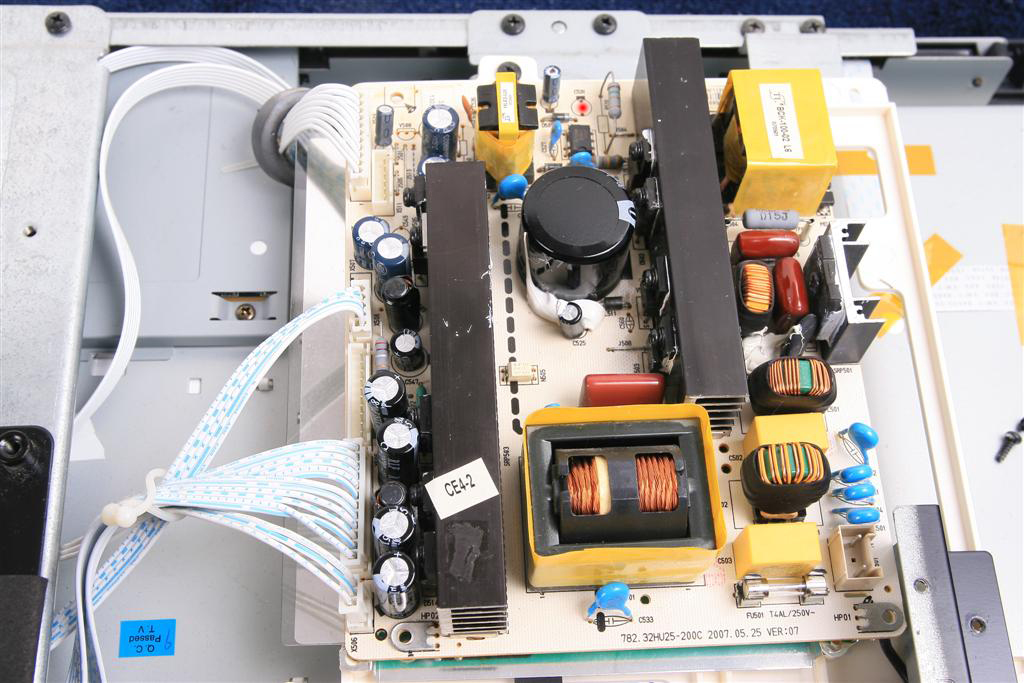

    Hello folks
    I have come across a capacitor 47uf 50v for a tv power supply with no esr value in curcuit or out of curcuit.cap is not bulged all other caps are have good values I am using EDS 88A capanalyzer I am very new to this so I am assuming this cap is no good. am I right
    Problem with TV is that it has green light on power nothing on screen.

      Re: capacitor with no esr value
      I get no reaction from meter at all. Meter is supposed to go thru a discharge then check
      dcr then I get esr value according to uf value in this case is 47uf nothing happens on meter when I connect probe to cap
        I say replace it, they are quite cheap components and can cause this fault.
            we call that open.like not there.a non capacitor.
                that value cap sounds like a startup cap,50v caps should read around 1 ohm on esr,normally 0.00 ohm esr would be a great value for lower voltage caps,sounds like this one has dried up showing open circuit.
                  Well I ordered the cap lets hope this 13 cent cap will fix 32" tv that I bought for $25.00.
                  What do you mean by a startup cap? is it a capacitor that remains in-circuit during both start-up and running ?

                    depending on the circuit,the startup cap normally delivers its voltage to a 8 pin power ic ,it will be working throughout startup and running,sometimes when this cap fails it will cause a chirping sound to be heard on the psu
                    fixed so far...376 lg lcd tv's,24 onn tv;s,24 panasonic lcd,16 jvc lcd,12 marshall jcm800 amps,refurb of various disco equipment lighting,old style disco decks ,and a flymo!
                    please let us know if everything works ok if your tv gets fixed, as it will be and aid for anyone else having the same problem and wishing to fix it.it would save people clogging up this site with topics that are duplicated,and can be found easily using the search function.,and taking up valuable space.enjoy your fixed tv!,hopefully!
                      The controller IC (8 pins usually, sometimes more or less) needs about 10-12V DC of power, from 115/230V input.
                      In order to provide this a high value resistor charges up the cap and a zener regulates it. Once the voltage reaches a set point determined by the controller, the controller starts using the energy in this cap to run and turn the output on.
                      Once running an auxillary winding takes over and provides power to the controller IC, like an alternator in a car supplies power to recharge the battery.
                      The cap is most important in the brief time at which energy is being drained from it by the controller IC, but no energy is being provided to it. If its capacitance is too low (or in some cases if ESR is way too high) it will be like a car with a flat battery, unable to start. And you will hear a characteristic ticking from the PSU sometimes.
                          whats the make and model number of the set your working on? whats the problem with it?
                          Insignia model # NS-LCD32
                          Problem is when plugged in push start button on I get green light nothing on screen. previous owner was watching TV when it suddenly went blank all caps check out fine except one 47uf 50v
                                    Update on my original post. I received my 47uf 50v cap and installed it, very encouraging when I saw the display light up now to put it back together and hook it up to my satellite. hope it works.
                                        Originally posted by koerneka
                                        I too have been fighting with an Insignia 32" - I am waiting on my replacement caps to arrive in the mail - what was the location of the 47uf 50v cap, if you don't have the set put back together now?
                                        Here is a photo cap goes where the red mark is
