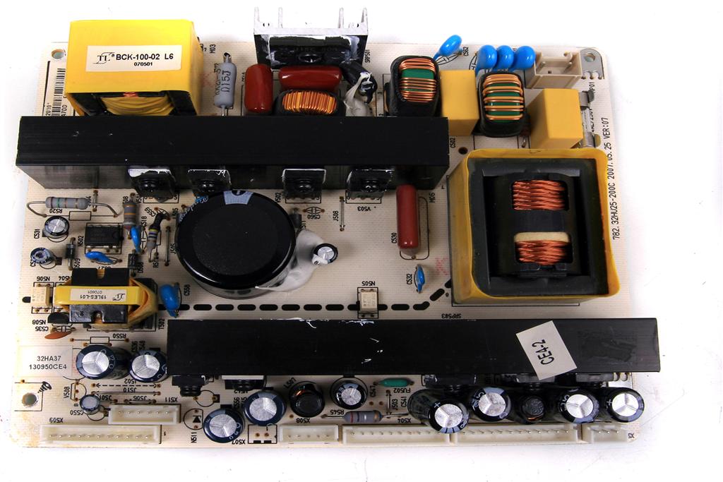

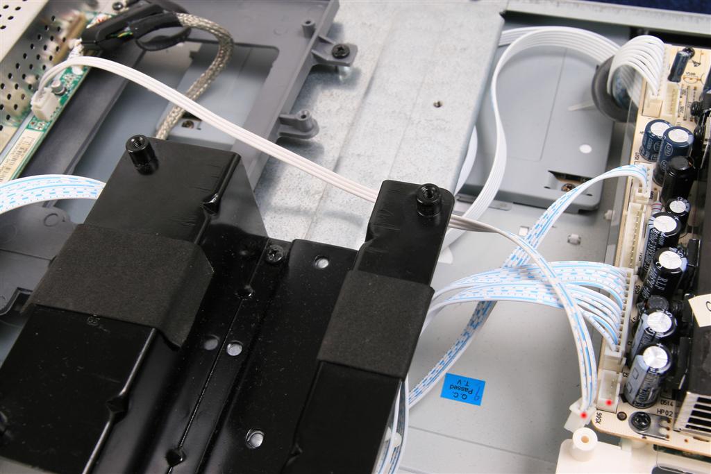

        As I re seated tcon cable and re assembled all the wires I turned it on and nothing no display untill I unplugged a cable form power supply to mainboard
        here is a picture. Ihave no Idea where to check for know help.

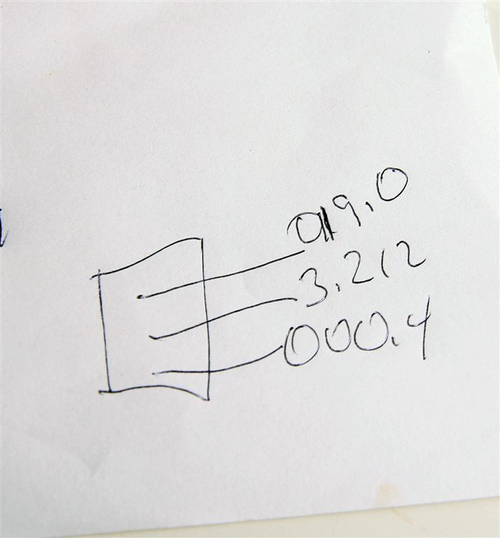

                    from bottom up pin3) 019.0
                    2)3.212
                    1) 000.4

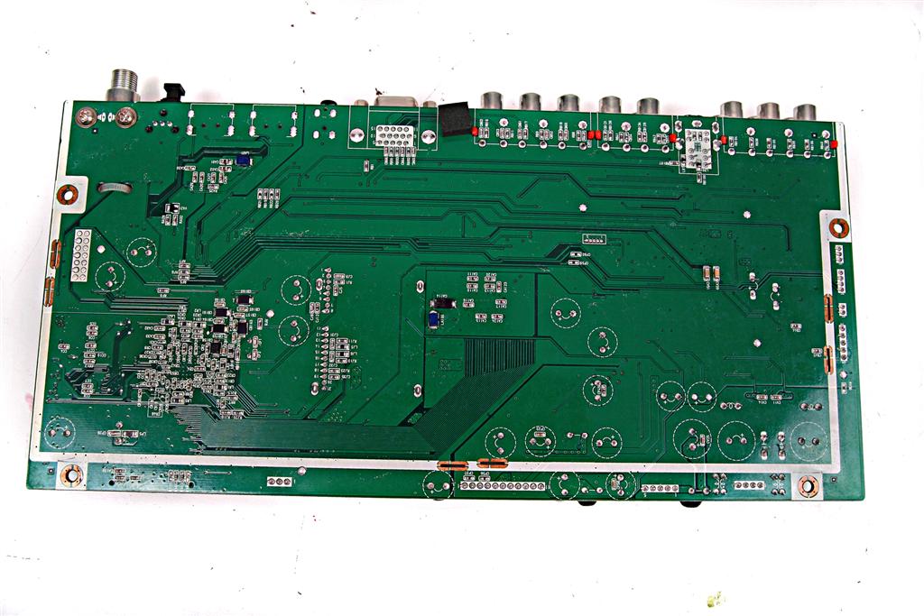

                        #31
                        Re: capacitor with no esr value
                        Originally posted by 1supertech
                        Here is a photo cap goes where the red mark is
                        Have a short circuit in wiring, if some on can follow this thread and help
                        me out I would greatly appreciate it
                        I have voltage reading with images

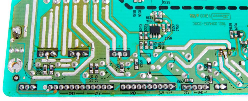

                          Does the power supply have any labelling near the connector indicating that is 3.3V output or something else? Are there any more outputs?
                          • 1supertech
                            • Apr 2012

                            No but here is a pic of connectors

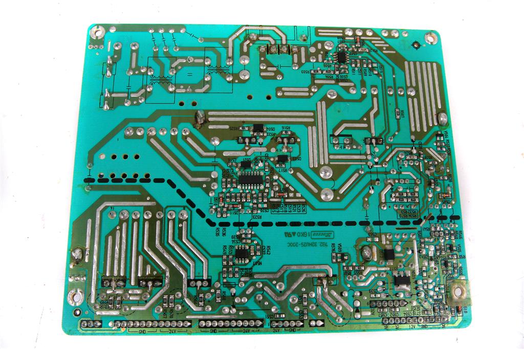

                              checking voltage form power supply at the problem connection starting at the top
                              I get
                              0.431
                              3.044
                              0.161
                              At the mainboard I get
                              004.5
                              3.288
                              005.0
                              I am assuming if a connection gets current from both ends that would be a short
                                #35
                                What does 24V measure at?

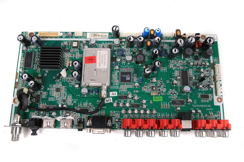

                                    I have a feeling that main board has a short I have checked all caps and they have good Esr values about .25 ohms
                                    Fuses on power supply test good all caps are good
                                    I have no idea what else to check

                                      #38
                                      Thought I would uplaod larger pics
                                      • 1supertech
                                        • Apr 2012
                                        • 384
                                        #39
                                        larger pics

                                          #40
                                          More images
                                          Finally got are hope they are large enough
