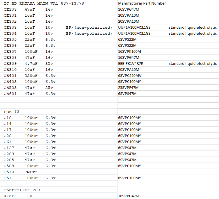

    I replaced some capacitor which is located on optical pickup pcb which is shown in the table below(PCB #2).Because it have been out of order.
    Now,It works very well,But I just have found that all caps (6svpc100my and other part number as well) ,which is shown in the table below, has ultra-high ripple current spec.
    It is not able to obtain any capacitor which can be a substitute for this ultra-high ripple current nichicon capacitor.
    So I replaced it with samxon and rubycon's general capacitor(GP,YXA series).
    I know that these capacitor will not last as long as nichicon capacitor did,
    But I doubt that inferior capacitor really harms nearby IC components, So I dread that Not only It doesn't last long, it may also chip away at lifespan of nearby IC components.

    nobody can say if it could cause damage unless they have a schematic

        so which cap is it? or is it all 7 100uf caps?
        who made that list btw? you should be fitting tantalum not more crap smd electrolytics.

            firstly lets talk about cap lists.
            they should contain the board number - because there are different versions,
            the cap uf, volts and ideally esr & ripple and most importantly size (width / height)
            a lot of people forget that bit and people buy caps that either dont fit or are too tall for stuff to be re-assembled.
            so you can replace electrolytics with tantalums,
            the only reason they dont use them from the factory is they cost like 5x the priice.
            apple, sun & sgi always used tantalums though - because it's expensive stuff.
            the bi-polar caps are special, you cant use regular electrolytics or tantalum for those.
            you can use film caps but those are probably too big to fit
            as for ali - i have had no problems with ali tantalums when i was doing xboxes.
            remember to pay atention to sizes so they fit across the pads nicely.
            and i hope you have a fast scope because you may mess up the laser calibration.
            btw, because tantalum dont dry out you can salvage them from old boards

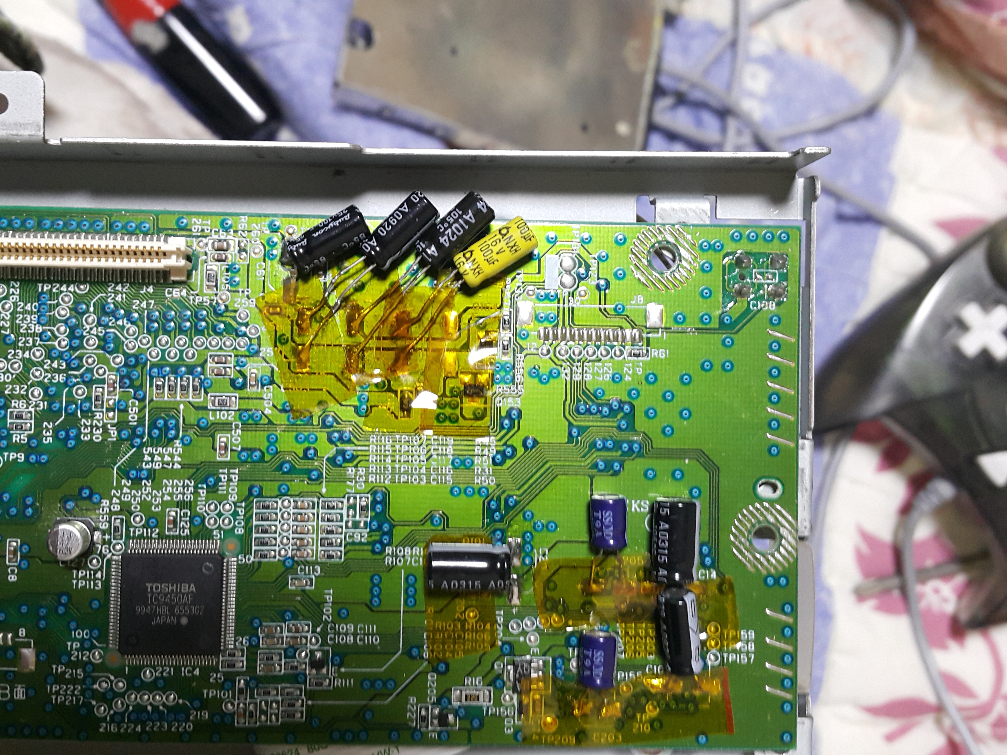

              Thank you very much for your reply.
              I bent all of caps in order to fit the height of space between pcb and plate like below jpg attachment.
              It seems that all of caps narrowly fit to space,And I test its performance by comparing it with another intact laser pickup PCB which I never have soldered at all and works fairly well.
              I inserted some burned CD-R and It seems that It also able to recognize any burned CD-R which can be recognized in the intact laser pick up PCB and It also stuttered to read some CD-R which is stuttered to read in the intact laser pick up.
              It seems that performance of pcb, which I replaced capacitor, is almost the same with intact laser pickup pcb.
              I plan to replace this regular electrolytics,which I soldered, with tantalium caps if it fail to recognize all of CD-R again..

                  I would recommend that you put wire insulation or heat shrink tubing that is the right size on the the capacitors leads when you put capacitors across traces like that what you have is not a good practice to get into because if when you remount the circuit board and you just happen to move one of those capacitors and the wires lead bends upward you will not know that this has happened and things might not go as planned I have had this happen in the past
                  However putting kapton tape is a good idea to use however you need to put it underneath the the capacitor leads as well but it does not keep the capacitors leads from being pushed together and cause issues that is why using wire insulation is a better solution for mounting capacitors on the bottom of a circuit board if you have enough space to do so
                  One note you need to try to keep the capacitors leads as short as possible to prevent picking up noise interference from the rest of the circuit sometimes this is hard to do sometimes you might need to put heat shrink tubing on the capacitors themselves to keep from shorting out the shell of the capacitor to the circuit leads from the board
                  Good job figuring out what the issue was with CD rom drive one more item that did not end up in the landfill
