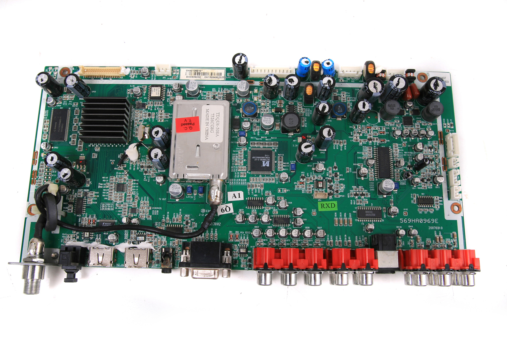

          Update on Ensinia 32" tv
          I installed 2 LDO regulators on mainboard still have the same problem
          I measured voltage on both regulators I get
          Regulator 1 from left to right
          000.7
          1.803
          05.04
          regulator 2
          000.7
          1.802
          05.04

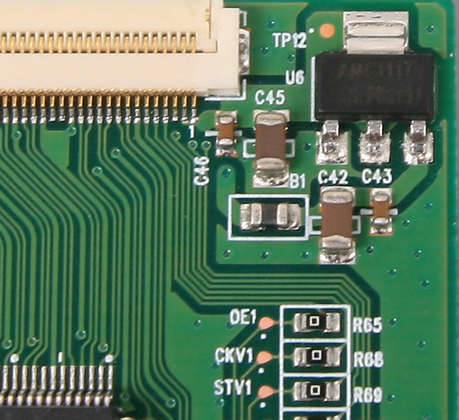

          I looked for a fuse on the Tconn could not find it. should the Tcon have a fuse ?
          I did find a fuse under f1 it' ohm measured 0000 I gather that is good
          Thanks for any response

            Did you replace the LDO with 1.8V fixed output regulators? In post 49, the regulator is an adjustable LDO that has too high of the output voltage, it should have an output of 2.5V (1.25 + 1.3 = 2.5V).

              #66
              Re: capacitor with no esr value
              Here is a Digi-key part # AP1117E118GDICT-ND
              How do I adjust It I hope it's self adjusting forgive my ignorance.

                    #69
                    I am confused, on post 49 we were talking about the bad Adjustable regulator, but where are these 1.8V Fixed regulators are from on the board.

                      #70
                      This is the mainboard two NP3 marked in red
                        #71
                        So both of them has -18 marking on them?

                                    #77
                                    Any one in the PDF will do.
                                    For example:
                                    http://www.digikey.com/product-detai...44-1-ND/586244
                                    I also see where the confusion come from and why you had ordered the 1.8V regulator, Tom was giving you and example how to tell if you have fixed regulator if it has -18 on the P/N. The "AMS1117-18" is just an example not the actual for you to order since you have adjustable regulator as shown by what the voltage you were getting at the 3 pins as you have posted #49 one ONE of the TWO regulator. The one with the reading a shown below needs to be changed for sure:
                                    "From left to right
                                    1.3
                                    3.303
                                    05.04
                                    part # EHI6A
                                    715F83"
                                    So one of them has bad reading, but you have shown TWO regulators as marked in the picture. What was the reading of the other one.

                                        #79
                                        You can tell for sure if they are both the same by looking at pin 1 to see if it has two resistors connect to it. That is how you can tell if they are adjustable regulators, and the voltage between pin 1 and pin 2 will always be 1.25V.
