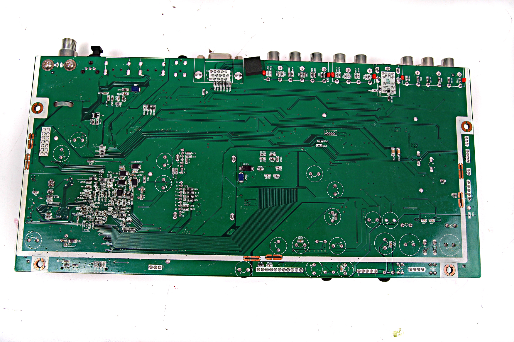

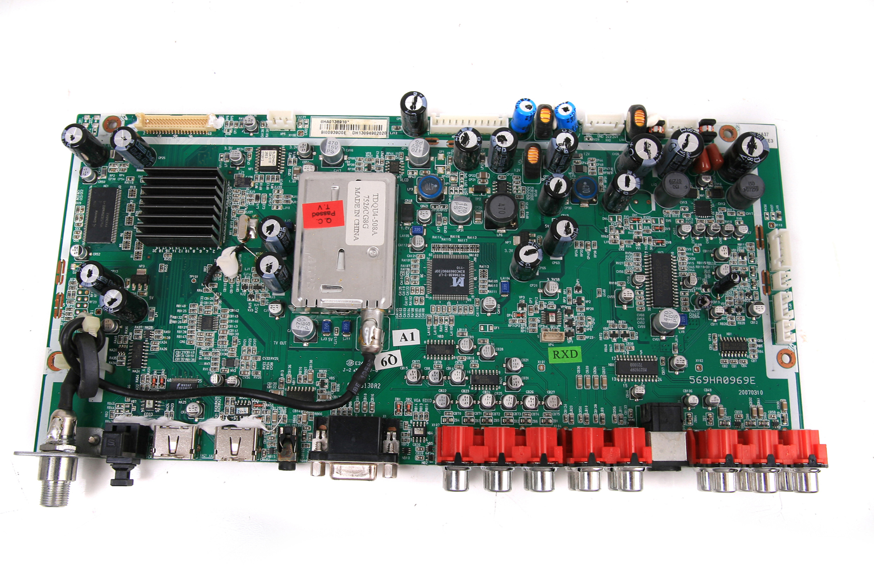

      Other pic of mainboard may be to small
      I think this will do
        #43
        Re: capacitor with no esr value
        Is there anything on the back side of the board? Any LDOs like in the picture?

          #44
          Nope
            #45
            I can see one next to the two black caps labelled NP3. There may be others, I can't see any though. Test all the pins of NP3, relative to the metal case.

              #46
              Yes I do see it and what do you mean by test relative to the metal case
                #47
                Meter on volts DC (20V), black probe in COM slot on meter and in a spare screw hole on TV (or any hole on the metal frame), red probe in volts/ohm and test each pin. Middle pin is the same as the fat tab, no need to test the fat tab. Report the pins 1, 2 and 3 (labelled arbitrarily, suggest left to right and that you keep it the same for each device.) Also include the part number on the device, for example AMS1117-18.

                    #49
                    From left to right
                    1.3
                    3.303
                    05.04
                    part # EHI6A
                    715F83
                      #50
                      I looked at the NP3, looks like Adjustable regulator (you can see two network resistors on pin 1 & Gnd and pin1 & pin2. If that is the case the output should be 1.3 +1.25Vref = 2.55V output at pin 2 ( if we know the value of the two resistors then we can calculate the output voltage). Input pin 3 is 5V as printed on the board.
                      On the bottom side around top left corner, you can also see Adjustable Vreg VA21.
                        #51
                        The best way to check an adjustable regulator is the Vout to ADJ pin should measure 1.25V approximately.
                            I have a feeling you have bad regulator, the output is too high. 1.25V ref is part of the internal circuits of the Regulator.

                              #54
                              so is this what was causing the short between power supply annd mainboard?
                              So I guess I need to buy another part form a digikey? # EHI6A 715F83
