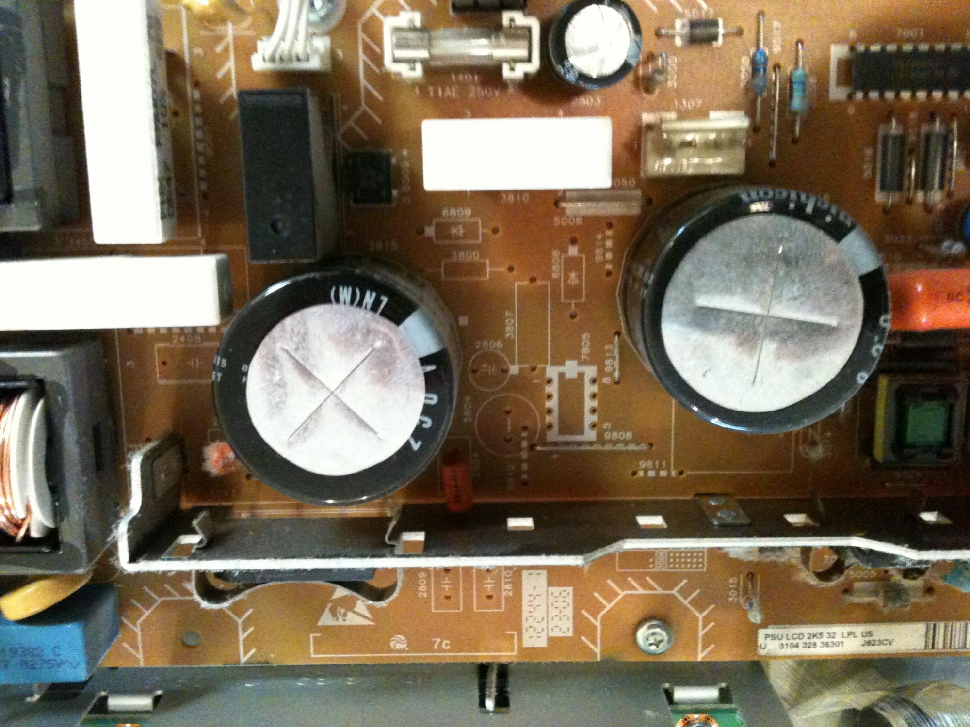

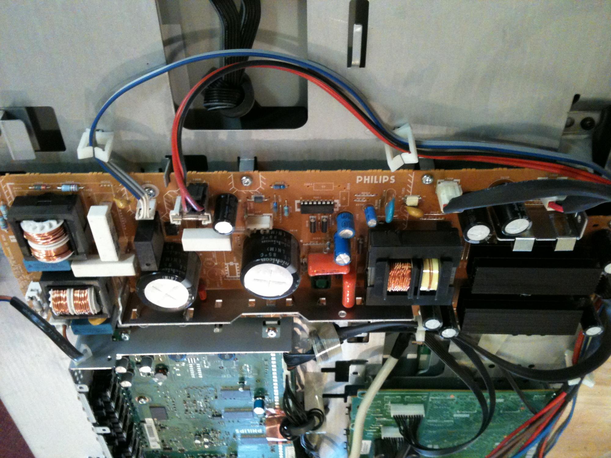

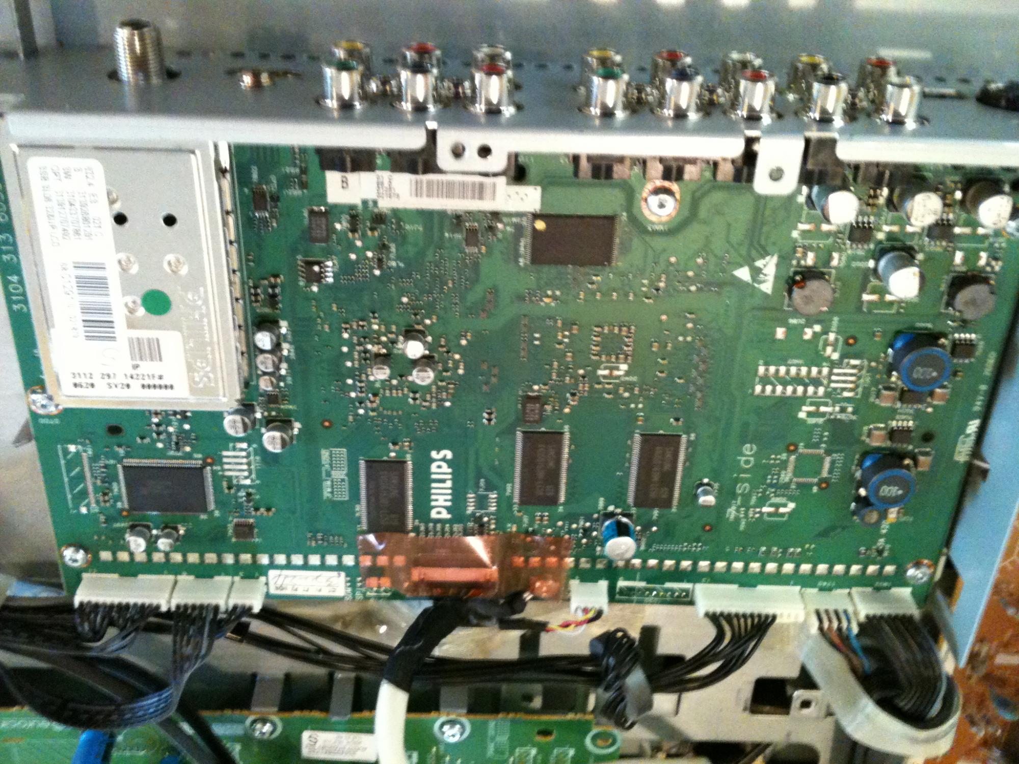

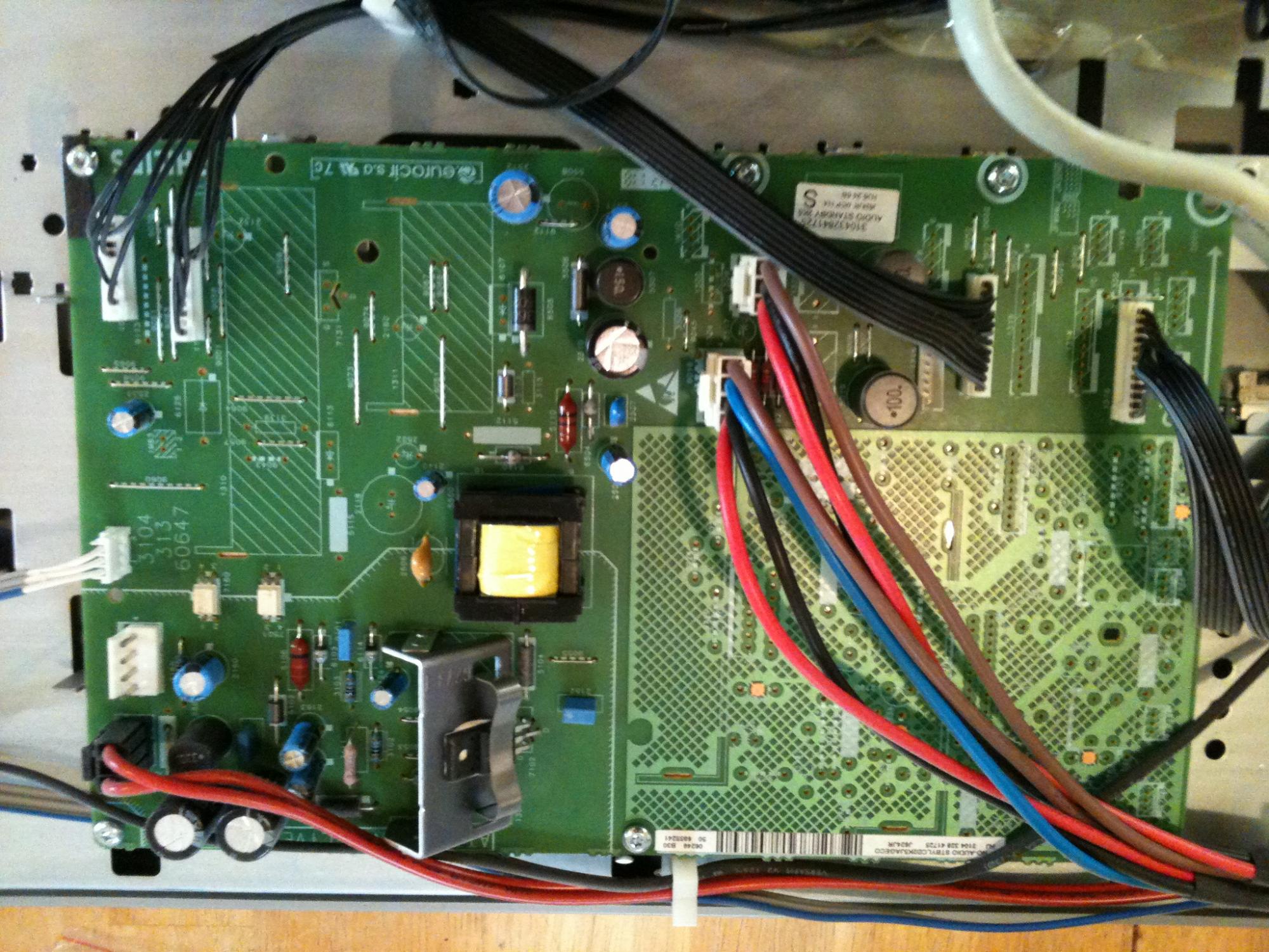

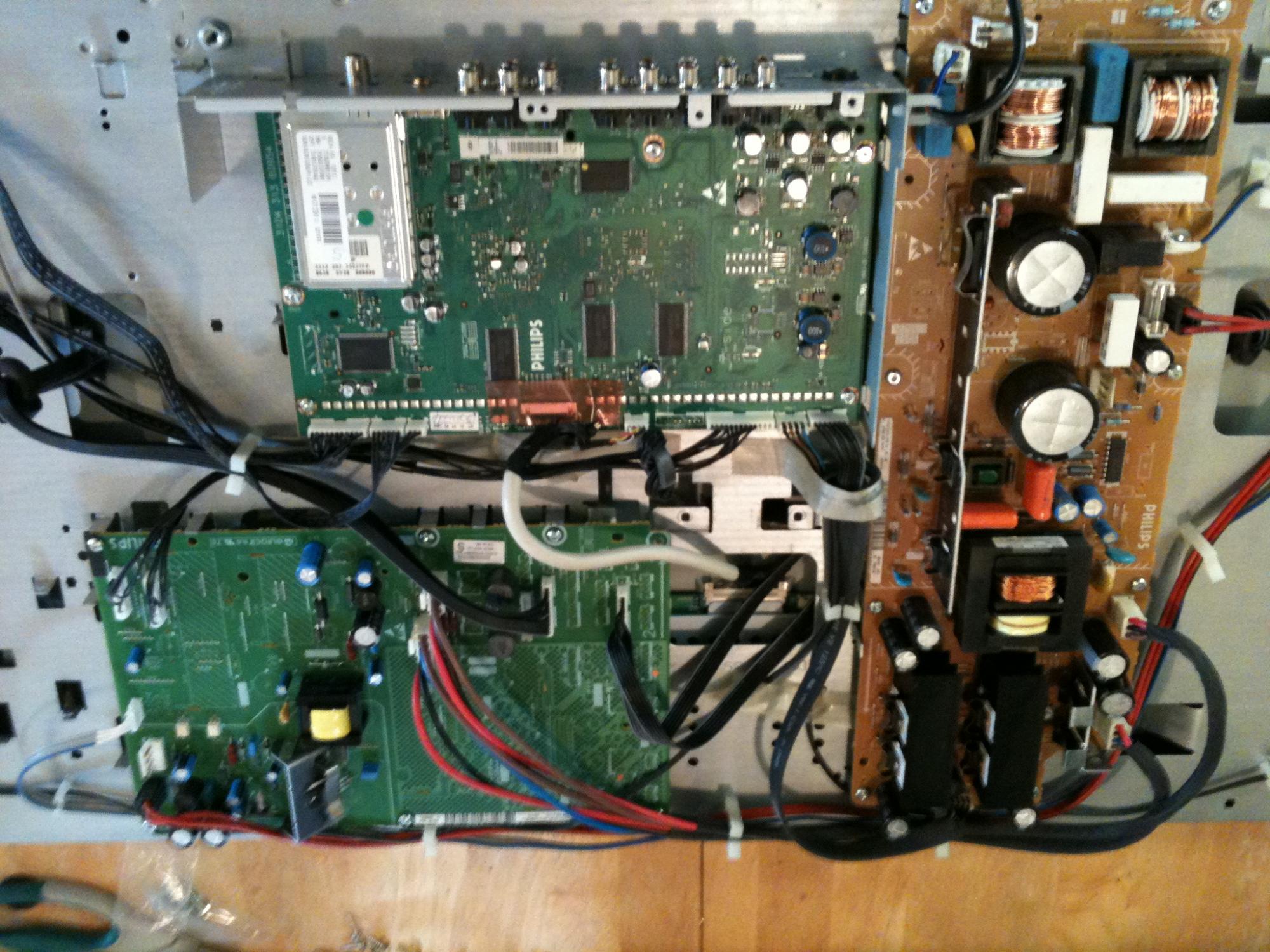

    These are the pictures I took.
    I took a close up of the two biggest capacitors on the board. They look a tiny bit bulged. I'm not sure that it means that they are bad or if that's not how they're supposed to look, but all capacitors I usually see are completely flat from crease to crease. These are the first time I've seen caps this big so I'm not exactly sure. I also don't know how to make sure they are discharged so I'm not going to touch them just yet.

          check the large caps with a multimeter to see if they have voltage on them,if they do ,just discharge them with a household light bulb, solder wires to it then just touch them on the big caps for a few seconds,no need to worry bout the smaller caps,sounds like you have a cold joint on the power board,have a check and retouch with new solder where they might look cracked
          fixed so far...376 lg lcd tv's,24 onn tv;s,24 panasonic lcd,16 jvc lcd,12 marshall jcm800 amps,refurb of various disco equipment lighting,old style disco decks ,and a flymo!
          please let us know if everything works ok if your tv gets fixed, as it will be and aid for anyone else having the same problem and wishing to fix it.it would save people clogging up this site with topics that are duplicated,and can be found easily using the search function.,and taking up valuable space.enjoy your fixed tv!,hopefully!

            Hi - random offs are often hard to trace. How random are we talking and if you turn it back on does it come on straight away. What does the power led do when it goes off. Is the going off preceeded by screen flicker.
            When turned on from cold does the screen look at all pink.
            Does it still turn off as much with the back off - ie when cooler.
            Your pictures are not really sharp enough for troubleshooting.

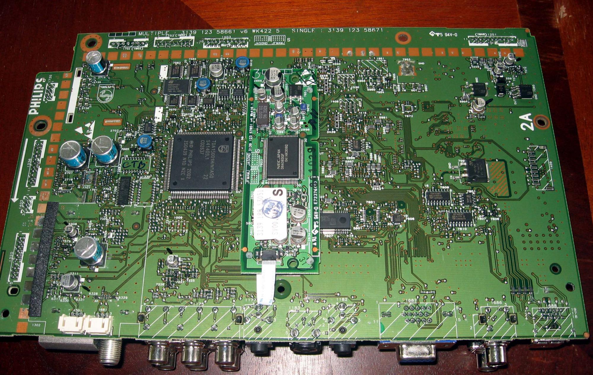

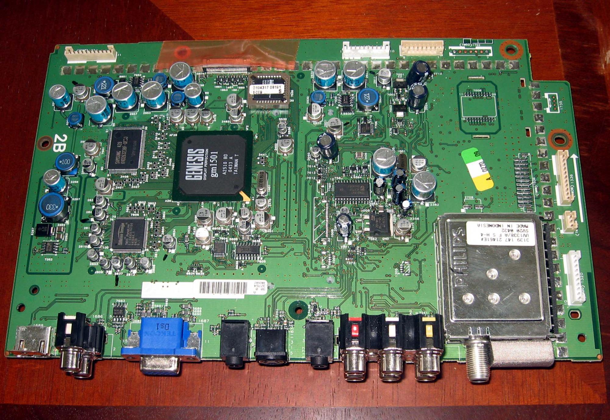

              Got mine apart on the bench right now. Of course it's worse than yours, won't even come on.
              Main Board:
              So far I have found 4 bad surface mount caps located just left of the tuner near a regulator and a crystal. There are (2) 2.2uf and (2) 10uf at 50V each (Surface Mount) Aluminum Electrolytics that my Blue ESR meter is reading at between 11 and 13 on each. Very bad caps right off the bat. I'm still working with it because I suspect there are more to be found.

                I'm also finding several 100uf 50V surface mounts in various places on the board that are reading an esr above 1 whereas my new caps read between .3 and .4 respectively. So far, the main board caps have not aged gracefully lol.

                  There are three boards on mine, I've noticed that richpart has described a main board and a power board- which is which, and what is the third board?

                    That's my conclusion on these gentleman. The main board surface mount caps are deteriorating and as they get worse, the set becomes more stubborn to turn on until finally it gives up the ghost. If you are not comfortable replacing surface mounts, looks like you'll have to buy the main board. The board also has them mounted on the bottom side as well.
                                The Power Board is the one with the BIG caps on
                                The Main or Video board will have the Tuner on it - a large silver metal can where the aerial /cable plugs in.
                                Third board ???? (Pictures are everything you see)
                                Could be a separate inverter board, could be a power supply filter board,
                                could be a Tcon board? - We will know when we see it

                                    List of all bad caps on the main board:
                                    Top tuner side:
                                    2911
                                    2912
                                    2024
                                    2921
                                    2061
                                    2355
                                    2396
                                    2356
                                    2561
                                    2380
                                    2262
                                    2843
                                    2837
                                    2834
                                    Botom Side:
                                    All on attached plug in card and
                                    2910
                                    2311
                                    2308
                                    2526
                                    2254
                                    • richpart
                                      • May 2012
                                      • 42
                                      Re: LCD TV turns off randomly
                                      You will see that I'm using regular capacitors topside because I don't have enough surface mount to go round. This is my preference.

                                        [Quote selldoor]Third board ???? (Pictures are everything you see)
                                        [/Quote]
                                        Haha - sorry you have a pic and the best one at that. It is none of the
                                        above it is an audio standby card No 3104 328 41725 ( whatever that is!!) I have not come across one before.
