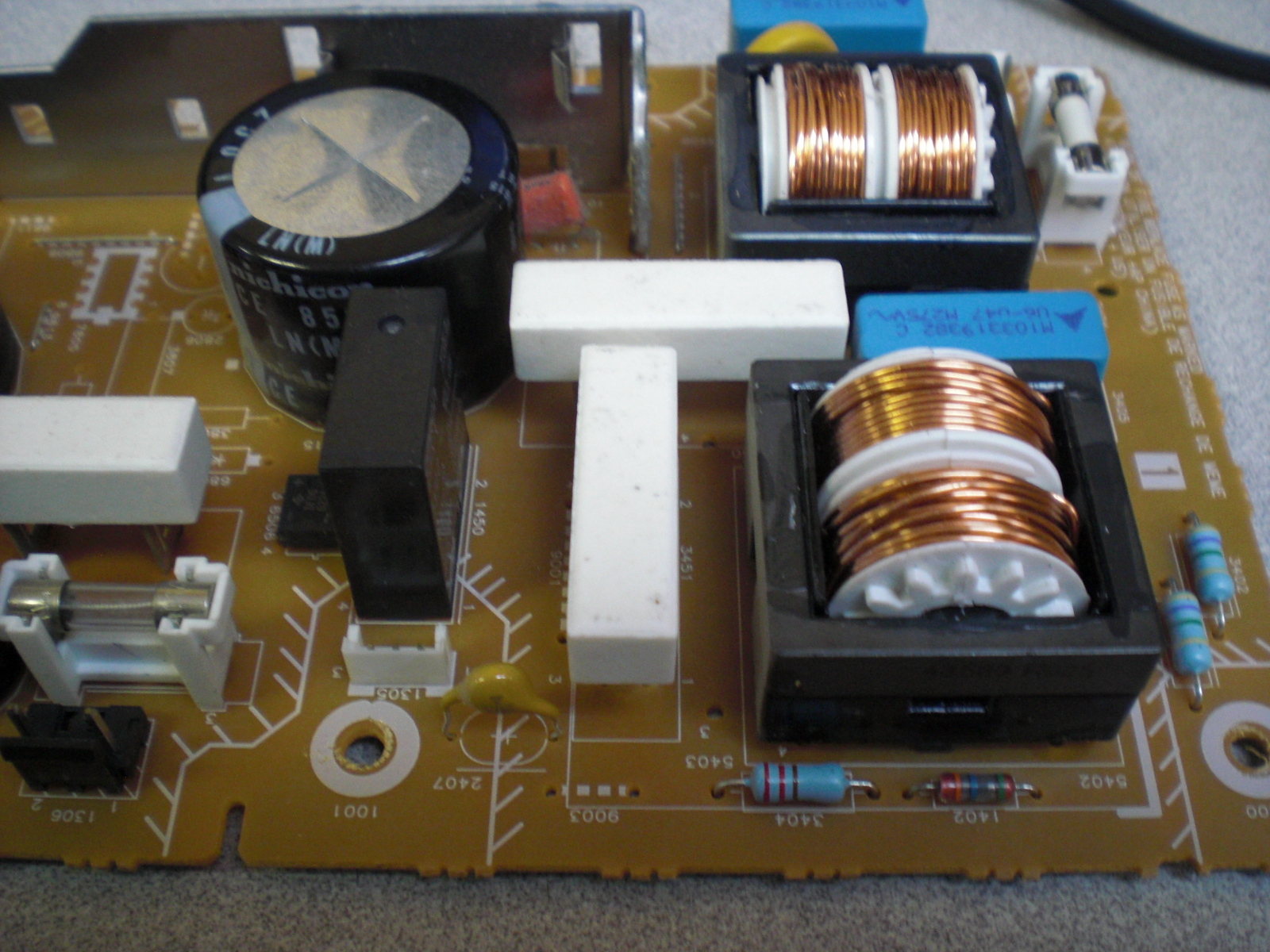

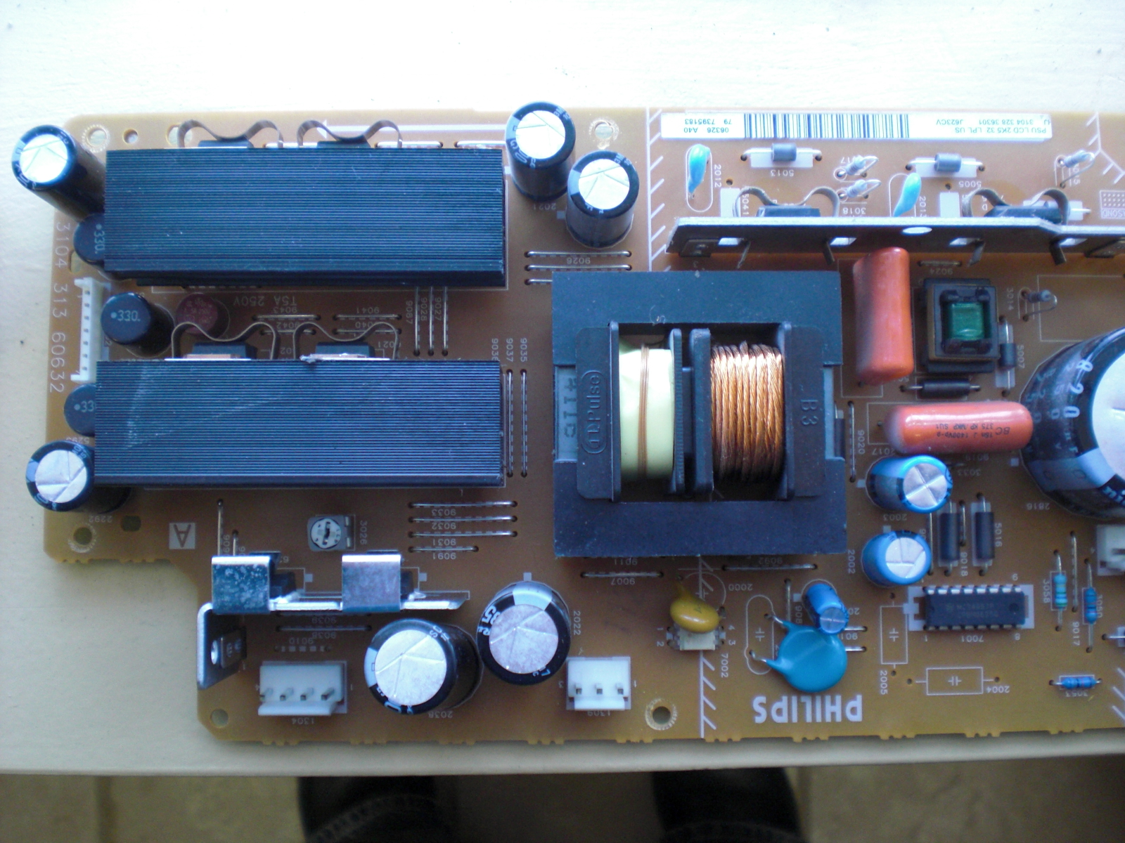

    @richpart. It would appear that your boards are entirely different to silvergoats.
    My suggestion would be that you start a new thread for your set and copy over what you have done already. Clearly you can support each other but the list of faulty caps
    and the pics of your boards are going to mislead everyone when trying to follow it.
    In fact you probably have time to edit the information out of this thread and cut and paste it into a new one.

      Re: LCD TV turns off randomly
      I just noticed that silvergoat's board is different but I bet the caps are going bad on it too.
        Yes but they are likely to be in different places and have different board legend

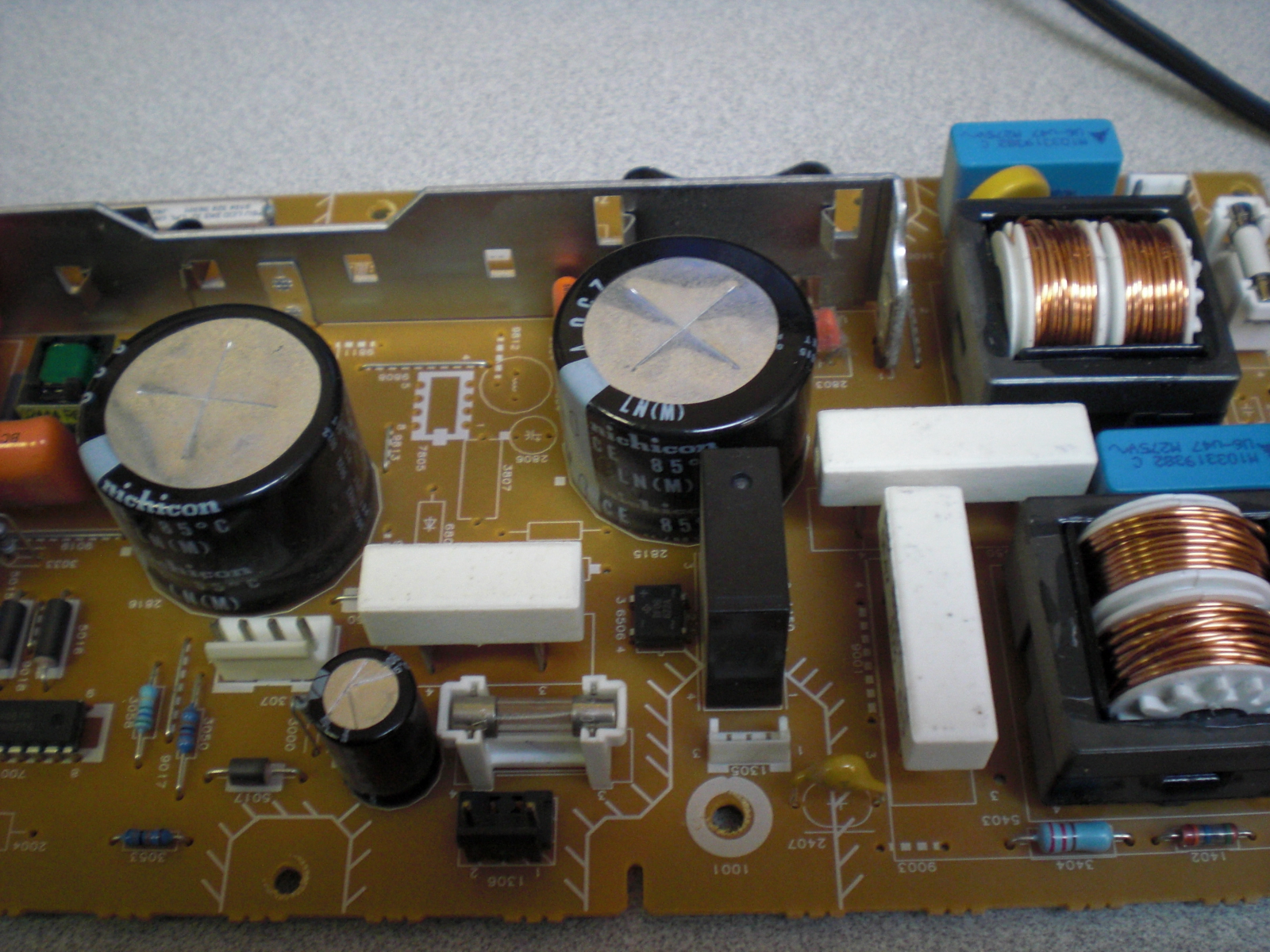

          The Power Board is the one with the BIG caps on
          The Main or Video board will have the Tuner on it - a large silver metal can where the aerial /cable plugs in.
          Third board ???? (Pictures are everything you see)
          There are 3 boards in the first pic- Power board is on the right (upside down), Main board is at the top, 3rd board is on the bottom

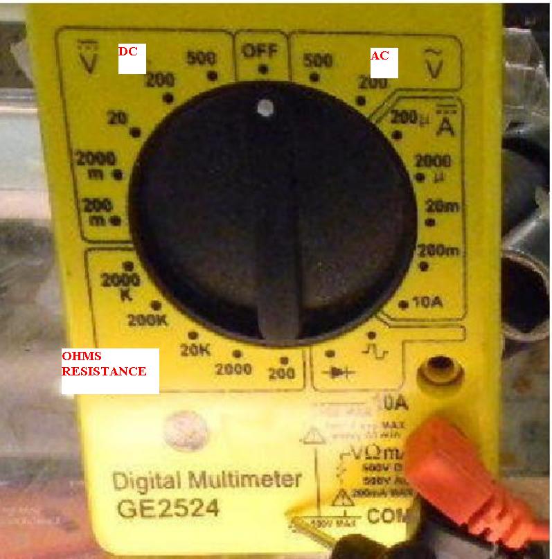

            "It's a GE2524"
            I cant find a manual but here is a pic - looks simple enough to use. make sure it has a good battery put the leads in as shown in pic red in middle hole
            black at bottom (com) I have marked which segments should be used
            to measure what.

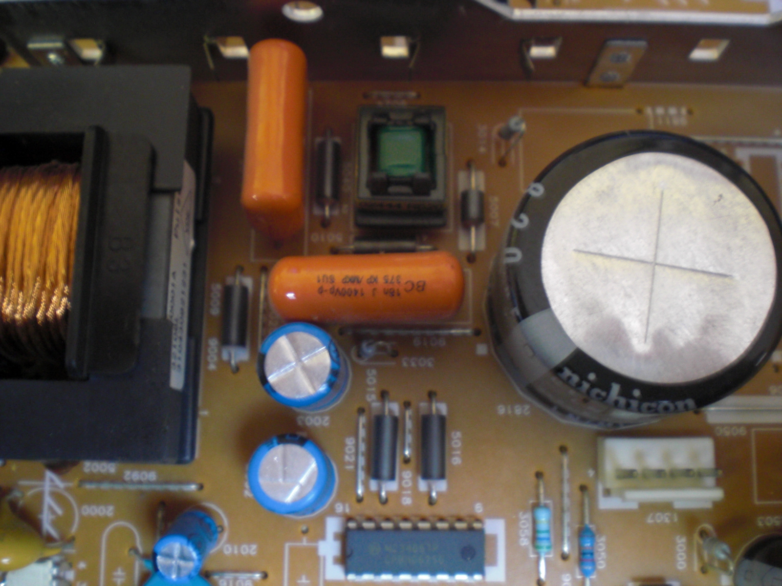

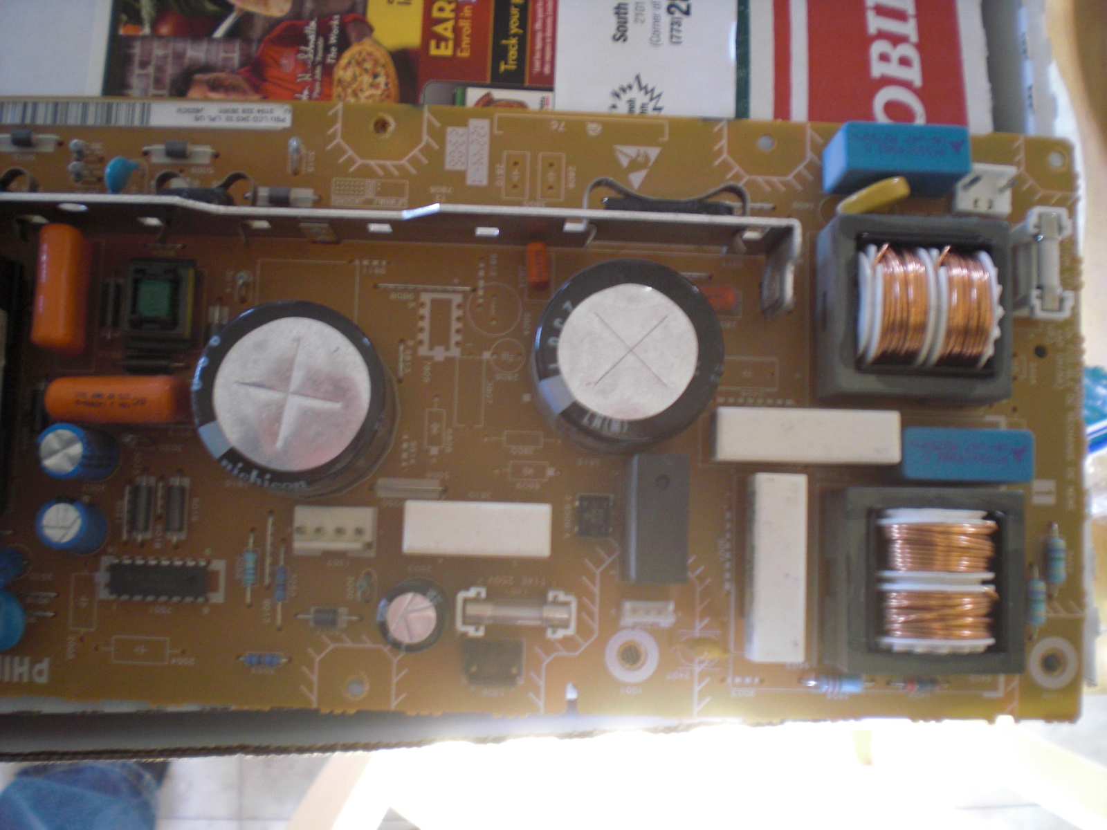

                  • Oct 2011
                  • 53
                  I've attached better pictures of the power board.

                    If the board is still off can you do the backs. The big caps are unlikely to be the problem
                    unless they have become unsoldered ,they are a good make and unlikely to have failed.
                    First unplug and replug as many connectors as you can find - make sure they are firmly reseated.
                    Next test is highly scientific and requires high skill level.
                    With it all connected up switch it on and get a hair dryer. Warm (not too hot) one board at a time and see if you can get it to switch off. If you find a board that does that you next have to try and narrow it down to a section of the board so let it cool then start
                    again. Report results. I have had a busy day so off to bed already- next tests will involve
                    measuring voltages - so i hope you have been practising.
                      Thanks-
                      I will put it together tomorrow and begin stressing the board to see if I can duplicate the problem. I've already desoldered and resoldered many items on the board so it should be a good test.
