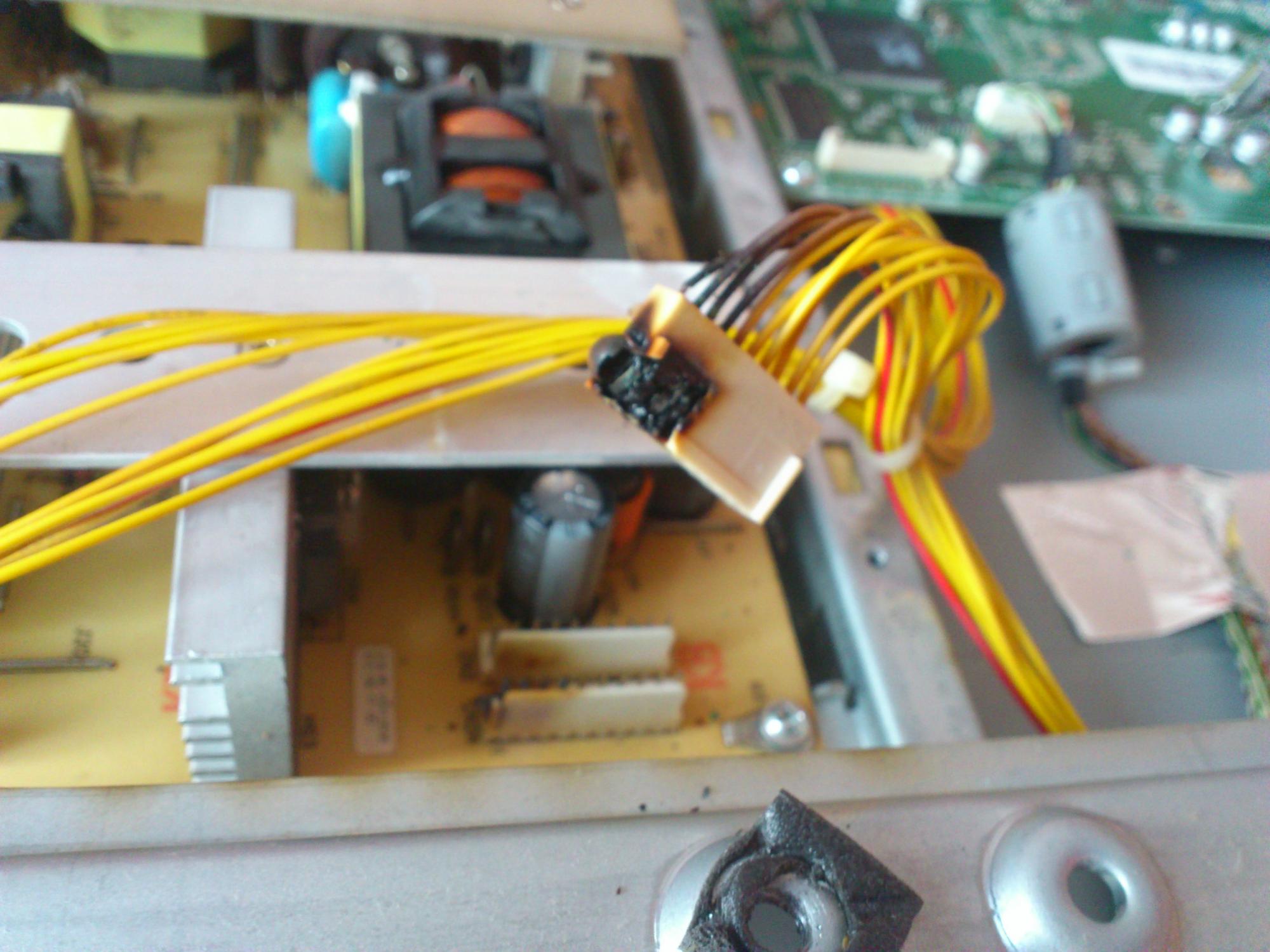

what could have caused this?? burnt connector
  • shepp
    • Mar 2012
    • 377
    • England
    repair on a 42" lcd, found this and 1 bulging cap
    ive ordered caps and changed the connector and fuse
    this picture is the invertor supply cable that comes from E301791 PSU
    could it just be a bad case of bad caps or something else?

    Poor connector contact resistance, the inverter usually runs at 24Vdc with about 5A of current. You need to replace the connector and clean the Male posts really well and also check and resolder the male pins as well.
      i managed to get the same connectors male and female off ebay so recrimped the cables and put new socket and plug on, just waiting for the caps to come theres 3 in total but only one bulging so thought id just replace all 3 while im in there
      another problem is ive had to order fuses from hong kong (T 5 Amp PCB Leaded) but not sure wether i can wait up to 4 weeks for them
      ive got some T 3.15 Amp leaded fuses so not sure wether to just bang one of them in for the time being if it'll run, what do you think? just try it and see or wait for the right ones?

        If it is the main fuse, it may blow due to high inrush current. Is this the main fuse? You can try running it without the Inverter boards connected since they are the one that draw the most current.

          Yes its the main fuse on the power board, think ill do that, just to test its ok then wait for correct fuse to come, thanks for input matey, if I get any more trouble when ive put the parts in I will post more pics and model etc

            well i was shocked to get the T5amp fuses today and the capacitors, so the tv is all done and tested.....another one bite the dust
              Re: what could have caused this?? burnt connector
              Great to hear... so the fuse just blew on its own with no other failure?

                no mate, see pic on first post, i had to replace the connector and there was 1 bulging 2200uf 35v cap, so i put new connector and socket on and replaced all the 2200uf 35v caps (x3) and the power board fuse (T5Amp). it had blown due to connector failure so had to order some fuses from ebay(couldnt find them any where else), but it said on the listing they were from Hong Kong so thought id have to wait ages but luckily they must have sent them from a company over here in the uk
                its lucky the tv didnt catch fire!
                them leaded fuses are a real pain in the arse to get over here!
                  The fuse was on the primary or secondary?
                  This fault has been seen in other TVs. It's very dangerous. Did you need a crimp tool to fix the connector?

                    it was the main fuse that feeds the primary side, the one near where the 240v plugs onto the board.
                    yes needed tool, but luckily my boss had one at work, only thing was i didnt adjust it so the first one i crimped just pulled out....so decided to tin the wire with a bit of solder then they crimped good, then i took them back to work and realised i could of adjusted them properly!
                    overall cost of repair was £10.84
                    fuses £2.16
                    capacitors £4.69
                    connector £3.99
