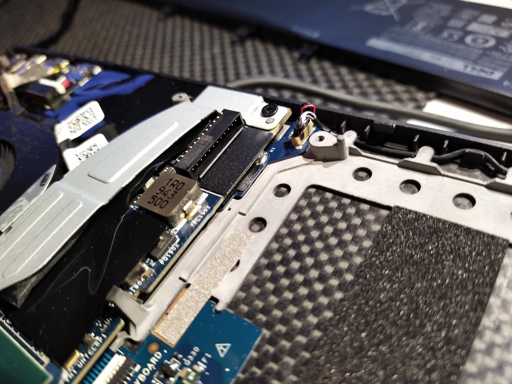

DELL XPS15 2019 P56F SPK connector burnt!
  • drscoot
    • Dec 2020
    • 44
    • Belgium

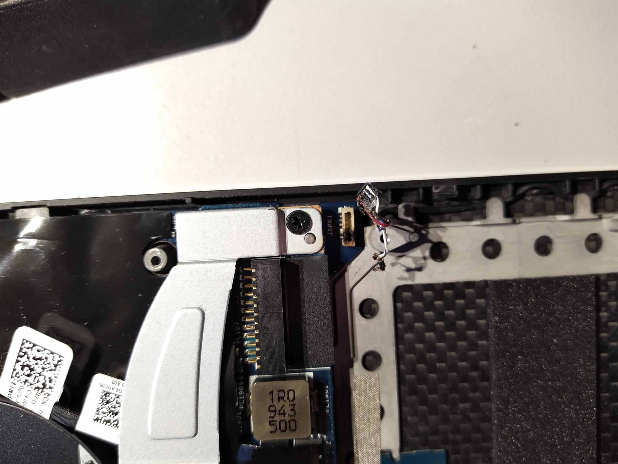

    Never saw this before, the speaker connector on the mainboard is half melted down! User says he was using a hdmi monitor when the laptop broke down. Power adapter led is the only live I see currently, 19,5V at the mainboard connector but nothing else. No voltages at the coils.
    What could possible cause that burnt connector?
    Idea's what to check?

    Re: DELL XPS15 2019 P56F SPK connector burnt!
    The only thing that can cause that is a high current short. Likely cause is that burnt wire caries a DC voltage and the wire got shorted to ground. If you can, test voltage on the pin with the connector disconnected to see if that is the case. Also test for a short on the speaker line.
