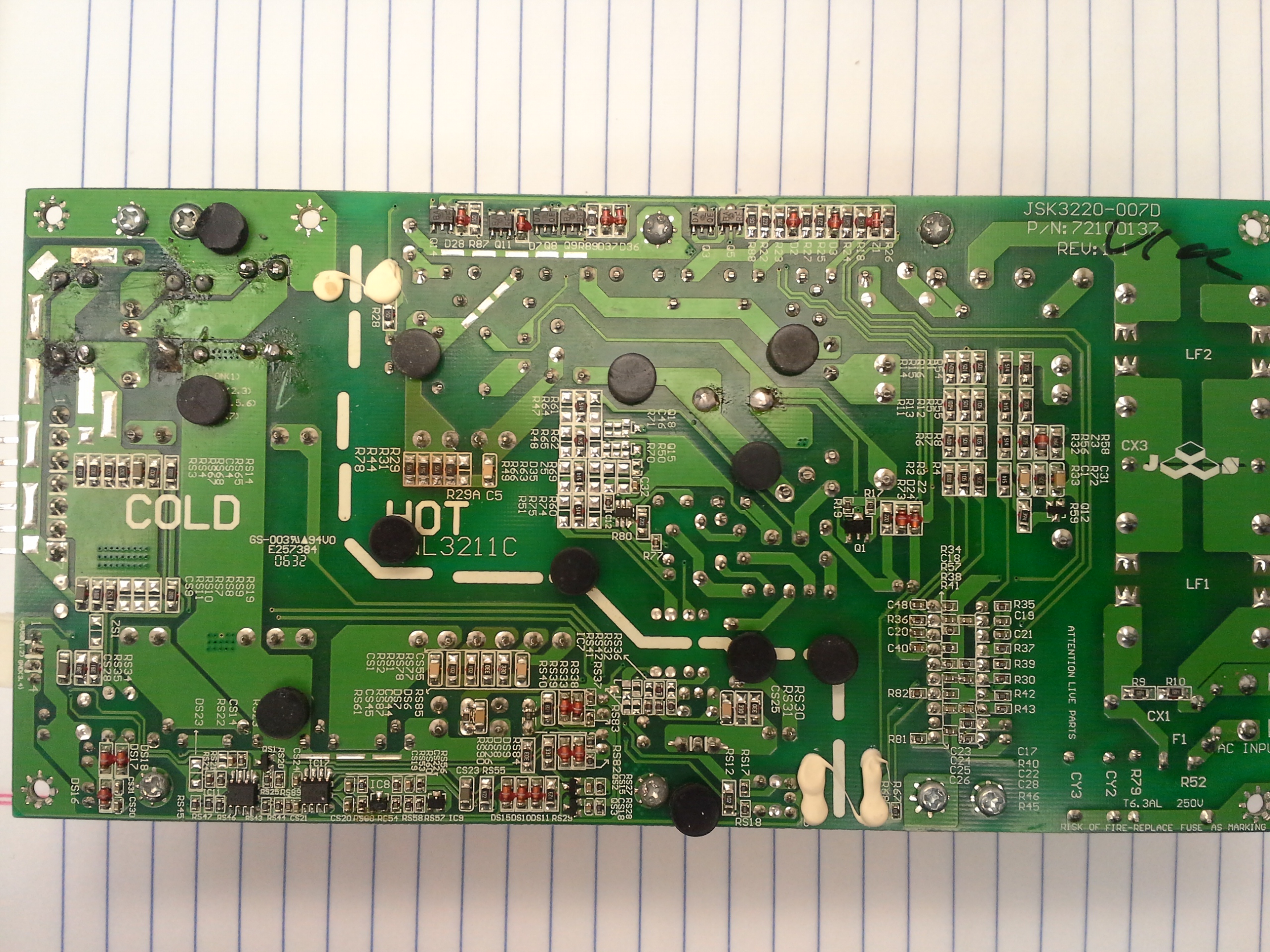

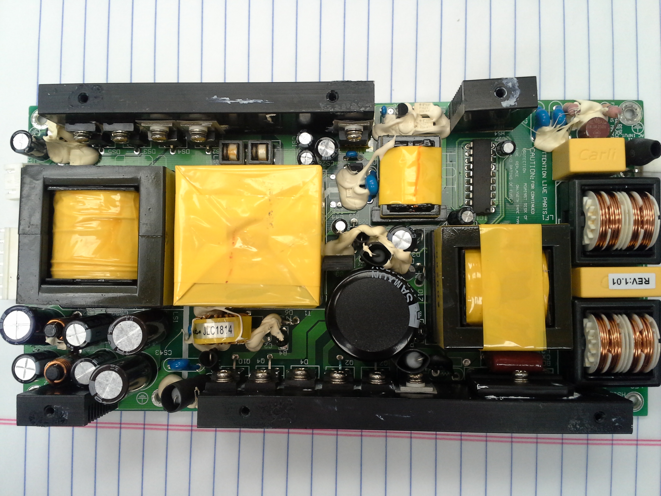

                          #92
                          Re: Rca l37wd12 lcd tv
                          I will try to post some pictures tonight...I at work right now and honestly I haven't looked at it for about a week so I will try to get it back out and do some investigating as well.

                              #94
                              Ok, here are some pictures...the capacitors that typically fail have been replaced, not a great solder job but didn't have much to work with since I bought this power supply on ebay and believe the previous owner attempted a repair. This power supply worked for awhile but now has quite working. As I stated before I can control the on/off signal providing the 120v to the power supply. On the output connector all I am seeing is 3.1v on Pin 1 of the 7 pin connector which I assume is a on/off signal as well. Any ideas?

                                #95
