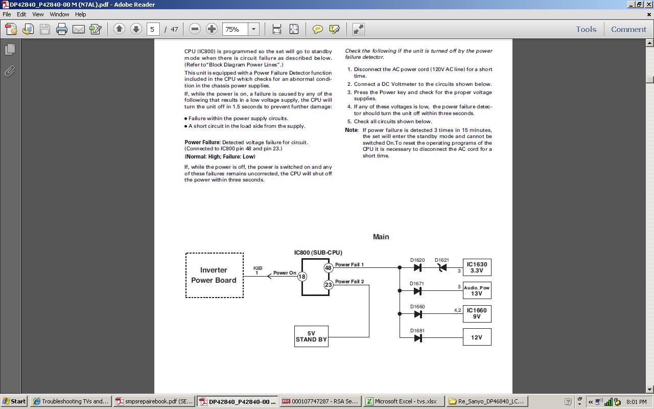

    I seem to have all the proper voltages except for K8L.. 2 black wires and 1 white wire.. White -0

      Re: Sanyo DP46840
      Did you get service manual though? It has test points for the 5 or so shutdown circuits which makes it fairly simple to determine where the issue is..
      Did you say it was DP42840-01? You had some typos

        Re: Sanyo DP46840
        See if you have these test points, this is from the -00 chassis..

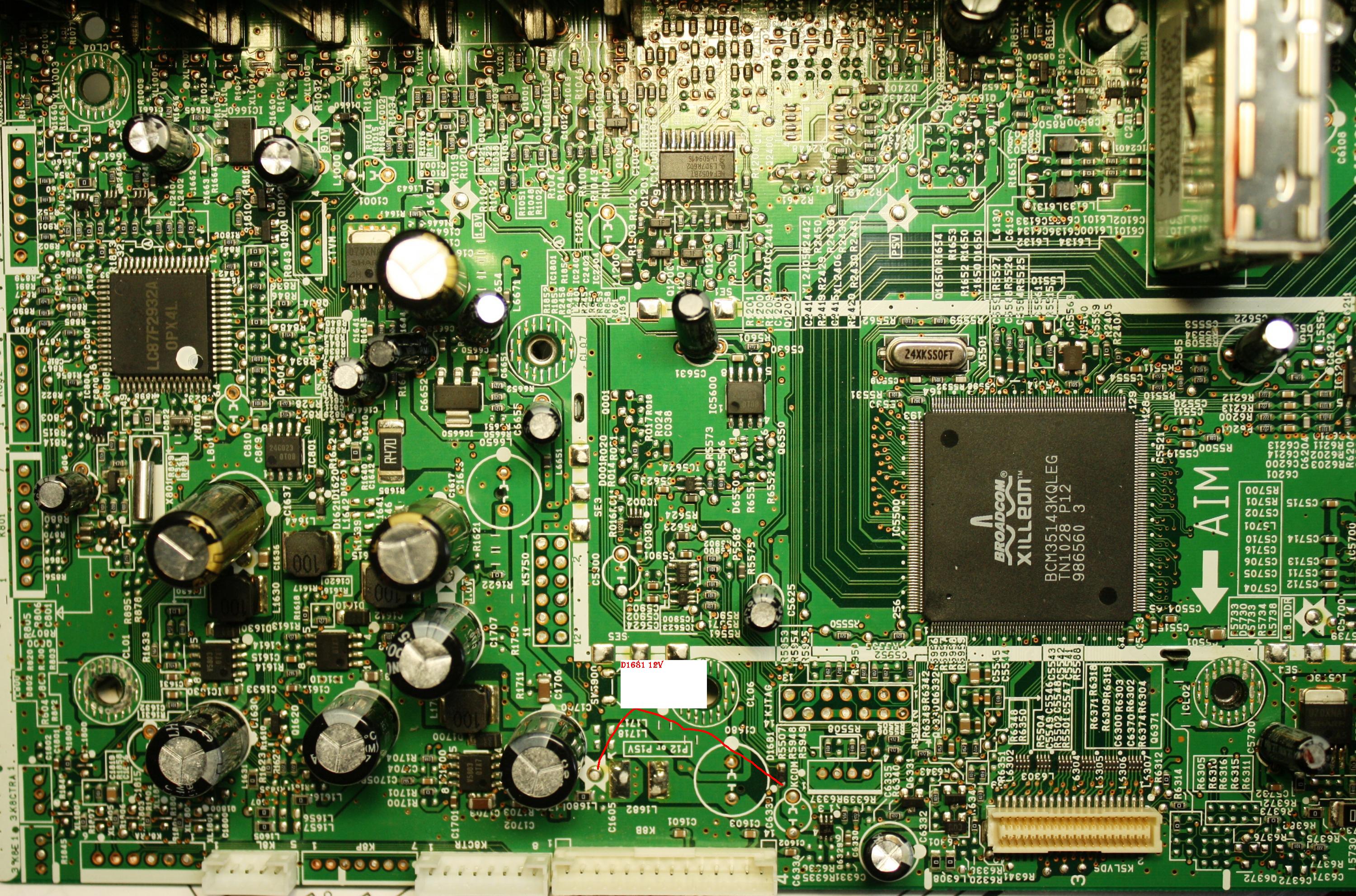

          • lilmonk3
            • Apr 2012
            • 259
            #85
            Re: Sanyo DP46840
            Here is a pic of the area on the main.. But I an not sure where or even how to test those points

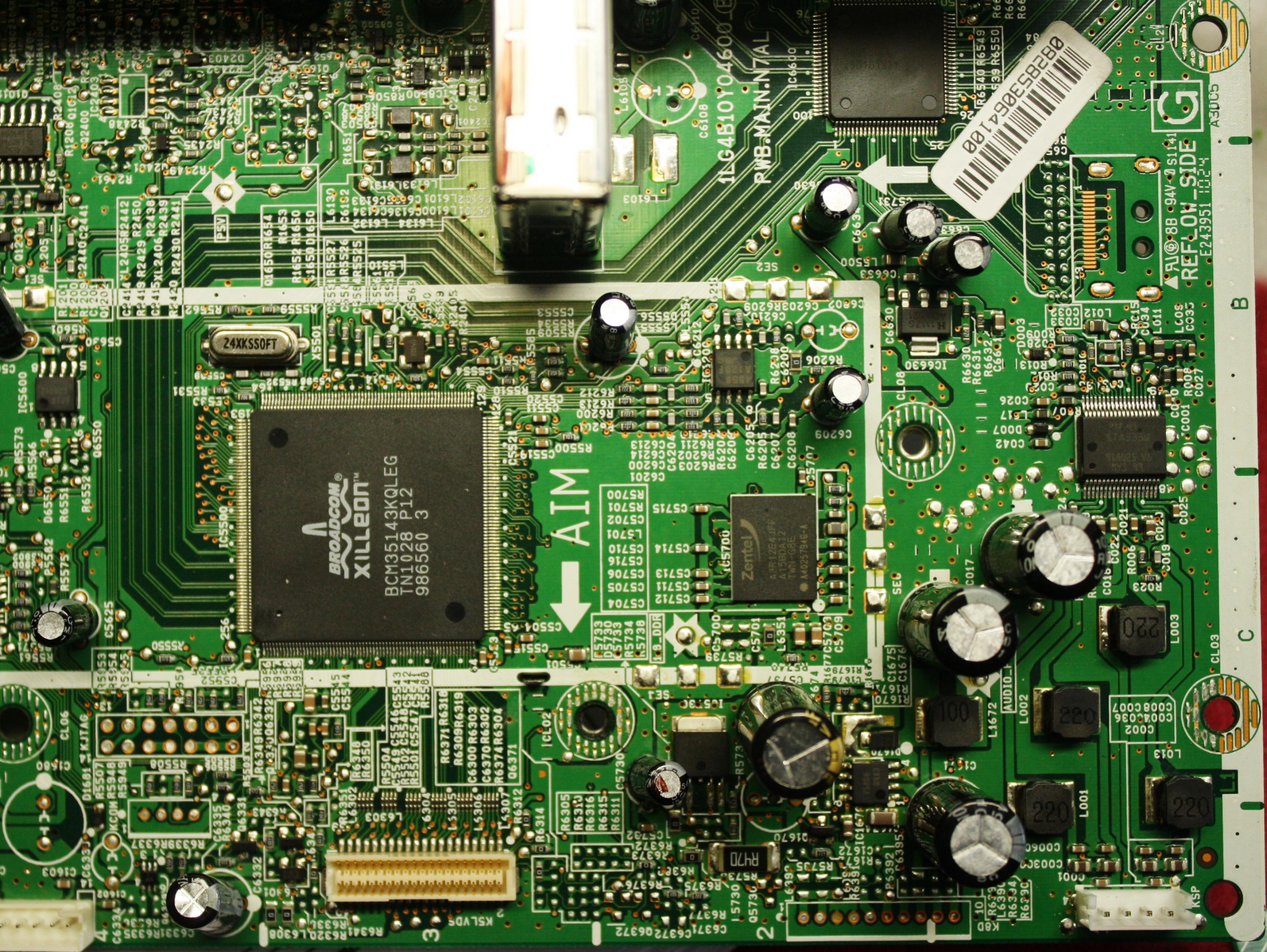

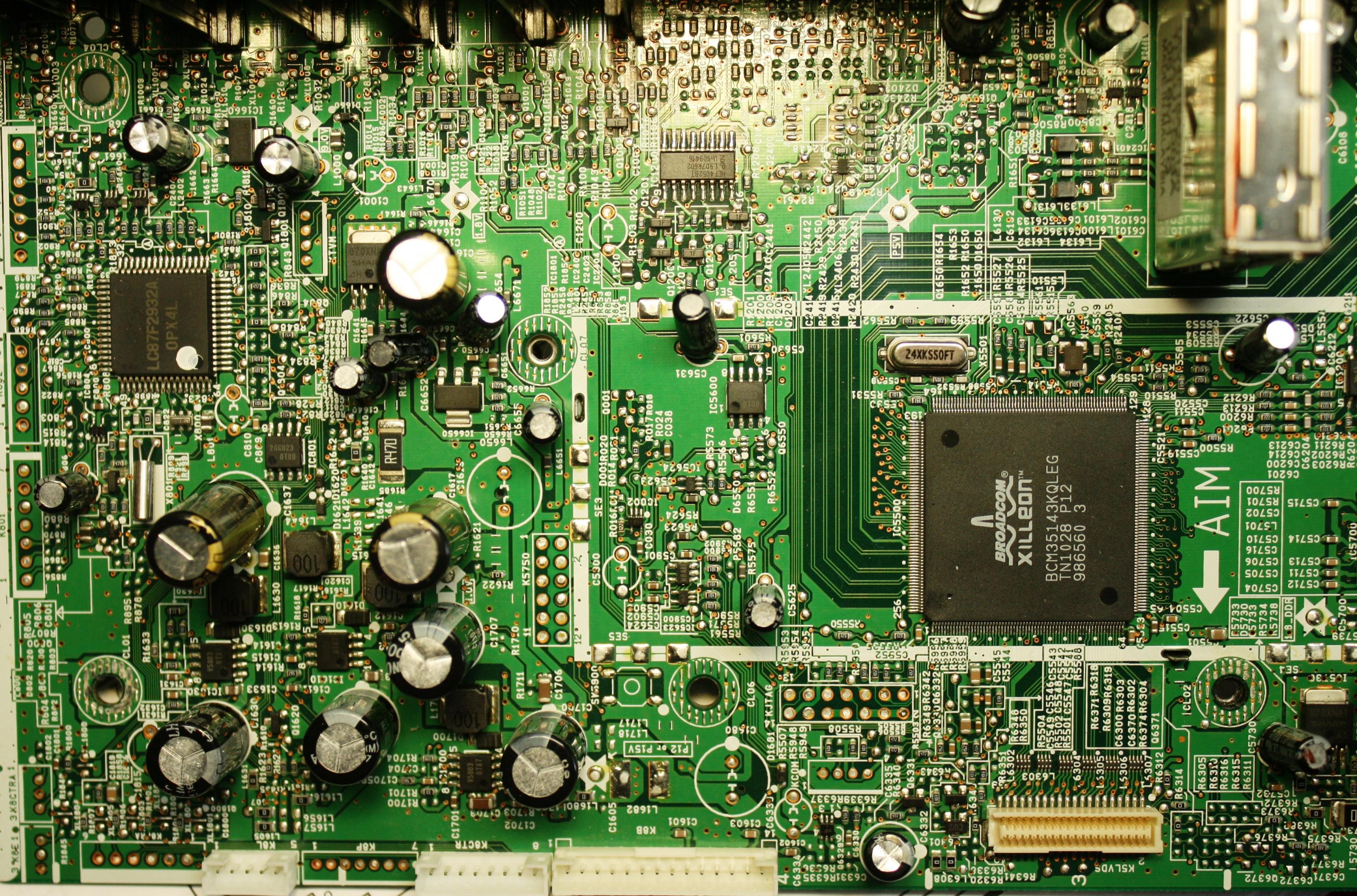

              • lilmonk3
                • Apr 2012
                • 259
                #87
                Re: Sanyo DP46840
                Here are some close ups .. White sticker is N7AM

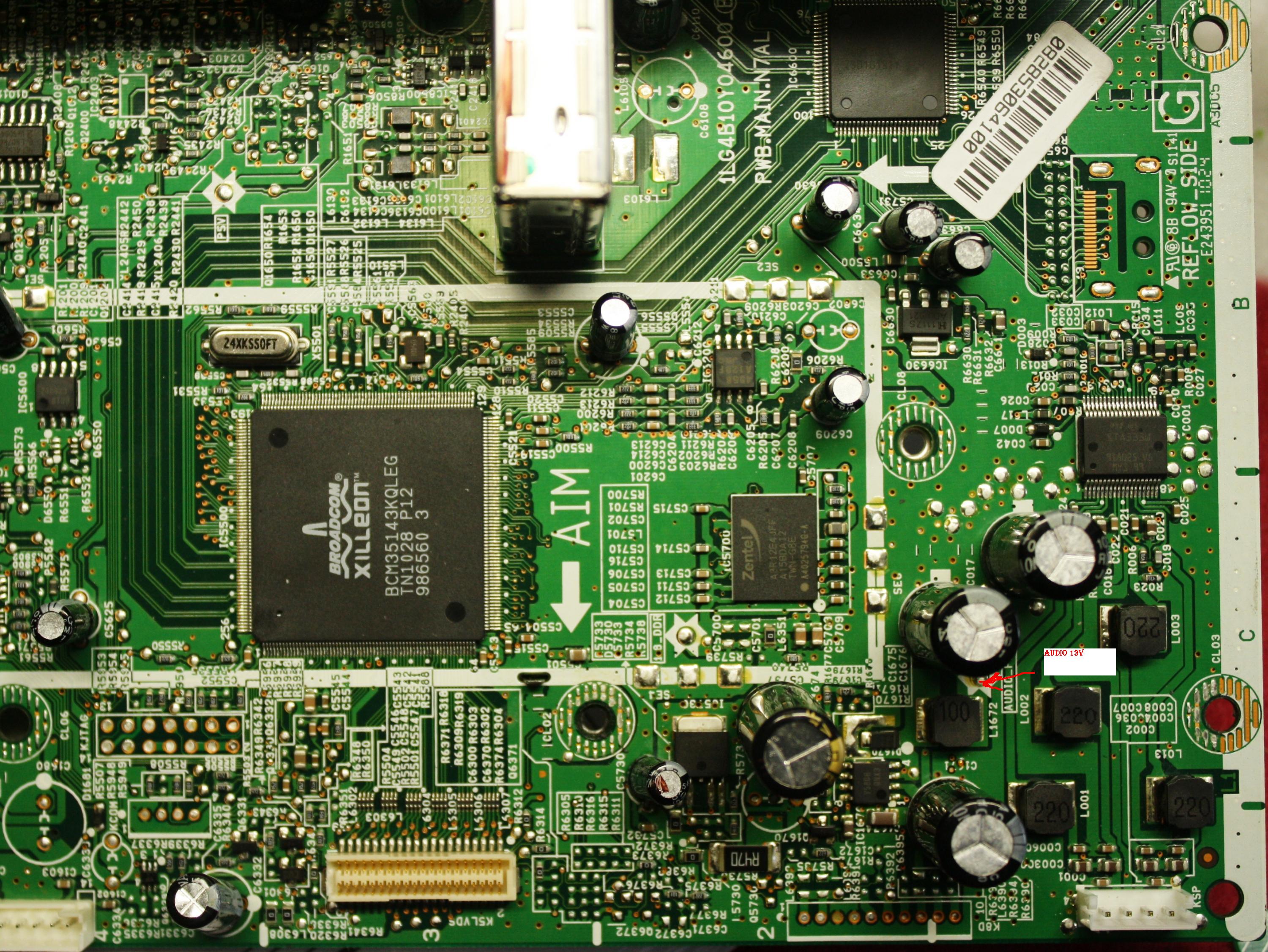

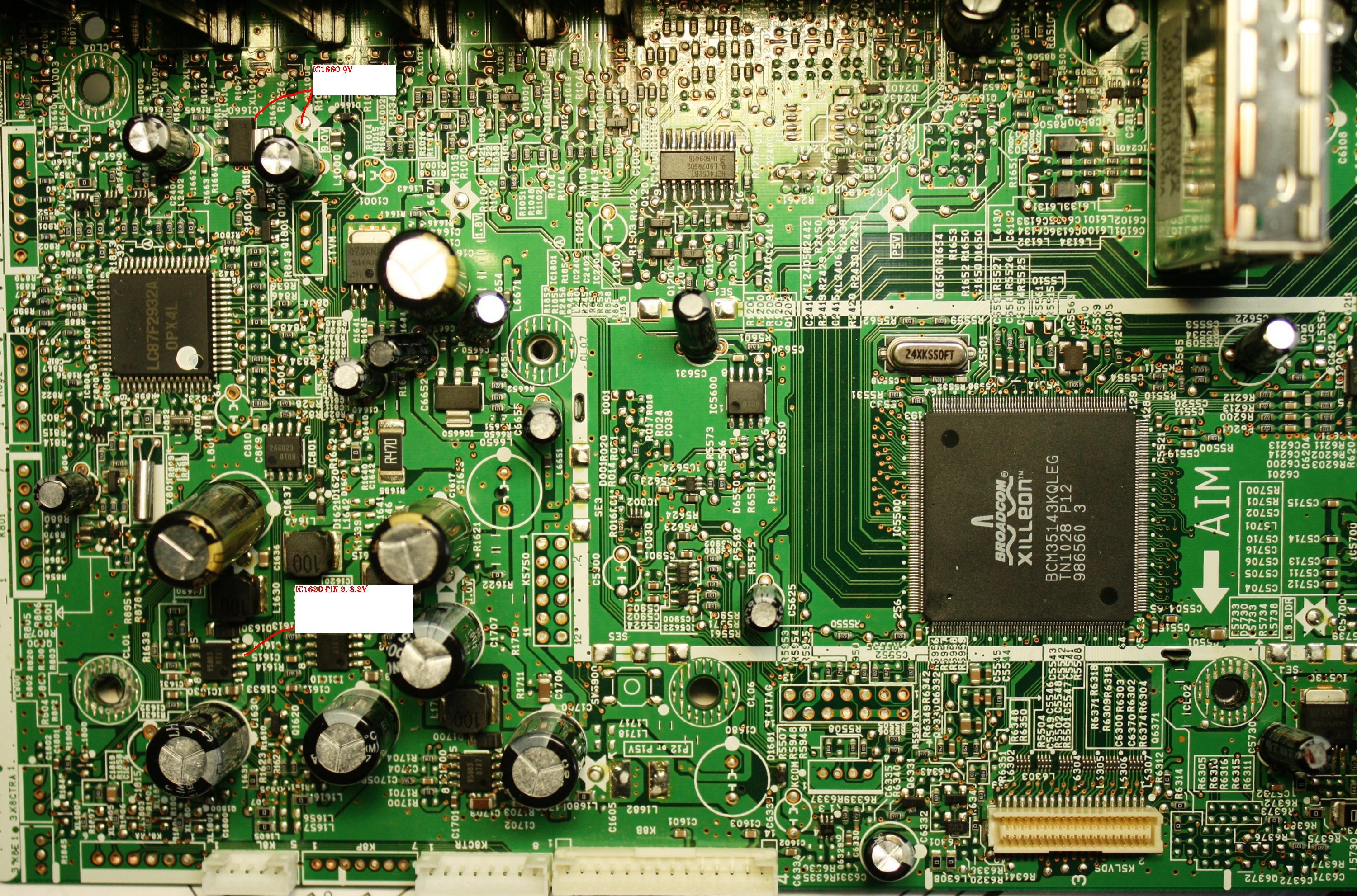

                • kevinm34232
                  • May 2012
                  • 1884
                  #88
                  Re: Sanyo DP46840
                  Here are 4 PF test points, you should see some other points as well on the board with white stars around them.
                  Be very careful not to let the red probe slip when testing. Black probe to chassis ground.
