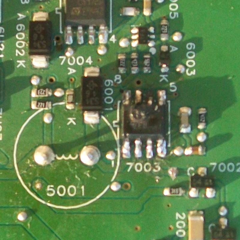

            #45
            Re: Magnovox 32MF231D
            The parts I ordered arrived yesterday, including two L5973 chips.
            Desoldering the old L5973 (at 7003) did not go smoothly.
            The pins would lift up after just 3 seconds, those were not an issue, but the chip itself would not budge, like it was glued. Prying it only served to break off little bits of it.
            I finally took a pair of cutters to it and hacked off most of the chip.
            Then put the the tip of the iron on what was left, I figured it would heat any glue still holding it.
            Guess what? It was solder, not glue. :surprised: No wonder it wouldn't budge!
            Unfortunately, the pad for pin 6 flaked off. This is the Vref pin of the IC and doesn't appear to connect to anything? See the schematic at https://www.badcaps.net/forum/attach...6&d=1335669269
            But that trace was there for a reason... it seems to connect both pin 5 (FB) pin 6, 7 and 8 to a tiny gold circle. (see photo).
            How important exactly is this Vref pin? It's a digital signal, right?
            Can I bridge the pin since the trace seems to connect them all on that side? Is it better to leave it disconnected?

                #47
                budm, I forgot to attach my photo
                I could be wrong, but seems pins 5, 6, 7 and 8 go to that little gold circle (the one by the number 5)?
                That circle probably goes through the PCB right? To another circuit on the opposite side. Or GND maybe?
                The trace also goes down to the other gold circles... and the three SMD resistors.
                EDIT: The chassis is the same, TPE1.0LA
                DOUBLE EDIT: The voltages I took before removing the IC tell a different story:
                Pin 5 (FB) = 11.5v
                Pin 6 (Vref) = 12.2v
                Pin 7 (GND) = 0.0v
                Pin 8 (Vcc) = 14.4v
                Resistors:
                562 - 23.8v
                473 - 23.8v
                So the trace is not connected? It sure looks like it though, since the dark green area criss-crosses and surrounds those four pins.
                  #48
                  I went against my better judgement, I installed the new chip leaving the Vref pin open.
                  When everything was back together, I plugged in the TV, and it turned on by itself, backlight came on, but I could not change ch/vol or menu. It was just a black screen. TV stayed about 15-20 seconds before the smell of burnt plastic filled the air, and a nice gray plume of smoke emmited from the TV.
                  The new IC is toast.
                  I think whatever killed the original one must've killed this one too, but what about that pin 6 Vref? Did my leaving it open have anything to do with this?

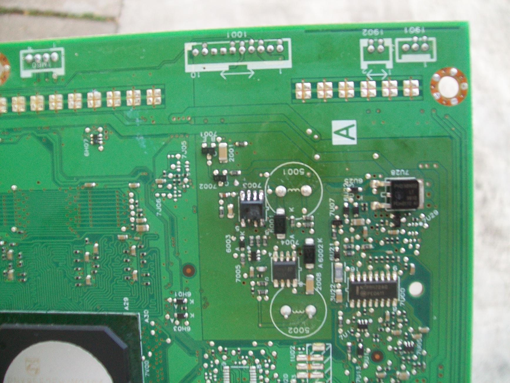

                        #51
                        budm,
                        I posted photos below.
                        The schotty diode 6001, that has low ohms both ways. It must be shorted.
                        Look at broksonic's readings, he has 11.8v at 6001. His is functioning properly.
                        Here's the IC datasheet: http://www.alldatasheet.com/datashee...ICS/L5973.html
                        The thing is, this IC is suppossed to shut off by itself when the load gets too high, right? So is something preventing that... is it really safe to use my 2nd new IC. Even if I replace that schottky, there may be more shorted components and I can end up with another toasted chip?
                        One more thing I noticed: The GND pin of the switchmode IC is always where it blows. In my first photo below, you will see the original chip, and a tiny hole near the GND pin. This appears to be a common problem for Magnavox scaler boards.
                        I have another of these scaler boards, got from eBay, listed "For Parts and Repair". The difference is it's a Rev 4 (my orignal is a rev 3, hence the the pic are labeled that way). The eBay board has a burnt IC 7003 in the same exact spot, on the chip near GND.
                        It also has trace damage, and at least one missing component (6002 schottky, the one on the 5.2Vsb circuit). The board has obviously been worked on, presumably by the seller, who gave up on it.
                        The advantage is I can use it as a source for components for the first board, and vice-versa.
                        UPDATE: Call me crazy, but I went and put my 2nd L5973 chip into the eBay scrapper. I repaired the trace on Friday and there's new diode for 6002.
                        The good news: The chip did not explode this time!
                        The bad news: The TV does not turn on at all with this board, not even a split-second flash, like I was getting with the other one. I checked both fuses and they're good.
                        Voltages for the new IC:
                        1 - 0.00v
                        2 - 0.00v
                        3 - 0.00v
                        4 - 4.82v
                        5 - 0.07v
                        6 - 0.02v
                        7 - 0.00v
                        8 - 17.3v
                        So the IC is turned OFF, hmm...
                          @broksonic,
                          I have some information that could help both of us.
                          After pouring over the service manual, I see that the 12VS chips feeds the white smd fuse labeled 1u01.
                          When you get a chance please check your board's fuse. If you click on my photo (the 2nd from the right, in my last post). And look at the top-left, there's a big green sticker labeled "M9", the fuse is directly under it. You should have 12v on one side of it.
                          From there the 12v goes into many transistors (or are they volt regulators?) and comes out as 1.2v, 3.3v and 2.5v. This is all illustrated on page 47 of the SM.
                          Also check the chips 7u03, 7u01 and 7u25. What are their voltages? I believe they are each converting the 12v into the smaller voltages that I mentioned.
                          If you get your board fixed, you can sell it on eBay to cover your losses, or better yet, make a profit.
                          @budm
                          On my board that keeps blowing 12vs chips. I was thinking about soldering a 9v battery to the pads where the IC was. Positive to pin 1, negative to GND.
                          Then take voltage measurements from the same places I mentioned above (fuse 1u01, chips, transistors...) and see if I'm getting 9v at those locations.
                          Wherever the voltage stops is where my problem component will be.
                          Is this a good idea? Could something go wrong?

                                    I've checked 6001 on the rev4 board that I got from ebay.
                                    In circuit, with diode test it's 150 on forward bias, 565 on reverse. Is this a cause for concern?
                                    Seems unusual, it should be infinity, right? So I de-soldered it, and it tests 150 on forward bias, infinity on reverse.
                                    So it must be good, but I wonder if something else in the circuit is causing the 565 reading.
                                    broksonic, please put your multimeter in diode test and check your board's 6001 schottky, is it also 150 / 565?
                                    UPDATE: I was just looking at your photos, here: https://www.badcaps.net/forum/showthread.php?t=20153#7
                                    Click the first one, and zoom into the upper left corner, there's an 8-pin smps IC, and just above that a SOT-23 transistor labeled 7P16.
                                    I want you to check that transistor, there's a mark on it that look suspicious, like a hole or a tiny gash.
                                    Use the Ohm setting on your multimuter, check all 3 pin combinations, (1-2, 1-3, 2-3). The side with one pin, is pin 1 (aka base pin of the transistor). The numbers go clockwise.

                                      OK everyone,
                                      While we wait for broksonic to reply, I really need help figuring out my rev4 scaler board. It seems like a better candidate for repair since the IC I put into it did not explode
                                      This will be the first time I post pictures of the rev 4 board.
                                      I hope some people will take a look and let me know if anything looks suspicious.
                                      To summarize what has happened with this board:
                                      When it arrived, I could tell it had been worked on by someone even more novice than me. The 6002 schottky diode was missing, luckily the solder pads are intact.
                                      The SMD resistor at 3u22 was yanked off, probably with pliers? Leaving a missing pad and trace damage.
                                      I got a new diode, exact match (from Digikey) also got a 10 Ohm resistor. Repaired the trace by soldering a small red wire to the trace and new resistor. (see photo)
                                      Note: The resistor is not an exact match, the SM describes
                                      3u22 as a fusible 10 ohm resistor, made by Vishay.
                                      After an hour of searching all I could find was a normal 10
                                      ohm resistor by Panasonic. The wattage is the same though.
                                      Does it really matter if it's fusible or not?
                                      I replaced 7003, the 12VS smps IC. (remember I ordered 2 from DK)
                                      1 - 0.00v
                                      2 - 0.00v
                                      3 - 0.00v
                                      4 - 4.82v
                                      5 - 0.07v
                                      6 - 0.02v
                                      7 - 0.00v
                                      8 - 17.3v
                                      More observations: I see a couple of crooked components,
                                      I circled them in red in the photos.
                                      One's a white smd (resistor??) the others a blue smd
                                      inductor with 330 printed on top.
                                      I guess the dude tried to pull those out too? What are they?
                                      Last edited by TechShui; 05-12-2012, 02:31 PM. Reason: Had to resize pics, re-upload
                                        #59
                                        Hmm - not easy- will look closer tomorrow.
                                        If you get it working you should replace resistor with a fusible one - it, as name implies acts as a fuse.
                                        Assume you are happy the trace went off in the opposite direction to what one might have expected?
                                        What is at 8510 and 8511 solder on 8511 looks odd.
                                        Dont know what the white block is- probably best you can do is to check it for resistance and see if the one on your other board is the same - and I think I see one other like it- you could check that also.
                                        Blue barrel Inductor - they seldom go wrong just make sure it is soldered down. On that same picture is that a fuse - bottom right corner white block with gold ends possibly 1U01 perhaps a T 3amp
                                        Also bottom left corner up from the 4 pin connector there is a green thing with F75? on it which suggests it is a fuse.
                                        Are these the same two you mention.
                                          #60
                                          Hmm, I wonder what happened to broksonic?
                                          Yes, that's where the trace leads.
                                          Those are the solder joint of the L-shaped heatsink in the upper right corner of the board. (above the tuner).
                                          Yes, those are the two fuses I checked. I've re-soldered the white block now too.
                                          Did you download the service manual from my link? I'm guessing whatever is preventing the board from starting is somewhere near the IC at 7003.
                                          I tested the schottky 6001 out of circuit, it's still 150 on forward, but infinity on reverse, so it's good. 6002 is, of course, also good, since that's the one I ordered from DigiKey.
                                          I starting checking those tiny SMD resistors near 6002
                                          These resistors connect to pin 5 of the 7003 IC.
                                          408 = 2.77k Ohms
                                          273 = 3.4k Ohms
                                          221 = 220 Ohms
                                          According to what I know about resistor labels, the last digit is the number of zeros. From this we can determine 221 is spot on...
                                          273 however should be 27k, NOT 3.4k.
                                          And what about 408? That's a VERY unusual ohm rating... 4,000 Mega ohms, seriously? Perhaps I'm imagining the line in the last digit, and it's actually 400 (i.e. 40 Ohms) but that's also unusual. 40 Ohms is so low.
                                          Yes, I did use a magnifying lens, there are not a lot of numbers that look like zero, so it has to be a zero or an eight, maybe an R, but I don't think so.
                                          The photo I posted has pretty good resolution, you could look at the resistor and make your best guess as to the marking.
                                          In any case 2.77k Ohms is not consisting with the marking. Does this mean these two resistors are bad? Or they're being affected by each other and gives off reading? I don't think removing them for further is an option for me. The lamination on this board peels easily, and I don't want to risk damaging another trace.
