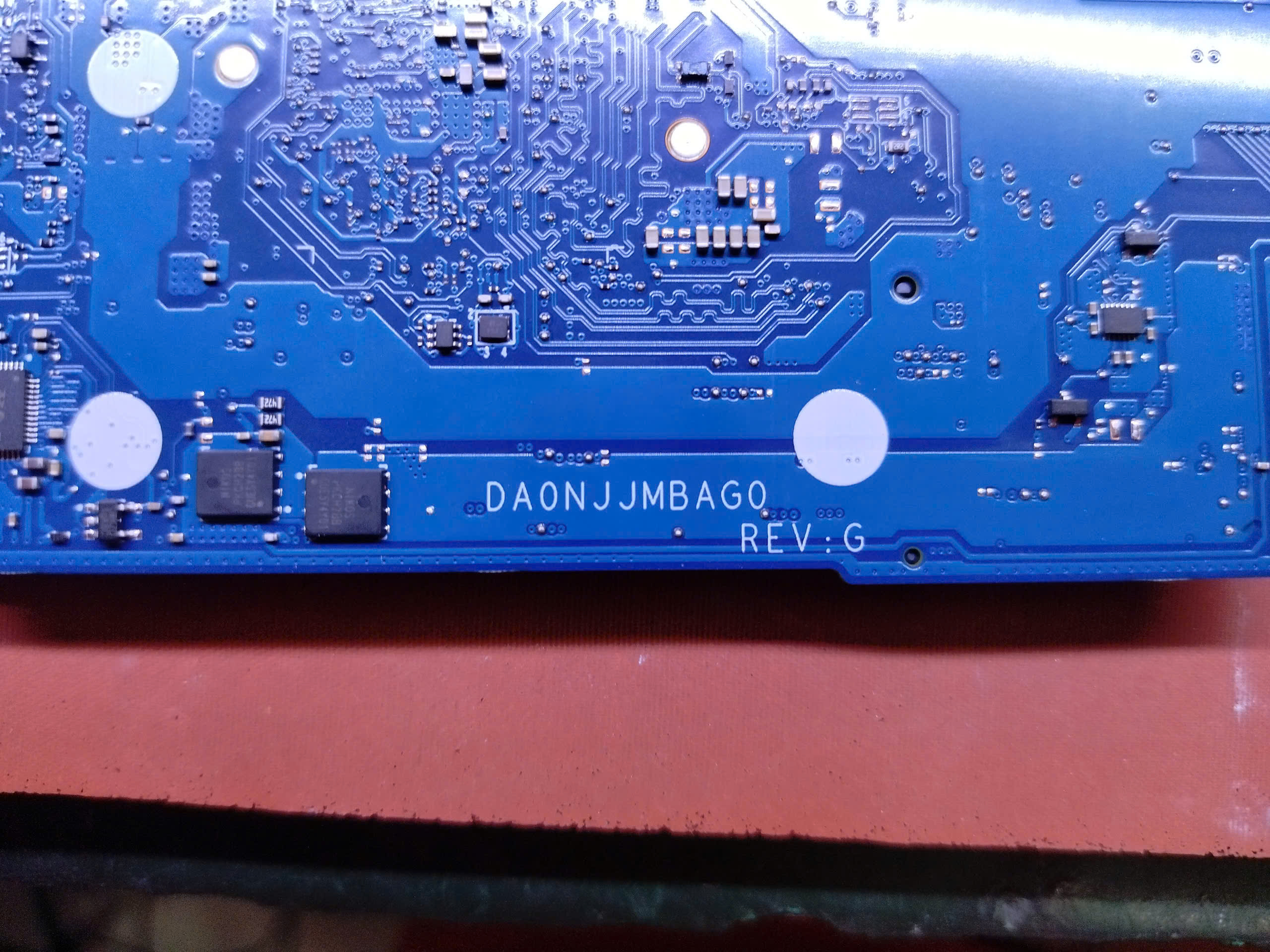

    Laptop motherboard DA0NJJMBAG0
    PROBLEM-WHEN I PLUG THE CHARGER WITHOUT BATTERY THE CHARGING LIGHT BLINKS AND WHEN I PRESS POWER BUTTON THE CHARGING LIGHT STOPS BLINKING AND STAYS ON BUT THE POWER LIGHT DOESNT TURN ON AND LAPTOP ALSO DOESNT TURN ON NO FAN SPINS NO KEYBOARD LIGHT.
    CHECKED- ON S5 STATE TGE LAPTOP HAS 5V ON USB 3.3V BUT I DIDNT GET 1.8VOLTS ON BIOS PIN NO 8 WHILE PLUGGED IN AND EVEN ON S5 STATE.
    GUIDE ME WITH THE PROBLEM..
    SUMMARY-
    1.NO 1.8VOLTS ON BIOS PIN NO 8.
    2.S5 STATE ((PRESSING POWER BUTTON)))VOLTAGES ARE PRESENT LIKE 3.3V,5V.​

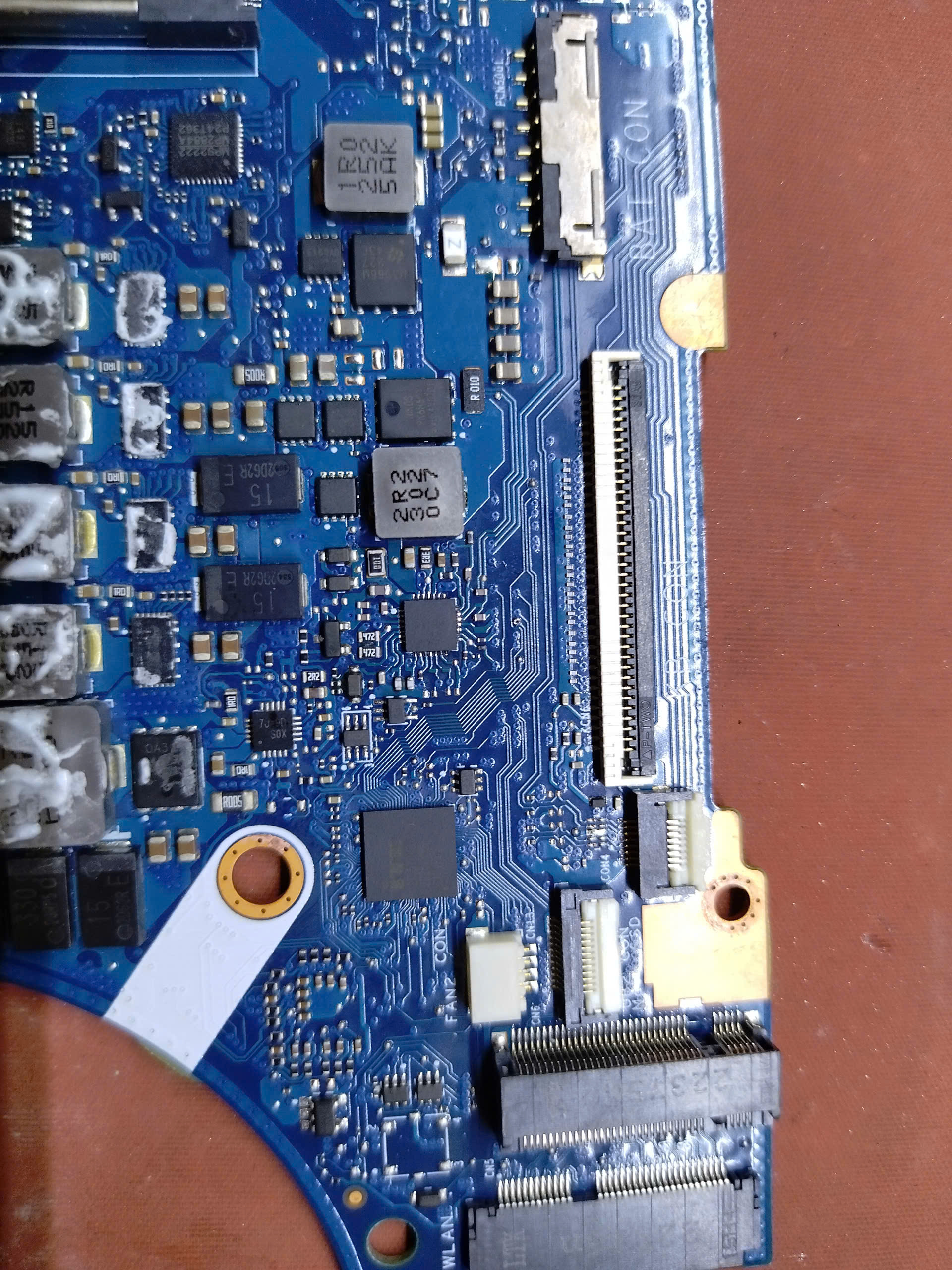

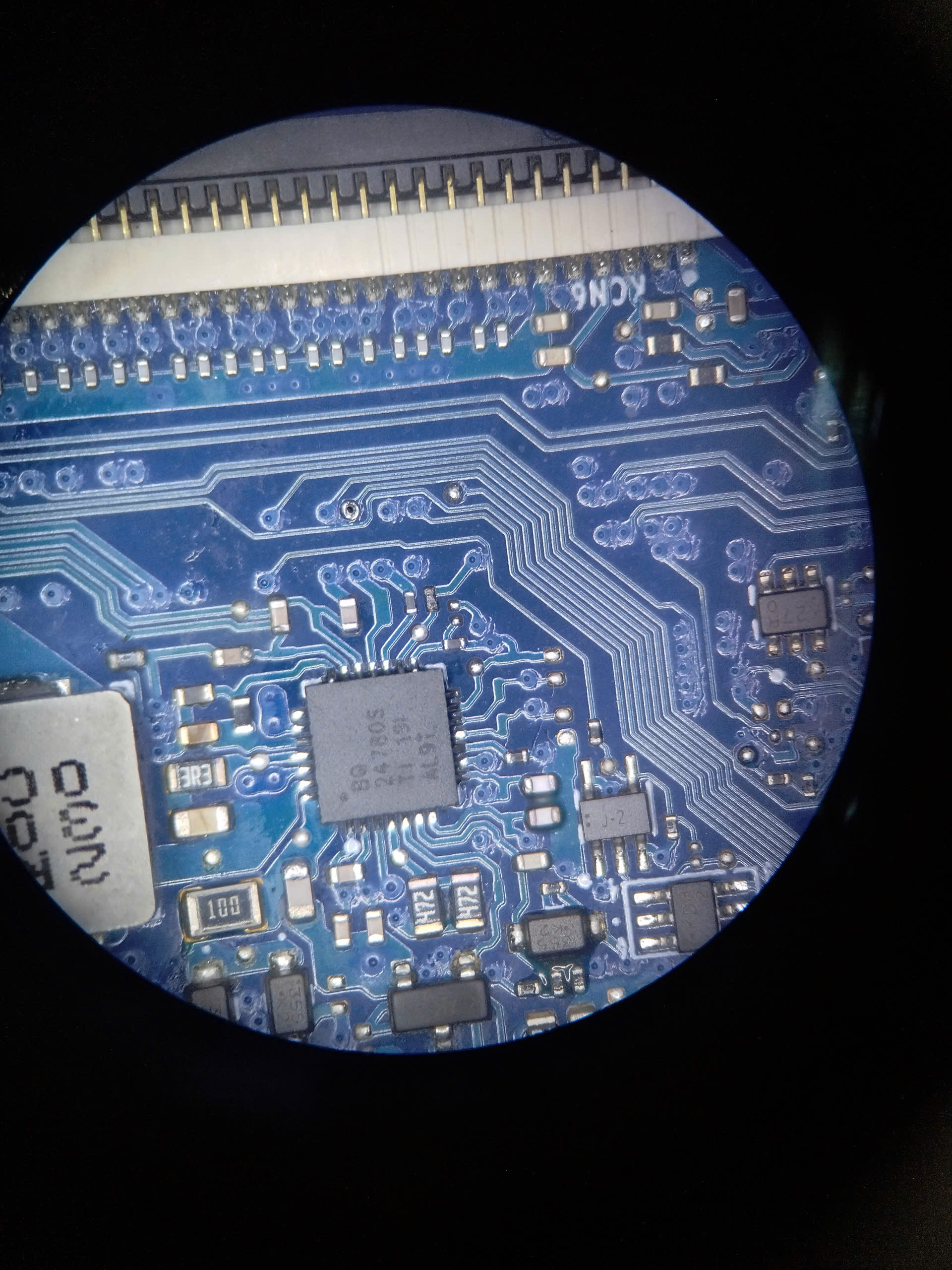

                                  • xana
                                    • Aug 2022
                                    • Can Tho
                                    Hi everyone, can someone give me a picture of this area on the main? thanks
