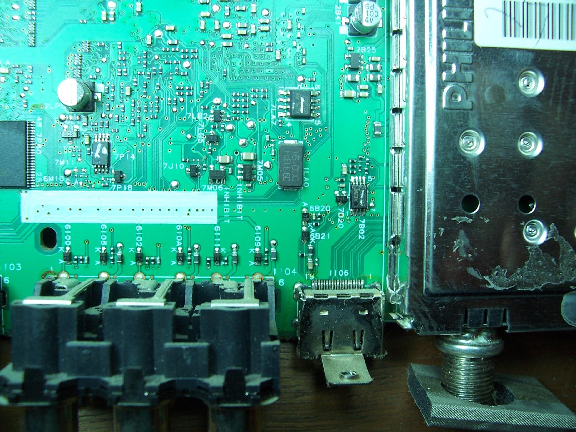

          Re: Magnovox 32MF231D
          Hi - Photos are quite good thanks- please can you do the backs of the boards and name them as you have the fronts.
          Also can you do a close up In picture 1 of 7802 Black rectangle with 8 legs bottom right corner near the silver box ( Tuner Box)
          Also at the top of the board there is a green item with F73 on it can you do a close up of it. I would also like you to do a resistance test. Set your meter on ohms and touch the
          probes together and note the result. Now put a probe on each end of the green item and advise the result. For this you just need the board on it own and not powered.

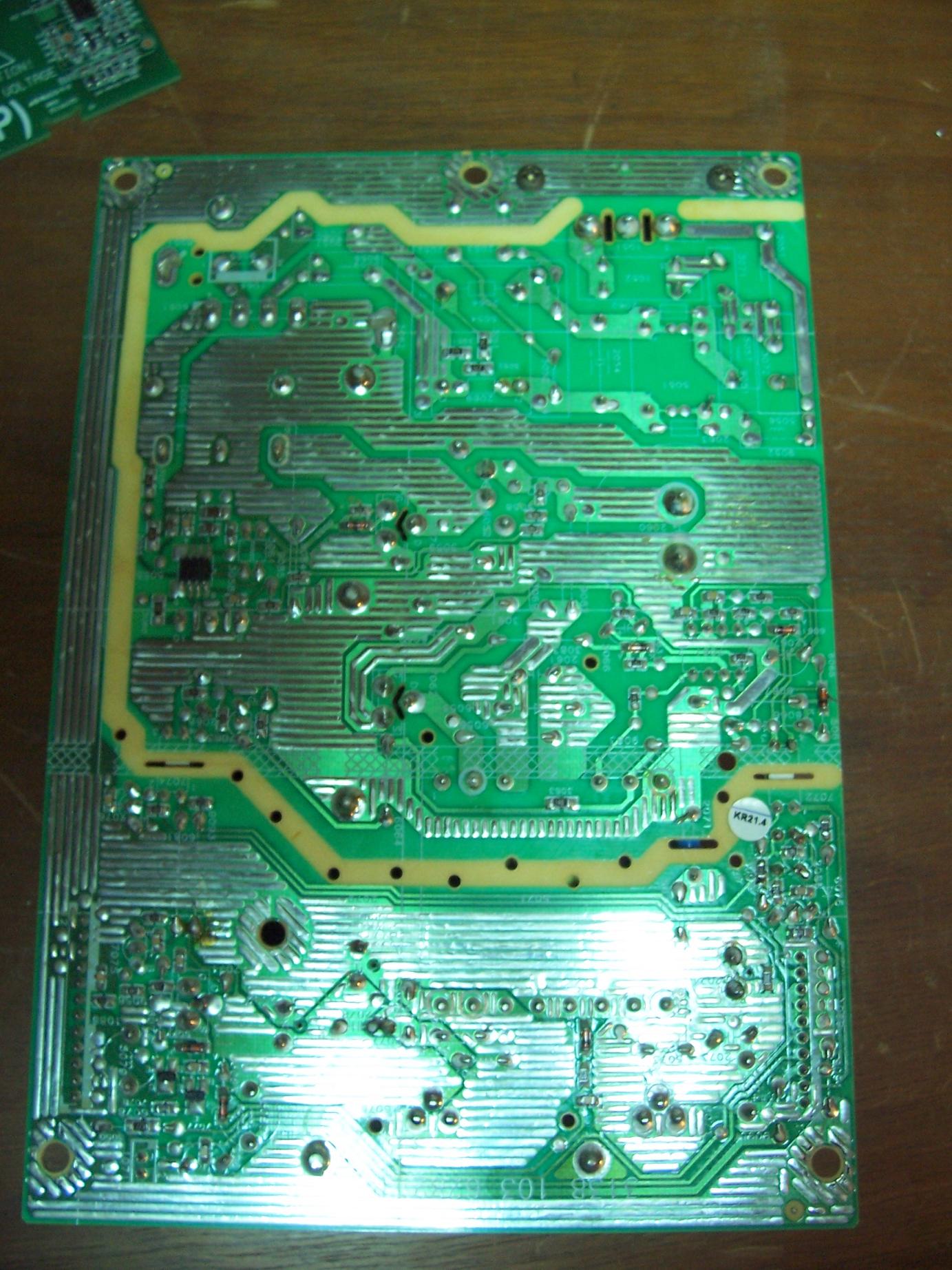

              Ok, as per request...
              Back of boards, chip 7B02, and F73 chip.
              I checked the back of the boards but didnt see anything.
              I tried to check the resistance on F73 chip.. DMM started at -1 and continued dropping. It never leveled off and i pulled the probes at -1.80.
              I included a picture of what i had my DMM set at (which could be wrong as i have never tried to test resistance)

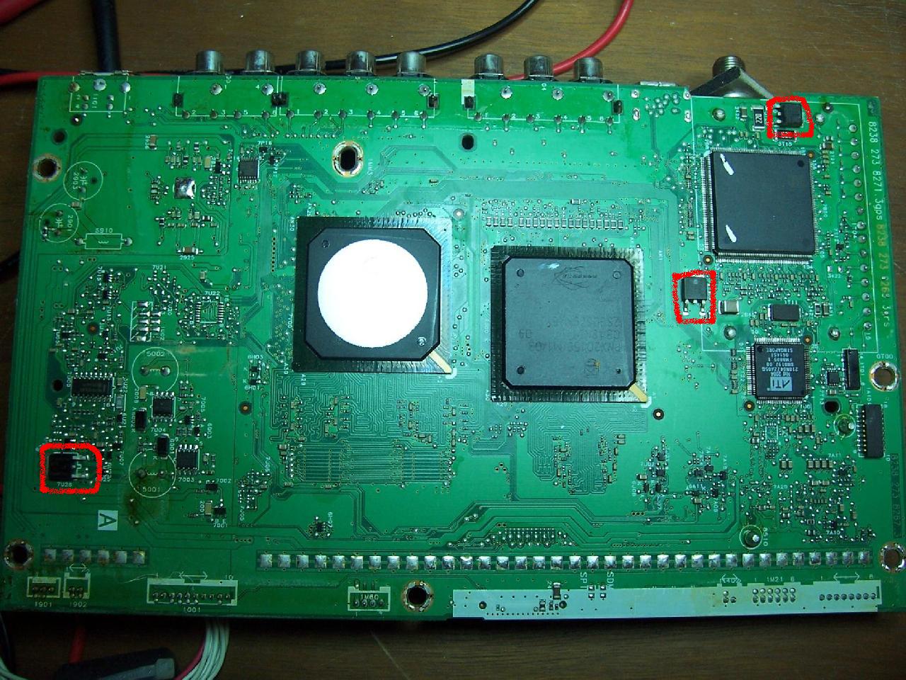

                  There are 3 voltage regulators on the back of the main board. I circled them in red.
                  The following will require the TV to be plugged in with power on. DO NOT touch anything on the power board or any of the heatsinks.
                  1) Put your multimeter to 20V DC (press AC/DC button until it shows DC).
                  2) Put your black probe on a main board ground screw. Leave it there for all measurements.
                  3) Put your red probe on each pin (ignore the top fat tab). Measure the "cut" or middle pin as well.
                  4) For each regulator you should have 3 readings. Report them like this.
                  Regulator 7710
                  part number 1084-33
                  pin 1 = 0.00
                  pin 2 = 3.3
                  pin 3 = 5.0
                  5) Note if the readings are steady or fluctuating.
                  Note: I don't know if this board will be "upside down" or not when you take the voltage measurements. If it is, use cardboard for separation so it doesn't touch any other board.

                                Ok, New DMM purchased (see pic).
                                With the new DMM set at 200 ohm the F75 (fuse) showed a .07
                                The 3 voltage regulators (refer to picture) are as follows..
                                DMM set at 20V DC
                                7T10 pin 3 (top one in picture) 12.03
                                pin 2 - 5.01
                                pin 1 - 0.00
                                7B45 pin 1 (right side in picture) 5.15
                                pin 2 - 3.30
                                pin 3 - 0.00
                                7U28 pin 1 (bottom one in picture) 4.12
                                pin 2 - 3.26
                                pin 3 - 2.60
                                Only flux i seen was when the lights flashed (refer to 1st post in thread)
                                Wasnt sure about the part numbers. If they are stamped on the top of the regulators i couldnt really read them (@49yrs old my eyes are not the greatest anymore) have to get a stronger magnifying glass.
                                Also noticed a change in the lights flashing. (refer to 1st post again)
                                Now when plugged in front power light comes on as well as the scaler board green light, the master backlight inverter boards red light flashes once.
                                Both green lights stay on for about 25 seconds then flash off and the red backlight flashes 2 long flashes.
                                Green lights come back on for about another 35 seconds and flash off while red backlight flashes1 long 2 short.
                                Green lights come back on for about another 30 seconds and system powers off.
                                Power switch on front will now turn set back on (wouldnt before), and the flashing will repeat.

                                    Two things to check on the board in pics 1 and 4.
                                    On the underside left hand side bottom there is a 5001 looks like a cold solder on pin?
                                    Also the area is stained - can you look at closely and see if you can see why?
                                    On the other side - pic 4 top right ah-ha its actually near 5001 inductor again! there is a small white box what does it say on it . I think it may be another fuse could be that F88 sticker is telling us something. Please test as with other fuse.
                                    Please also look at the soldering on cap 2002 - probably just shadow but looks odd.

                                      Can you take "macro" photos of them and post, sometimes easier to see that way.
                                      Not sure which # on the chip is the part #, but here is what is on the chips
                                      7U28
                                      PHD38N02
                                      LT
                                      PEm0610 A1
                                      7B45
                                      L1117
                                      33
                                      GK1S0613
                                      7T10
                                      L1117
                                      50
                                      GK1LJ610
