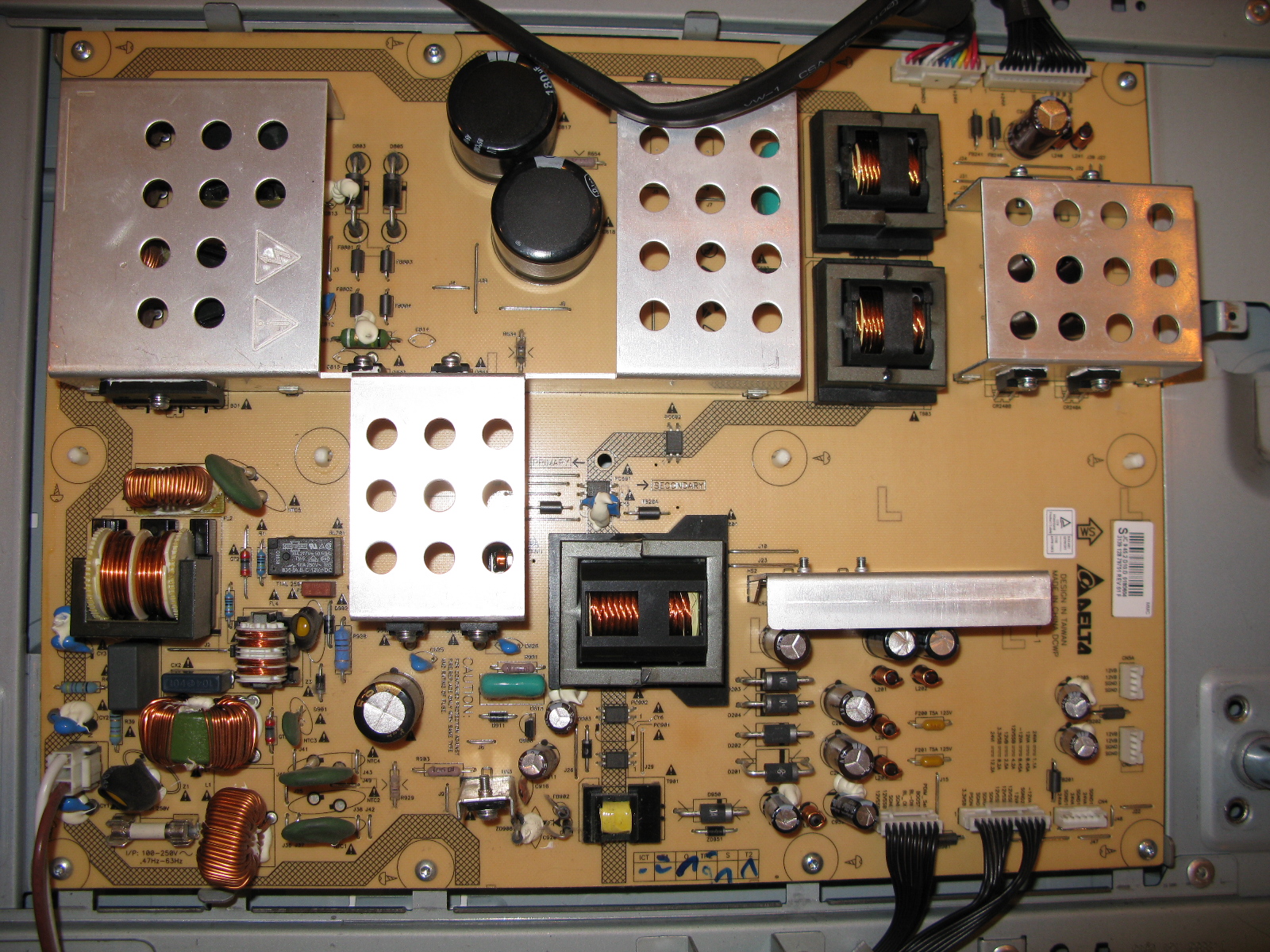

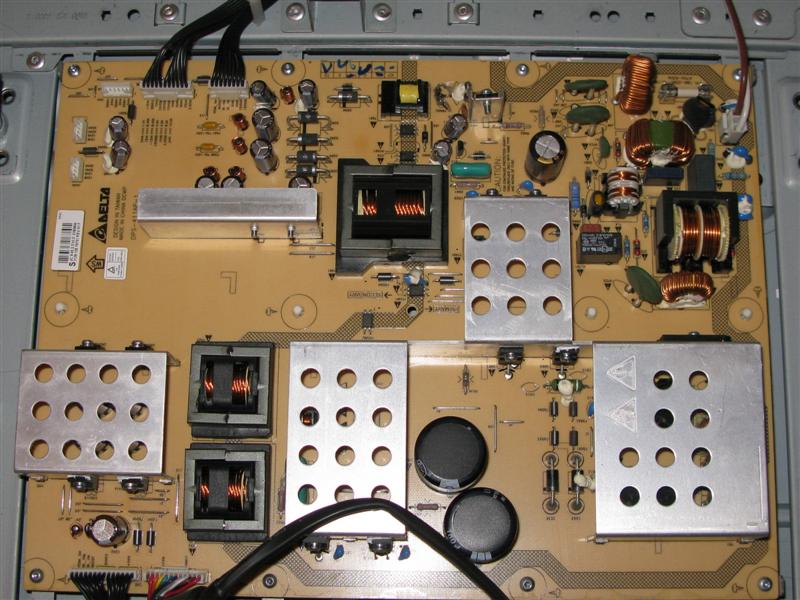

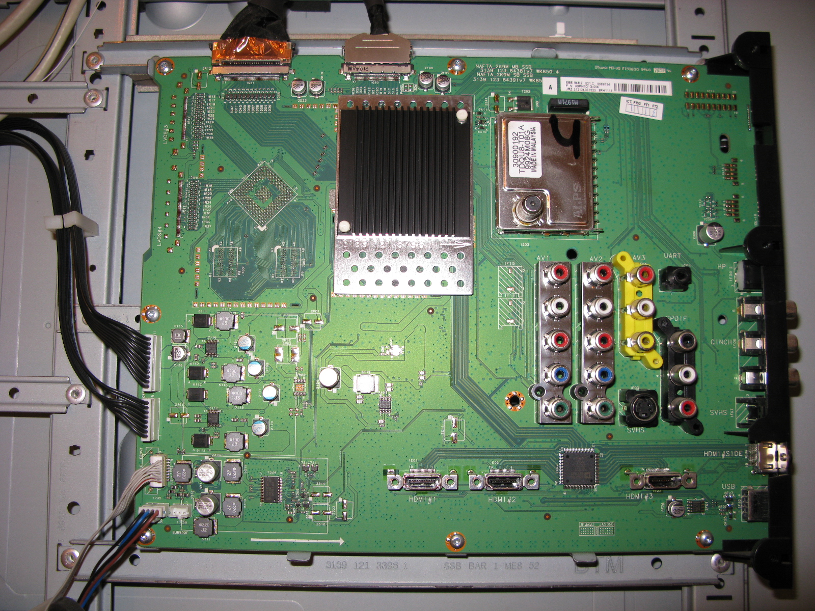

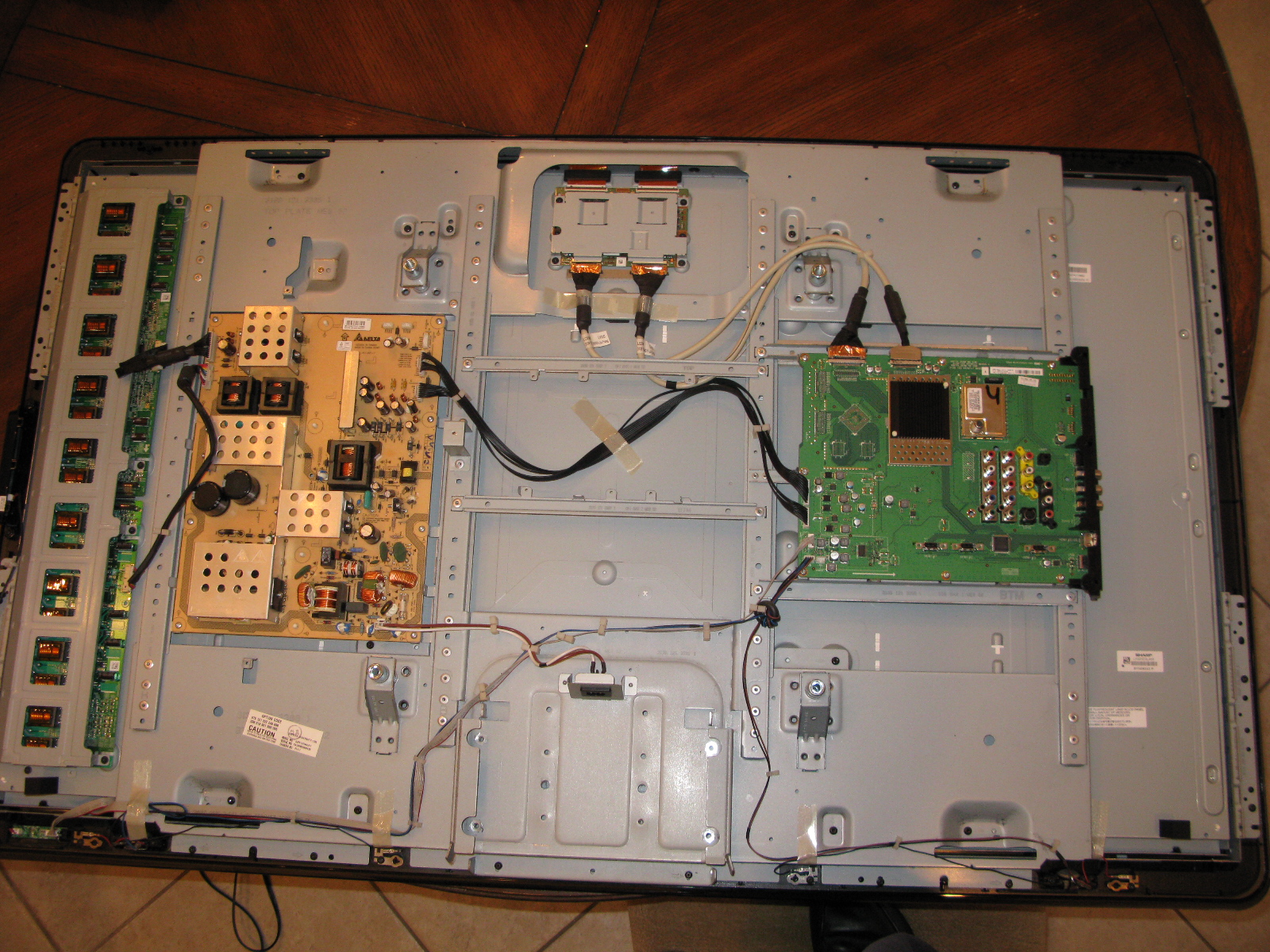

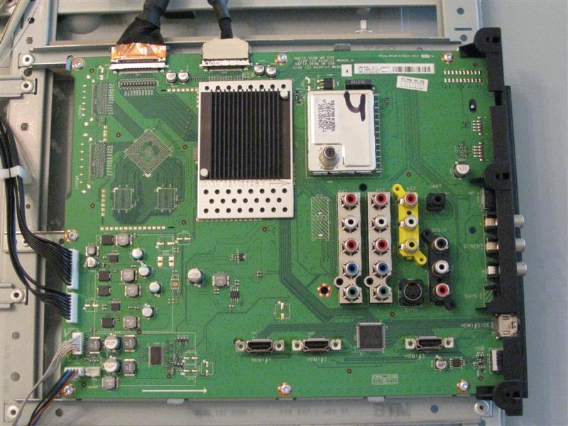

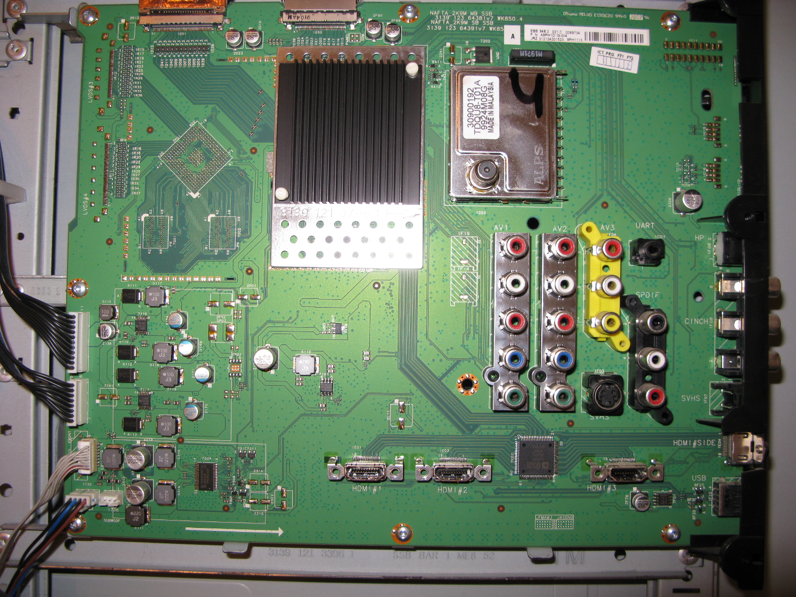

    First thing, thanks for any help you can give. I have a Philips 52PFL5704D/F7 that clicks when the power cord is plugged in and has no other indication of power getting to the unit (no LEDs, etc.). The set is about 2 years old, has not led a hard life (only on 5 or 6 hours a day) and just did not power up one day. The manual ON/OFF switch does not do anything and the remote does not also. I downloaded what appears to be the relevant the service manual from the Elektrotanya.com site (It shows 52PFL3704d, but the boards in their pictures look identical to me…). Got the back off and I do not see anything out of order. All the caps look pristine, as do the chips. The SM says to check the 3.3V from the power supply at various points ending up at Pin 1 of the 1101 connector, which I did and it reads 3.4+ volts. Almost looks like the 3.3V is running unloaded. The SM says to replace the SSB if the 3.3V is there, the 3.3V is on the IR module, the ON/OFF switch is good and the set does not power up. As more info, I checked the various voltages at the power supply and they are all in the millivolt range except for the 12V supplies which are about .6 V. I have included pics of the boards including close-ups of the labeling of the boards and the set itself.
    Any thoughts? Do you think it really is the SSB and what is the worst case $$ to replace that? (It has a BIG FPGA on there and there is no way in heck I could replace that!! Discrete parts, yes….)

    Hi - Nice intro and good try with the pics. They are not really detailed enough when enlarged we cannot see clear enough - the ones of the boards need to be as near to 2mb as you can get and one of the total layout of the back of the set would be good.
    Please can you post the link to the service manual so we can all look at the same one.
    What is SSB - first time please put in full.

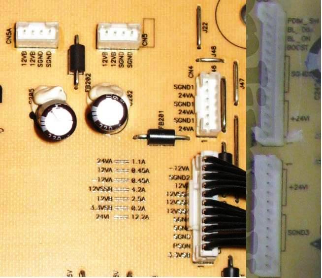

        When you plug it in you should test the DC voltages on 3.3, 12v and psOn. You want to have the black probe to a peice of metal on the frame of the tv or a screw that is holding the board down.
        You said you get 3.4 (that is perfectly fine, they almost never are 3.33000 or something perfect.
        psOn should be 0v till you press the power button, then tell use what voltage you see when the power button is pressed.
        And remeasure 12v if you werent using the right ground the first time.
        You might also want to attach a closer picture of the black power wires leaving the power supply, as i can barely read what the labels are.

          Pictures are great - thankyou- labelling is particularly small. At some point you will have to take the boards off the frame and do similar pics of the backs of the board.
          That time could be soon. I think you have tested the glass fuse although as you have voltage it must be ok. However there is a small red box at the left hand side of the heatsink with 9 holes. This is another fuse and should be tested.

            Re-checked the 12V. They are indeed .6V with reference to the metal chassis structure. PSON is 0.0V and stays that way even when the power button is pushed. Took a pic of the board and the black wires. Getting the power supply board off to see the back side and check the red fuse will have to be tomorrow evening. 0500 comes early after a day of honey-dos....

                Here is the service for this chassis PL9.1:

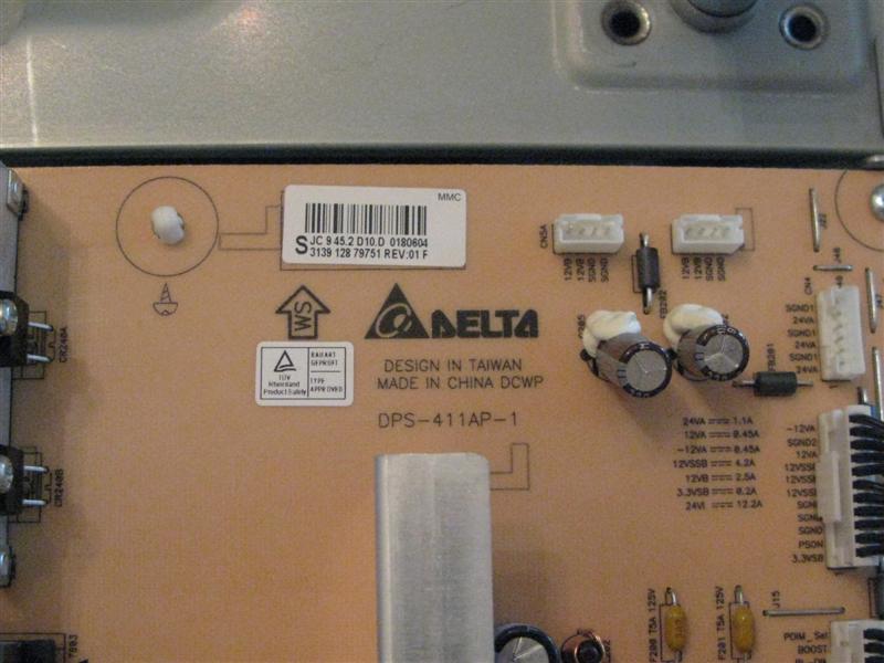

                I would like to see the closed up pictures of the connectors on the power supply board so I can see how they are labeled.

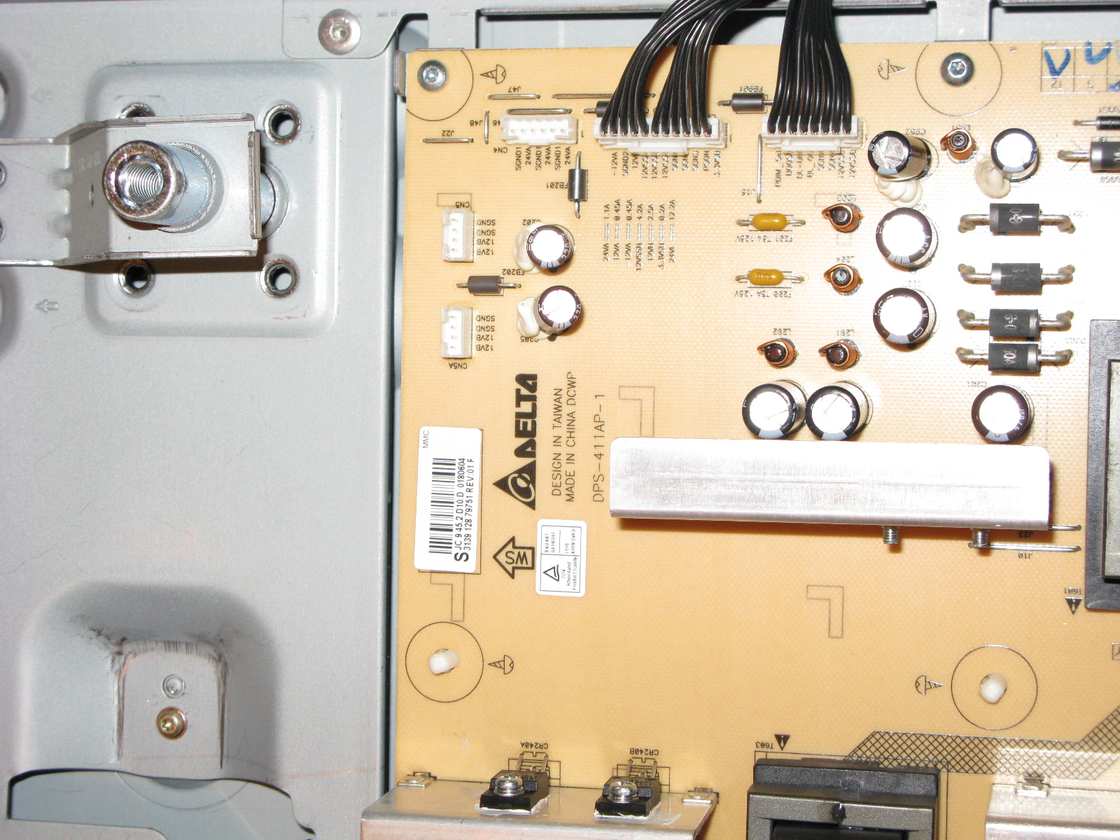

                  I have re done connectors pic and added in the other two connectors
                  from a pic of this board on a website.
                    Re: 52PFL5704D/F7 dead except for click when power cord attached...
                    Those orange bead/cylinder objects on your second last photo - they are fuses. Check both with your multimeter on the 200 ohm range. With power unplugged, measure from one side to the other. You should see close to zero. When your meter probes are not touching, it will probably show a single "1"; this does not indicate 1 ohm but a resistance in excess of 200 ohms.
                        Both show close to zero. Time to pull the board off and measure the red fuse....

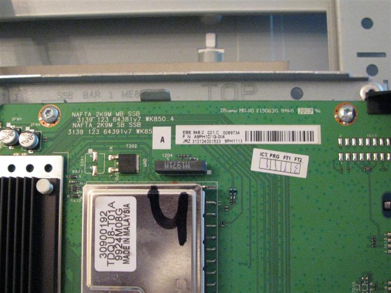

                            Interesting contradiction here. The PL9 schematic posted above shows that it applies to the 52PFL5704D/F7, but the photos, cable designators and the troubleshooting info does not match. The one noted as applying to the 3704 appears to be a much better match.
                            In any case, I did get some pictures of the underside of teh power supply board, not very good ones I am afraid. The green is playing heck with my autofocus and I can't seem to do much better in manual focus. Just not enough light. I will play with putting a couple of desk lamps on the board later tonight. I will also take the SSB loose and get some pics of it. I did check the red box part and it shows zero ohms.
                            Sounds like I might be in for a SSB replacement....
