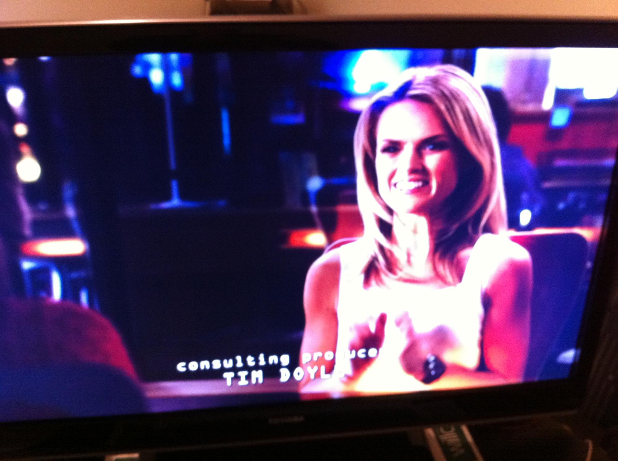

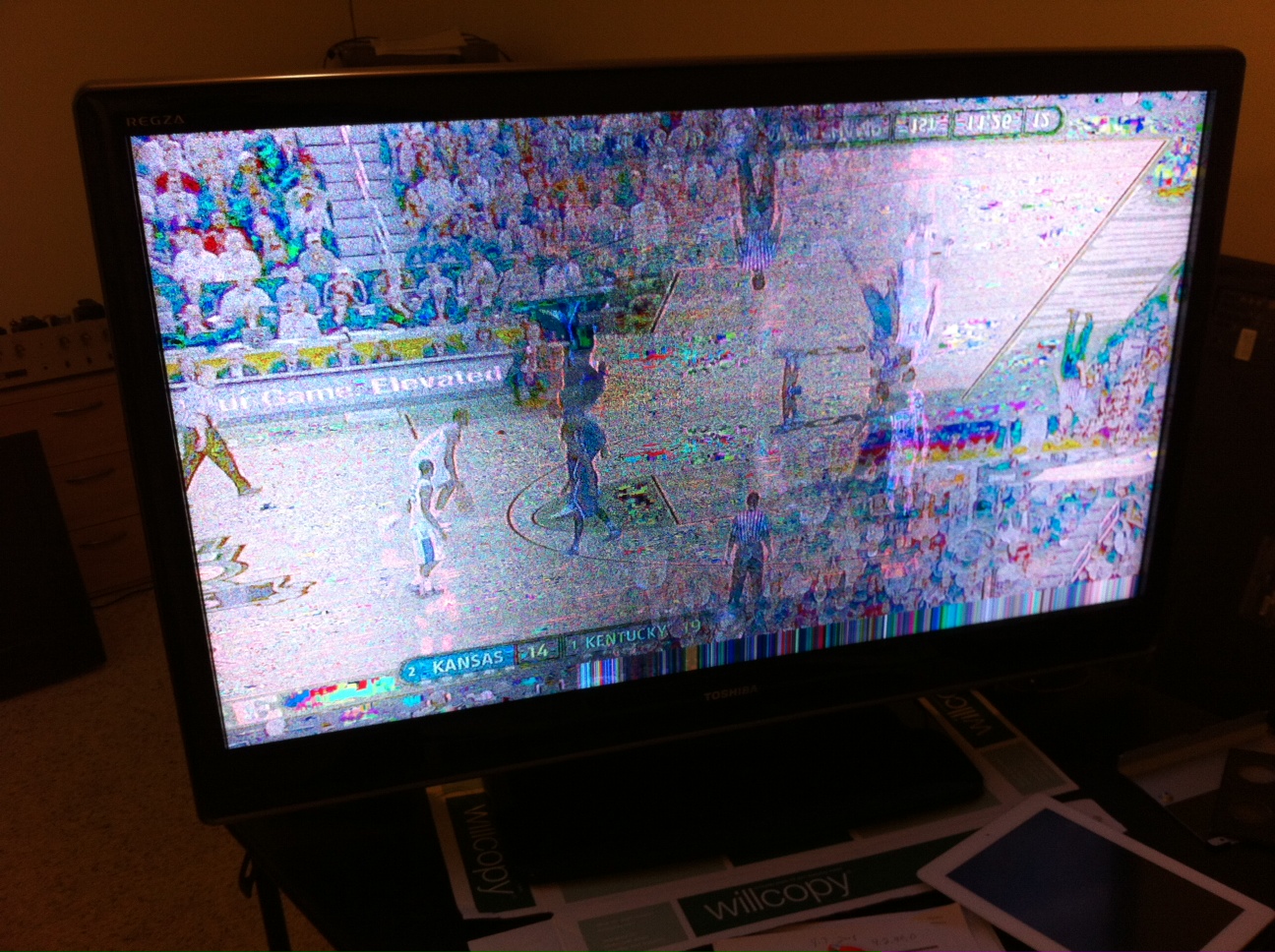

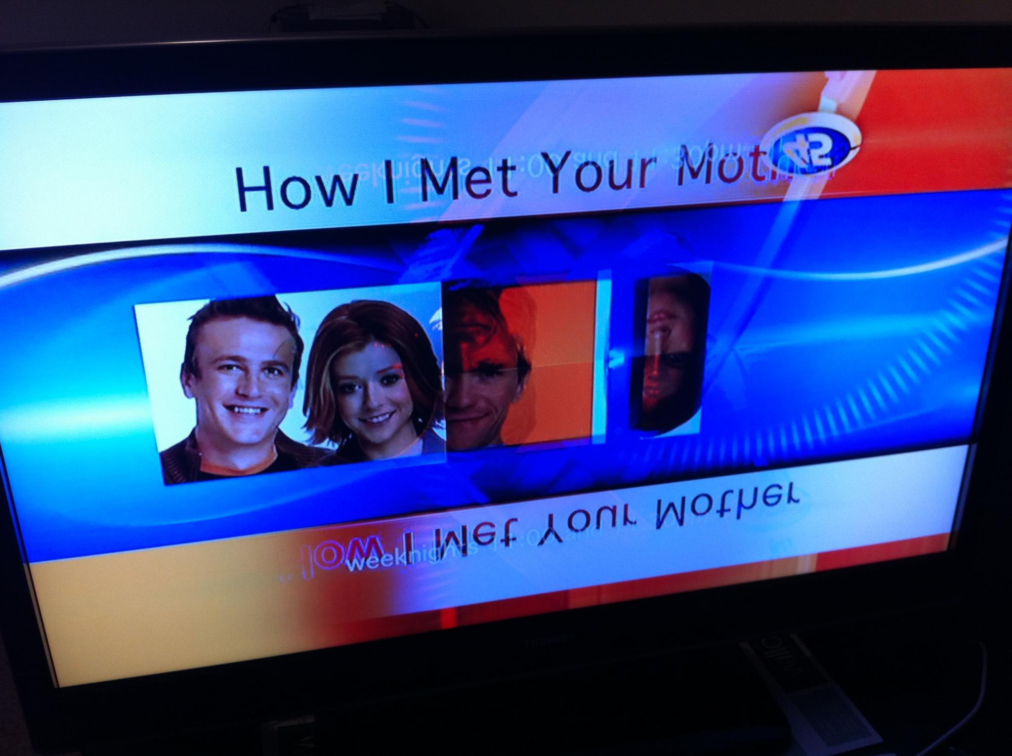

I finally got this unit to display a picture. I bought a used main board from an auction site. I've checked all power supply voltages and found them to be correct. I've also tried a different T-con board, But the picture still looks like this. I'm still thinking the main board is at fault. The picture also has a mirror effect, Like its taking the bottom of the screen and inverting it to the top. I would like to know what commonly fails on the mainboard and replace that particular component . Any help or ideas would be greatly appreciated.

Do you have a bigger picture of the problem? It looks like a failed memory IC, does it affect the OSD/interface too?
If the board you bought wasn't taken from the same model, or the model it was taken from used a different LCD panel, it's possible it needs to be reconfigured using the service menu, if available.Last edited by tom66; 04-03-2012, 08:27 AM.Please do not PM me with questions! Questions via PM will not be answered. Post on the forums instead!

All inputs do the same thing. The menu displays funny as well. When I checked the firmware version it said - 4.2.40.0. Xv540u 4-7-2008. Is that model listed the problem? How would I reconfigure it? Thanks for the help!Comment

That model number certainly could be causing the problem.
To enter service mode:
Set volume using RC to zero.
Press MUTE twice then release it.
Hold MUTE down.
While holding MUTE press MENU.
Important information from manual - probably relevant to your problem: "Whenever using new MAIN PC board to the set, set the SET-ID data according to panel option data."

Thanks Tom66! I followed the service manual to get the parameters set. The tv came to life for about fifteen minutes then started to do funny things again. The picture is no longer fuzzy though. Still getting the inverted image. I checked voltages on the power supply, They are all correct while unit is powered up. Any idea what component may be failing on the main board?Please do not PM me with questions! Questions via PM will not be answered. Post on the forums instead!
