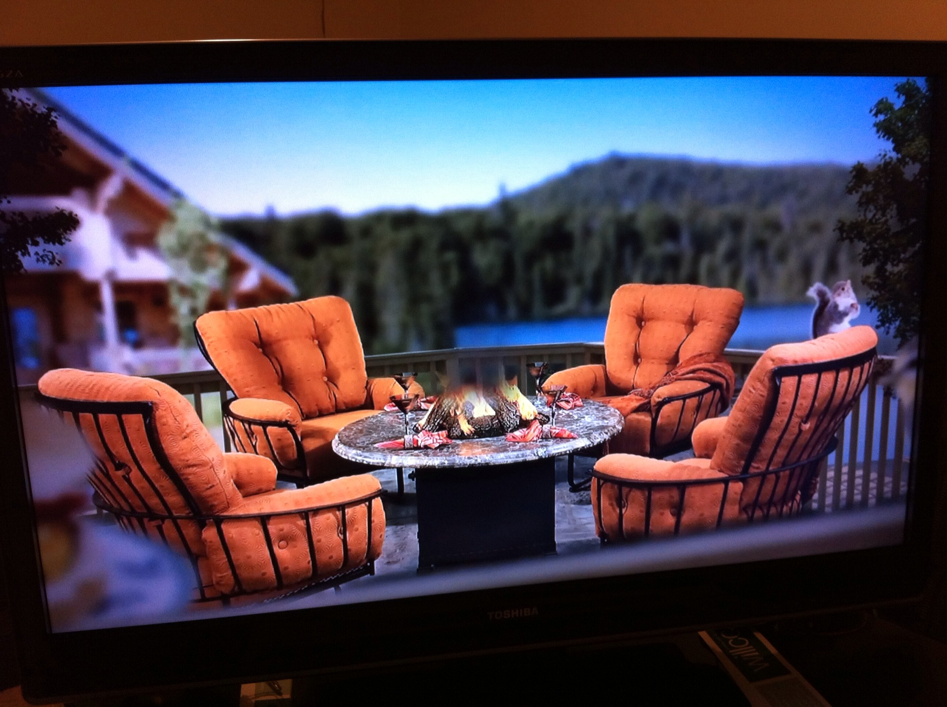

Toshiba 42rv530u picture problem
    Re: Toshiba 42rv530u picture problem
    Possibley a bad driver IC on the panel? Ideas?

          Only does it after fifteen minutes it's on. It's fine when I first turn it on. I just hope the LCD is not going south.

                Tv sat all night unplugged. Plugged in and turned on. Perfect video for twenty minutes then started the inverted image again. Any ideas?

                  Try applying a small amount of pressure to the main processors on the main board, and if accessible, the T-con. If the problem appears, it is a BGA problem. If this fails, try using a hairdryer to heat up parts of the TV.
                    What exactly is BGA? I've also put pressure on the Ic's on the mainboard and changed to another Tcon -no change. Thanks t0m66

                      Ball grid array. A type of package for a processor with many pins (typically >300.)
                      I would then think heating up the main board might help. Otherwise, I'm completely stuck!

                        I'll try the heat gun test again this evening. I'll check for the IC. Thanks

                          Found to be a bad tab and driver ic on the right side. Has anyone found a good source to repair LCD panels? Or is it considered scrap? Thanks.

                            If it's a driver IC, it's essentially impossible to fix it.
                            But a bad tab bond may be fixable. See here http://www.youtube.com/watch?v=zW998RTAq-0.

                              If I press on the small IC's on the tabs my problem goes away. Not having much luck finding a replacement under 2-3 hundred bucks. Guess its time to part it out. Lost on this one

                                You can try taking a bumper or spacer and pressing it inside the frame to fix it. This has a ~90% success rate with Sony LCD panels with this problem.

                                  Update- I purchased a used panel from a polaroid 42 inch and dissected the tft lcd out of it. I had to make a few modifications but it worked flawlessly until i went to put the top metal retainer on that covers the tft panel boards. Being a slightly different configuration, The little foam pads sit in fifferent location on the boards. Of course they had to be conductive and shorted the op-amp ic's on each side. power was shut down immediatley. NO ONE in the USA sells the 2 chips I need, So I found a supplier in china and ordered them. They should arrive in 15 days. I will keep you posted on the progress. Not giving up yet!
