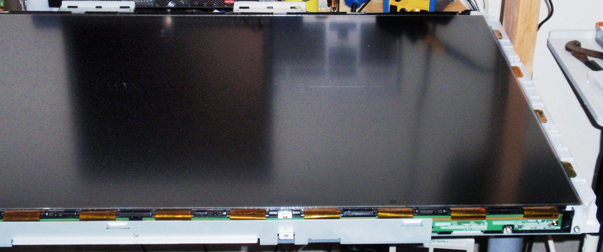

                EUREKA IT WORKED! I CANT BELIEVE IT IT WORKED!
                BUT BUT BUT, this is insanely hard to do, and im not sure ill be able to solder any of it well enough to last ...
                http://youtu.be/JGM3jJQ6J-Q is a link to a unlisted video i made on youtube that shows what testing of the fix i could do. I dont have time tonight to try to actually finish soldering it.
                But i believe you have 2 attempts to solder vON, (1 on each side), (i destroyed the first trace while attempting to solder a too large wire). And you have 8 tabs on the sides, and im pretty sure they all have the proper place to try to solder / peirce the tab .(I destroyed 1 tab slightly by making the peirced hole to big...)
                I honestly have no clue how so many people were successful with the 32" models, as this is extremely hard soldering ...
                BTW bellow is a picture of my testing area, to prove i really took that video, i have no reason to lie to yall. Its also more to make tibi jealous of the amount of space i have to lay out tv's.

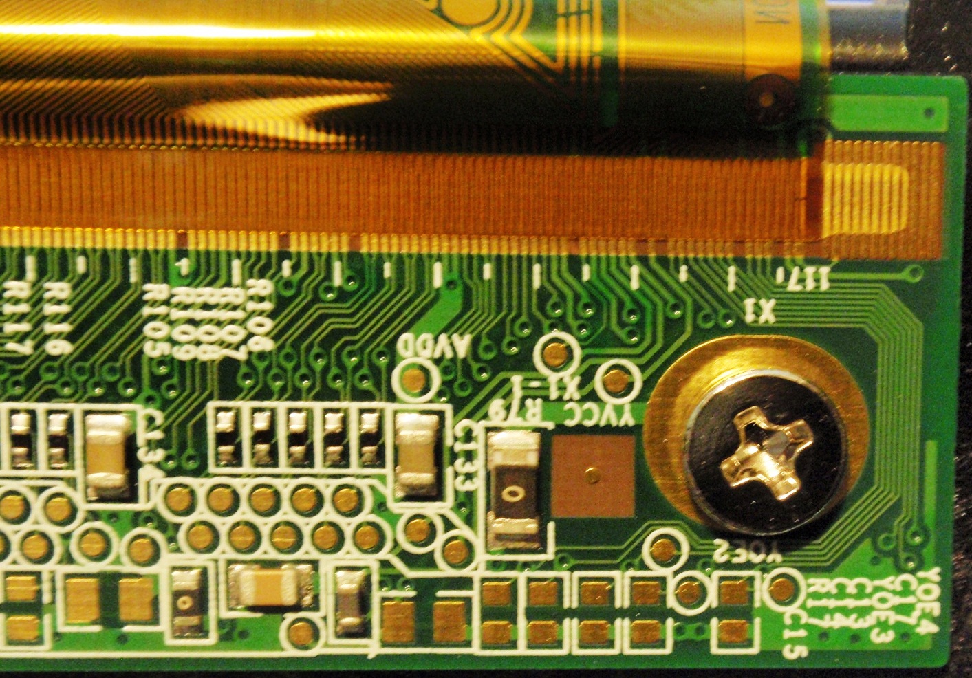

                          I finally got it soldered together... It tooks 3 tabs before i got a good lasting connecting between 1 of the tabs and the wire running to the resistor.
                          The tabs have copper (maybe...) traces inside of some sort of plastic. The plastic is really high temp proof/ temp resistant, cause the soldering iron could be left it contact with it for very long amounts of time. Trying to shave off the plastic coating to get to the traces with a razor blade didnt work at all for me. And if you stuck a needle through you didnt get great lasting contact, and there would be no where for the needle to go once the tv was assembled. But the needle was good for peircing the tab, so that I could try to pick the trace out of the plastic, and eventually i just made a hole, stuck the 28 guage wire through the hole and a lot of flux, and then tryed like hell to get the solder to stick to anything.
                          I used foam tape to hold the 2 soldered wires firmly in place so i wouldnt jar them while reassembling. then i put it all back together and covered the resistor with electrical tape. (My wires were already insulated so i only needed to insulate the resistor.
                          Once back together it still worked ... just have to find some way to live with the extremly dark scenese (an issue with the firmware and design of the TV, not a broken part)... The firmware update i applied was suposed to fix that, but it still is a horrible horrible picture on any show that isnt super bright. Kids shows look amazing on it. Court room shows are so dark you cant see anything but peoples eyes and teeth. (exageration)... (this is probably only a problem with some of the more feature rich sony models specifically my kdl-40s5100) they sell this worthless feature as dynamic scene contrast or something.

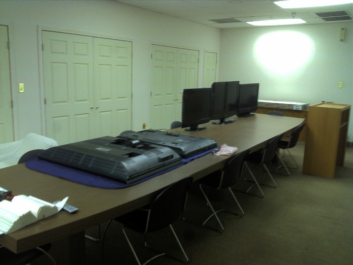

                              Maybe one day topcat will hire us all, and we can line up like the picture of the testing area at this company
                              http://www.febalcdrepair.com/?title=location&menuid=5 < picture at top of site

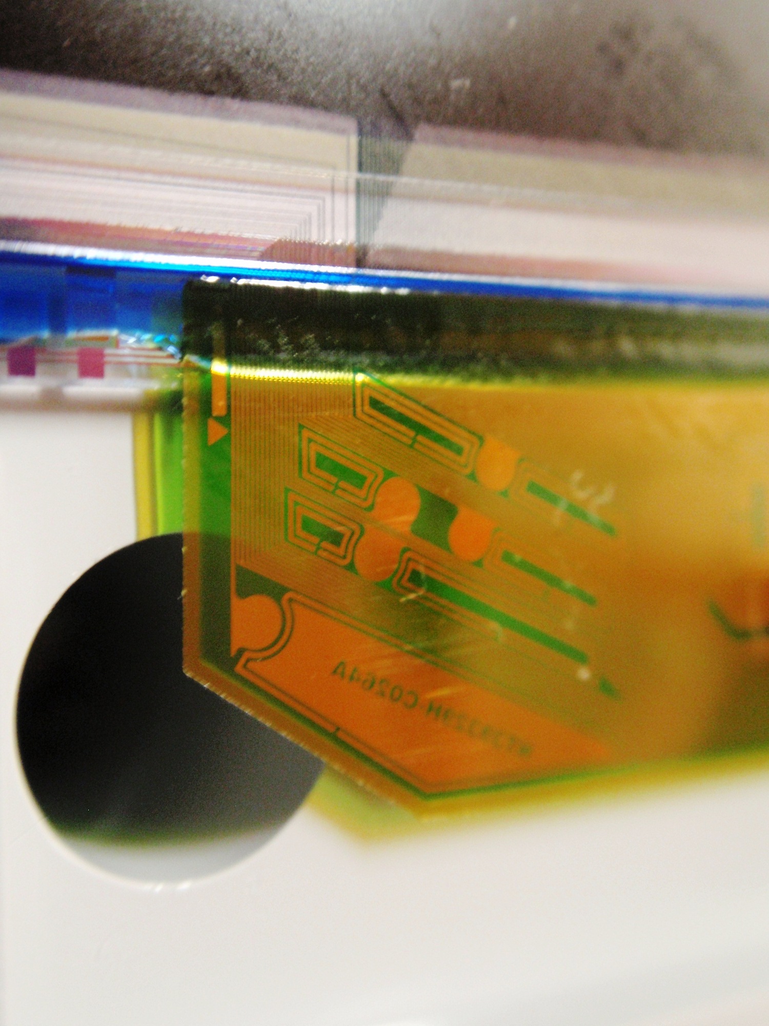

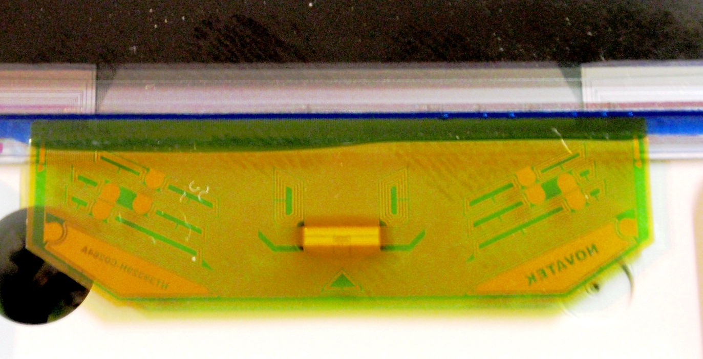

                                      Ok, I have taken the panel apart and found the left upper tab(if you look at the TV from the front of the TV) changes the screen if I touch it.
                                      I took a couple of pictures.
                                      I haven't taken the whole TV apart to check the model of the panel yet.
                                      The thin LCD board looks different then in the video.
                                      Next time I will take some measurements.
