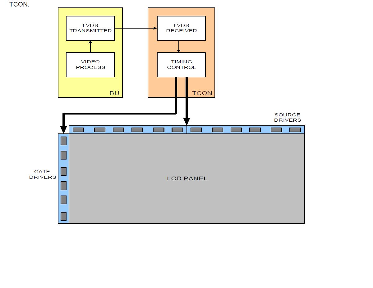

                    I like to know too, since there are ICs (little rectangular bump) on those side tabs for driving the Gate of the TFT's. The first person that figure that out must have known how the panel is wired up. Each one of those need power to operate.

                        The Source means Source pin of the Mosfet (TFT), the Gate drive is for each Gate of the Mosfet (TFT). Sources and Gates are scanned to turn each TFT ON/OFF. Just think of them as X/Y grid, and the T-CON tell which X/Y location to turn it ON/OFF. The block diagram is from SONY training manual. All LCD panel will have X/Y drivers.

                            1 pixel contains 3 sub-pixels, Red, Blue, and Green. So 1 pixel will have three TFT per pixel, when all R, G, B are ON then you get White.

                                "So there must be another voltage applied to the color filter / glass" that is the point, you vary the Source, there is no voltage for the color filters.

                                  Yes a 1080p panel is essentially 5760x1080 pixels, nothing special about each pixel. Maybe they are different sizes for some colours to balance panel colour.
