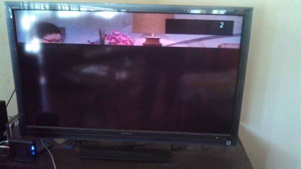

        #43
        Re: Sony Bravia KDL-52W5150 - Are These Symptoms Of A Bad T-Con?
        What could be this symptom?
        • tibimakai
          • Jan 2012
          • 3680
          #44
          Nobody has any idea what this could be? It's the panel?
