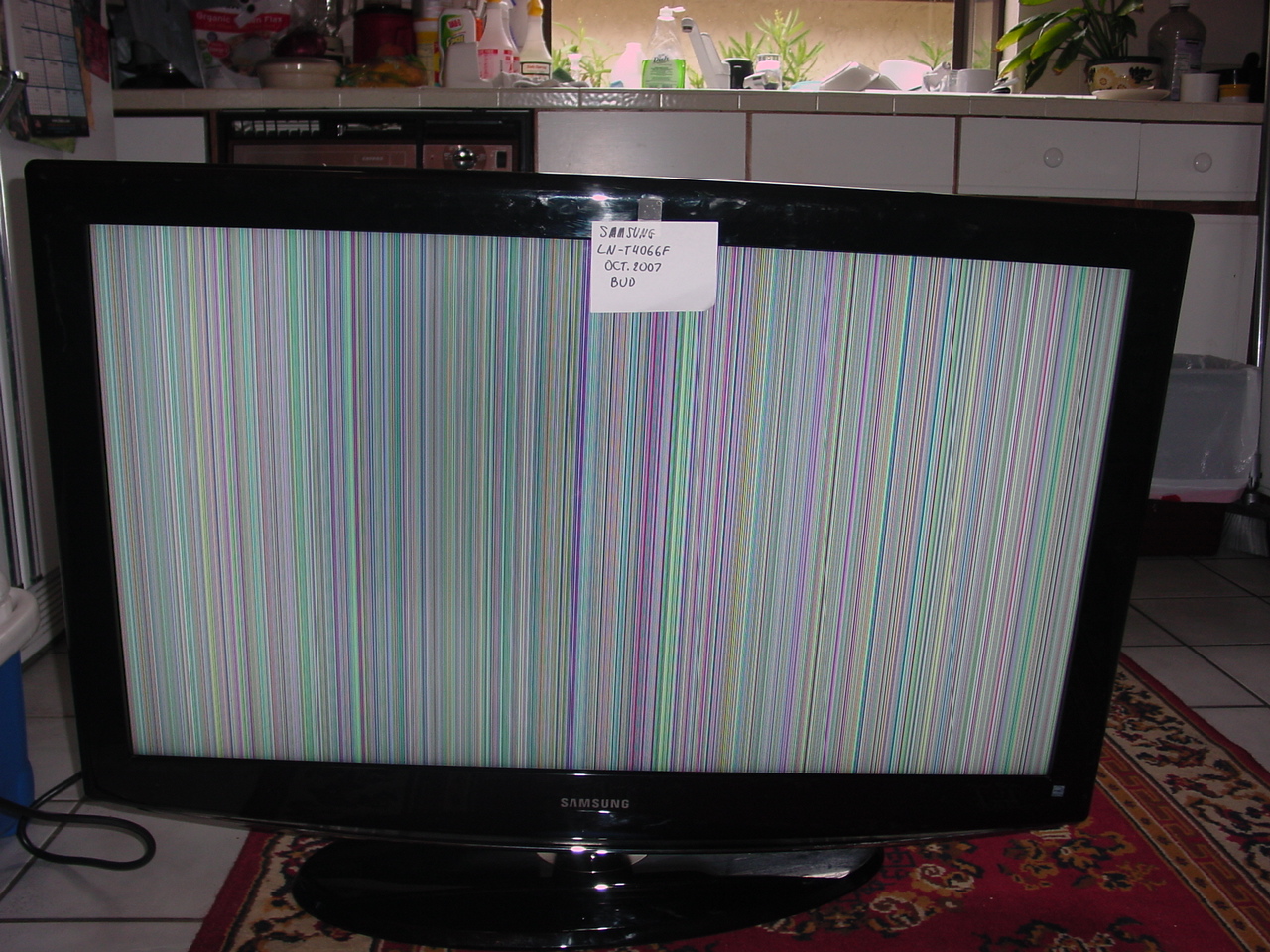

    Sony Bravia KDL-52W5150 - Are These Symptoms Of A Bad T-Con?
    2 Years Old (Out of Warranty)
    Here is a photo with no signal input:
    When I turn on the TV, this symptom may first appear or sometime up to 1/2 hour later.
    If I turn the TV off, wait a few minutes and turn it back on, it works fine (may have to hit the on/off a couple of times before it works though).
    When the picture goes bad, you can hear a very high pitched noise, otherwise, when the picture is working good, there is no noise.
    Here is a picture with signal:
    Lately, it is taking more power on/off cycles to get a good picture.
    Are These Symptoms Of A Bad T-Con? or bad connection?

    Re: Sony Bravia KDL-52W5150 - Are These Symptoms Of A Bad T-Con?
    Sure looks like T-COn. Try pulling up the menu. If it looks bad too, that would tend to confirm T-Con.
      Yes, the menu shows exactly the same pattern as the 1st photo.
        Try T-Con first (relatively cheap option). If that doesn't fix it at all, it's a bad panel unfortunately (which seems to happen a lot on Sonys for some reason)
        Open her up and look for a panel model number (white sticker on the LCD panel itself, usually with a manufacturer name/logo like Samsung, ChiMei, LG-Philips etc.).
        That model number combined with "t-con" or "tcon" in an ebay search should yield some results..
                    As a note, when the vertical lines start to appear there is a high pitch squeal coming from the TV.
                    After a while, the screen is covered with the vertical lines to the point where you cannot see the picture or images on the LCD screen, At that point, the high pitched squeal disappears.
                    Turn the TV off and then back on and the picture reappers. It may take 2 - 8 on/off cycles before the picture stabilizes and the TV can be watched all day.
                    Turn the TV off at night, and the next morning I have to start the on/off cycle all over again.
                      Although the tcon is more likely the problem, the following symptoms youve described sound more like a power supply issue:
                      1) squeeling noise
                      2) goes away after power cycles / heated up
                      3) affects everything (menus and inputs)
                      If you took a picture of the whole back of the tv and a closeup of the tcon and power supply might help diagnose it.
