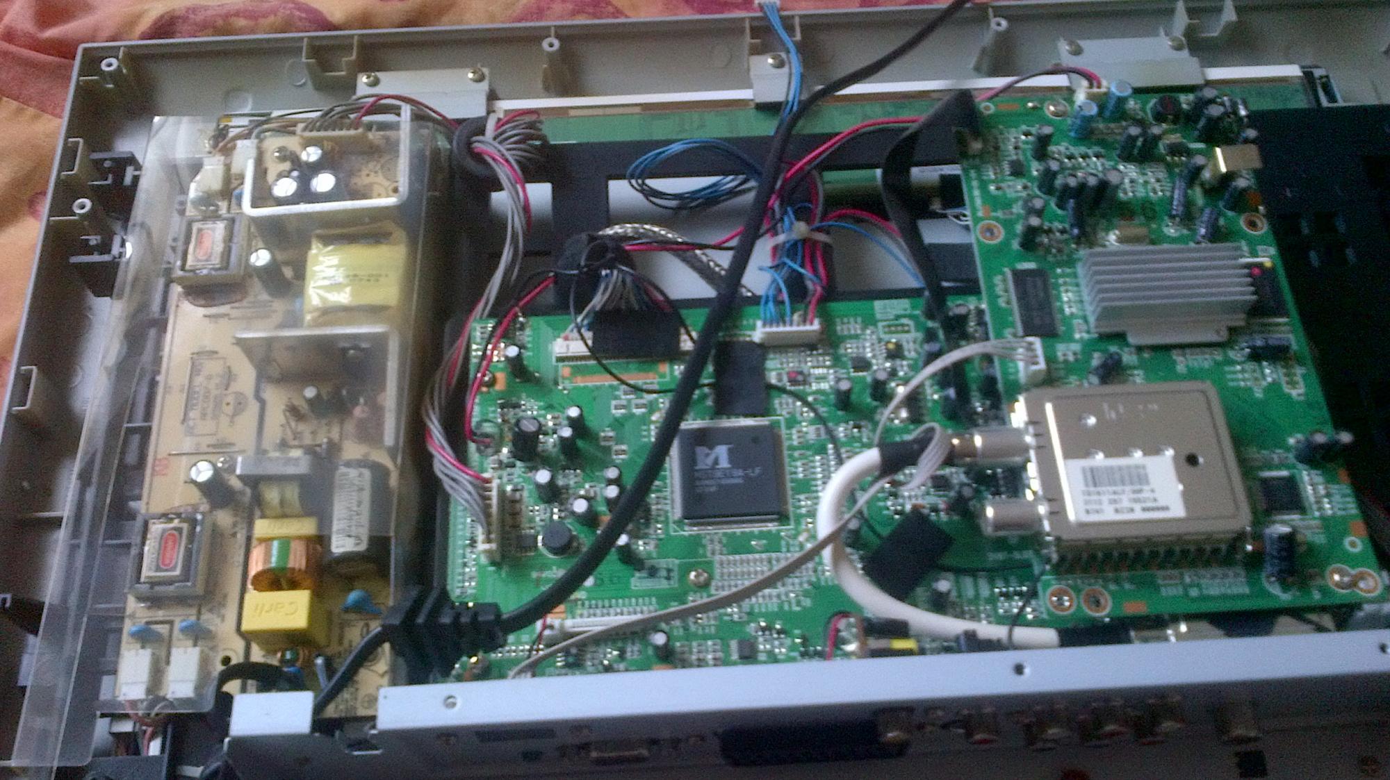

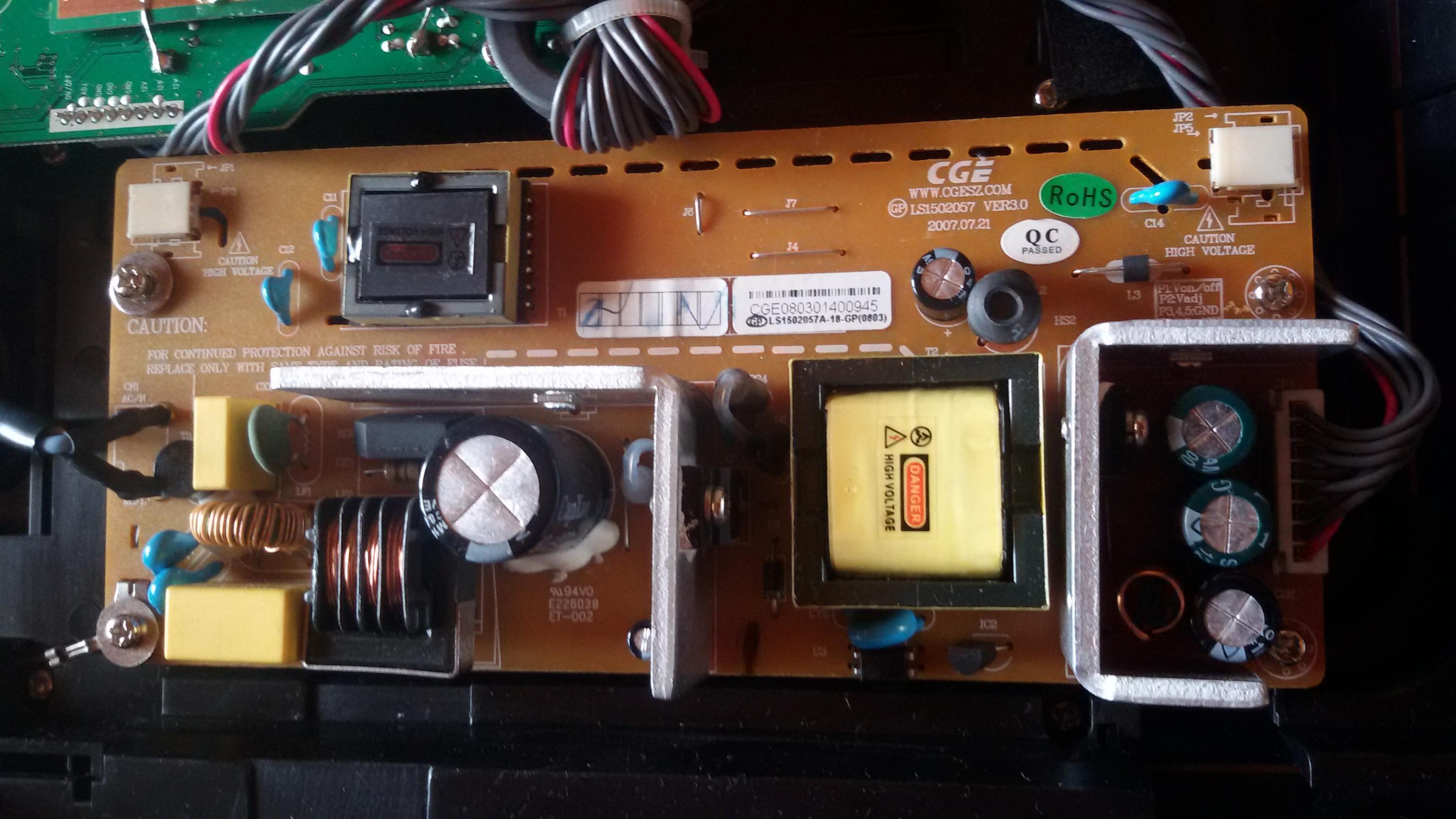

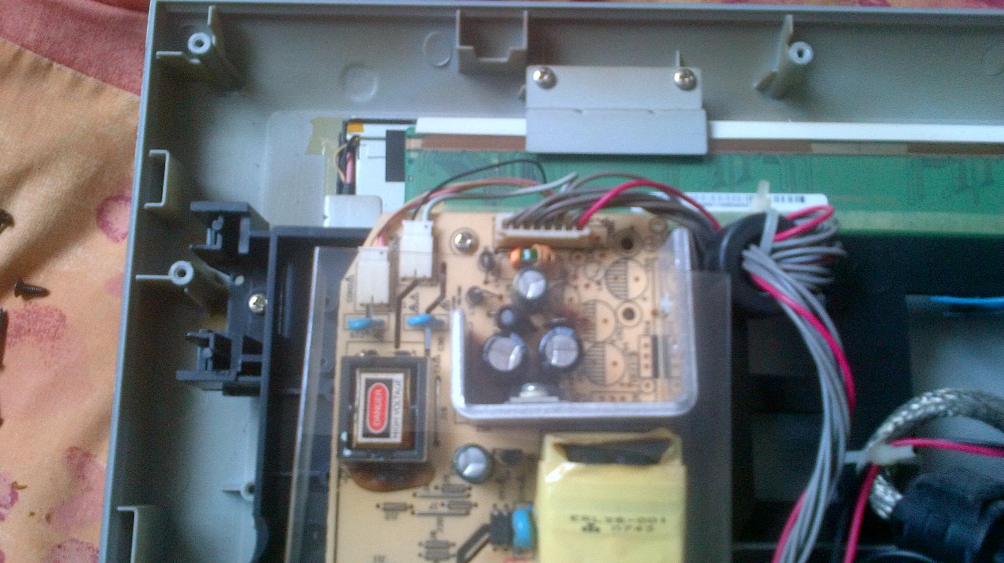

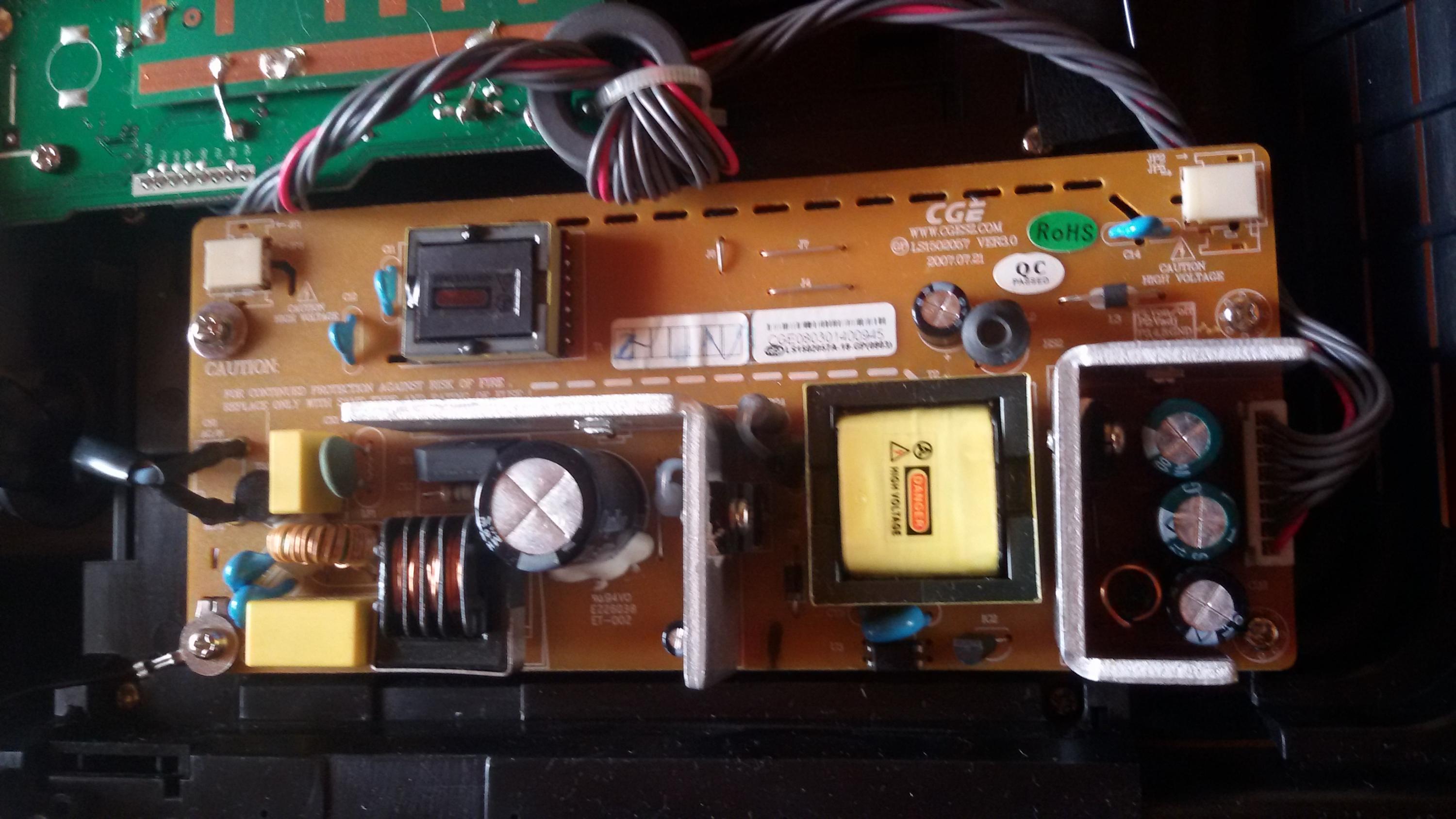

    Picked up 2 of these TV's with the same issue.
    Thought I would share the fix with you in case you come across one of these in the future.

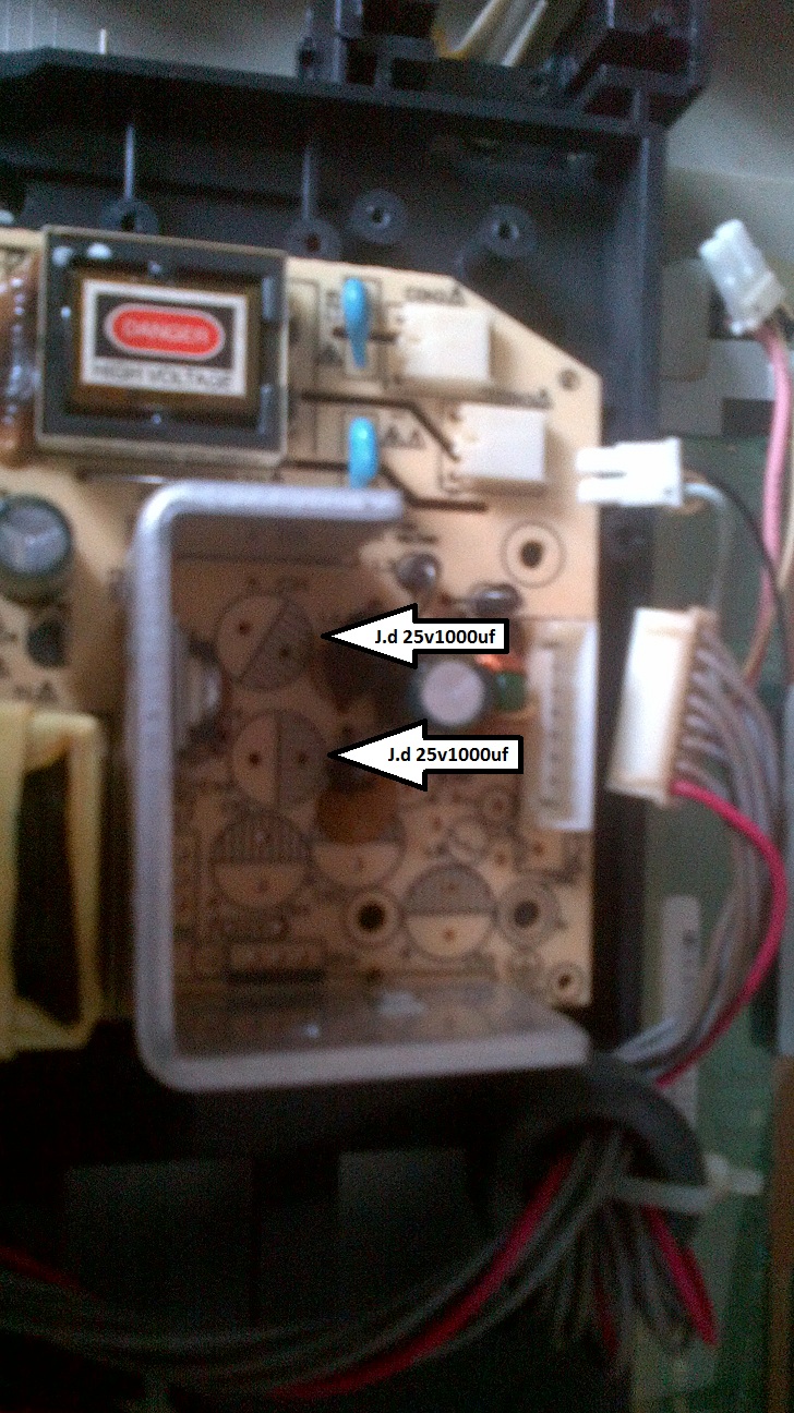

    They both had 2 blown 25v1000uf caps that needed to be replaced. I have attached a picture of this below.

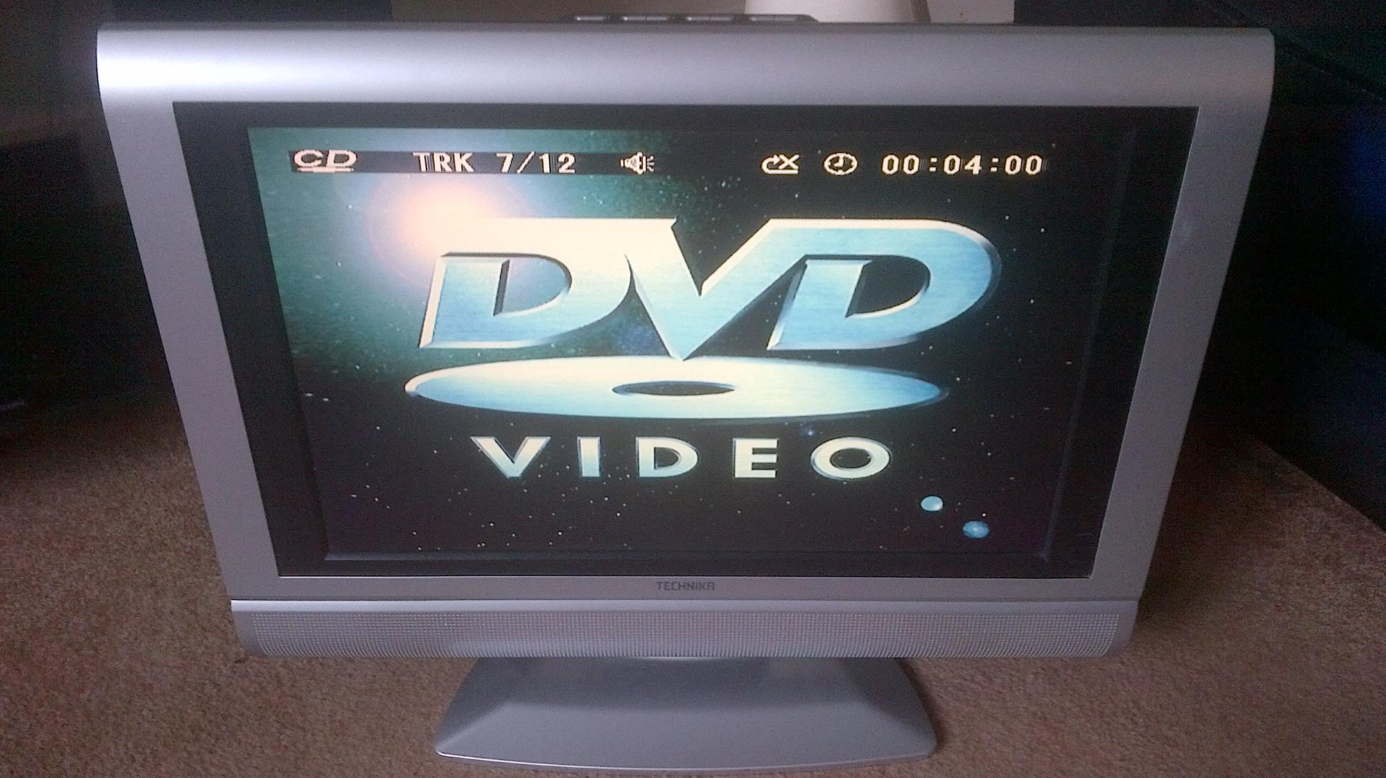

    When the TV was put back together the DVD wouldn't play (something I should have checked before putting it all back together really!). I took it back apart and took out all 4 screw holding the DVD drive in to give me just enough room to move the drive out a little to clean the lens without having to remove the ribbon cables. These are glued and they hover over the power supply so I didn't want to worry about them coming loose in the future.
    Put it all back together again and hey presto all up and running and the dvd is now running well. I'm actually playing some music in the background on it as I write this!
    P.s I know the pictures are of the worst quality I need to get my proper camera back of my sister! Hopefully they are clear enough to give you an idea of what's going on.

        Yep these 2 caps fail often , They are marked on the pcb as C34 AND C49.
        They go leaky usually. There is a 16 volt 680 uf close to these two, i usually
        change it too even if it measures ok as it usually does.
