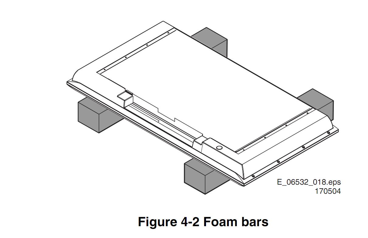

      Ps: Is it ok to lay it face down to remove the back?
      I know it,s not great for transportation.

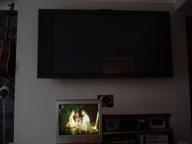

      A little pic so you can see what i am stuck watching. Back to the 90s.

            [QUOTE=Securityman;208336]
            QUOTE]
            Yes. As long as you place something underneath to protect the screen. A couple thick bath towels or bed comforter.
              The preferred method is to support the TV by placing the TV on some blocks to ensure no pressure is placed on the plasma panel itself. If you slide a mirror onto the bench below the TV, you can even see what is being displayed.

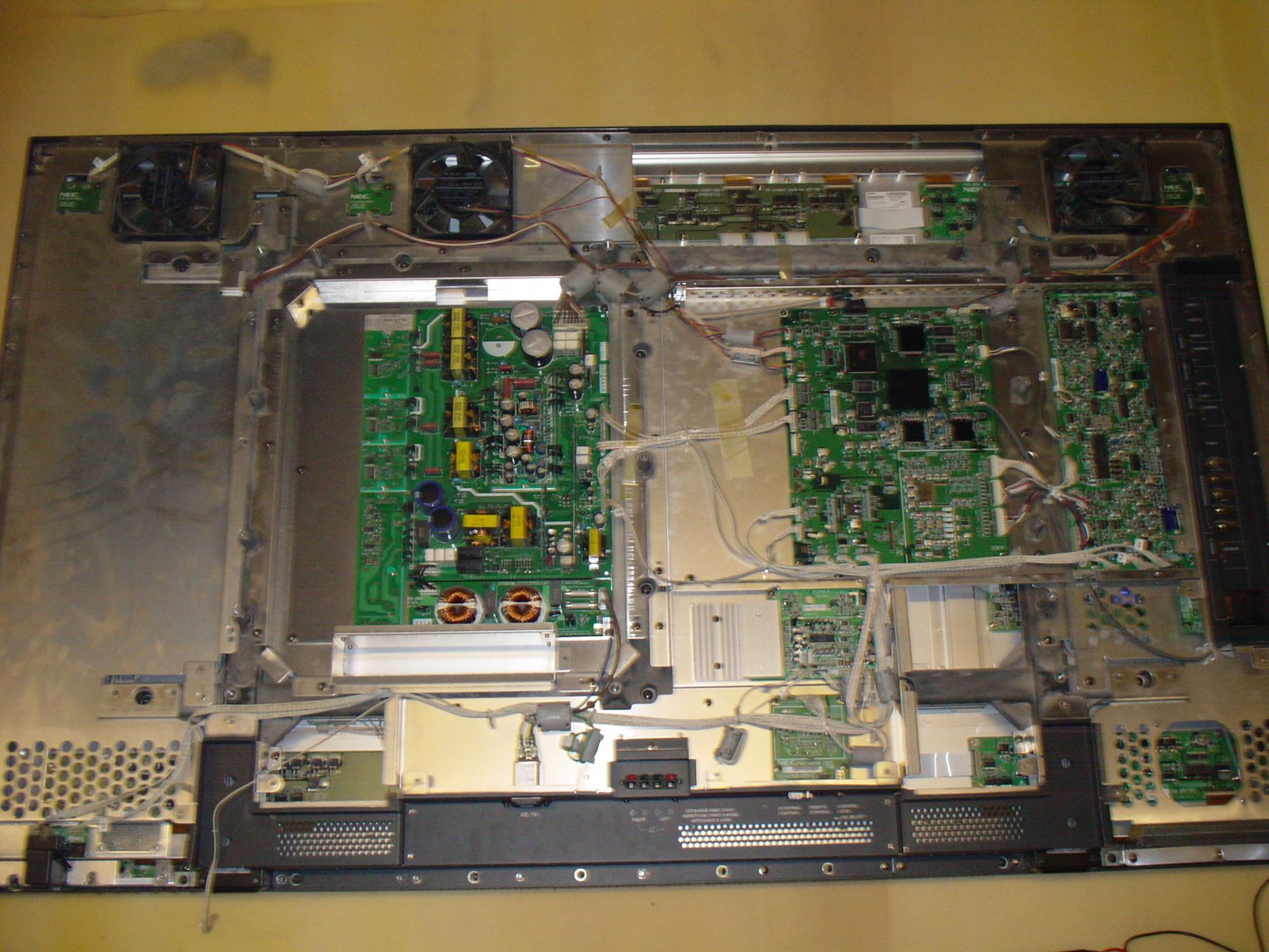

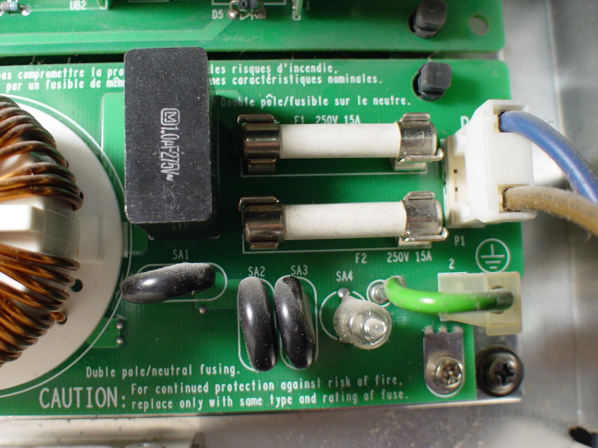

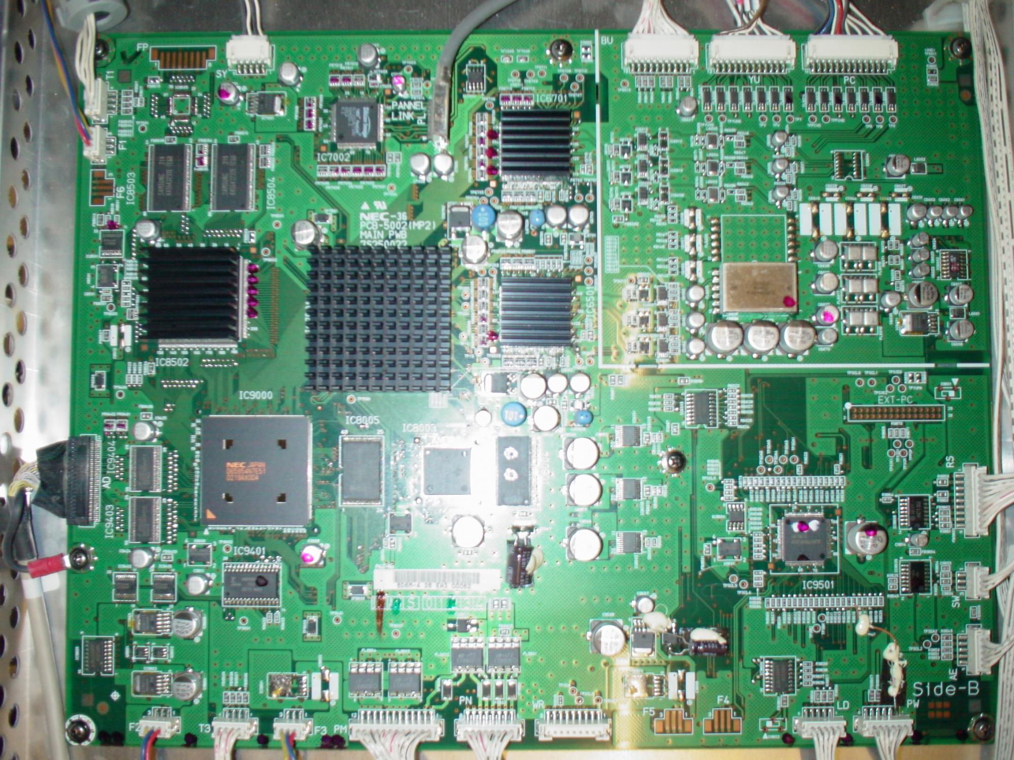

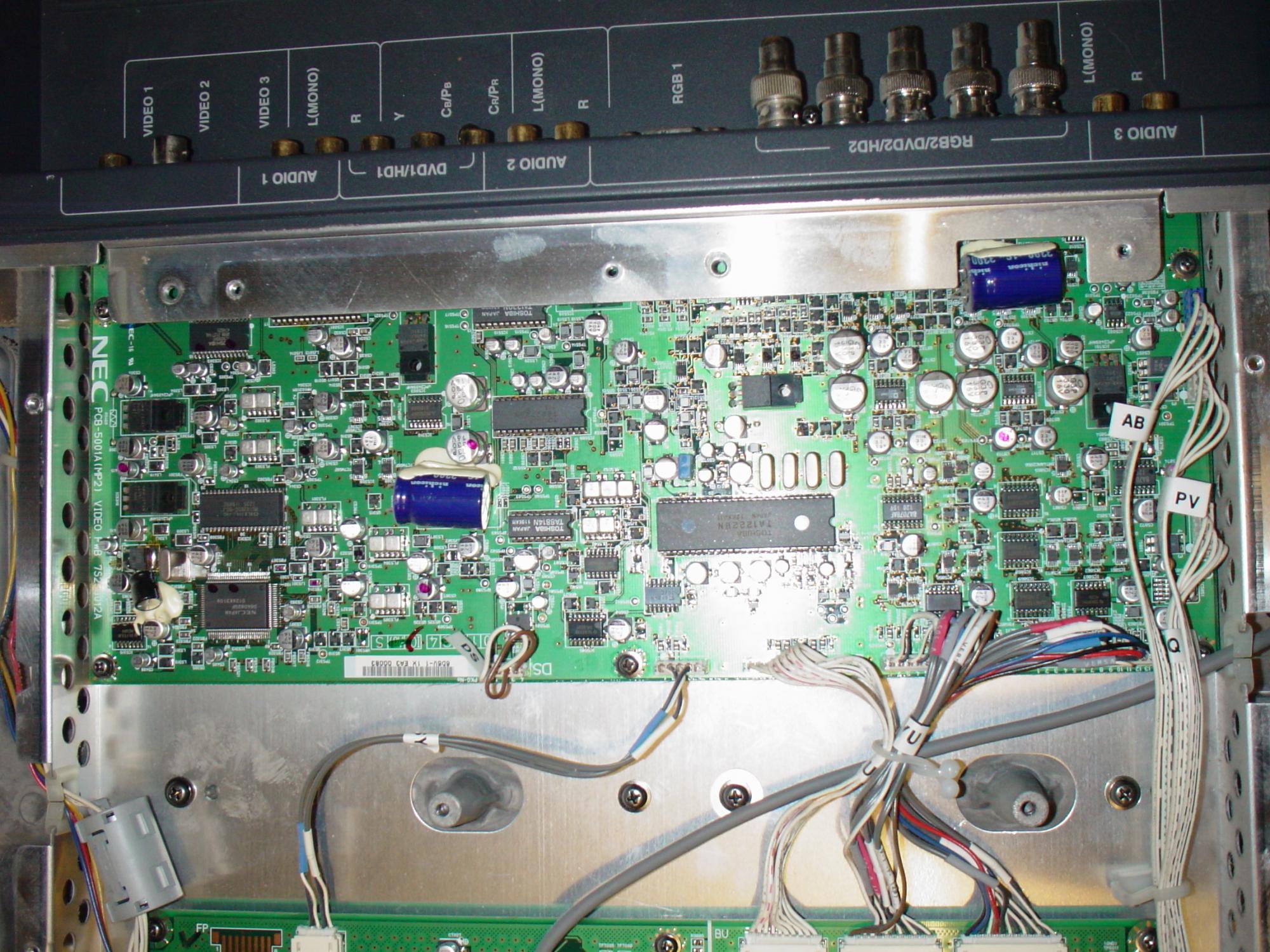

                So i am back, it's been to long watching a 17in CRT
                I have cleared the garage and removed the back.
                Just so you know i am a newbe when it come's to electronics.
                I have built a couple of bread board circuits, but that's about it.
                I can follow instructions ok, so should be fine with some help.
                I have a fluke 77 series 2 meter and i am ok testing voltage and continuity.
                I have a couple of soldering irons and a SMD station that i dont know how to use.
                This is my first shot at some pic,s. I hope they are ok?
                I will have to get some more light into the garage tomorrow if not.
                The second pic is a board under the metal plate on the left.
                There is another board on the right under the video board.
                I can strip it down more if needed, but thought i would get these pic's out there in case i don't have to remove any more.
                Any help would be great.
                Cheers

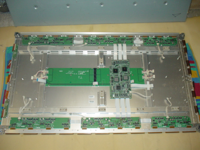

                    These are pic's of a spare panel i have here.
                    It only come with the PCB boards that you can see in the pic's.
                    The one's around the edge have a, b, c, d, e, f, on them. Are they the buffer boards?

                        The spare panel.......a lucky buy on Ebay about 3 years ago for £30 with pick up only 10 miles away from me. It,s been in the garage all that time just in case. I was hoping it would of had more boards on it. But got to be worth £30 if i can use one thing out of it.
                        I will have to brush up on my photography, had to hang a lead light above my head to get more light.
                        I hope they are ok.

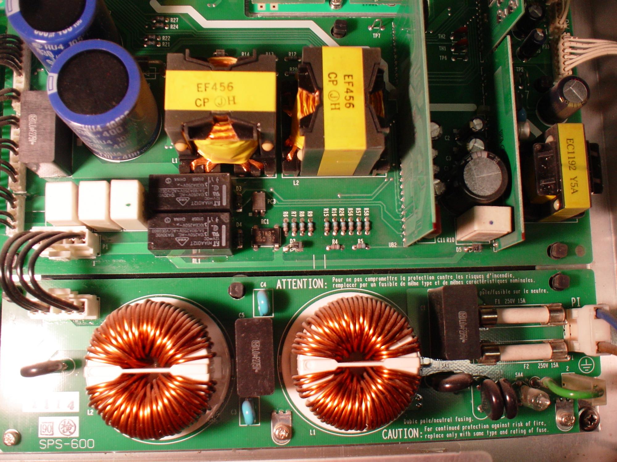

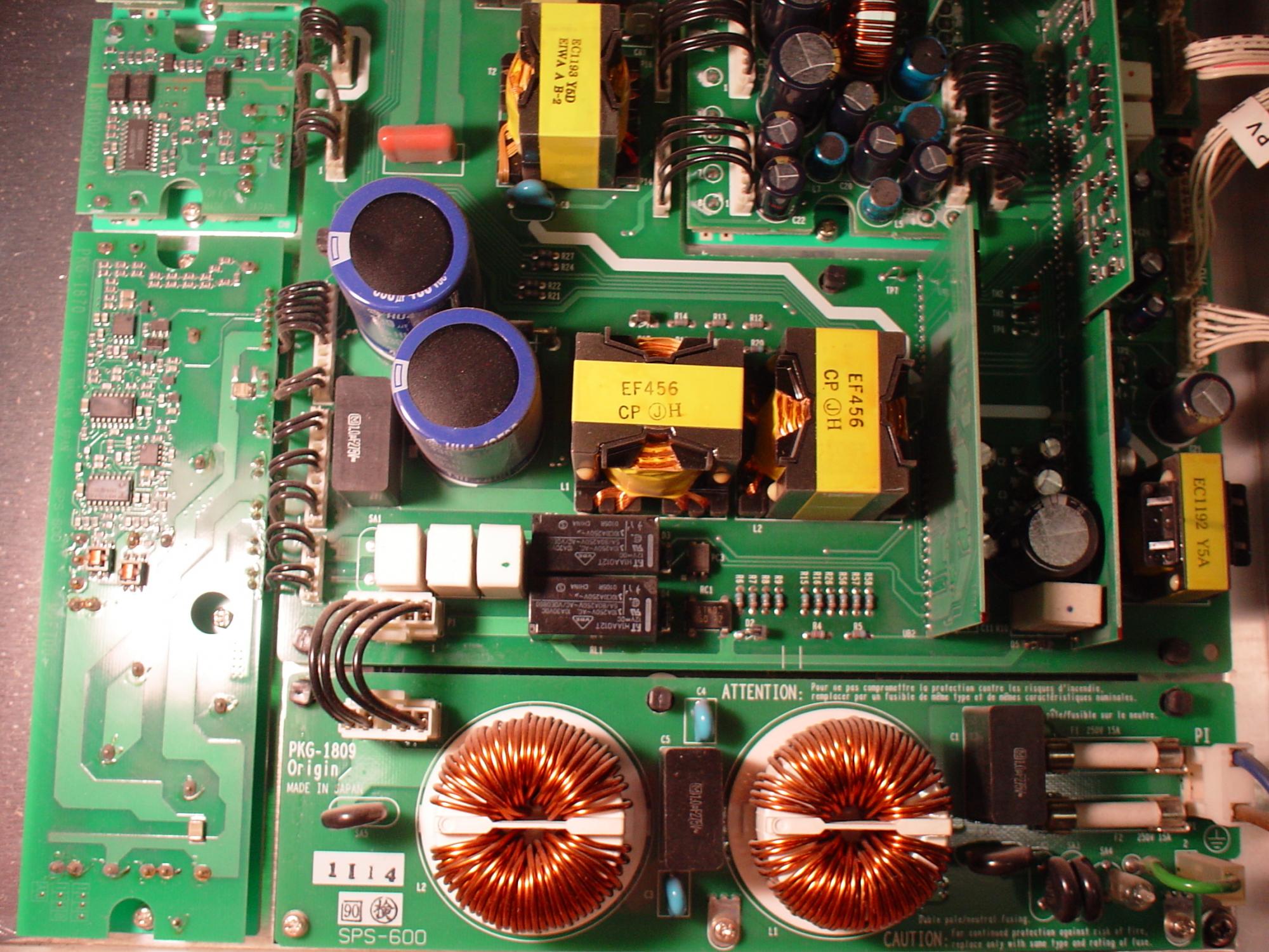

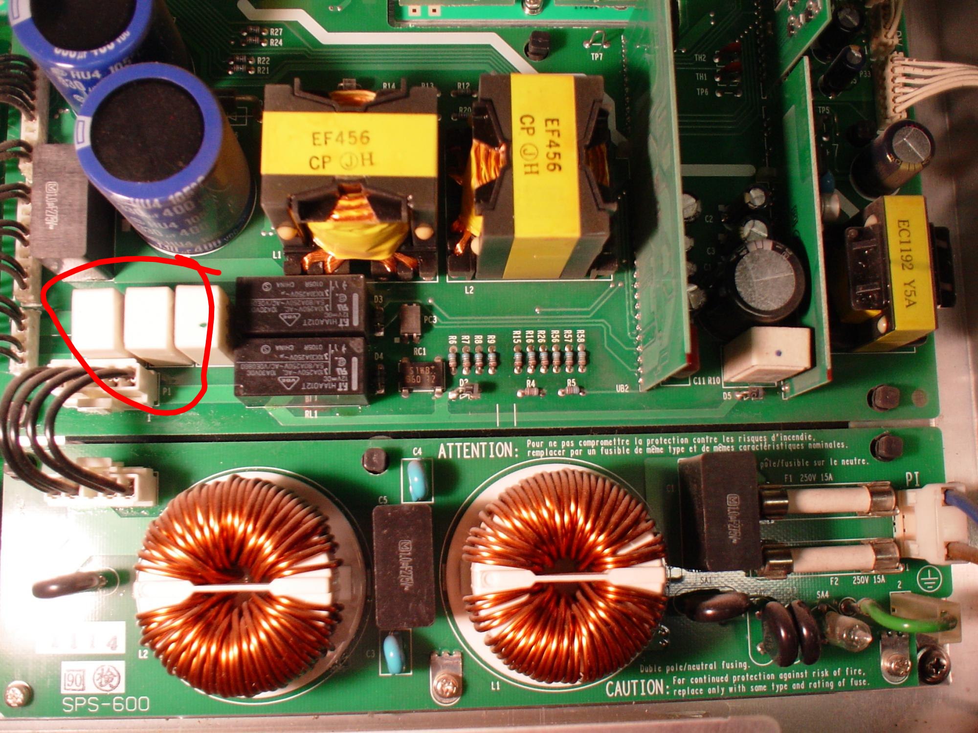

                          Re: Faulty 61in NEC MP1 plasma tv, stuck with a 17in CRT in the lounge

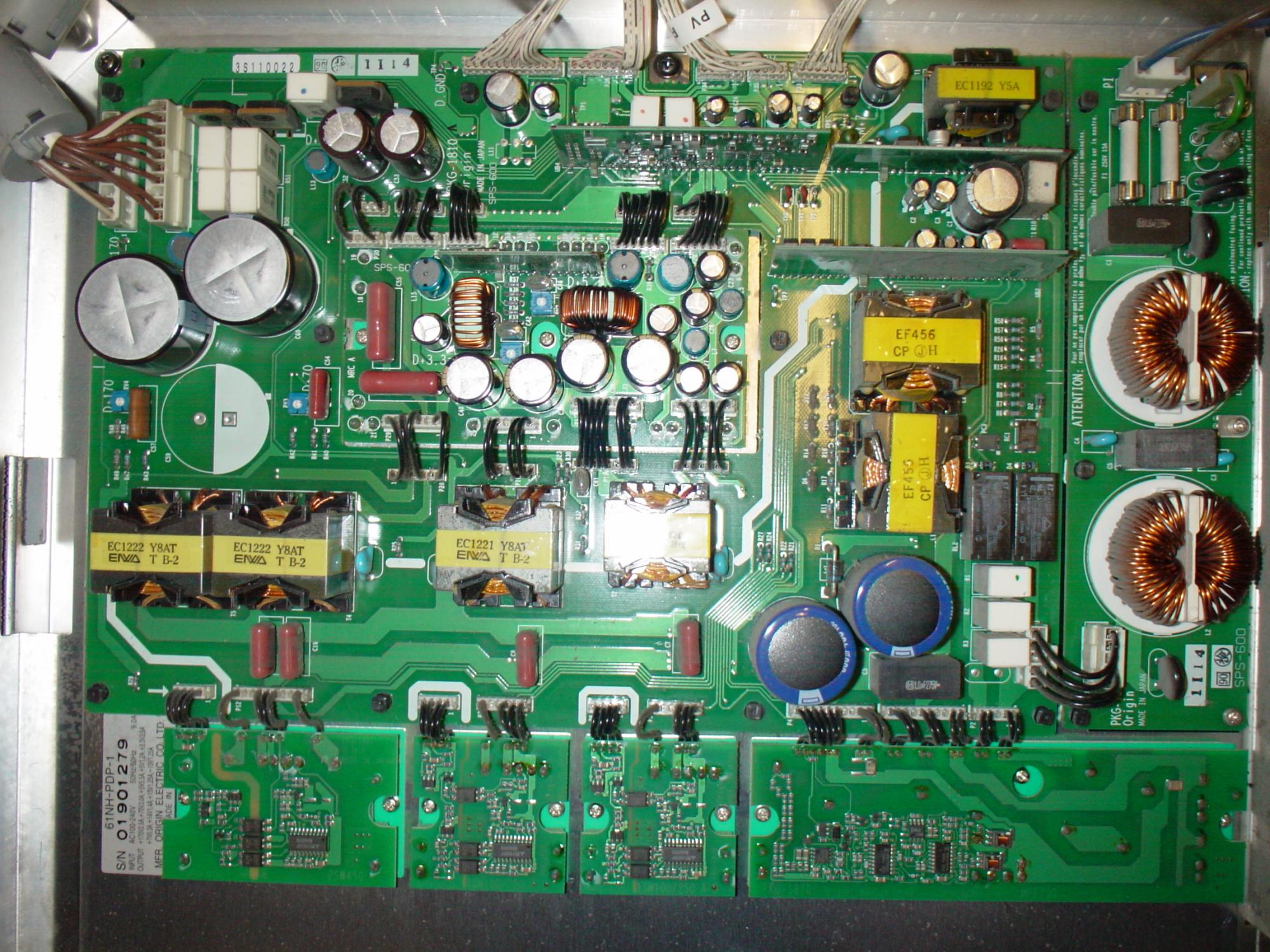

                          These three white devices are your "inrush" resistors.
                          They can fail open from either being worn out from many turn on/off cycles, or due to a shorted component further down the line (i.e. they act as fuses.) In one case on a Hitachi/LG PDP, it was old age (just replaced one of the three and it powered right up), but on the Pioneer, it was a shorted FET (on replacement, there was a "crack" and "pop" from the resistor... then it measured open circuit)
                          Flip the power board and measure the resistance of each. They will be labelled, but in general for a plasma of this size I'd expect <15 ohms each.

                              Selldoor i will have to check that lot in the morning because the computer is upstairs and i will need to print it off to check the panel in the garage.
                              Tom66
                              LOOKING GOOD.
                              I cannot believe that you may have diagnose the fault at the first crack.
                              Left to right, 1 to 3 in the pic you posted.
                              Number 1 and 2, GSW 10 ohms Micron 19T
                              1 = open
                              2 = 10 ohms
                              Number 3, 5A 2.2 ohms 01 04B, i think because i cannot see it great
                              3 = 2.2 ohms
                              So it looks like it's number one is the problem.
                              I tested all the other white box fuse's i could see on this board and they all read as spec.
                              Now where is the best place to get it in the UK and do i just it fit it and try to power up or is there any more to check before a replace and power up?
                              Just tried a Google search and cannot find anything. What is that part called?
                              Last edited by Securityman; 05-15-2012, 05:23 PM. Reason: update: Google search info
                                Here's a replacement part. It is sometimes known as a sandstone cement resistor. (Despite being made of neither sandstone, nor cement.)
                                http://www.ebay.co.uk/itm/5W-Axial-C...#ht_1813wt_907
                                HOWEVER, before you replace it, check the resistance across the main 420-450V caps. (With power off.) It should measure greater than 1k ohms. (On your Fluke, you'll want to range to the nearest to 10kohm and set it to manual ranging (the autoranger will be confused by the caps), and wait for the caps to charge - you're looking for a stable measurement.) Anything lower indicates a potentially shorted component, which is the cause of the failure.
                                IF there is no short, it would be advisable to change both 10 ohm resistors and ideally the 2.2 ohm one too - the failure mode is by metal fatigue from rapid heating (they deal with peak currents when the TV is first turned on) so the others might not have long left.
                                        Good morning, back to the garage after about 4 hrs sleep.
                                        The Fluke i could only switch from k to M ohms. Not got the hang of auto ranging yet.
                                        I tried it with a cheap meter i have here. UNI-T UT33B £10 job from the market.
                                        This one:
                                        http://www.ebay.co.uk/itm/Uni-T-UT33...ht_3890wt_1018
                                        This one does not have auto range. It has 200, 2000, 20k, 200k, 20M, ohm range.
                                        On the 200k ohm setting they all climb out of range.

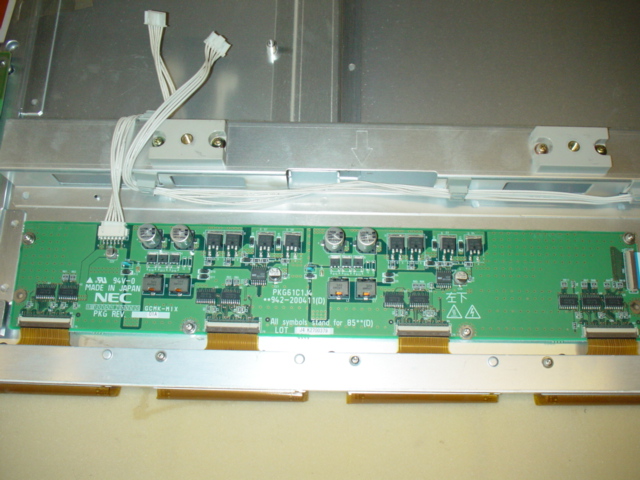

                                        On my pic number 4 the two caps closest to the ceramic Resistor's that i tested.
                                        When on range 200k ohm setting they climb out of range, then i remove the probes, change to the 20M setting and they are at about 1.90 ohms and fall to about 0.27 ohms.
                                        Remove probes, wait about about a min and retest, they climb from about 0.16 to 0.27 ohms. Then they climb slow from here, from 0.27 ohms to 0.28 ohms take's about 30 seconds.
                                        The other two caps on the top left of my pic number 4.
                                        200k settings out of range, 20M sit at about 0.16 ohms with a slow climb.
                                        Does this sound about right?
                                        I hope i am giving you the right info.
