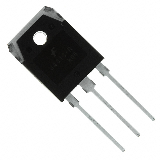

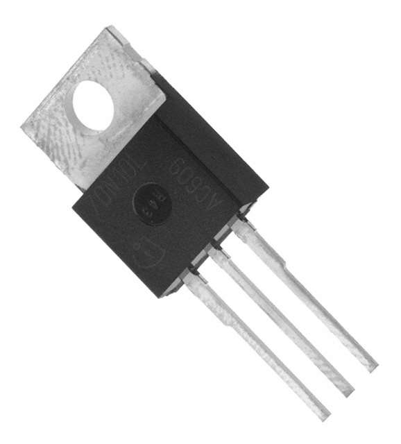

          Caps should read above 10 kohm. Preferably above 100k ohm.
          You likely have a shorted power MOSFET further down the line. A power MOSFET looks like this:
          http://media.digikey.com/photos/Fair...FJA4313RTU.JPG
          or this:
          http://media.digikey.com/photos/Infi.../SPP70N10L.JPG
          They will likely be mounted to a heatsink of some sort, perhaps directly to the plasma panel.
