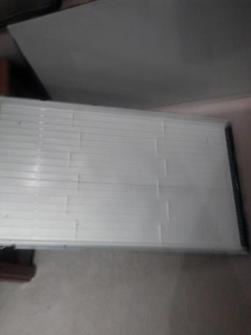

                    What I found out with my LCD tv if the any of the ccfl lights goes out, the inverter board shuts down within a few seconds of starting. This was the case with my TV. One bulb was out causing this issue. It is a project to tear apart though. As you can see from the pic, there are 18 bulbs and one in the middle is out. You can also tell by the darkness of the LCD bulb.
                      #70
                      Re: Polaroid TLX-04244B
                      That is corect, there is 3 second timing circuits that detect if the lamp fired up and stay conducting, open connection (lamp not connected), over current, the inverter circuits will shutdown, it only take one bad lamp to shutdown the inverter circuits.

                                    TLX-04244b the screen turns on for a second and then buzzes and shuts off.
                                    I have fixed 2 of these now both times they just had bad bulbs. same 3 bad bulbs in both TV's. replace those and you are good to go..
                                    If you really watch the screen when it comes on, you can see a shadow across the screen where the bad bulb is.
