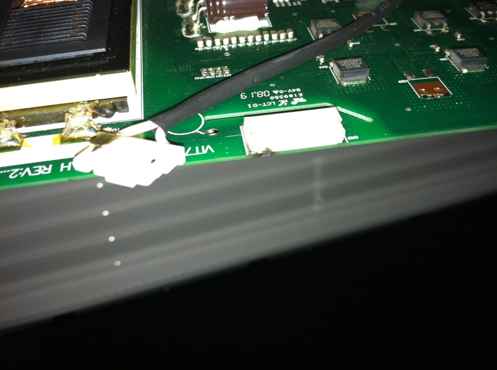

            That is most likely an au-optronics panel. It consists of a master and slave inverter.
            Mosfets on the slave short out and can be caused by one or two bad ccfls.
            Very common on this type of panel.
            Do not replace the inverters until you inspect the ccfls.

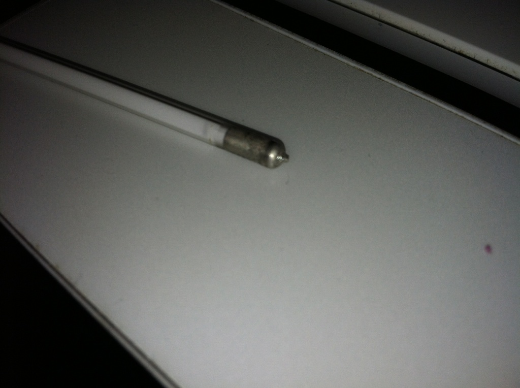

                      So you were right it has 4 bad bulbs out of 18. Do you know anywhere I can buy these?

                            I'm not convinced that four bulbs have failed. These inverters shut off when one bulb dies so no further failures should happen.
                            There's a simple test for this, though.
                            With power off, carefully swap a "faulty" CCFL for a working one. See if the CCFL in that position lights up. Do not change them around when the set is on as you will get a nasty shock (~3,500V) although as this is AC it dissipates almost instantly so no harm once unplugged.

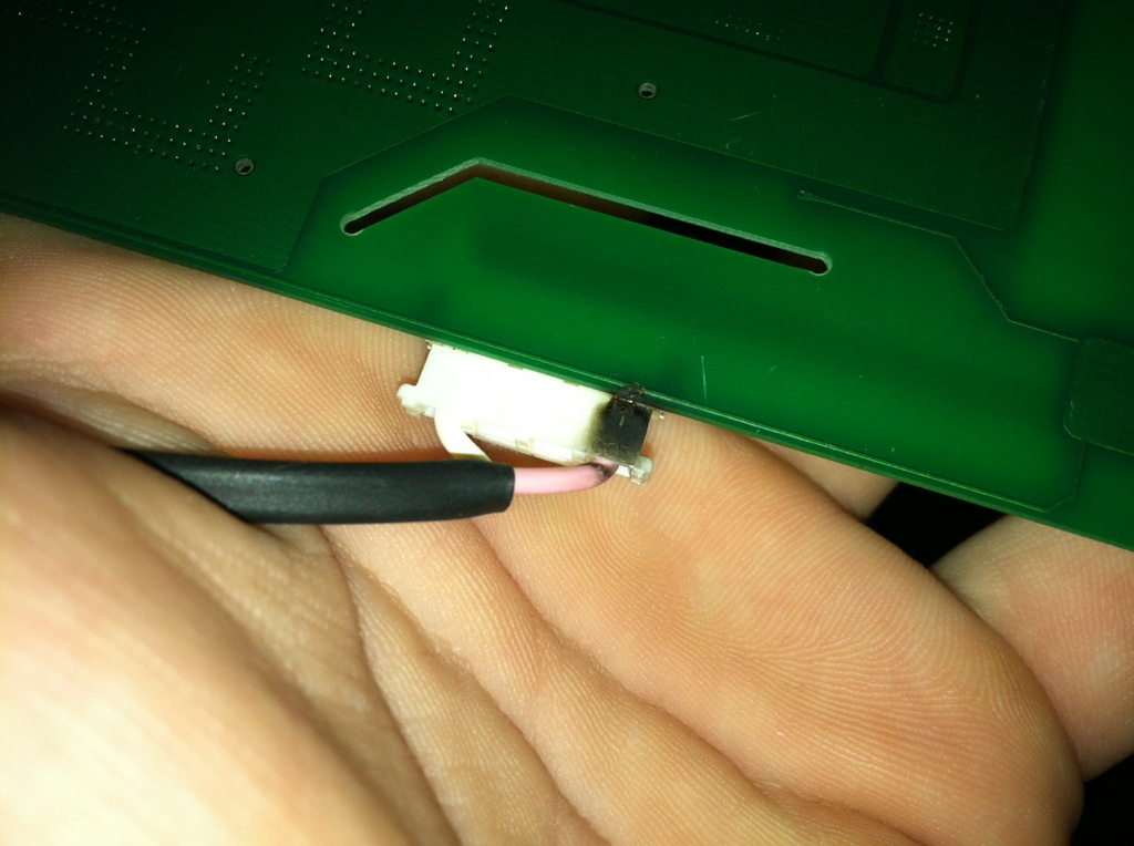

                              I did what you said and there's only 3 out I thought i seen four but it is flicking. But the same three are out after I moved them. They also have black spots on them. I'm having trouble still trying to find replacements. I think i'm going to put the AOC or Sony ones in after i fond out the diameter of the bulbs.
                              See early I was messing around with the bulbs and put them back in there was a little light and the t.v stayed on longer than it has been at least a min or longer. But now there no light what so ever in the three bulbs.

                                    I have replaced the ccfls from another of the same size (42 or 32 etc).
                                    I soldered mine in because the ends were smaller.
                                    I replaced all of them from another panel. (even light)
                                    You can do the same. Some are plug in and some are soldered.
                                    Any ccfls with dark spots are bad.

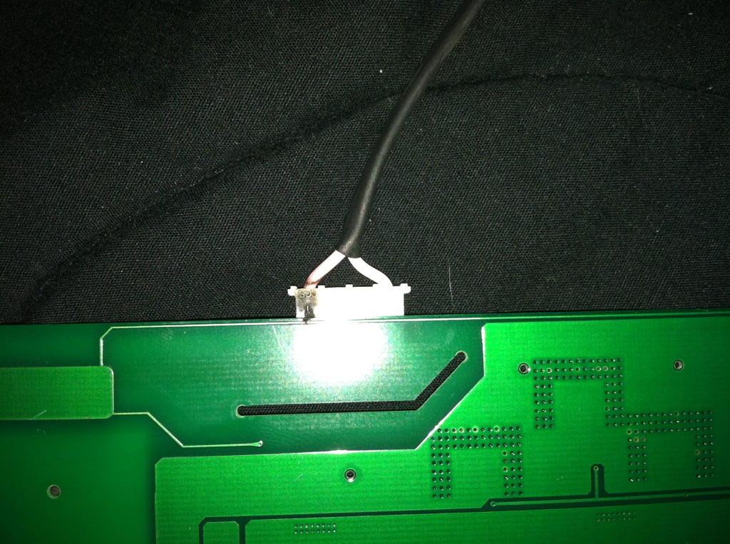

                                      So I got home today and truned on the t.v so I could see the bad bulbs and it truned on but the light slowly shut off from right to the left and I started smelling something like electrical components burning. I immediately unplugged the t.v and inspected it and found this. So do you think the master board is bad now or what could have caused this, i;m kinda scared to plug it back.

                                          You might have a bit of conductive dirt where the connector is. I don't think the board is damaged. Use a needle or small pin to scrape off the carbon residue and clean the "wound" and plug it in again. It won't start a fire.
