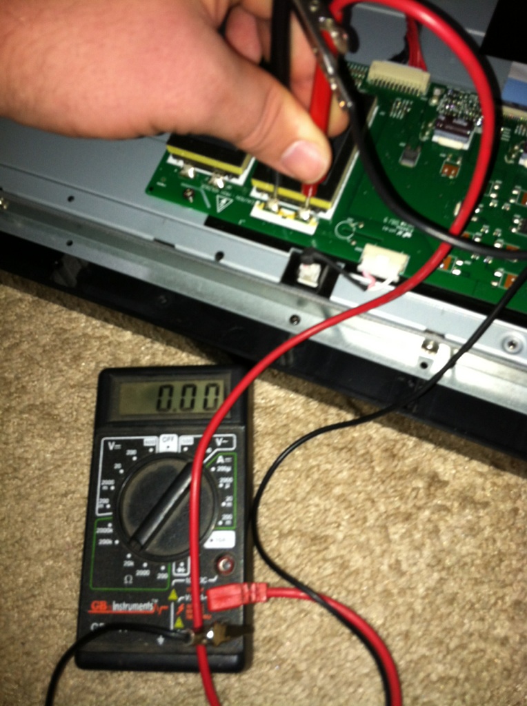

                                What range did you set your meter on? Can you post a picture of it in that setting?
                                • 2011srg
                                  • Nov 2011
                                  • 46
                                  Re: Polaroid TLX-04244B
                                  Here you Go
                                    Okay, so I'm stumped, that's the right setting, but I'd expect results of "6000" or something for typical inverter transformers. Try again on the 200k range, but that would be very high for those types of transformers.
                                    Another test. While the TV is off, disconnect the slave inverter bulb connector. Turn on the TV. Do you hear the buzzing noise and does the screen light up? Try it with the master board (reconnect the slave). Does the same thing happen? The board that does not produce the effect is probably the bad one.
                                    • 2011srg
                                      • Nov 2011
                                      • 46
                                      Ok so I did another test and the left ones still nothing and now with using the 200k the right ones jump from 173.3 to 0.01.
                                      I also tried disconnecting the slave and turning on the t.v no light and no buzzing and did the same with the other one and the same thing they both have to be plugged in for the light to come on.
                                      • 2011srg
                                        • Nov 2011
                                        • 46
                                        The frist pic is on 200 and the second one on 20K. Just making sure this what you are wanting me to do, because i feel like i'm doing something wrong.
