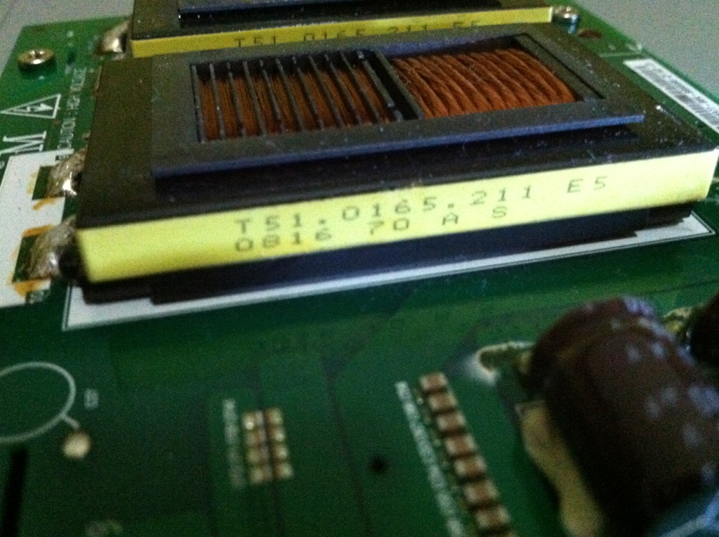

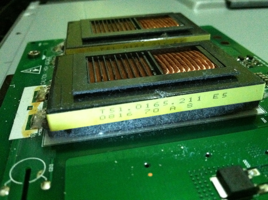

    1) Is there a part number (or list all the numbers) on the inverter transformer?
    2) Take a clear focused picture of the above.
    --- begin sig file ---
    --- end sig file ---
    • 2011srg
      • Nov 2011
      • 46
      Re: Polaroid TLX-04244B
      On the side of them in the pictures they say T51 . 0165 . 211 E5

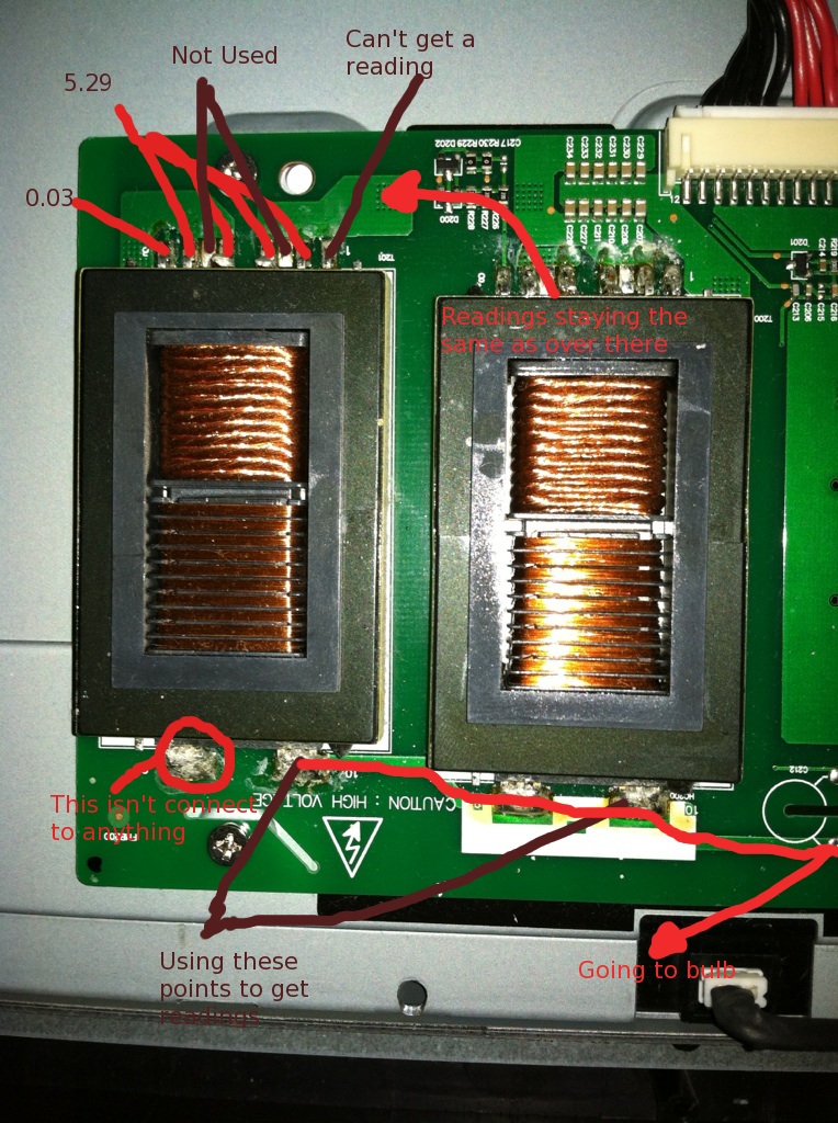

        1) Over at
        http://www.lcdparts.net/T.aspx
        there are 6 inverter transformers that begin with T51. None of them are an exact match for yours, but if you click on all 6 that begin with T51 (click on the buy now button), they will take you to a picture of the underside.
        2) What you are trying to measure is the resistance between S1 and S2 (the secondaries - see post #7). As you can see, with the T51, the secondaries are on opposite sides of each other. Your job is to find the right one that will give a reading somewhere in the range between 880 Ohms and 2000 Ohms.
        3) Since the resistance might be 2001 Ohms, set your multimeter to the 20K scale otherwise it will display a "1" on the left hand side indicating out of range.
        4) Once you find the correct combination of pins, repeat for all inverter transformers and report the readings. All readings should be within 3% of each other. If not, you have a bad inverter transformer.
        5) Remember to measure resistance with the power off and TV unplugged from the outlet.
        6) PS. Clicking on "buy now" won't put anything in your shopping cart. It just gets you more info.
          Ok so here are my new readings on the Master transformer on the right I get 4.88 on both solder points but on the left one (edge of board) i get 4.88 on the right solder point and nothing on the end (edge) and on the slave side I get 7.59 on both solder points on the right one(inside) and of the left one(Edge of board) I get 8.30 on the right one(inside) and nothing on the left(edge)
          • retiredcaps
            • Apr 2010
            • 9271
            1) Your finding would be easier for us to interpret if you report it like this example
            Master side
            transformer T1. S1-S2 = 777 Ohms
            transformer T2. S1-S2 = 773 Ohms
            Slave side
            transformer T1. S1-S2 = 774 Ohms
            2) Please perform the test again to verify your findings.
            3) There seems to be a lot of people who are mis-interpreting their manual range multimeter readings.
            A multimeter always gives a reading. "1" on the left hand side of the display means the reading is "out of range".
            1.0 on the right side on the display is a unit of measure (i.e. 1 unit of measure). As you as you turn on the multimeter, it gives you a reading. There is no such thing as "nothing".

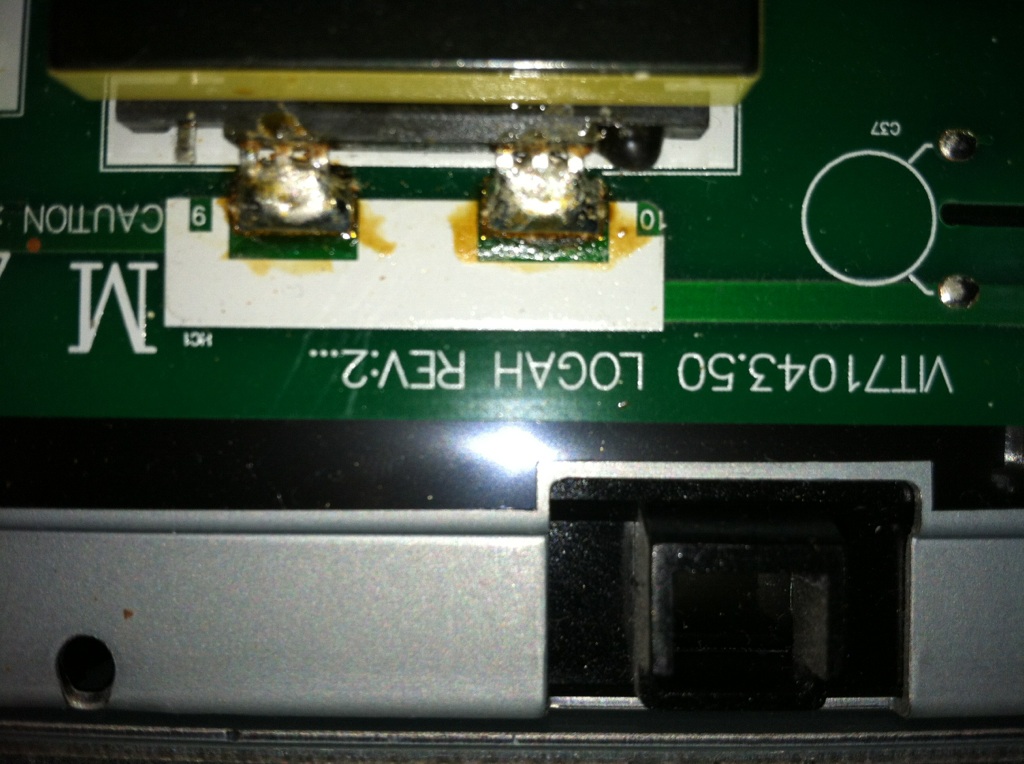

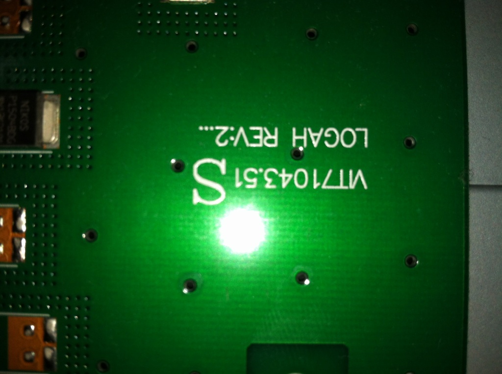

                    1) Is the slave inverter transformer the exact same part number as the master?
                    2) Let's measure the secondaries one more time, but now put you meter on the 2000 (two thousand) scale. Report these findings.
                    • 2011srg
                      • Nov 2011
                      • 46
                      #30
                      Yes the part numbers are the same.
                      Master
                      Transformer T2. S1-S2 = 37.7 Ohms
                      Slave
                      Transformer T2. S1-S2 = 35.6 Ohms

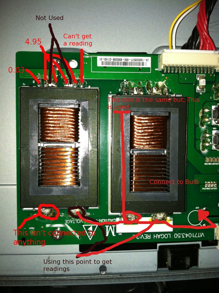

                                Here are some pics of readings
                                  #36

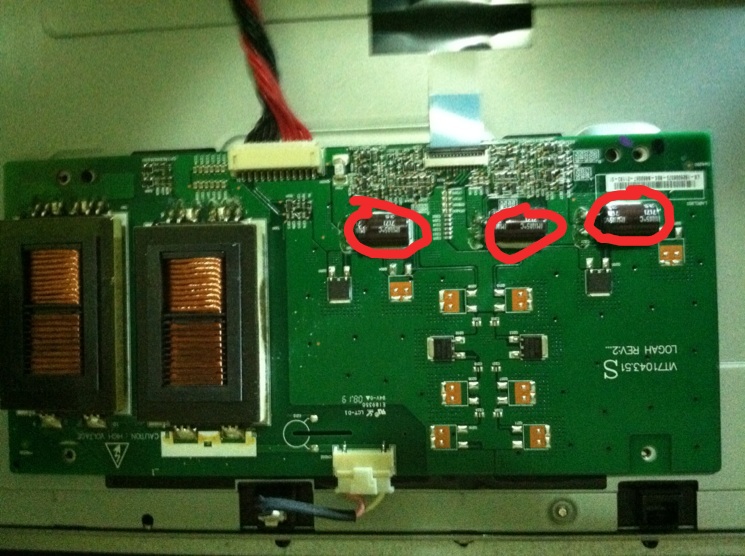

                                  Did you test the fuses on the inverter board?
                                  • 2011srg
                                    • Nov 2011
                                    • 46
                                    #37
                                    Is this what your talking about?
                                      #38
                                      So i did the paper thing both boards are buzzing but I can't tell if both or just one of them are doing it
                                      Did you check the fuse on the boards? It's the white object next to the power connector. First; check the zero level of your meter: Set your meter to the ohms range, then touch both leads together. Note the reading and write it here. Then place one lead on one side and the other lead on the other side of the fuse. Report back the reading.
                                      • 2011srg
                                        • Nov 2011
                                        • 46
                                        #39
                                        They come back as 0.00 Ohms
                                        • 2011srg
                                          • Nov 2011
                                          • 46
                                          #40
                                          Is there any chance that the power supply isn't giving enough power to the inverters, if so how can I check. I also contacted a ebay seller that is selling the inverters and asked if he could tell me the ohms of the transformers
