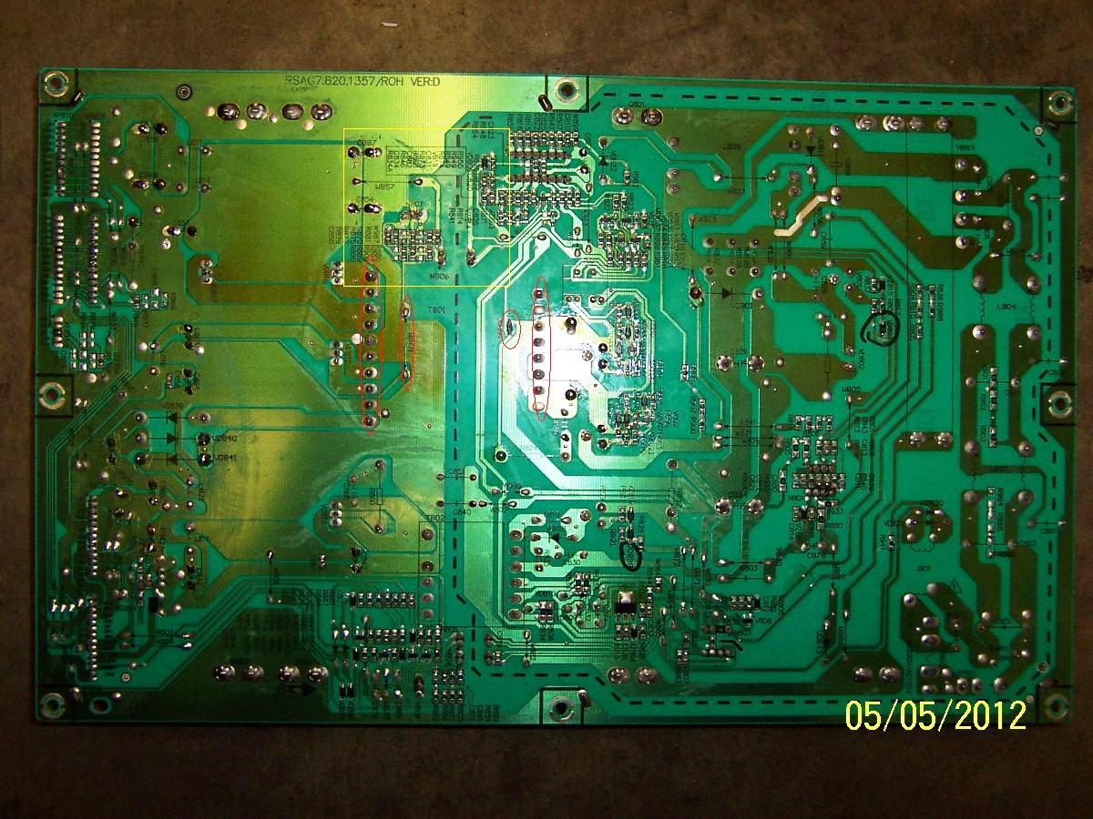

                                    Anyway to move on -I have attached a pic. -(could do with a clearer picture of this side of the board )
                                    As you do not want to transplant the transformer I suggest you resolder all the connections - some of them look a bit grey so may be failing I have marked them in the picture.
                                    There is also what I think is a wire link to resolder and what looks like a single joint in the smallest red loop.
                                    Please can you also do a close up of the yellow box area.
                                    @vr69 He has already replaced all the caps on the power supply - post#5

                                        I did replace all the capacitors that are listed in the kit. I will try to get a better picture of that area and will resolder all the pins on the transformer.
                                        I dont have the other tv close by to try my psu in it. It was easier to remove the psu and leave the tv at his house. I can try mine when I take his back though.
