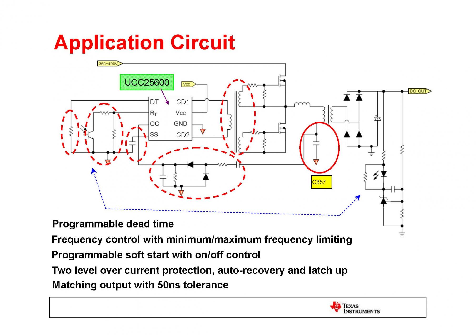

        Went over all the solder joints on the transformer but it didnt change anything. I happened to look at the high voltage cap I originally replaced and compared the value to the other board and noticed it is different. The original cap is a CBB881 1000v 68nj but the other board has a CB881 2000v 22nj cap. I dont know if it would make a big difference or it has something to do with the different transformer. The numbers on the original transformer are different than the borrowed one.
          #44
          Re: Proscan 55LC55S240v69
          That C857 DC blocker/coupling capacitor for half-bridge circuits that drive the 12/24V transformer, it is VERY important to use the same value for replacement (you can go for higher voltage) otherwise it will mess up the feedback circuit and can cause the transformer to be over driven or under driven due the Xc of the cap. The j is the spec for 5% tolerance for the cap. When this cap has resistance leakage or shorted out, it can take out the two MOSFET's with it.
          See example of typical setup.

            The original cap in my board is a CBB81 68nJ 1000v. I replaced it with this one.
            http://search.digikey.com/us/en/prod...1922-ND/502702
            The borrowed board that appears to have been rebuilt has the CBB81 22nJ 2000v. Any explanation why it would be a different value?
                            They could have redesigned the circuits due to new parts such as transformer, or they had problem. You will have to look at the Revision number of both boards assembly (not blank PCB) and other components also to find out what else is changed.
                                      The resistance you are reading may be the Gate-Source resistor a shown in the diagram, you need to look at bothe boards to see if they are the same value. You may not be able to use the spare board as a reference since the design is not the same as your board.
