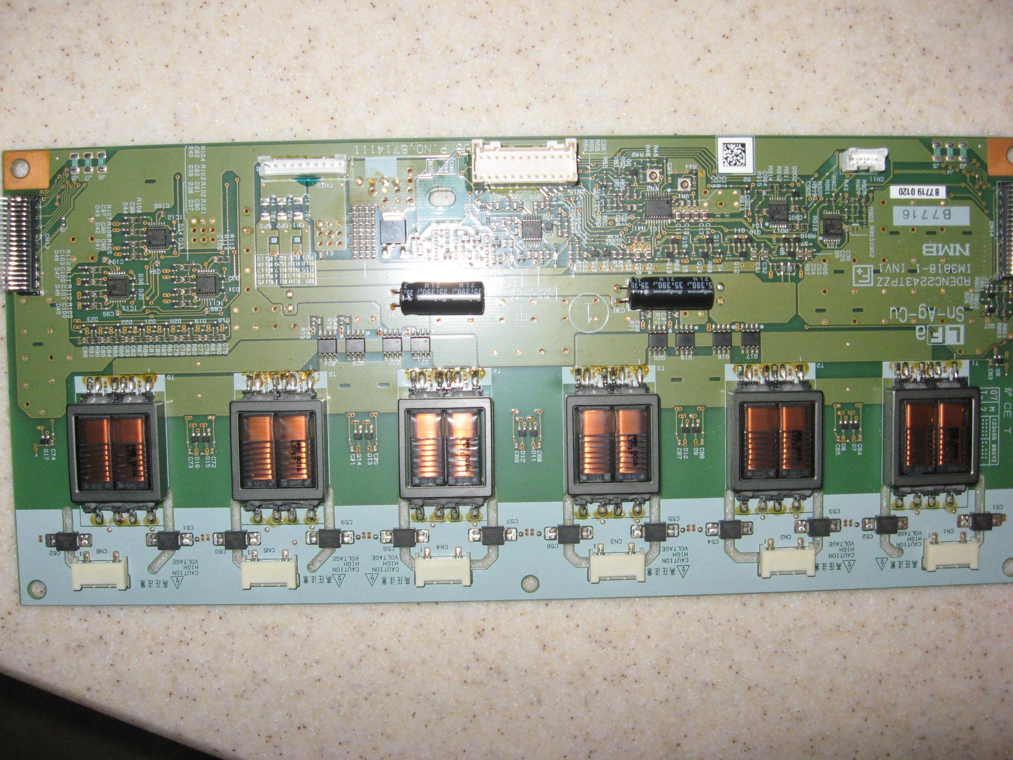

          The next step will be to get a part number for the inverter boards and try and find the pin-out of the connector going to the master. It's possible the main board is shutting down the inverters itself.
          • chcbearsfan
            • Oct 2011
            • 32
            #45
            Re: Olevia 265-t12 - no place to turn but the Internet
            Hi Tom I am not sure how to do that but I can get the part numbers. There are 4 different inverter boards. I will label each below the same way. Starting from the bottom left through clockwise.
            Inverter 1 - RDENC2244TPZZ IM3818-2
            Inverter 2 - RDENC2243TPZZ IM3818-1 (master - already replaced)
            Inverter 3 - RDENC2244TPZZ IM3818-2
            Inverter 4 - RDENC2246TPZZ IM3818-4
            Inverter 5 - RDENC2245TPZZ IM3818-3 (slave)
            Inverter 6 - RDENC2246TPZZ IM3818-4
            So what next?

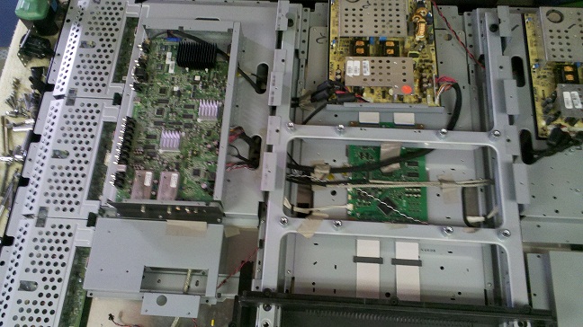

              Why does this TV have two power supplies?
              If anything I would look at the Power-supplies as the problem if one has failed and not providing power to one of the 6 inverters, that would be enough to bring the set down.

                #47
                A few posts back I noted the output voltages for each red wire on each inverter. They were all consistent and within an acceptable range per retiredcaps.
                I am at a loss at this point but it would appear the issue is inverter side? Any and all suggestions welcome. I have invested so much time in this I would hate to not be able to end up with a fix

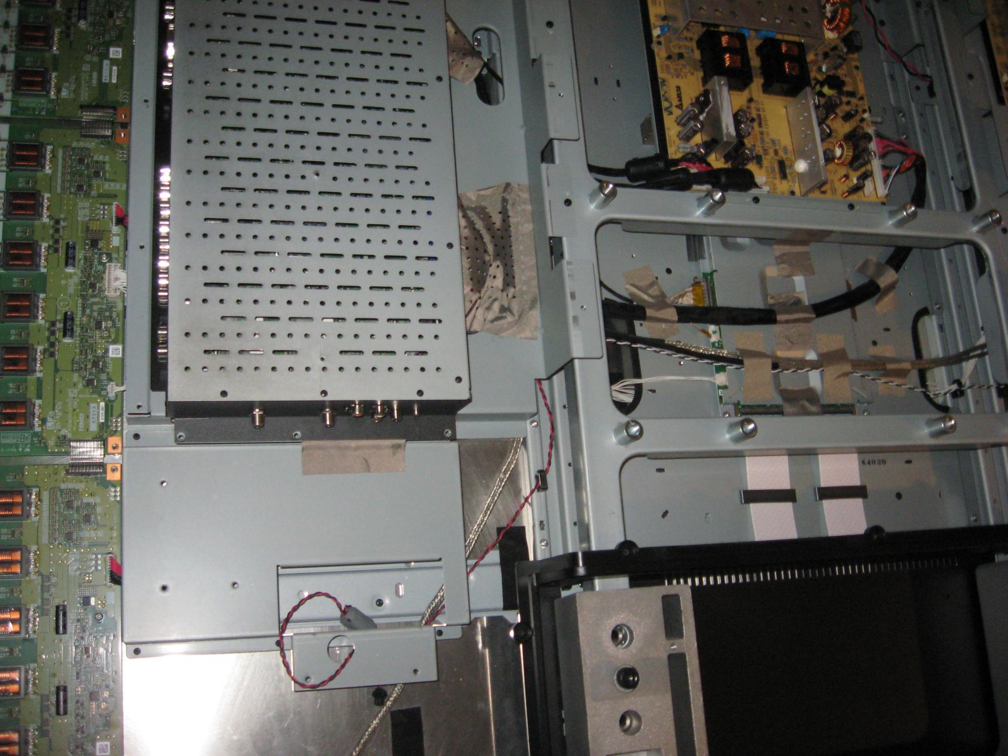

                      #50
                      This looks to be a really strange setup.
                      Is there any connection between the two power supplies,other than the AC source?
                      On the inverters do they all have there own controller for the inverter?
                      Where the inverters come together,is there a connection between them?

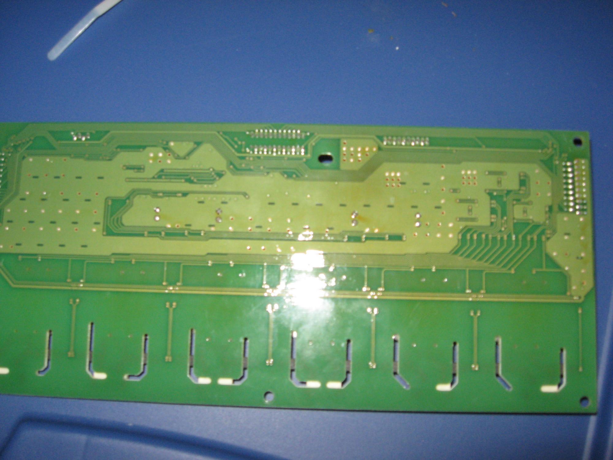

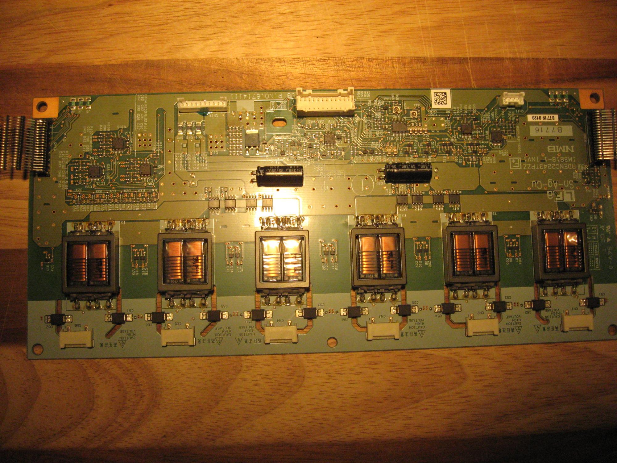

                        #51
                        Could you post a clear and detailed shot of the connector which connects to one of the inverters in this image with the white wires?
                        Does that connector go the main board? If so, post a picture on the main board side, too.
                        Also, try removing the inverter with this connector and posting a picture of the bottom - if you're lucky, there will be a key to the pins on the bottom.

                          #52
                          From the Power supplies there are 3 power outputs to the each inverter per board, totalling 6. Then there is a red/black connection, which is assume is the AC source and there is a couple of connections to the AV input section.
                          The inverters appear to be controlled by the middle inverter in the series where the ccfl outputs are blue/white wire combination. I am posting a pic of one I replaced and is dismounted from the TV.
                          The big white wire clump is where the master and slave inverters are connected. I took several pictures, hoping one of them gives a clear shot to the markings and is what we are looking for. Let me know

                            #53
                            The big clump of white wires is what connects the slave and master inverters together. The small bunch of white wires on the pics i just posted are what look to connect to a control board of sorts. I took oa picture of the back and also another where you can see the wires go underneath the AV in/out section and under the control headed to the other inverter board.
                            I copied a pic offline of what the exposed control board looks like. I would have to remove the power supply and the metal covering to get to it on my panel. Hope that helps.

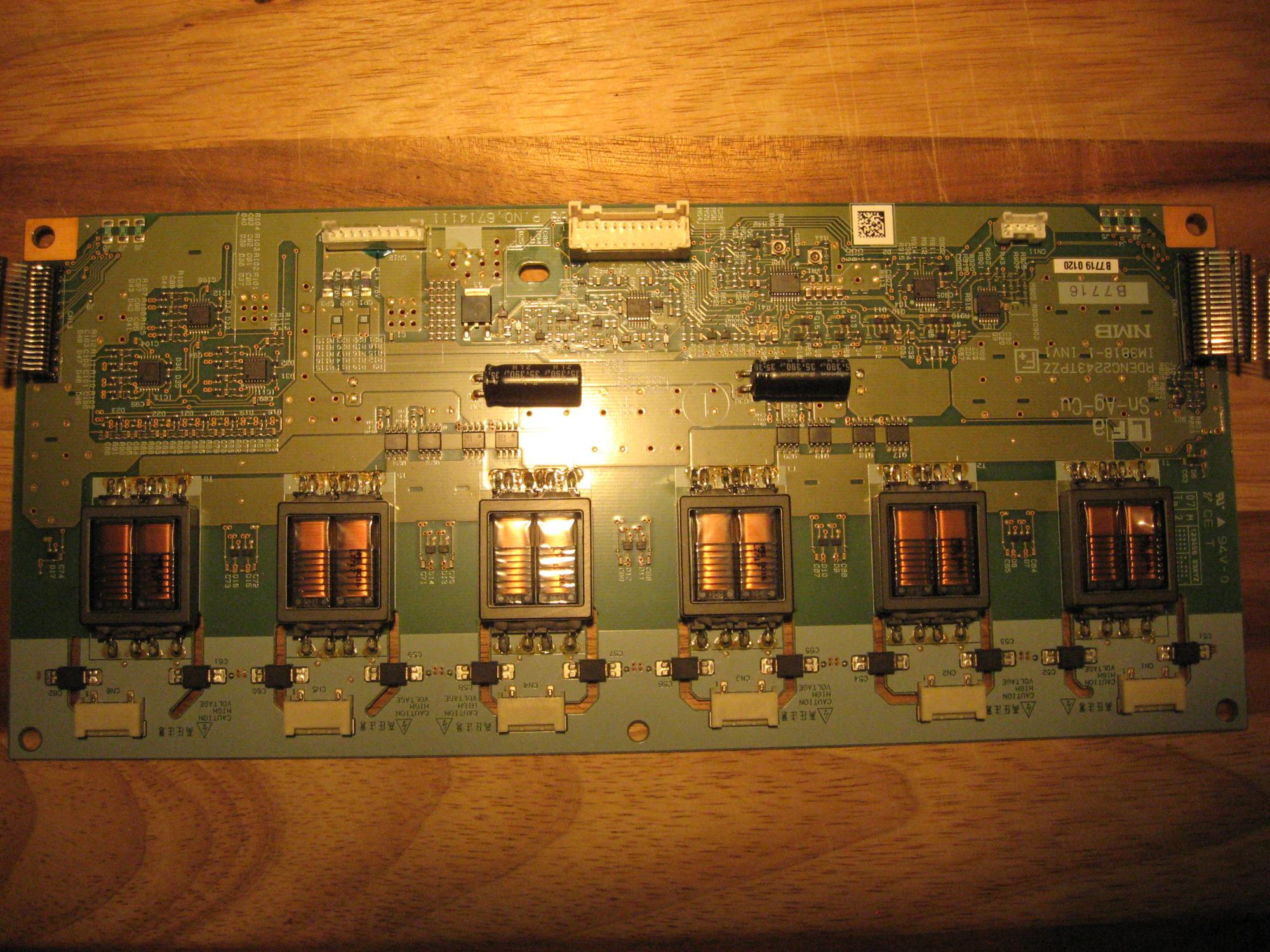

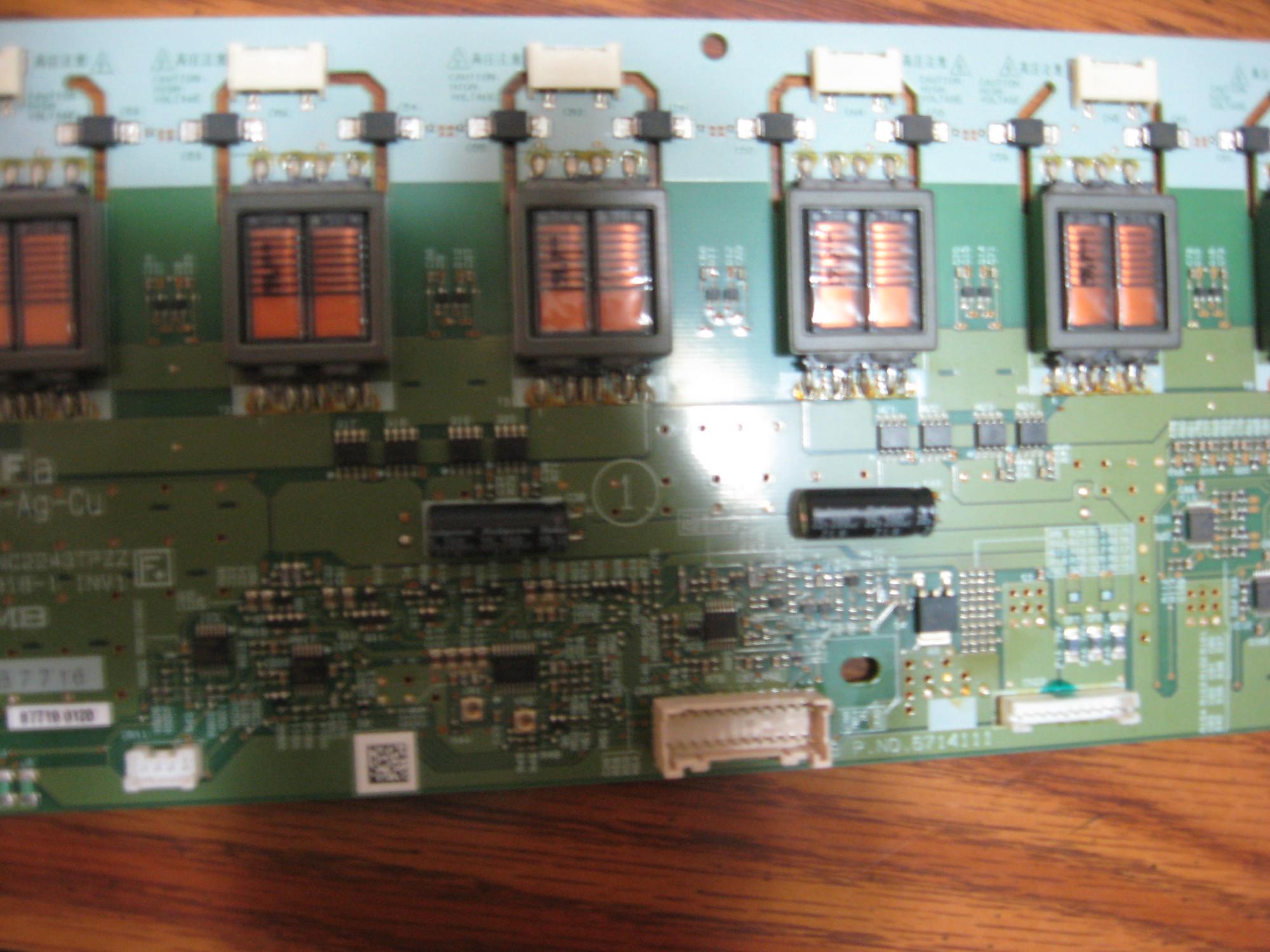

                              #54
                              I've tagged a number of semiconductors in the attached picture.
                              1 thru 6 are 16 pin ICs. What are the part numbers (I suspect they may be identical)?
                              7 appears to be a power transistor or voltage regulator. What is it's part number?
                              8 is the one I am most interested in. It is most likely the inverter controller. What is it's part number?
