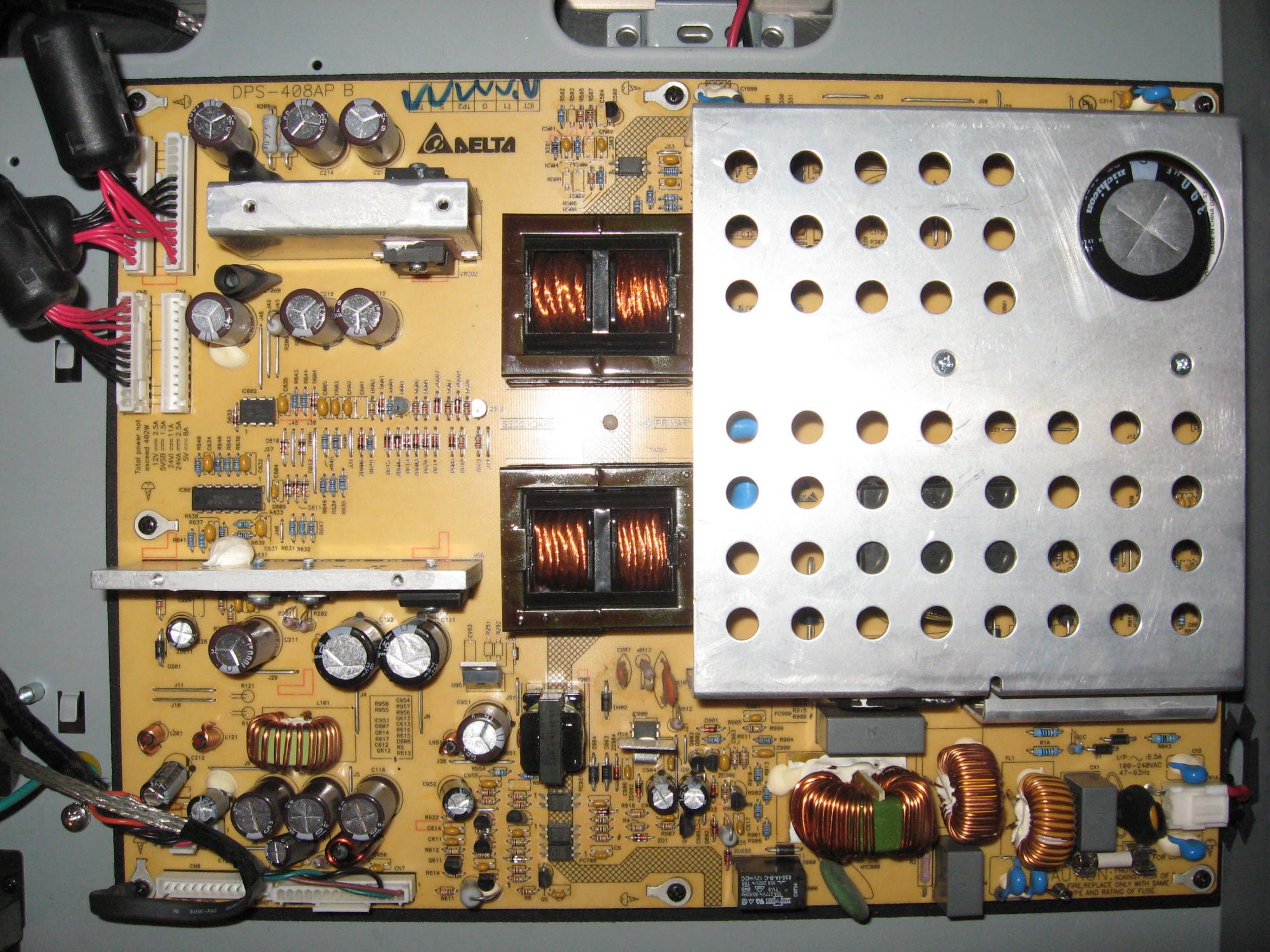

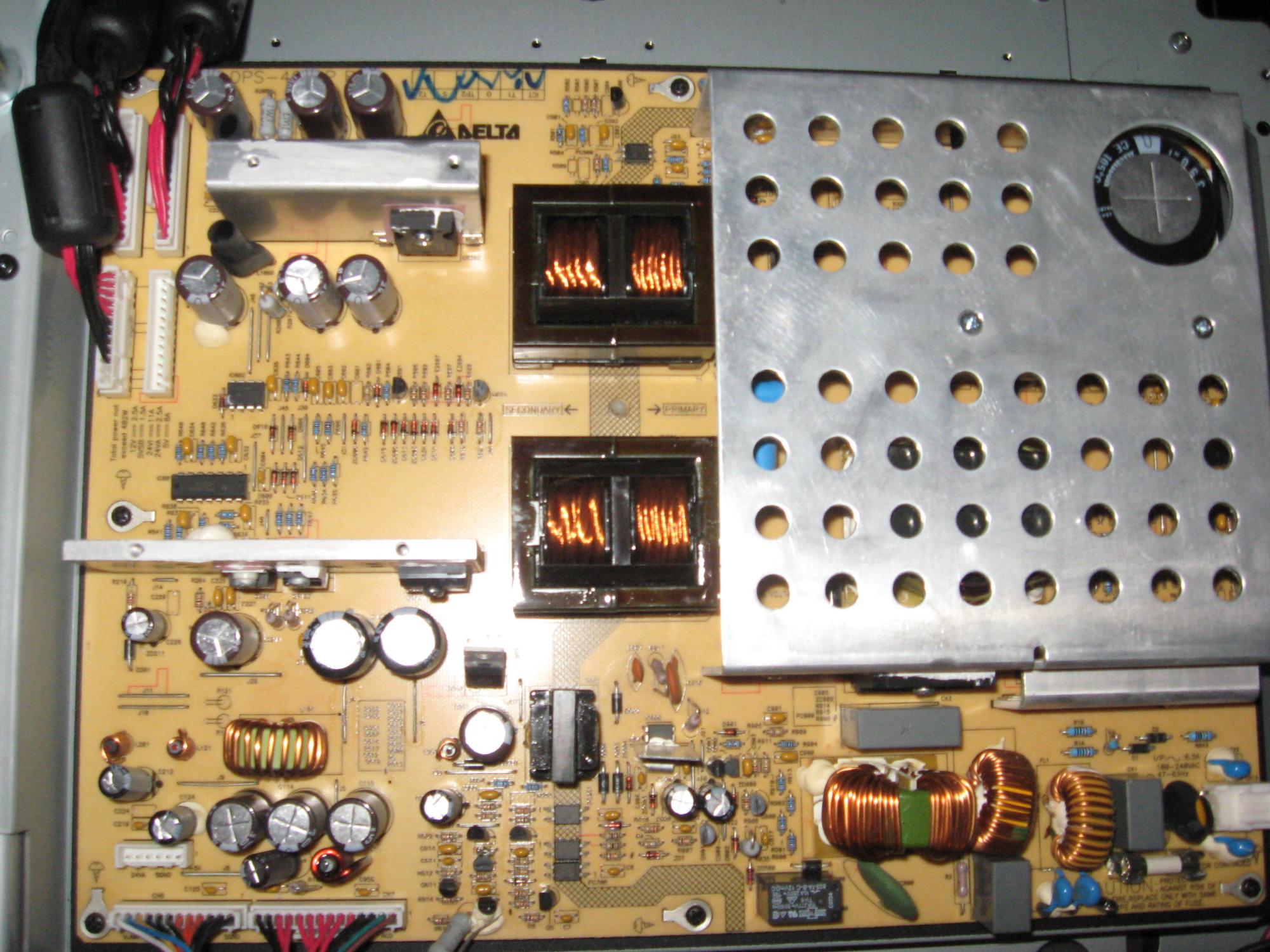

          Re: Olevia 265-t12 - no place to turn but the Internet
          I agree with retiredcaps; the transformers look good. The variation was less than 1%.
          At this point things get difficult. The choices are replacing a few caps from a manufacturer with a reputation for high reliability (Rubycon, on the inverter); replacing more caps that appear to be good (unknown brand on the 24V output of the power supply); or letting the inverter run with essentially no load.
          Let's take the safe approach. Wow, I just took a look at the first picture. Dual power supplies??? What are the brand and series of the caps near the 24V output of the power supply?
          Whoops!!! A few brain cells just kicked in - unusual for this time of the morning.
          Let's cover ALL the bases. First, another set of pictures; the first one showing the complete set of inverters. The next showing the power input area (the area around the connector with the red and black wires) of each board. All fuses should be checked; the only picture showing a power connection shows three fuses. A single open fuse could cause 'two seconds to black'.
          Next, a picture of the output connectors on each power supply; I'm hoping to see some indication of output voltages.
          And as I've already mentioned, what are the brand and series of caps in the output area (lower left corner) of the power supplies?

              Hopefully this covers everything.
              As for the fuses. I think each inverter board has 3 picofuses (sp?) from my research and on the power supplies I see what appears to be a fuse in the top right. Is that what you want me to test and what setting on the DMM should it be?
              Let me know if you need cleared or different pictures. The inverterboards with red/white power to the panel is on the right side and the blue white is on the left. The left has the master inverter board centered and the right has the slave centered.
              Edit - Unable to tell the mfg for the caps on the power supplies. They all appear to be the same brown ones. I took a closeup so hopefully you could tell from that
                          The "K" vent are Rubycons.
                          The brown ones with "Mercedes Benz" vent have a crown symbol on the sleeve are made by United Chemi-Con (UCC). Specifically, they are KZE series. The KZG series are definitely problematic as per (they are mainly used on computer motherboards, but I have seen bad KZG on lcd monitors as well)
                          https://www.badcaps.net/forum/showthread.php?t=2280
                          The ones with the "+" vent look like they are Nichicon caps.
                          All 3 are reputable cap manufacturers.
