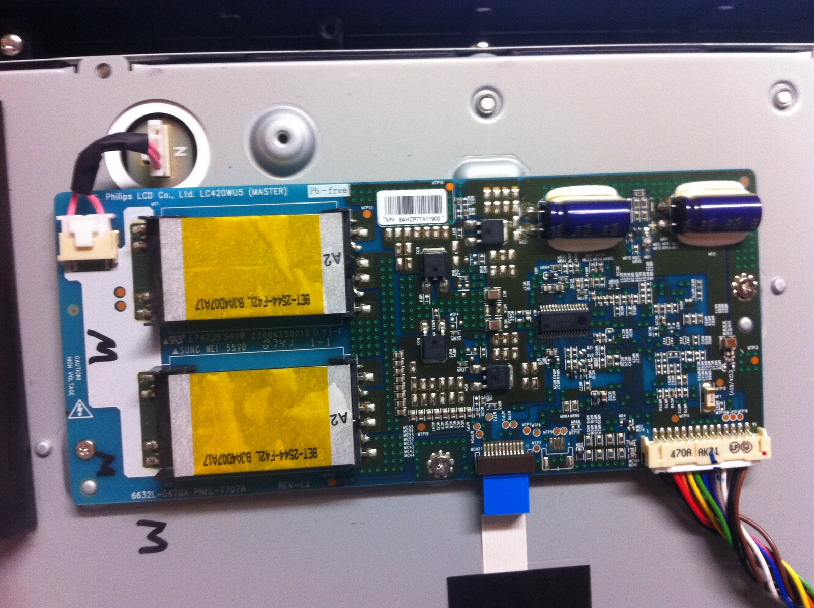

            Hello, I seem to be having a similar problem. The resistance was off on two mosfets so I replaced the IC on the slave board. Now they are all around 8.5k. The master board is at 8.5k as well.
            When turning the TV on, I get a backlight for about 2 seconds then it turns off again. Also, the blue light on the master board turns on, then off at the same time. Is that light supposed to be constant under normal operation?
            What else should I check?

              In the lcd computer monitor world, we normally ask people to check the resistance of the secondary inverter transformer pins. It should be within 3% of each other.
              Other possibles causes of 2 seconds to black in the lcd computer monitor world are:
              a) bad caps
              b) bad ccfl
              c) bad ccfl wiring (the return wire)

                    The backlight does light up fully for 2 seconds, does that rule out b) ?

                          I noticed in post #21, that each inverter board has a SMD fuse. MF1 and SF2.
                          If there are 2 fuses and if one fuse is open, this may explain 2 seconds to black.
                          So check all your fuses on the boards to see if they are good or not. A good fuse should measure less than 1.0 ohms.
                          We had a similar case where one bad SMD fuse caused 2 seconds to black. From post #19 section 3 (of the troubleshooting guide) ...
                          https://www.badcaps.net/forum/showthread.php?p=197027
                          edit: This is why we always insist on clear focused pictures. Having those pics in post #21 help.

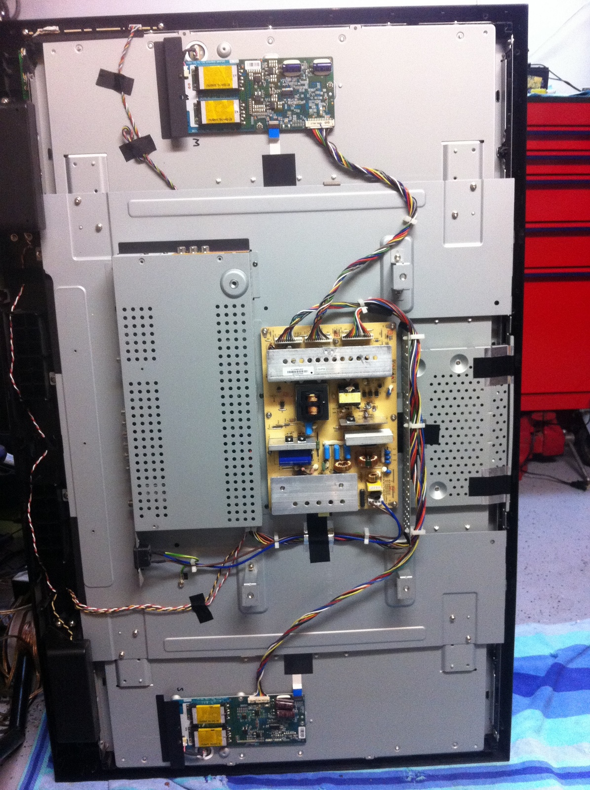

                                I agree there may still be a problem with the slave board. This is also the one I changed the IC on. (The MOSFET resistances are good now though).
                                Here is a photo of the back of the TV. I thought about trying to switch the boards but based on the wiring I don't think it would work. The master board has a 14p header from the PSU, while the slave has a 12p. The ribbon cables don't line up either.
                                With this arrangement can I not do your test of disconnecting all but one CCFL at a time?
                                  I mean just switch the pink cables that go to the ccfls. You will have to do some board acrobatics so exercise caution and use cardboard to insulate and prevent shorts.
                                  Or are the cables all keyed towards a master and a slave?

                                    I can't tell with the shielding how all the ccfls are arranged internally. Before you go taking things apart, there are a few more things to check on the inverter board and others may chime in with other suggestions.
