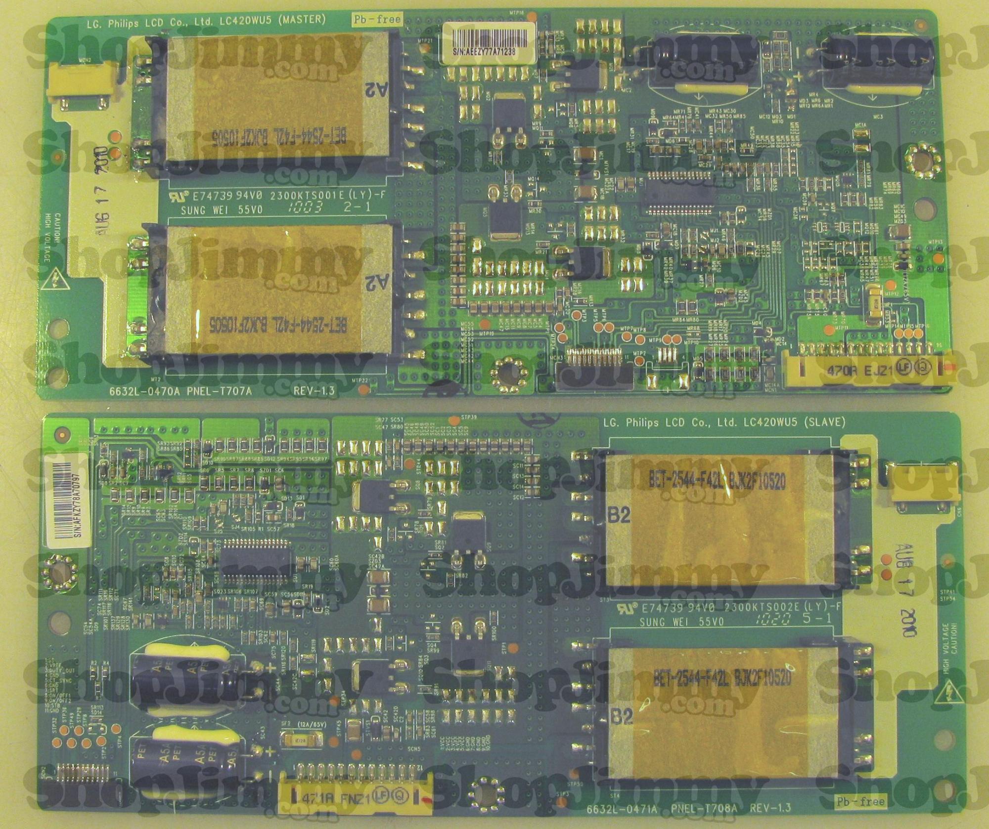

      Hi. Noobie here. But I have been reading the forums and they have Been a TON of help. I've never even picked up a multimeter until about a week ago but I'm trying to learn as much as possible. I really appreciate all the knowledge on this forum and the help.
      Let me first explain what I have. I also have a 42 inch vizio LCD but My model number is vw42flhdtv10a. I'm having the same problem as described by the first post in this thread. I have a black screen. I get a standby and power light. I get sound and if I hold a bright flaslight against the screen I can see the "no signal" screen saver bouncing around the screen. I can also hear sound, turn channels, change inputs, ect. I took off the back of the tv and figured that I needed the MOSFET and ic chips that everyone else is having problems with on the slave board. My inverter boards have different board numbers also. My master is 6632L-0470A and slave 6632L-0471A. I decided to check the ohms on both boards MOSFET chips. All 8 chips get about 8.2 to 8.5 ohms so I figured that wasnt my problem. I then started testing the ohms on the transformers. The two transformers on the master board both get a secondary reading of about 63 ohms and a primary of about .04 ohms. I figured that was probably normal. I then read the readings on the slave transformers but the secondary reads 1 on both transformers, that means it's not showing any resistance. It doesn't change from when the probes are in the air to touching the points. The second transformer reads exactly the same. It's kinda odd to me that they would both read that way. I figured that one transformer might have gone bad but for both to go bad just seems not probable. Do you think that it could be something else on the board causeing something to stay open or something? I have a feeling that the slave board has gone bad but I would like to fix it if possible, plus I can't even find a new slave board to buy anywhere. It looks like everybody's out of stock. Any help would be very much appreciated. Thanks.
      Lman
        #63
        Re: VIZIO VO42L No picture, No Sound
        1) Post top down view pictures of all your boards (back and front) following the instructions my sig file in post #61 (just above yours) exactly.
        2) Also post a picture of your multimeter.
        3) BTW, there is a huge difference between 8.2 ohms and 8.2k ohms. One is 8.2 and the other is 8200. When you leave out the multiplier, it leads us to incorrect conclusions. When I first read it, I thought all your mosfets were shorted with a reading of 8.2 ohms.

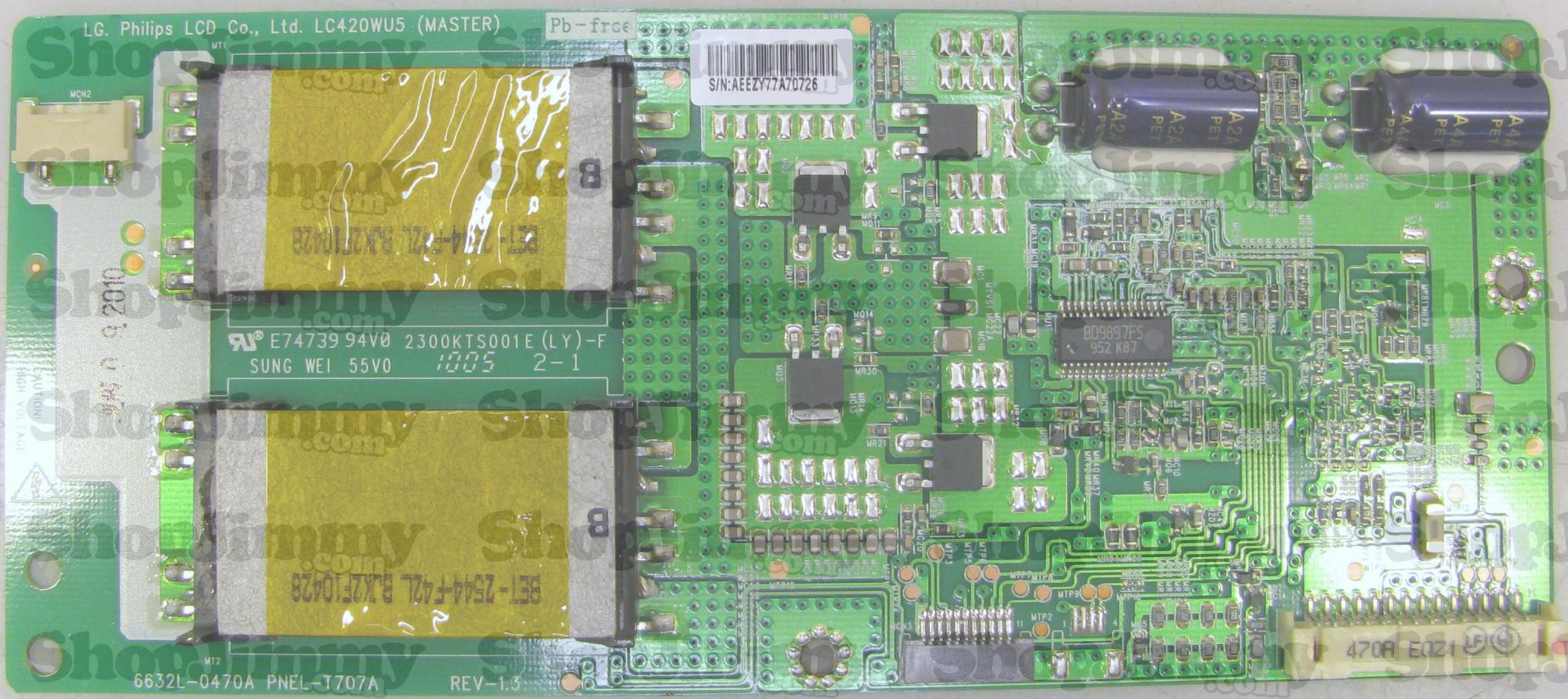

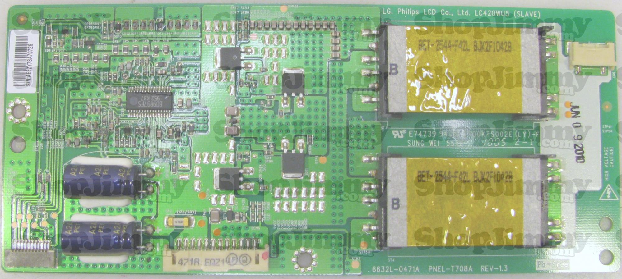

              Here is a few pictures of my boards off the Internet. It's not my actual boards, but these are the same boards that are in my tv. What would you recommend that I try next?
              I seem to have no problems with my MOSFET's but I don't know what to try next. My backlights aren't lighting so it would have to be the inverter boards right?
              How would I check the caps on the inverter boards? Are they checked with ohms also? I've looked very careful at all the boards and I can't see any burn marks or bulging caps.
                #67
                We prefer to see pictures of your boards for a number of reasons.
                1) Manufacturers make revisions or even complete board changes while keeping the same lcd model number.
                2) Your board, while perhaps the same, may have "aged" differently due to heat, cold, etc. Your board might have hot spots, poor soldering, glue turning conductive, etc. We have some members with eagle eyes.
                3) Just a few months ago, someone posted "I changed all the bloated caps", etc, but it doesn't work. It wasn't until he posted a picture of his recapped board that I spotted another bad capacitor. The poster also claimed he had 20/20 vision (which I do not have).

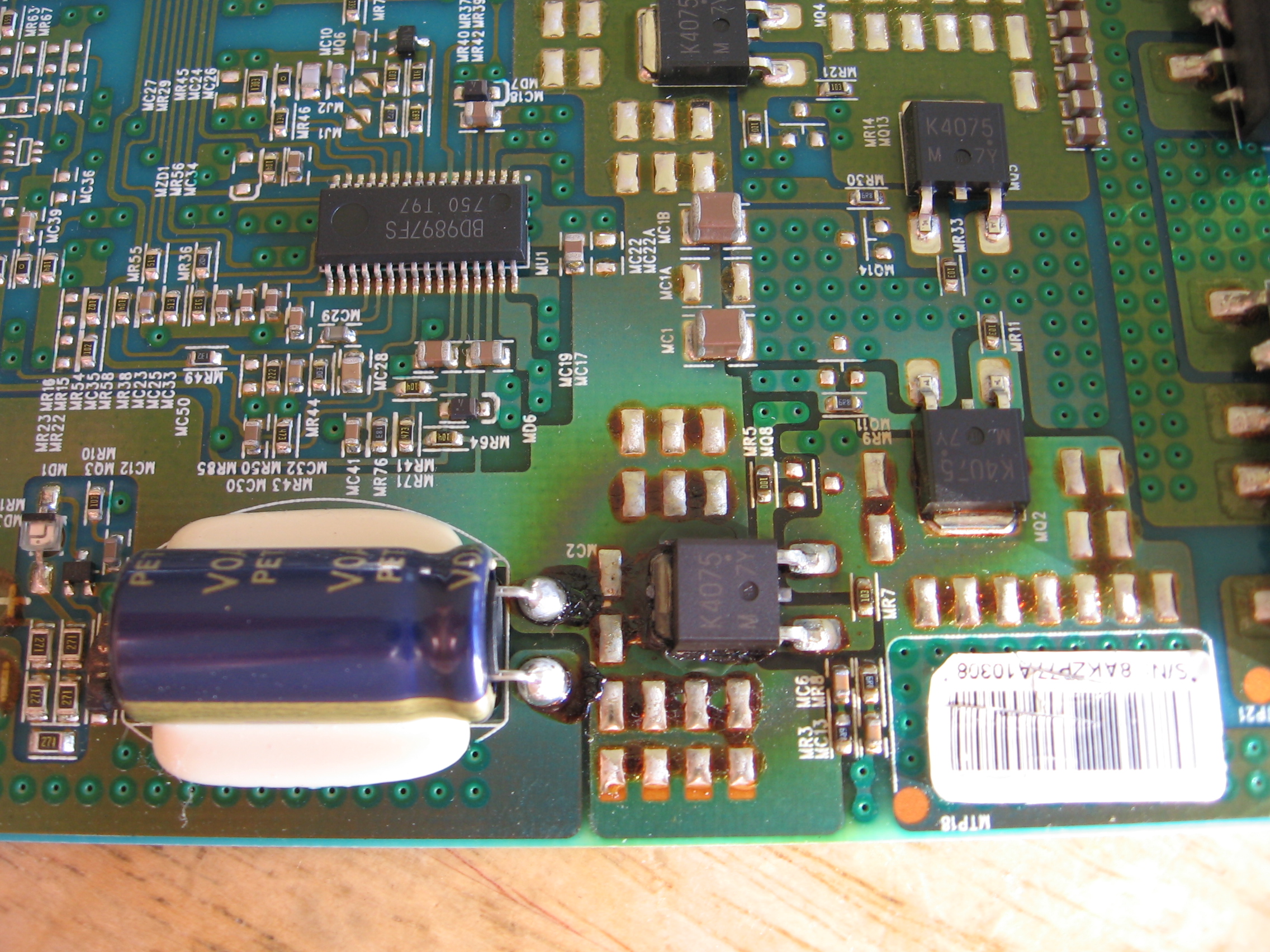

                    not sure the bad capacitor is cause or result but it definitely involve inverter failure.
                      #70
                      When those C filter caps failed, the circuits will get trmendous AC ripple feeding the circuits. You need to inspec the large PWM IC, and all the MOSFET.

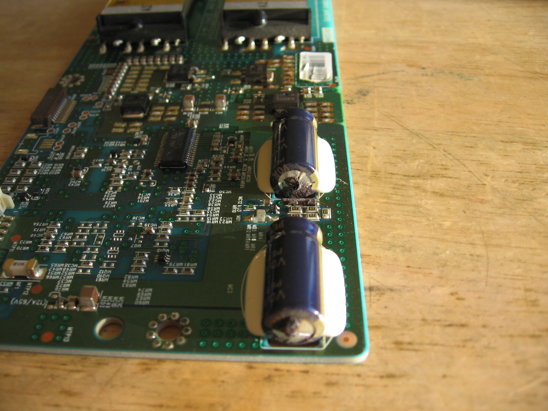

                        They are Samwha caps. Second worse caps known to man, just behind CapXon. The flux around the FET would make me suggest it has seen better days and may be dead, due to the increased current draw from bad supply decoupling.
                          #72
                          one FET sure fried. I plan replace all 4. BD9897 need long time to arrive. thanks everybody here.
