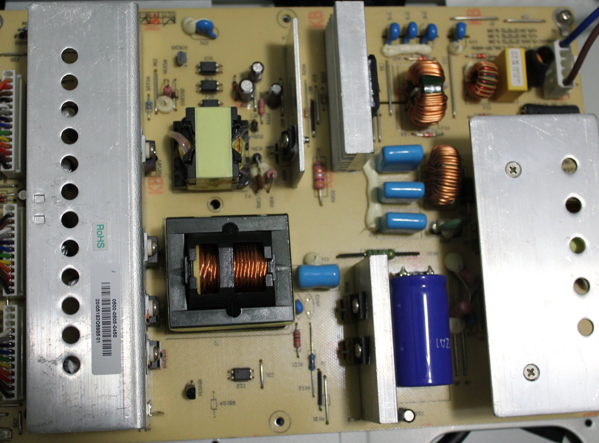

    The PSU is almost the same as this one https://www.badcaps.net/forum/attach...8&d=1289868833
    from this thread https://www.badcaps.net/forum/showthread.php?t=12041 Google for PSU part number, the PSU indeed also use in Vizio VX24L

    Good pictures of the top and bottom of the power supply are essential. Note the links in my signature for information on what we are looking for.

      I check voltage across the main big cap. 398VDC when ON and about 172VDC when standby.
      Most caps on the inverter are either made by Rubycon or Chemicon (KY). Is that a good thing?
      After taking the pictures, I try to plug all connector back to probe for LDO regulator, I forgot to plug in the 2 connectors for master and slave inverter board. I check 12V and 24V. To my surprise, 12V line read 11.9V and 24V line read 24.5V.
      So the problem is not the PSU. I need to do a load test on the 24V line to confirm that. For now, it's good

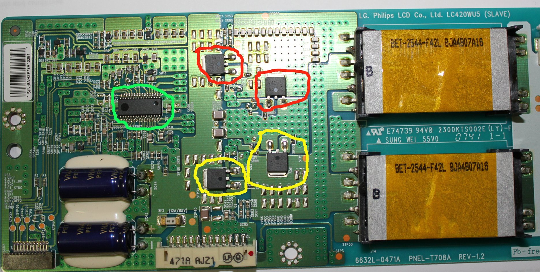

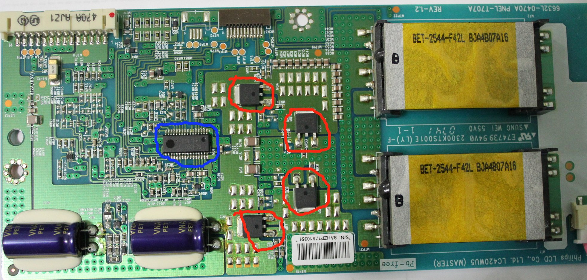

        I remember one post (#29) by Dgtech https://www.badcaps.net/forum/showpo...4&postcount=29 regarding checking for 4 mosfet along with the BD9897FS controller.
        Well on the master controller all 4 and 2 on the slave read 8.45Kohm. Those are circle in RED. Within the spec as indicated by Dgtech. the other 2 on the slave card give weird reading. 1.6 ohm and 7.6 Ohm. Those are circle in Yellow.
        Does that mean the controller chip (BD9897FS) is going south or only that 2 mosfet (K4075) are going on honeymoon?

          You are correct. This video driver chip is bad. It shorts out internally and gives a lower resistance on one or, in this case, two of it's four outputs. Once the chip is removed, with just the pads showing, you will see that the resistance check you made will go even higher. They should read 10K each. Place the new chip in, about 8.5K.
          The chips I get are from in China. I buy them on Ebay for about $10 each chip. Sometimes you can find a seller here in the US that has a few. If you can find this then it helps cause the shipping from china takes a while.
          I have a few here I bought in anticipation of seeing more of these TV's. I'll have to check my stash before I know if I can give up any. Check ebay first.

            After remove the chip, the 2 bad mosfet is still reading bad and 2 good mosfet is ready about 10K. I guess the bad BD chip probably isn't bad, but a bad 2 mosfet instead.

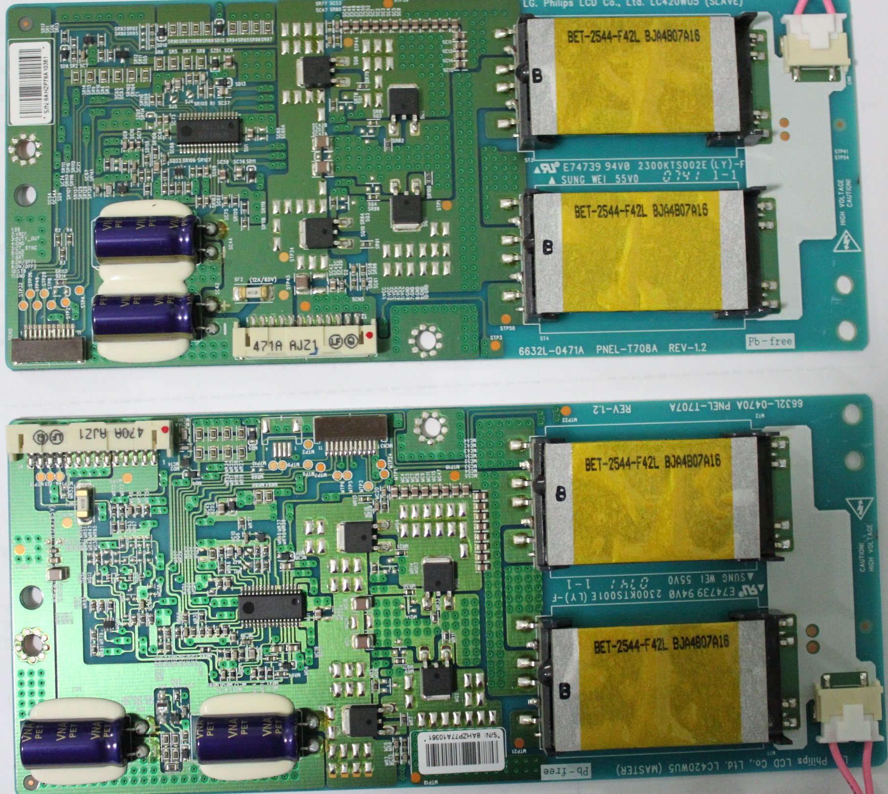

              Just order new inverter kits (6632L-0470A & 6632L-0471A) from fleebay for 120 bucks shipped.
              Let see if that fit the problem. Finger cross and waiting for new part to arrive

                    New set of inverter came. Replace the inverters and I'm back watching TV
                    Before install the inverter, I did check 8 mosfet and they all read 8.56k Ohm.
                    Also note, new inverter set has same part number but revision 1.3 board whereas the old on was rev 1.2.
