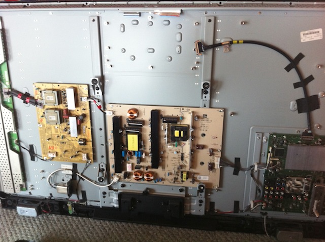

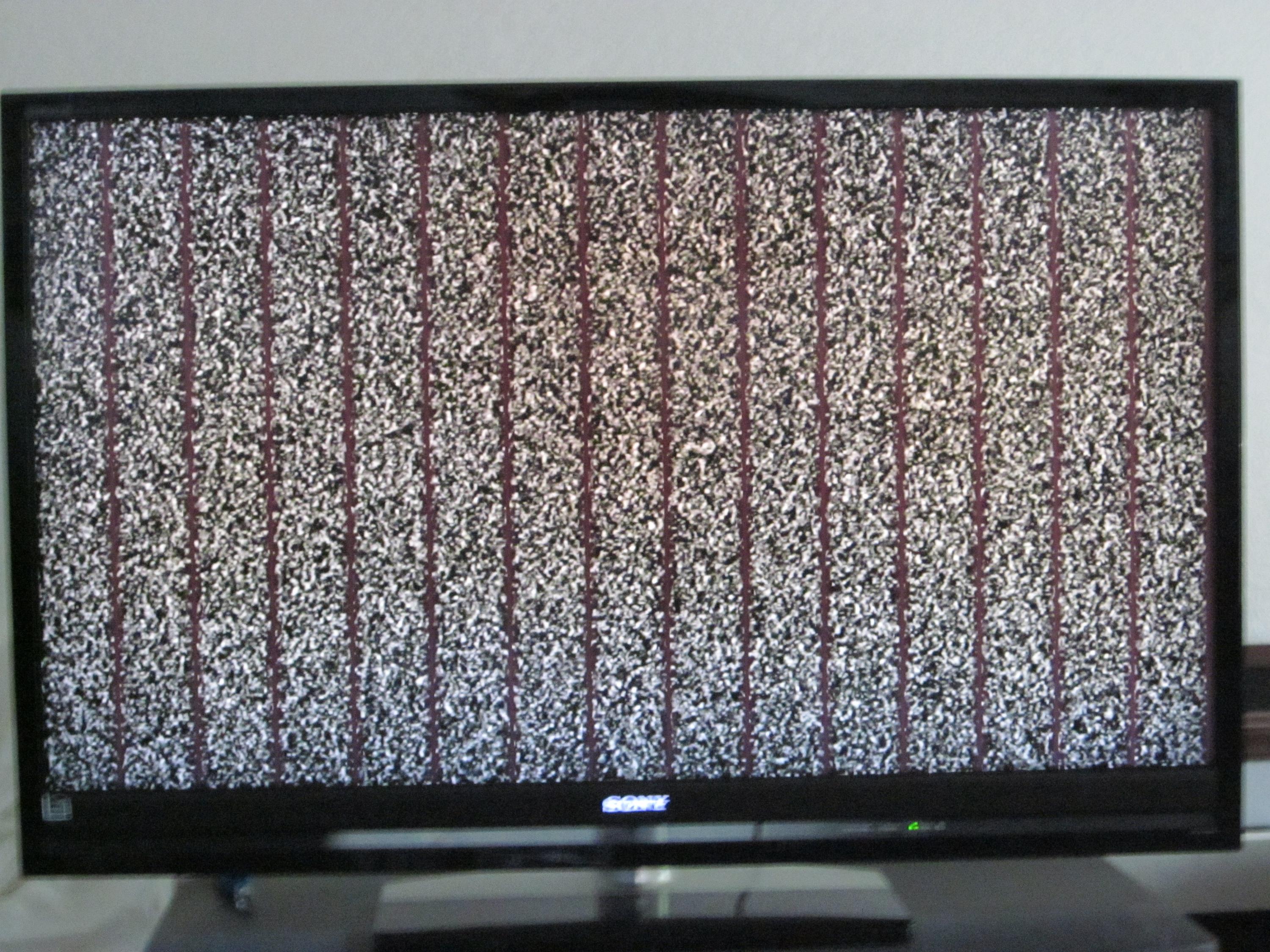

    Hey all, so I have a ran into a problem with the set. It went while it was on, and shows no blinking lights, etc. I read around here and took it apart and snapped some photos. I went ahead and ordered the LCD controller (TCON i hope) as that seems to the first thing to try out, as there are no power related symptoms. I have sound from inputs and the picture did come back (for a short while) when I squeezed the top part of the tv once (where the board is located).
    I've attached the pics. So the board had a part number on it and thats what I have ordered (T400HW01 V3), hopefully that was the right one. Anyone seen this sort of problem? or know anything else?

    Most cases this is your t-con board, however when you said you squeezed the top part of the bezel where it is located and it fixed it for a short while, usually that indicates that the lcd ribbons are not making direct contact. To make sure what you would do is carefully lay it on its back side with the screen facing upward and take off the bezel and metal casing (be very careful while doing this) and once you have all the top ribbons exposed you then would want to go down the line and gently press down on each ribbon (while the tv is on, again be very careful, and you want to use something as small as a baseball card because it will not conduct any electricity) and see which one resolves the problem. If it does resolve the problem then there are 2 options you can do. A. you can try to find some foam of sort and set it in place so when the bezel is put on it will put pressure on the ribbon causing it to fix the problem or B. Get a new panel. The reason i say get a new panel is because if it is the ribbon issue, its usally due to the connection not being very well and in essence you have a bad panel. Its more of a temporary fix but hey it beats buying a new tv again. Hope this helps!

          So the part arrived today, replaced the board (T400HW01 V3 40T02-C04 Ctrl BD), its the main lcd controller board on top of the tv. I ordered this from company called usefulparts. So anyways, I swapped the boards and the entire screen lit up, but the lines were begie/very light colored, so i thought I had gotten the board for another tv (as this board is used in other tv's as well, the 40z4100 for example.) After almost giving up, I again unhooked the board, and put it back in again, this time trying to get the ribbons perfect. And guess what, it worked!
          So there it is, full screen of lines, TCON or LCD controller board fixed it. Hopefully someone can use this info in the future.

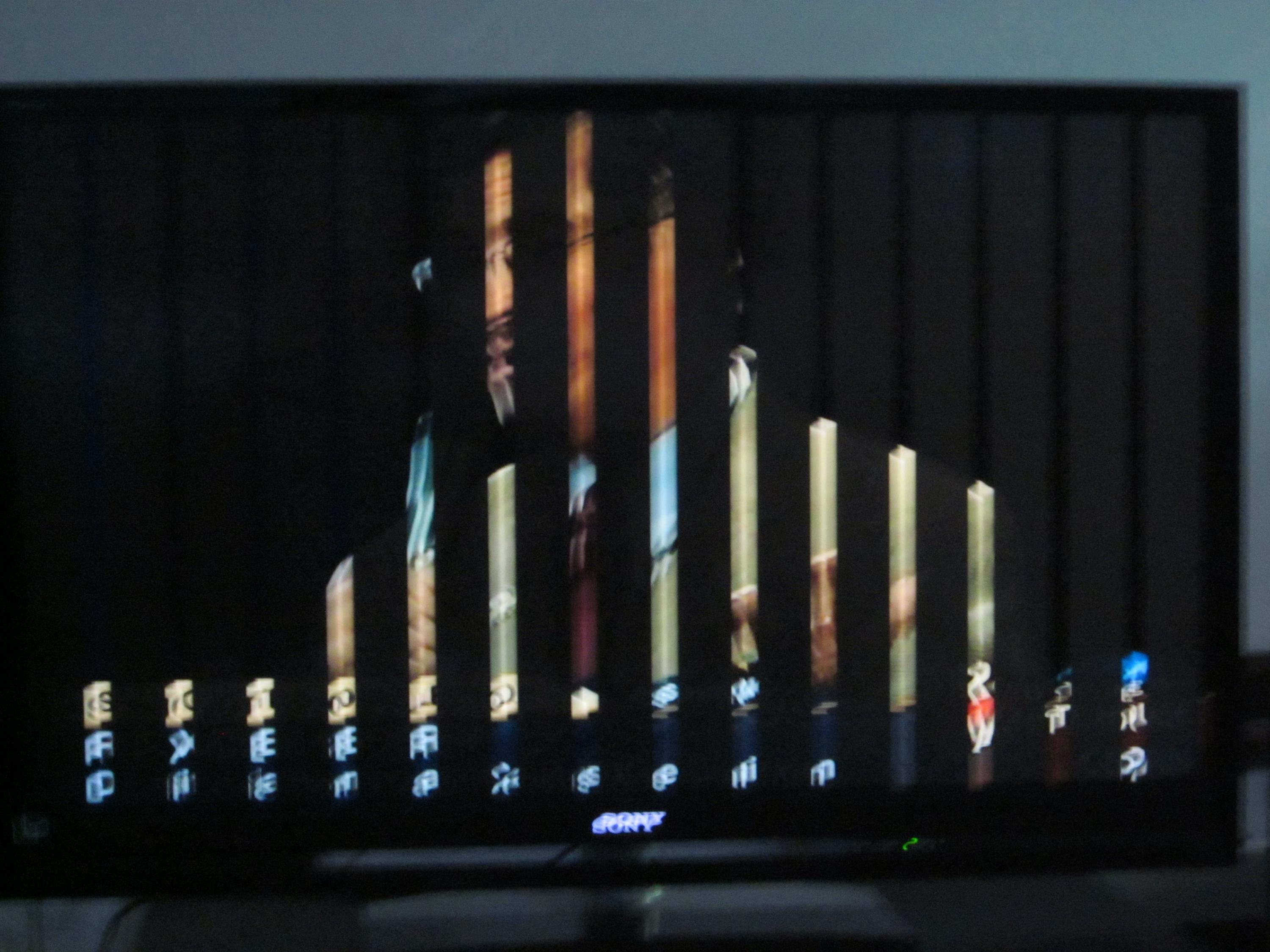

                      Please see attached pix . They're a bit blurry, but I didn't have much time before the screen went black.
                      I think that the Initial Setup loop may be caused by a watchdog timer that resets the TV. I don't hear a power relay cycling when the Initial Setup restarts. But that's just a guess; nothing was mentioned in the service manual.
                      After the coax was disconnected, I didn't see the firmware update screen. Other than the LED in the USB gizmo flashing when I plugged in the TV, there was no indication that the firmware was being update.

                        That look like the T-CON board as you still get an image so main is processing data correctly it seems. It looks like (if you pictures are a progression of what happens) it works then progressively goes down hill from there. Take a good close pic of the T-CON board please.

                            It basically takes your video signal from the main and converts it to a signal for the LCD panel. The panel works by allowing light to pass through your RGB filters which is controlled (refracted) by your liquid crystal controlled by voltage. The liquid crystal has very predictable effect to voltages so it sends a voltage to (x,y) for the pixel to produce whatever color.
                            If you're careful, you can re-use the tape used in the set. It's usually there to hold the cable down (I suppose less stress) but usually not unless it is a conductive tape but in your case it'll just be holding down the LVDS.
                            No worries and you won't usually hear anything...well if you do then that might be something to worry about
