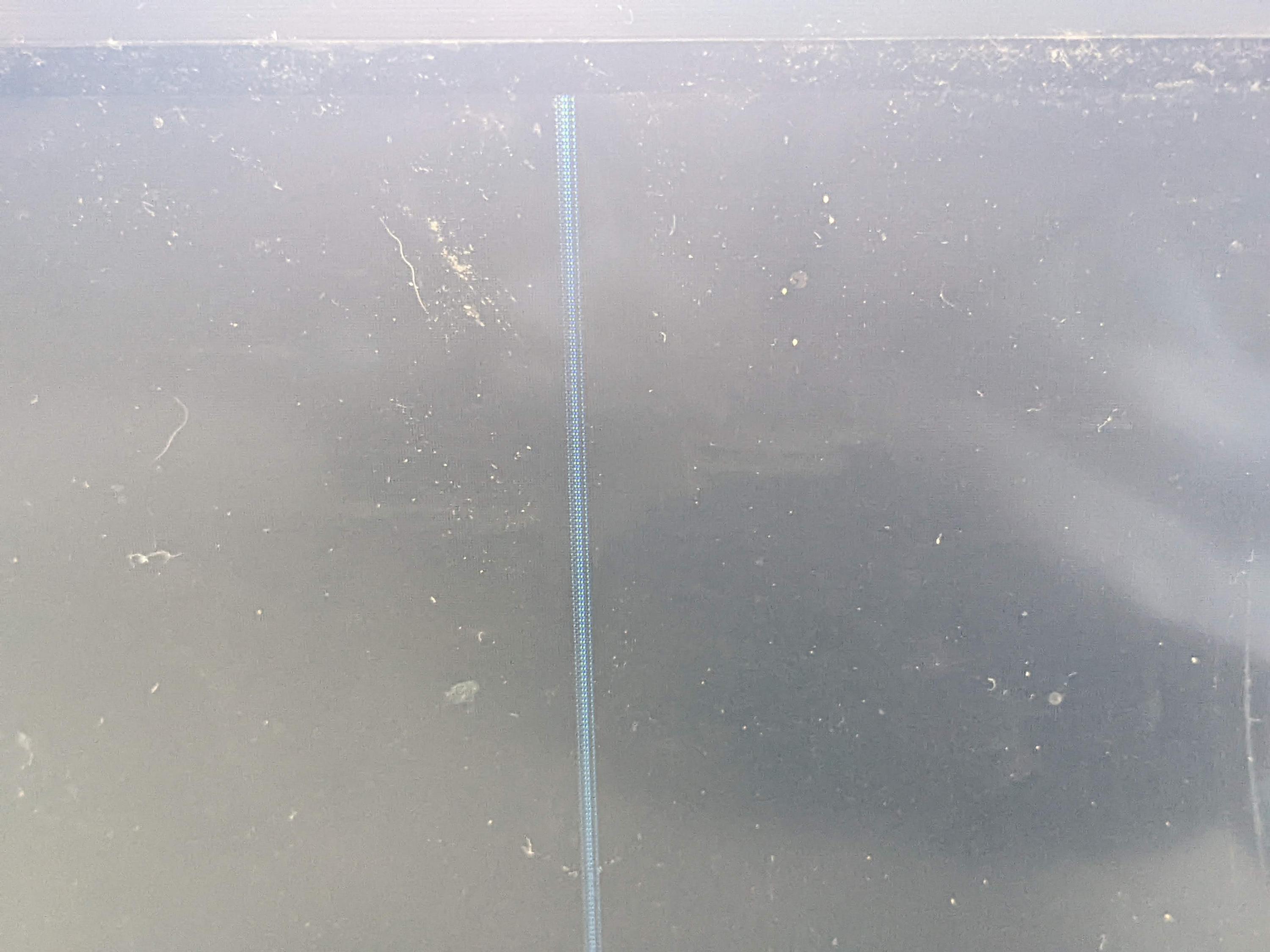

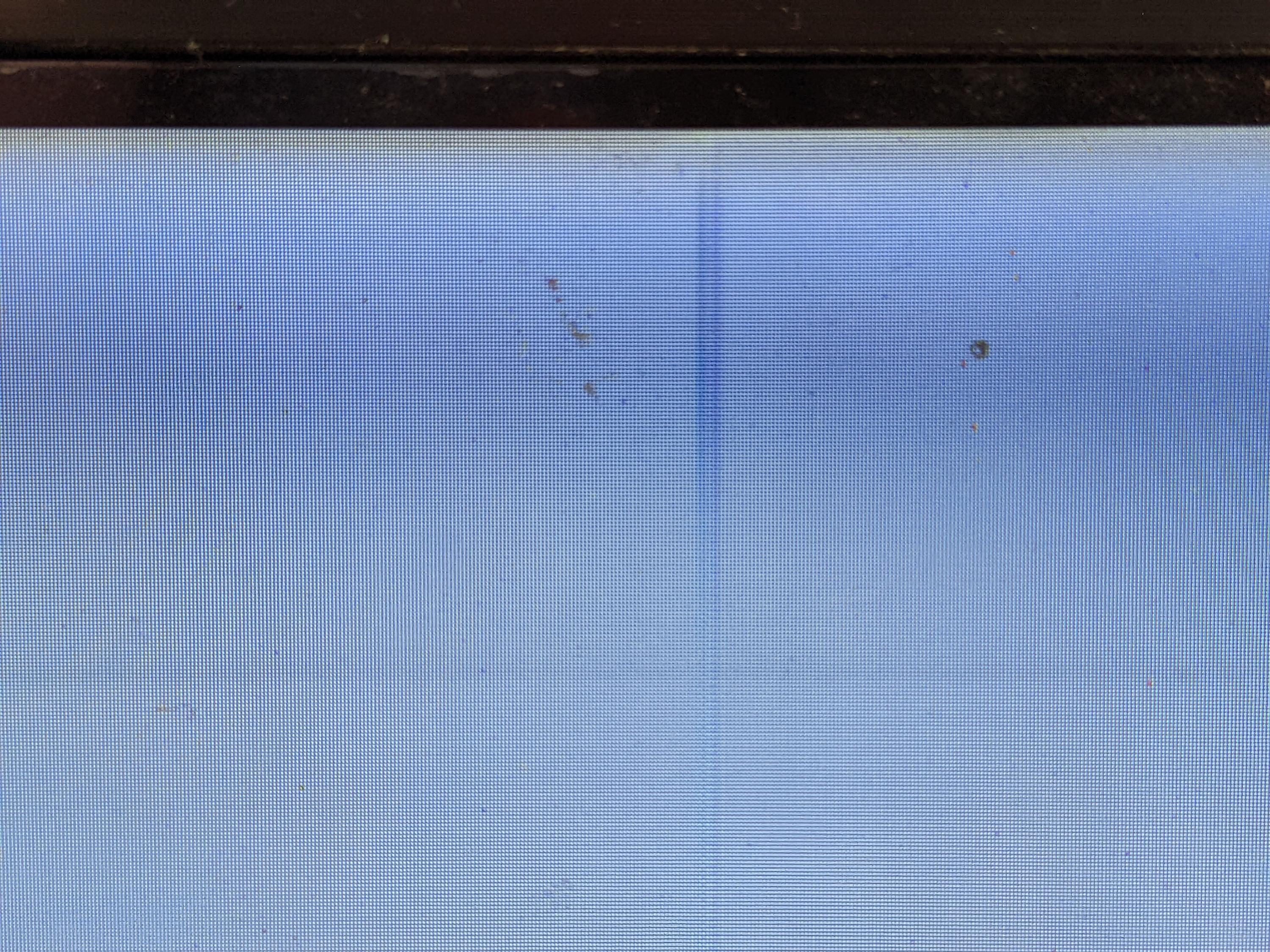

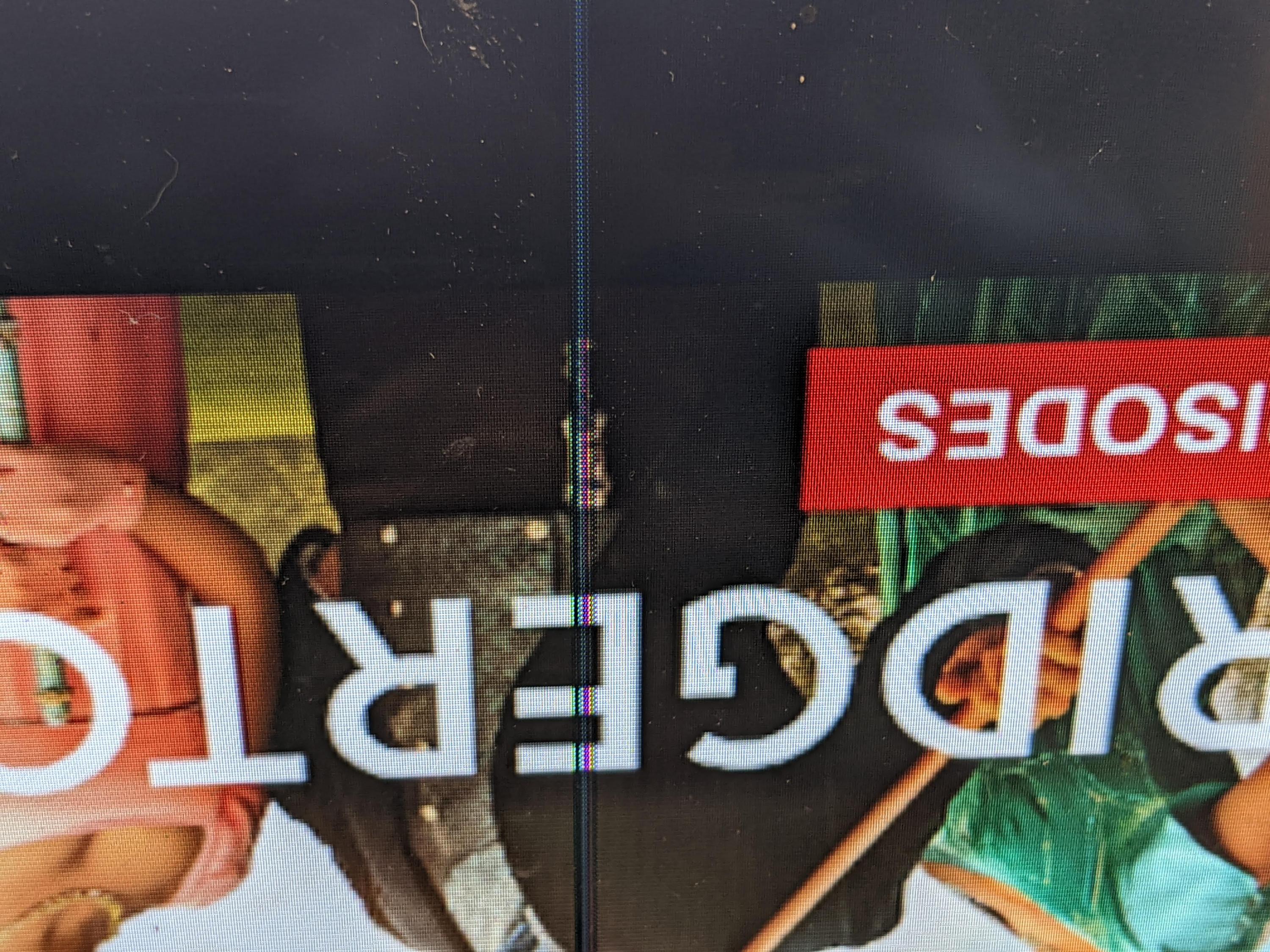

    I have a Sony 55x8000f that has three vertical lines (three different colors), with the lines still showing when the cable from t-con board to the panel is disconnected. Am wondering what might be causing this? Unfixable panel problem?
  • iampivot
    • Nov 2015
    • 24
    Re: Three vertical lines without t-con board connected: Sony 55X8000F
    The line is still there if the other t-con cable is connected, but not there if both are disconnected. could it still be the t-con board even if the flex cable is disconnected on that side of the panel?
    • neilc6
      • Nov 2015
      • 1550
      Vertical lines are bad panels and not the tcon board. Google Sony tcon training manual.
      • iampivot
        • Nov 2015
        • 24
        Thx. So either a tab bond or driver IC issue i assume. Or can the issue be inside the actual polarisers? Since it seems to be a couple of lines, I'm inclined to believe it's a driver IC issue?
