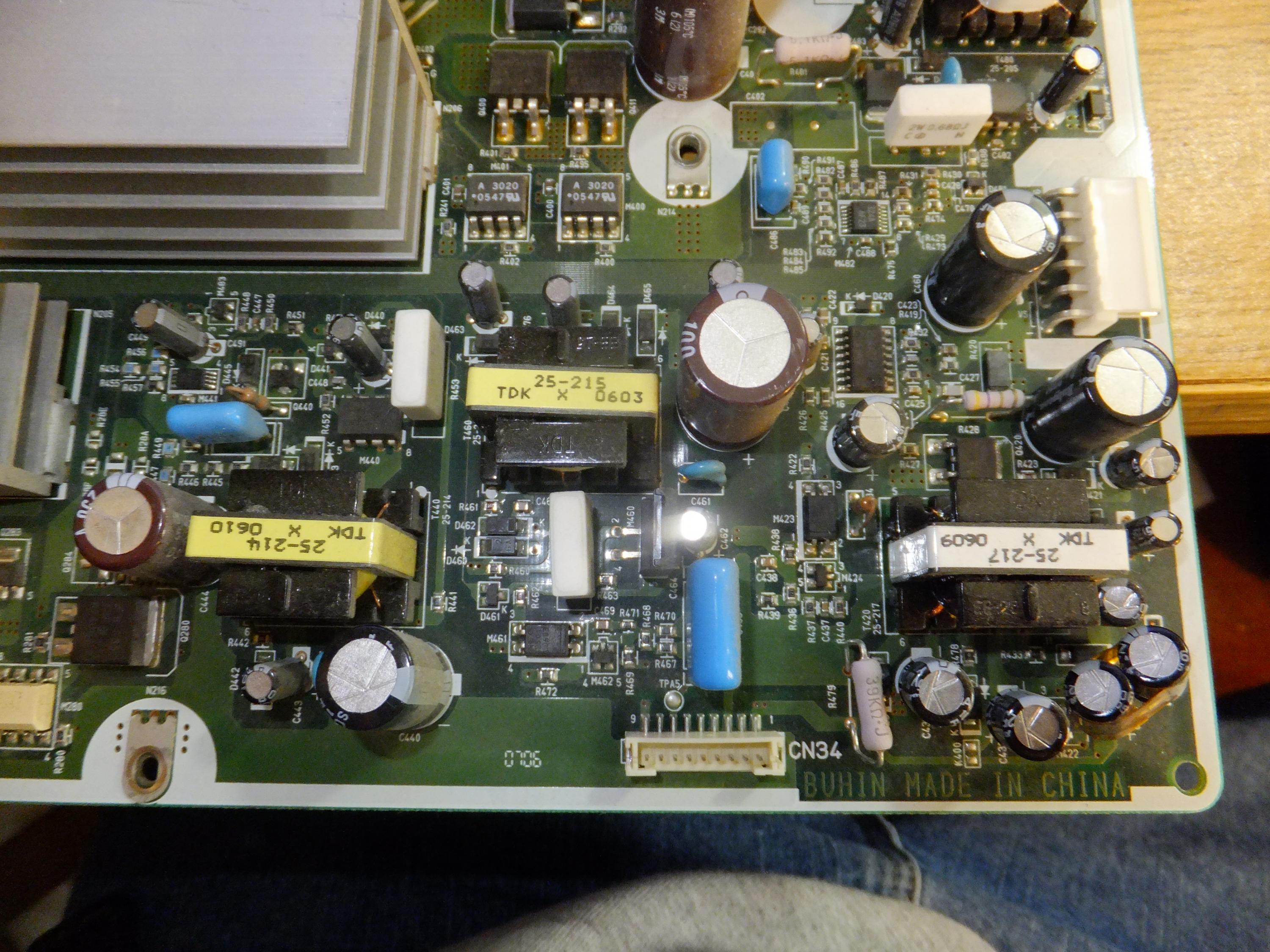

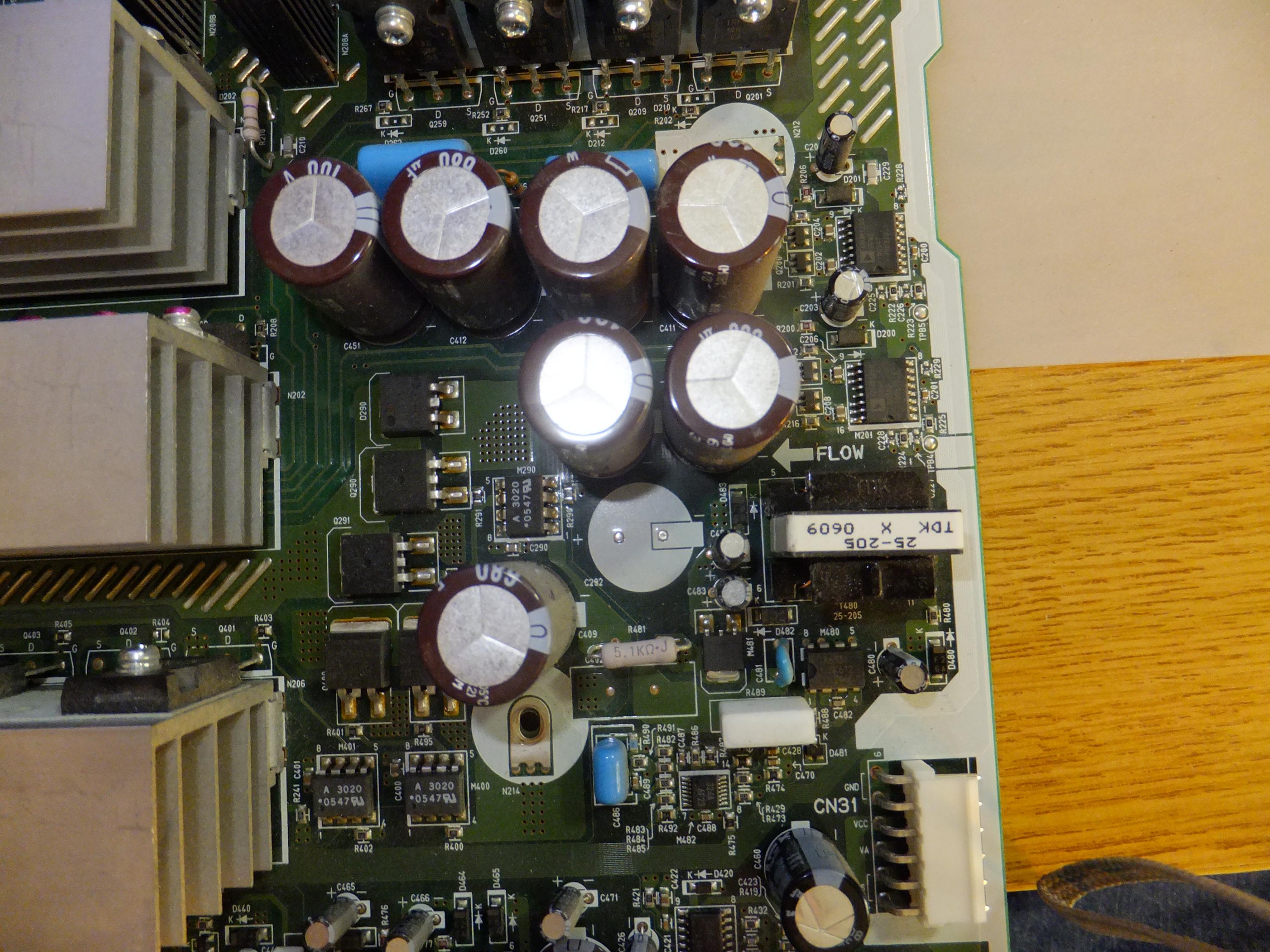

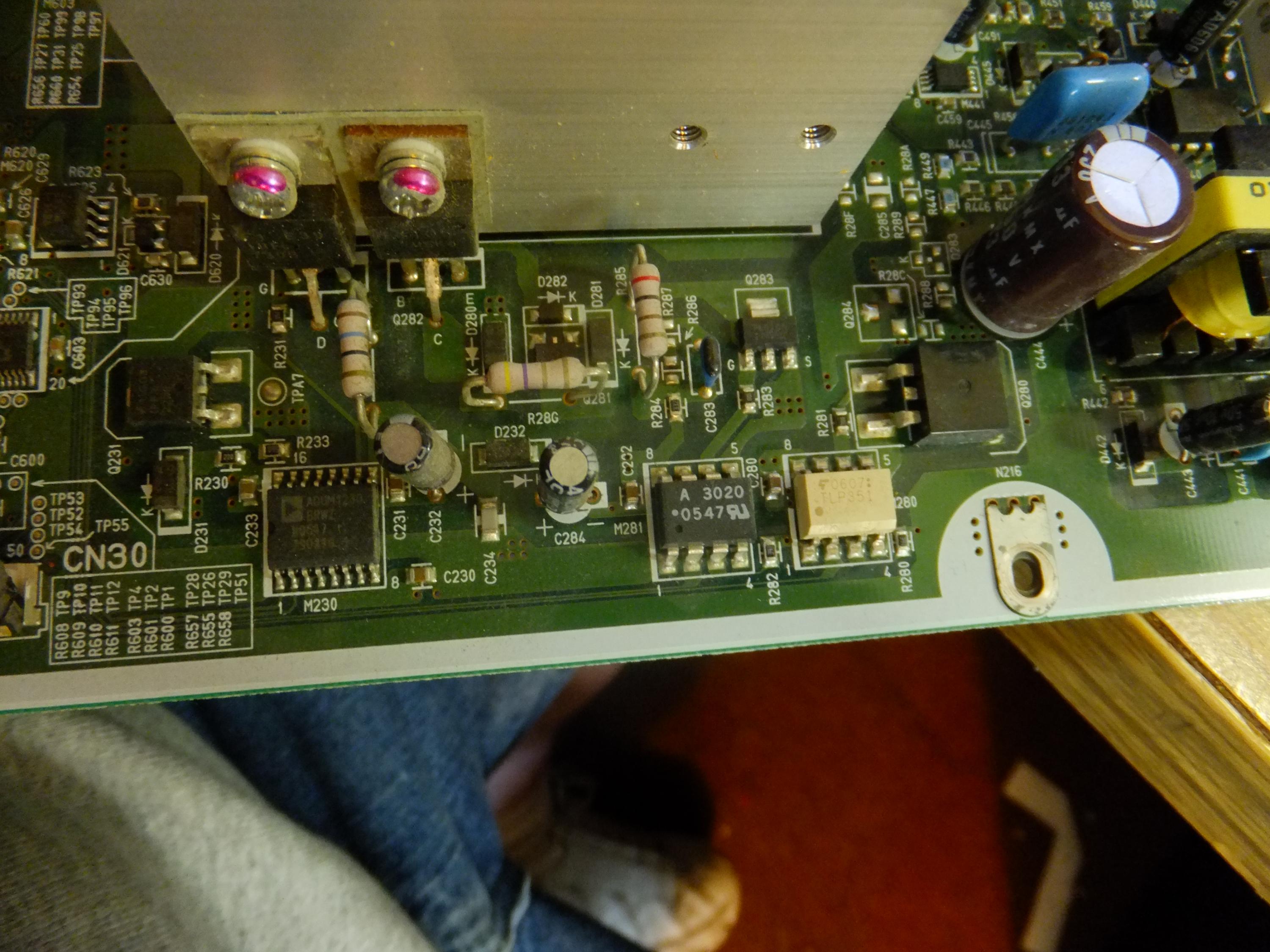

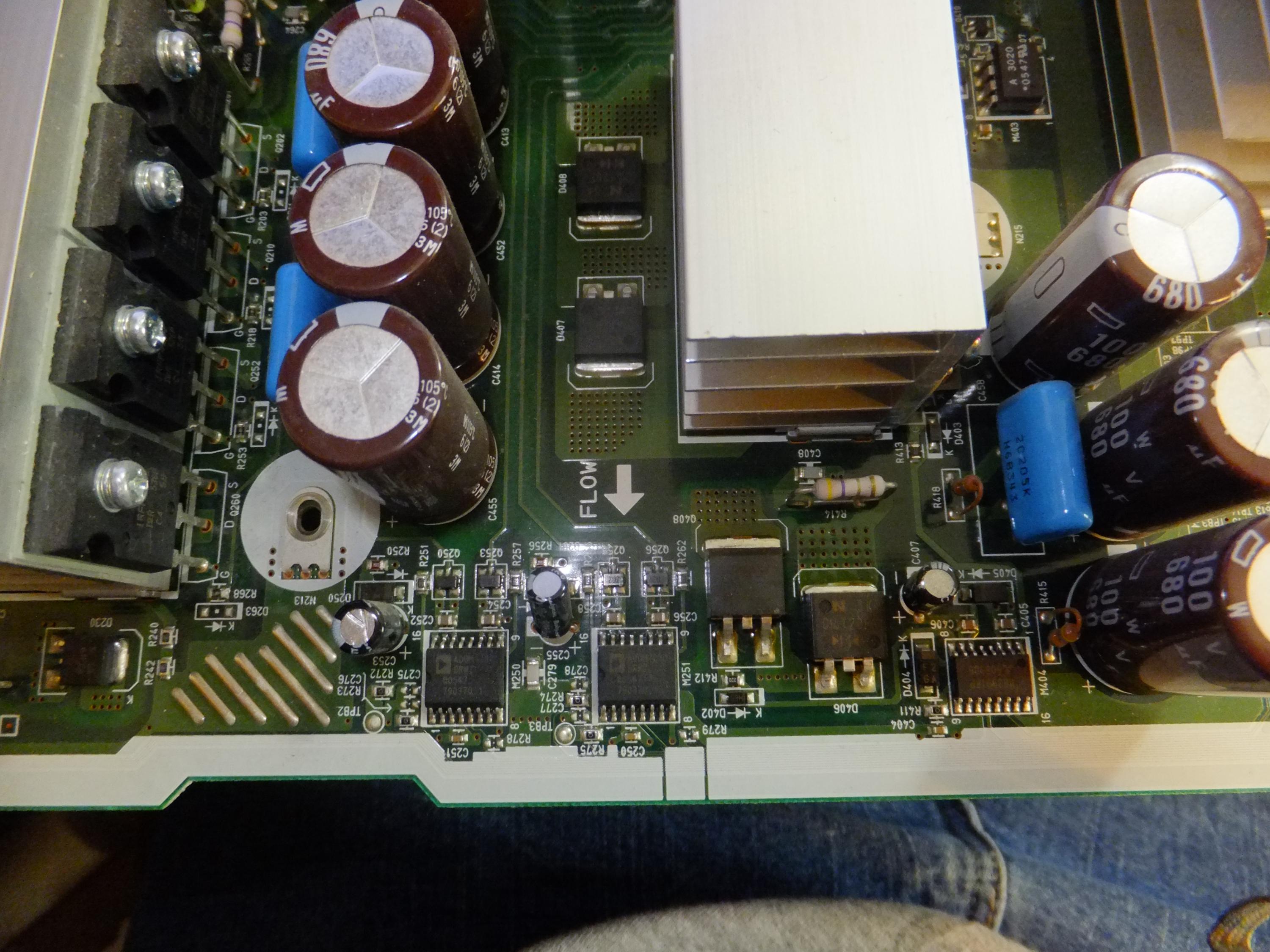

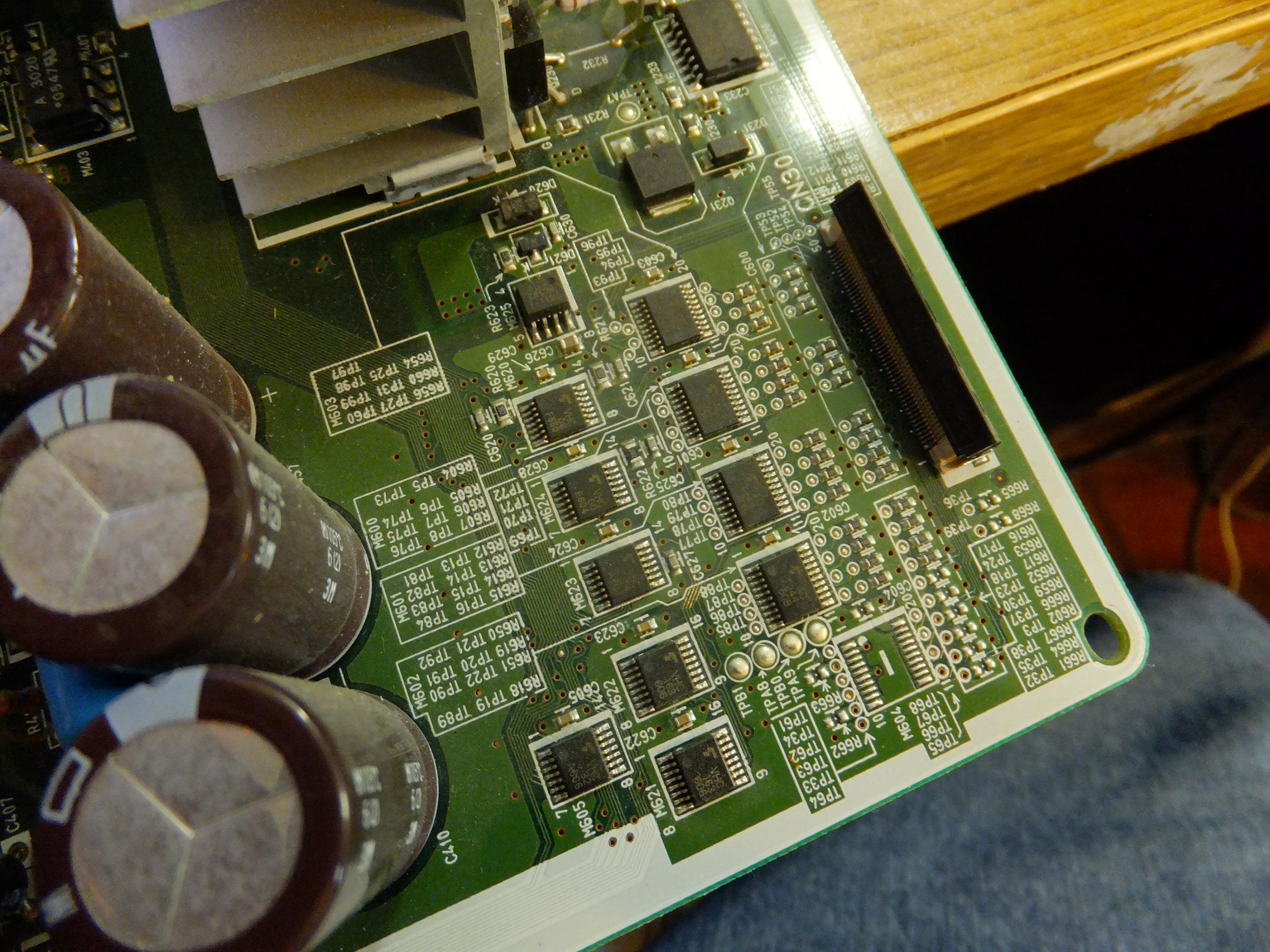

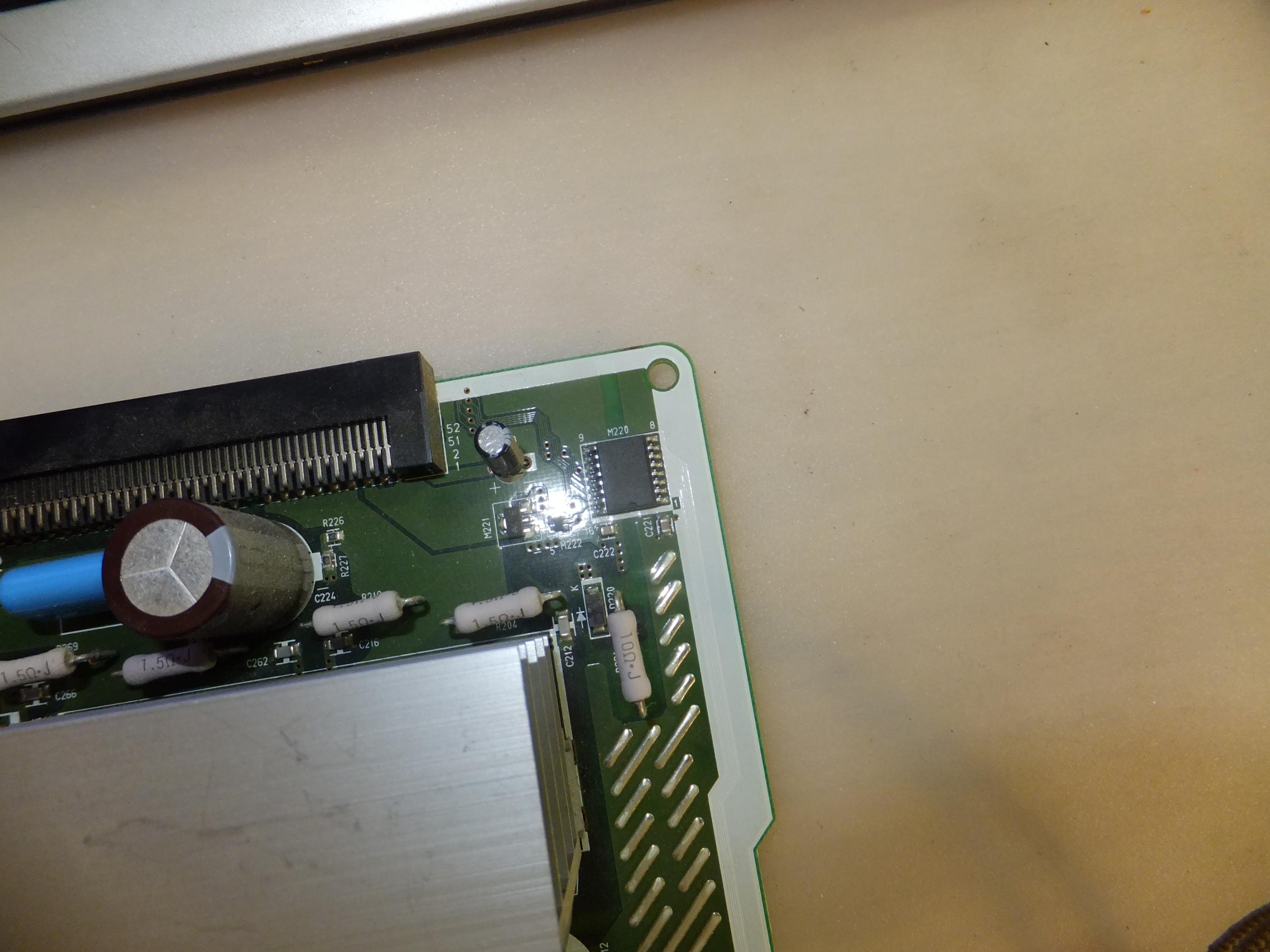

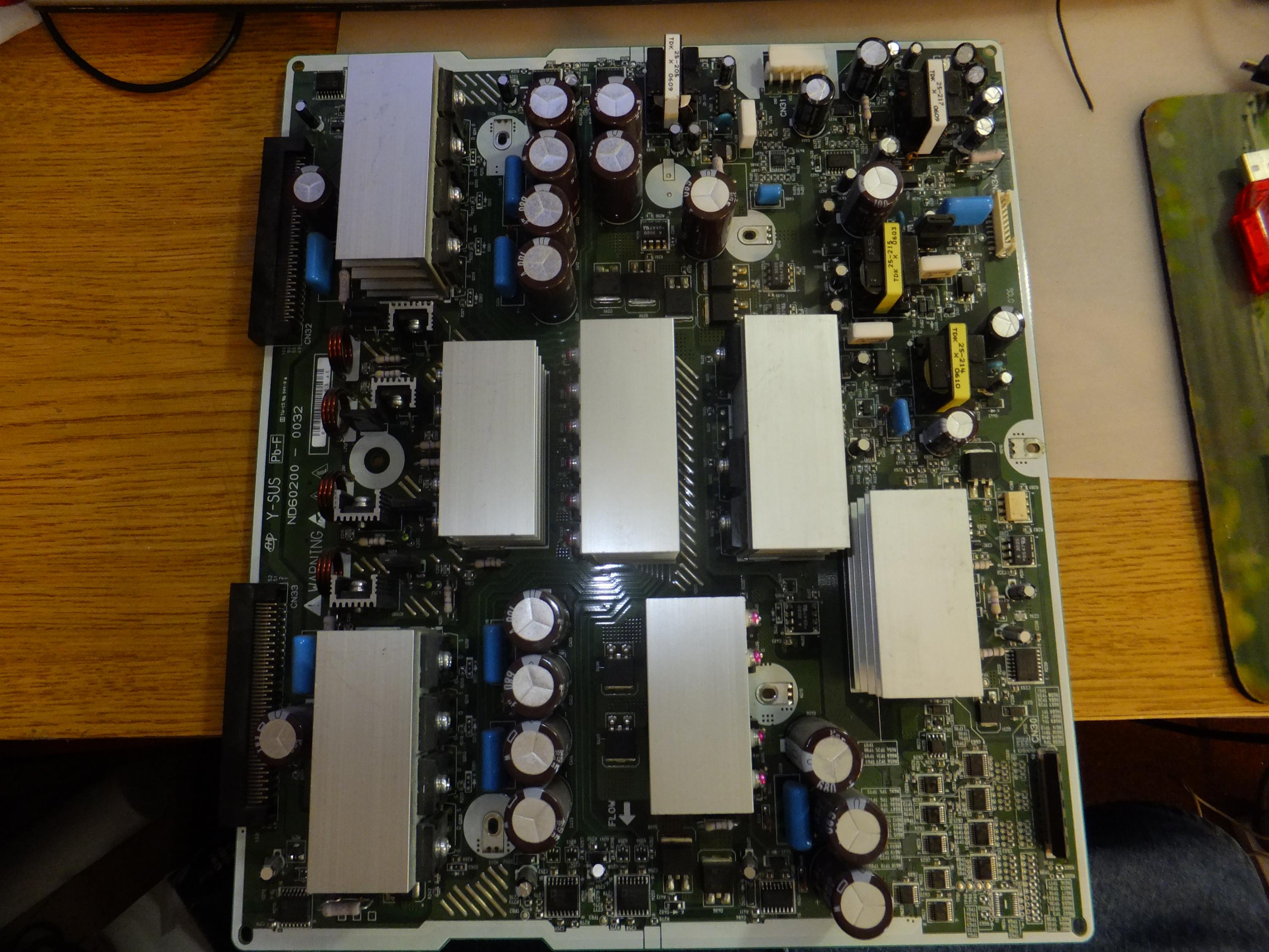

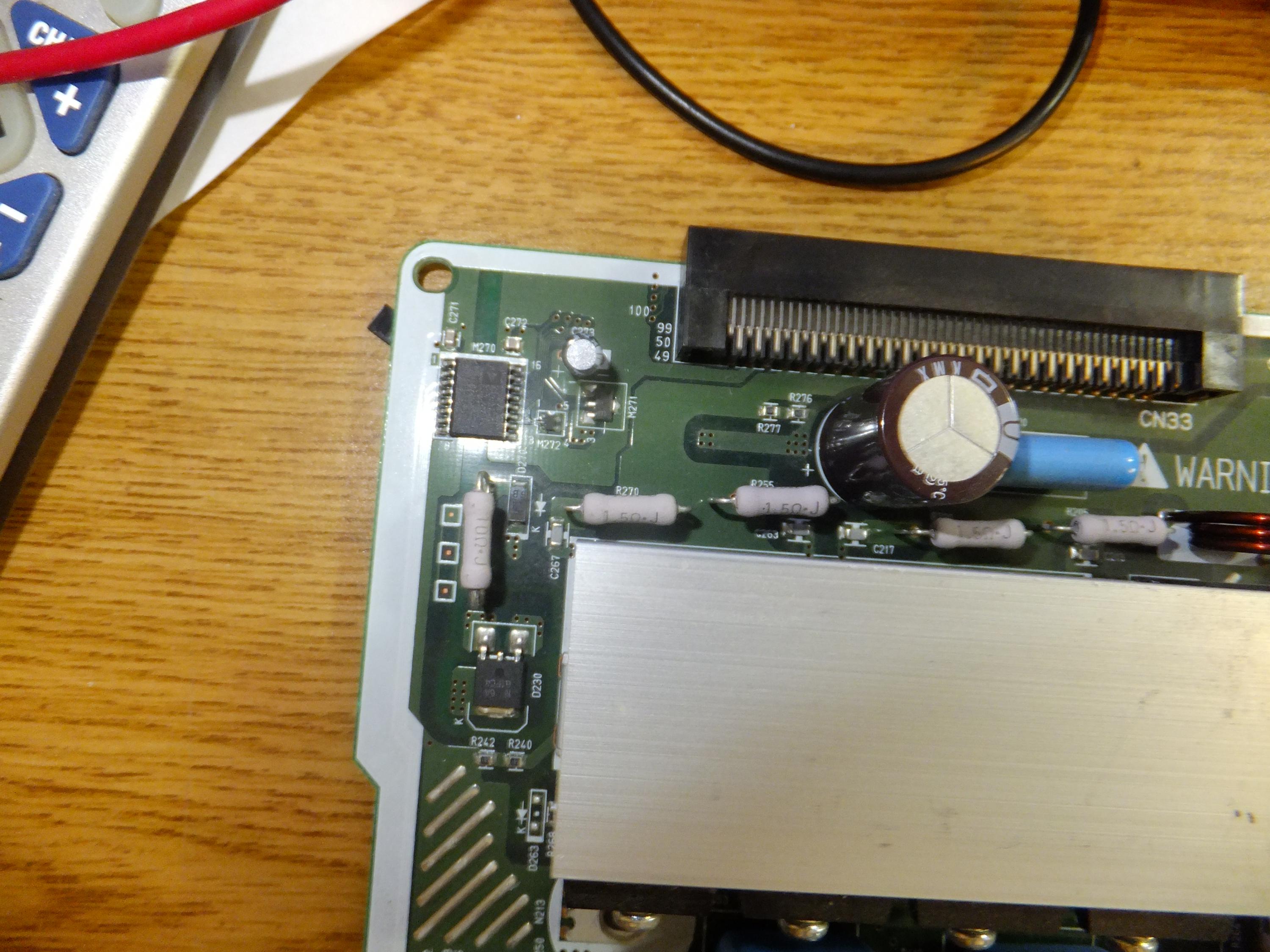

                  I have this TV ( Hitachi 55hds69 ) and I have no picture.
                  I have had it for some time and have not been able to fix it. I have determined that my Y-SUS board is bad but I do not want to buy a used Y-SUS board that is only going to go bad again. So what I want to do is repair the Y-SUS board. So I need some help.
                  Let me first explain that I have tested just about every possible part on the Y-SUS board and it seems that there is a bad IC only because I can not detect any bad parts. My knowledge for testing ICs can use some improvement. I will attempt to look up each IC for info on testing.
                  The TV turns on and stays on with no trouble as long as I do not have an input source. As soon as I turn on an input source such as a DVD player then the picture goes out as well as my VS and VA.
                  I bought a cheap Y-SUS of eBay but with that board the TV did not work at all so now I have 2 non working Y-SUS boards.
                  Then I discovered I could test the scan driver boards by removing one at a time so I did that. Removed the lower board and the TV worked perfect and stayed on except I was missing the bottom half of the screen. So then I put that back and removed the upper board and again the TV works perfect except I have no top part of the screen. Puzzling.
                  It seems that when the TV is demanding the power it turns off, what could be causing this?
                  I tested every transistor and diode on the Y-SUS board. I removed every cap and tested them. Nothing bad found.
                  Whatever is causing the problem seems to get worse with time.
                  I took some pictures, if there is any IC you need a better PIC of I will upload it.
