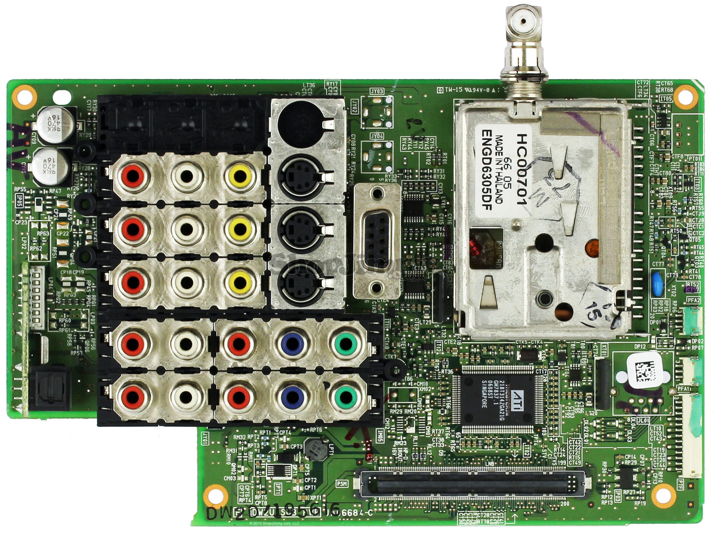

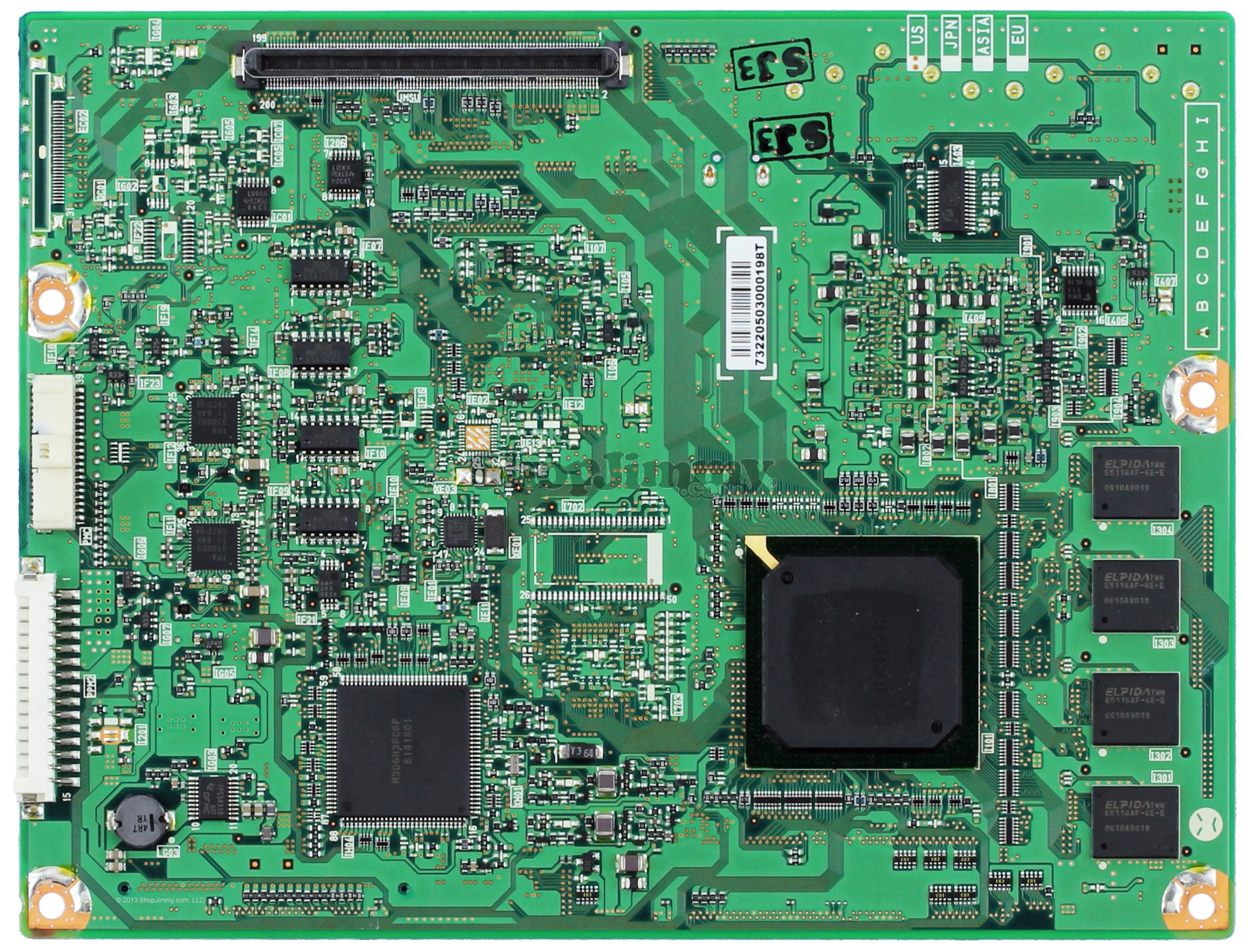

    Re: Hitachi 55hds69 No Picture
    It could be that the Main digital board became seperated from the Sub digital board. They use a 200 pin connector between the two boards, The sub digital board handles all the inputs except the hdmi and the tuner. The hdmi is mounted on the main digital so it might see the device but the video/audio won't be processed.
