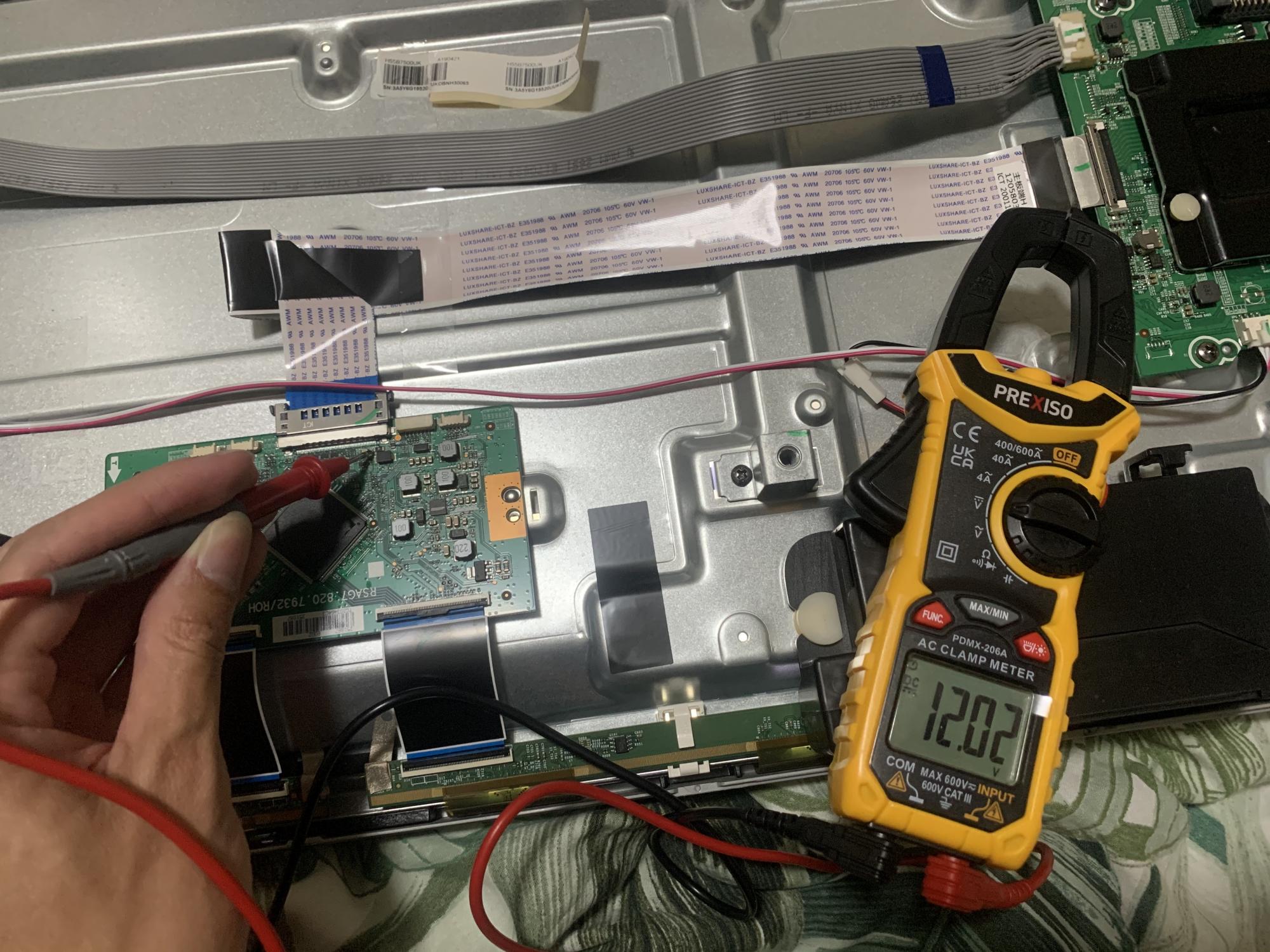

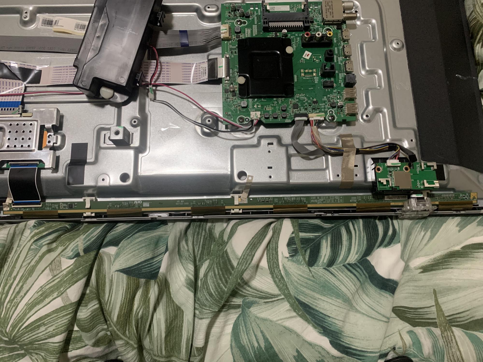

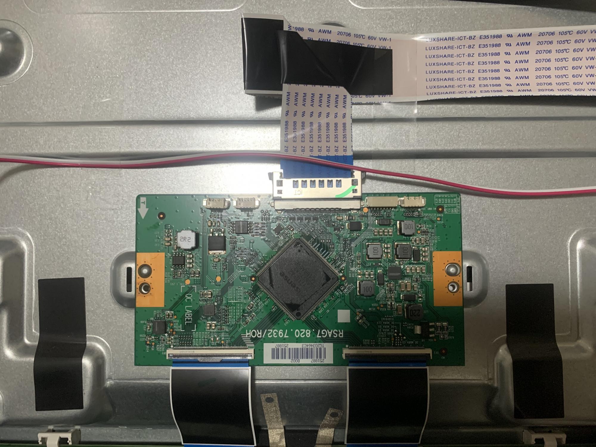

    My tv still has backlight when turn on, 12v on tcon board but no picture and 6 flashing red light at power button. I already disconnected each ribbon cable in turn but the screen only had backlight and nothing changed.

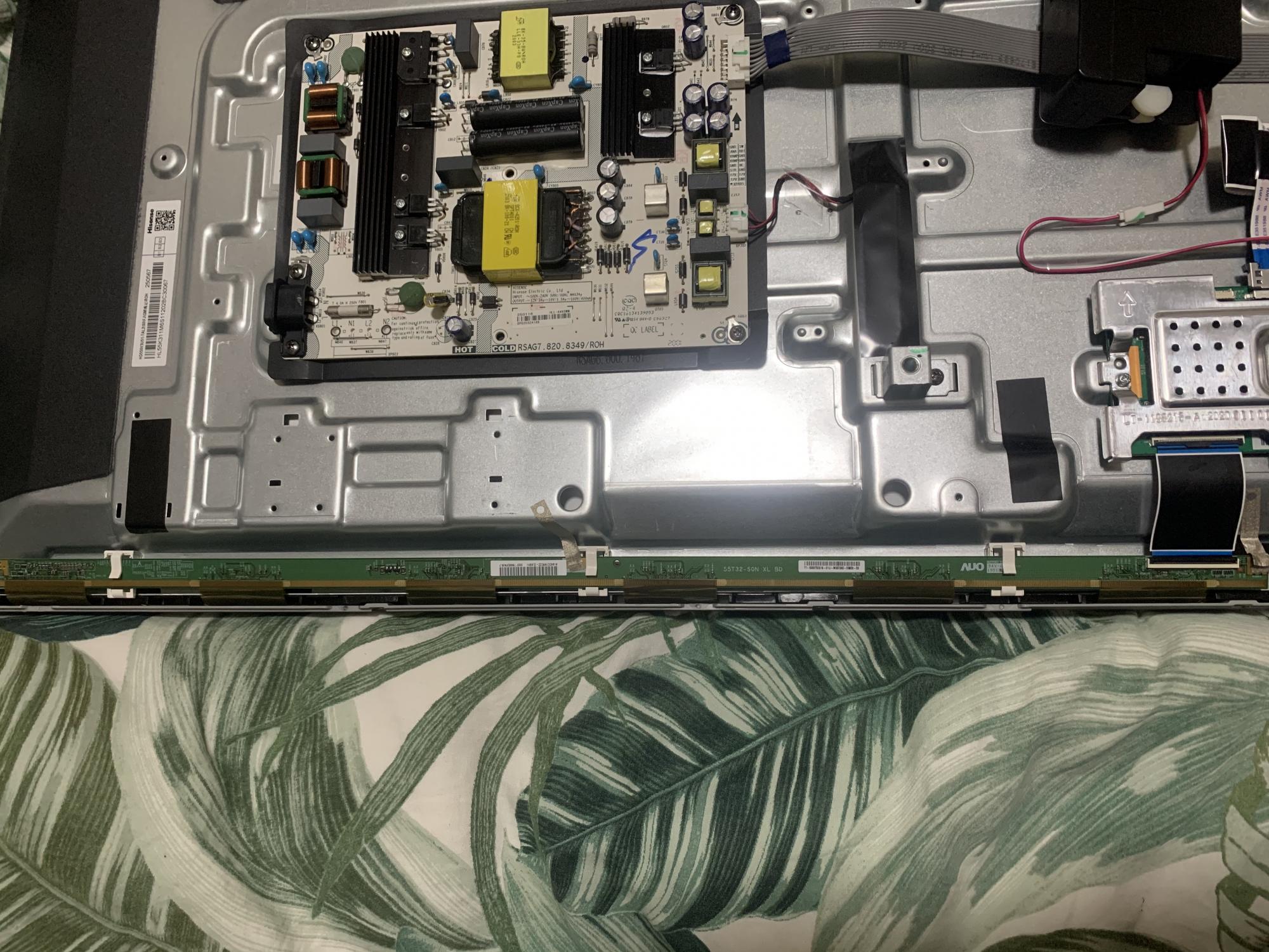

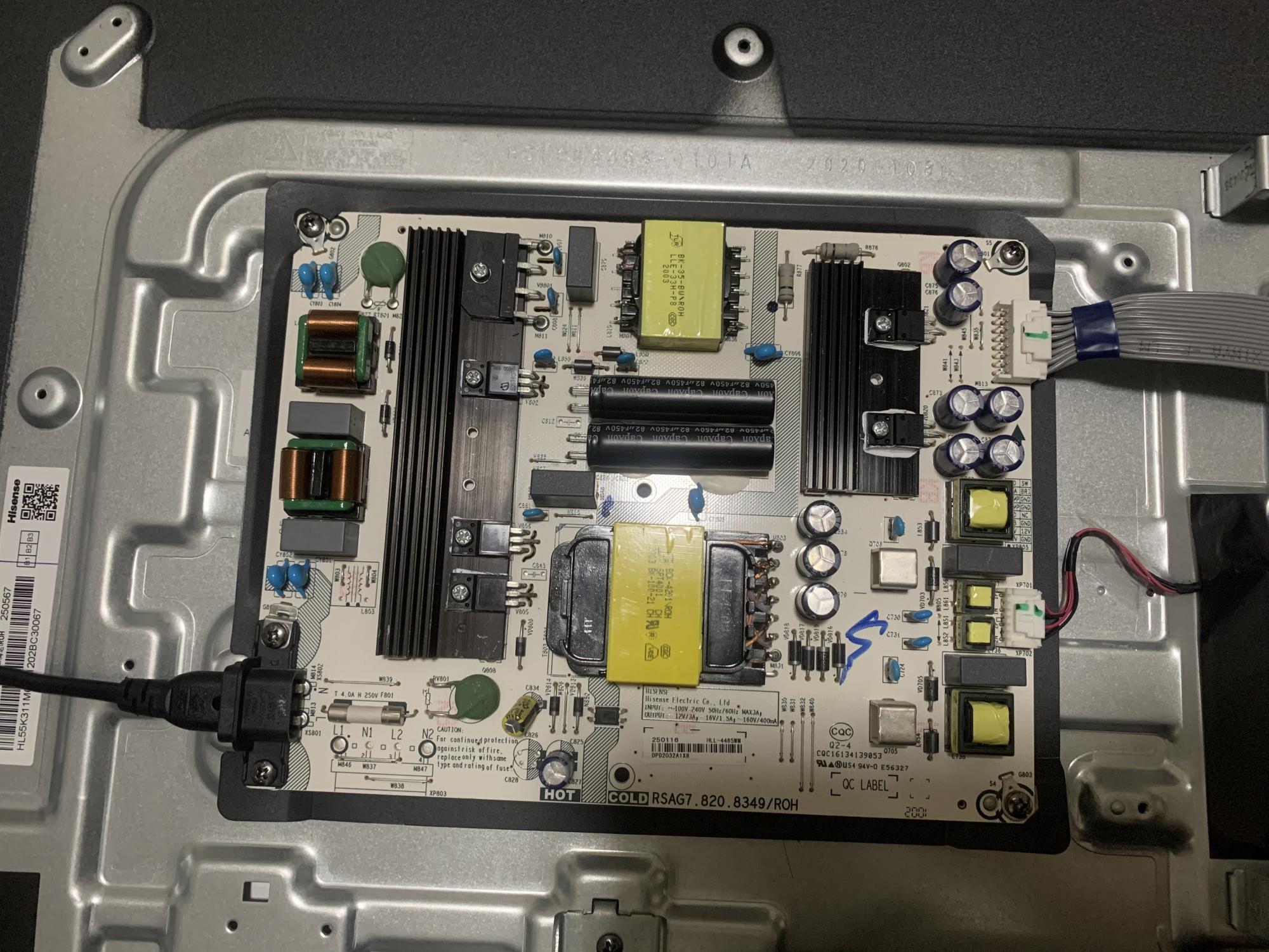

    Re: HISENSE H55B7500UK has backlight no picture
    Update photos and clip(gg drive)
        Turn it on, look closely at it with a flashlight
        LOL.... why flashlight and he have BL working fine ...!!
        you need to test T-CON and Panel as stand alone first..
        disconnect the LVDS from T-CON side.... if the BL come on... then make Jumper from PSU 12 V to T-CON fuse direct... see if the screen lighting up...with full color
            I already disconnected the LVDS from T-CON side, BL came on and the screen had nothing when i connected 12v to t con fuse
              when every things as original connected... did you have sound ??
              • snowangel27
                • Aug 2023
                • 45
                • United Kingdom
                No, I didn't hear anything
                  take out the speaker... and reach the panel edge buffer boards see if the left and right had at the middle U ribbon cable... if yes disconnect it from one half and turn each time

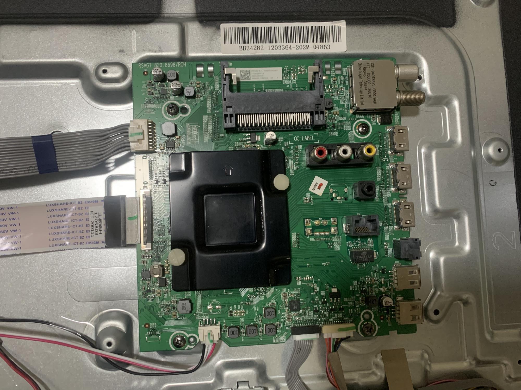

                          i saw your movie.... try to disconnect the WIFI BT module and turn on.. if the same issue you have issue at MB.. emmc dead or Firmware ... try to write firmware again via USB... am sure 5V at USB you have because T-CON 12 V you have measured before... if this didn't help then replace MB or packing it LOL if u have BGA station then refleo main CPU
                            Yes, i m having 5v on usb port.
                            I tried to disconnect the WIFI BT module at the first but it didn t help
                              go hard play on MB.. check any low volts you have for emmc or DDR or cpu.... if all fine...take out the heat sink.... and do what you can to heating the cpu to touch again in it place if you did trying flashing the firmware.... good luck
