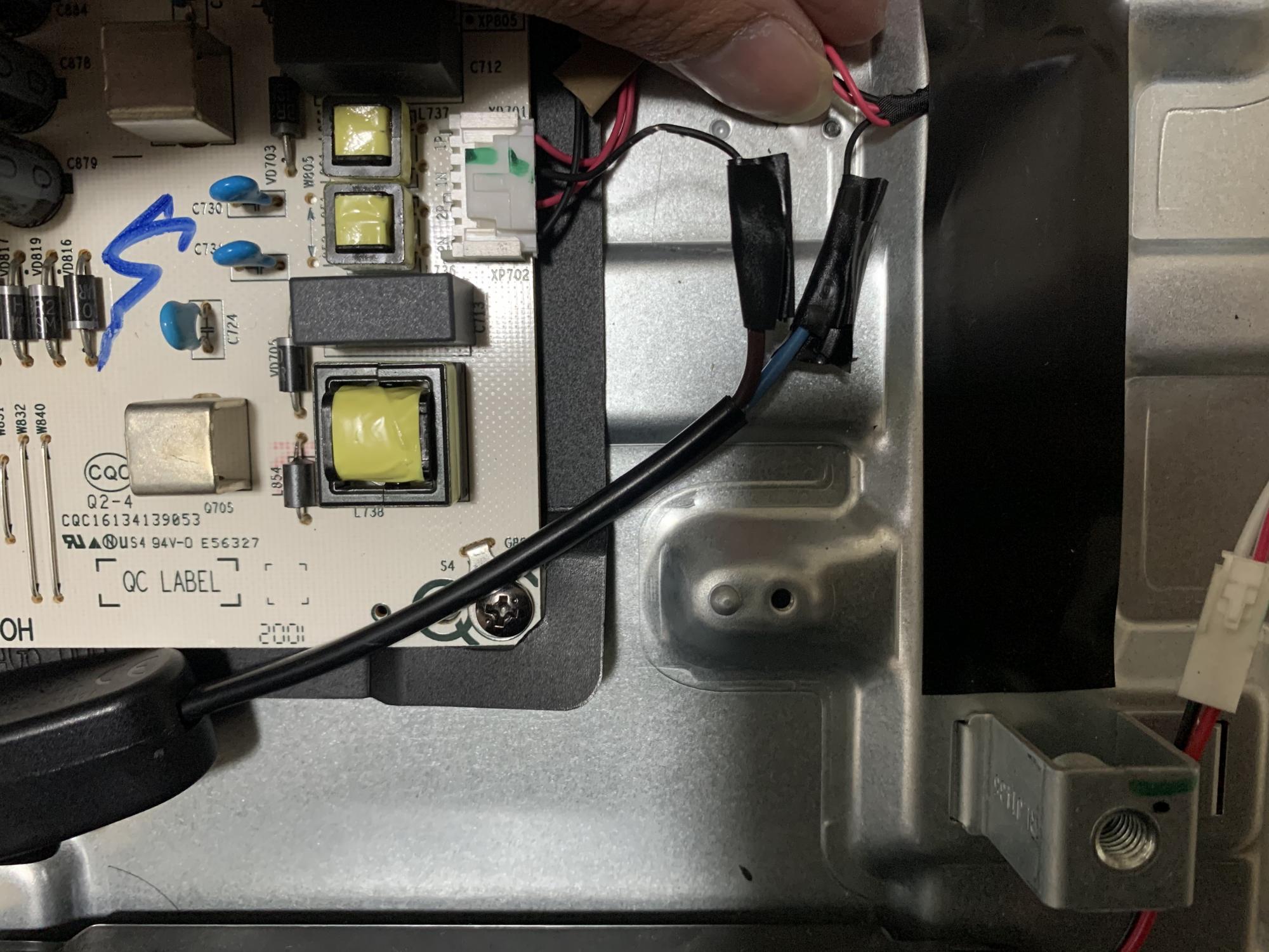

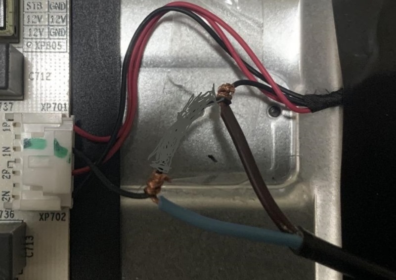

    Re: HISENSE H55B7500UK has backlight no picture
    Originally posted by lotas
    I understand that it is necessary to break one channel, but why hang the two ends of the lamp on one wire, what is it?
    hahahaha.... i just saw his uploaded photo ...LOL he is doing wrong LOL
    OP: you should cut the wire and connect the 2 end to lamps wire...LOL

      #42
      That’s what I wrote about!

        #43
        how silly i am, sorry diah, i will do it in the right way

                #47
                from yours Photo.... N1 & N2 are connected together.... i wrote before if they connected together the lamp test you need to do it to P1 & P2

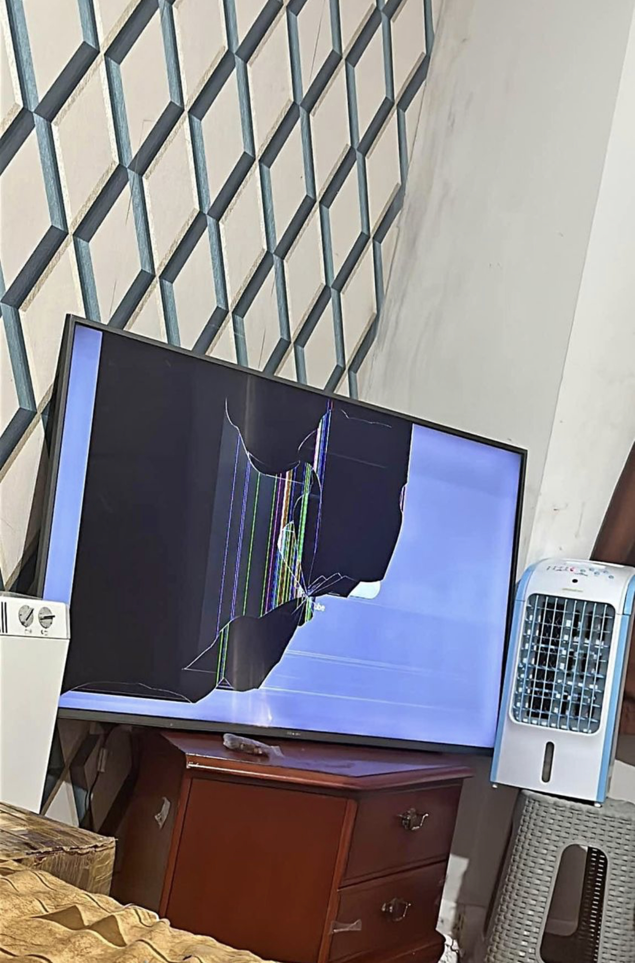

                                        #59
                                        do it again with half screen each time...by disconnect the ribbon , LVDS must be disconnected... if same result then i suggest as my Post #49
                                        Yes i tried disconnecting one by one but it s helpless.
                                        I already took another t con board from a cracked screen hisense tv to replace mine but the screen s still has nothing and the led light keep flashing 6 times.
                                        • snowangel27
                                          • Aug 2023
                                          • 45
                                          • United Kingdom
                                          #60
                                          I just took a quick look, so if you get one make sure it's compatible.
                                          I m having 1 more cracked screen hisense tv(diffirent model but uses the same t con board). I tried to replace the t con board but nothing changed.
