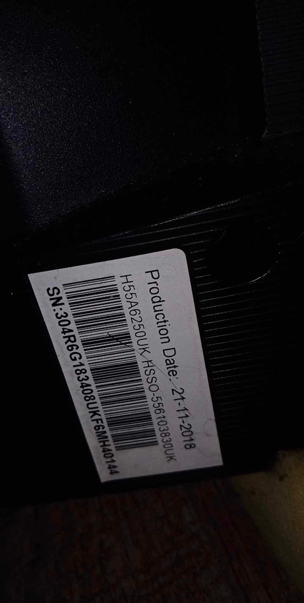

            #65
            Re: HISENSE H55B7500UK has backlight no picture
            Originally posted by Diah
            which model and size the cracked one?
            H55A6250UK, same size

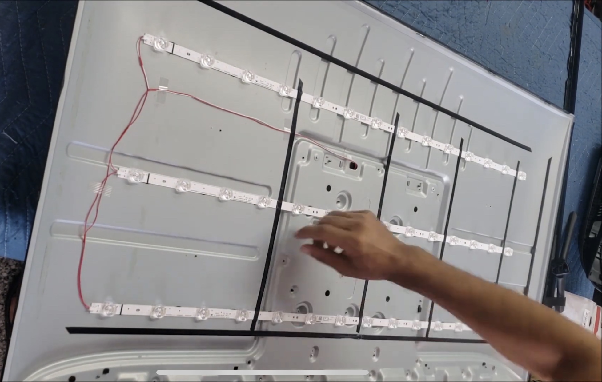

                              the BL of the cracked one... also 2 group or only one ?
                              show us photos

                                #75
                                show us photos
                                I already brought the cracked tv to my brother's house to use the led tester test the led strips.
                                The whole middle strip s gone.
                                • snowangel27
                                  • Aug 2023
                                  • 45
                                  • United Kingdom
                                  #76
                                  And my TV’s led strips are all good. No one s down^^ good news
                                  • Diah
                                    • Feb 2013
                                    • 6397
                                    #77
                                    Originally posted by snowangel27
                                    I already brought the cracked tv to my brother’s house to use the led tester test the led strips.
                                    one LED on the strip get open... all strip will be OFF
                                    so you have on cracked all strips in one group... not as yours
