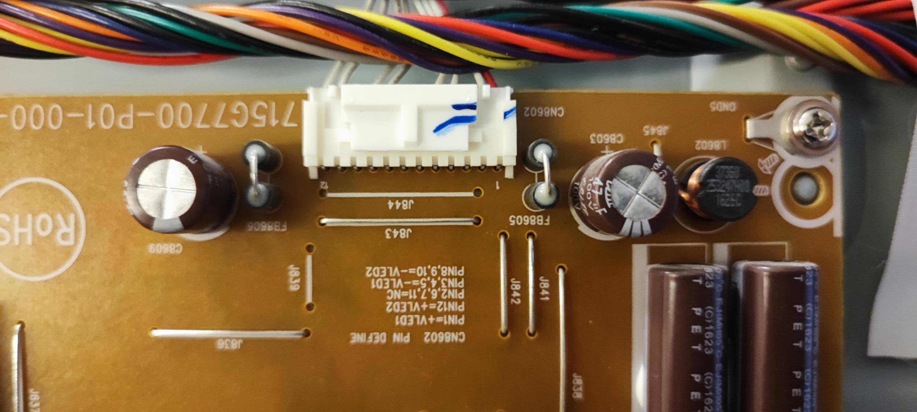

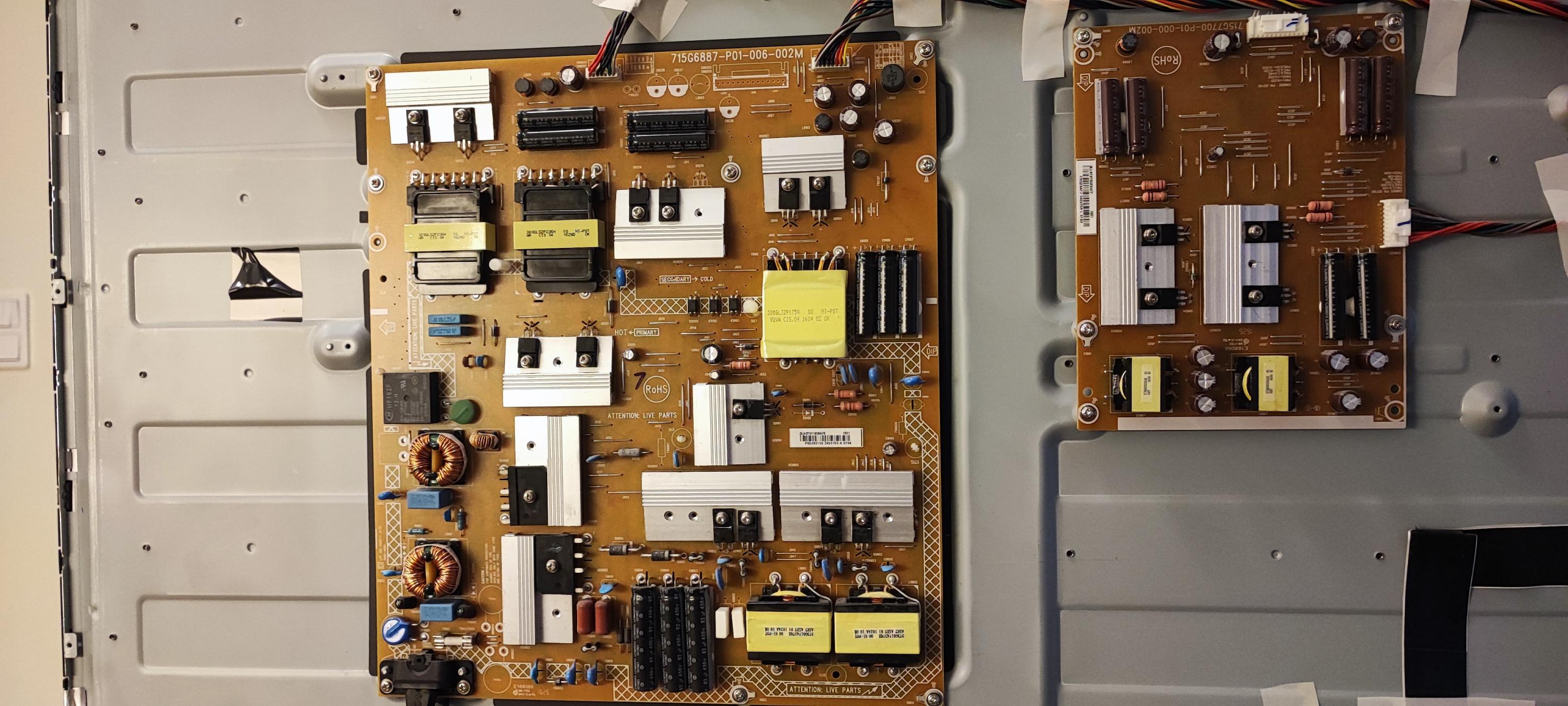

    I have picture with flashlight but no backlight. Logo comes on quickly with low light before disappearing. When checking behind the tv I see backlight turning on in some holes before turning off and that's when the room is pitch black. Impossible to see otherwise. That explains the logo barely visible before disappearing. Don't know about sound but it should be fine. TV stays on.
    Here are some pictures and numbers taken with TV on.
    PIN1,2,3=VIN 33V
    PIN4,5,6 =GND 0V
    PIN7 =+18V 12V ???
    PIN8=BL-ON 3.2V
    PIN9=DIM 2.8V
    PIN10=ADIM basically 0
    PIN1=+VLED1 33V
    PIN12=+VLED2 33V
    PIN2,6,7,11=NC 2 and 11 = 33V, 6 and 7 = 3.8V
    PIN3,4,5=-VLED1 3.8V
    PIN8,9,10=-VLED2 3.8V
    So PIN7 shows 12V instead of 18V.
    Should I open up completely and check the strips? I don't have a LED tester and if some LEDs are broken or burnt it should show right?
    Please help me

      How did you measure the led voltages? black probe to gnd, chassis?
      What voltages do you get on pins 1, 2, 11 and 12 with led connector removed?

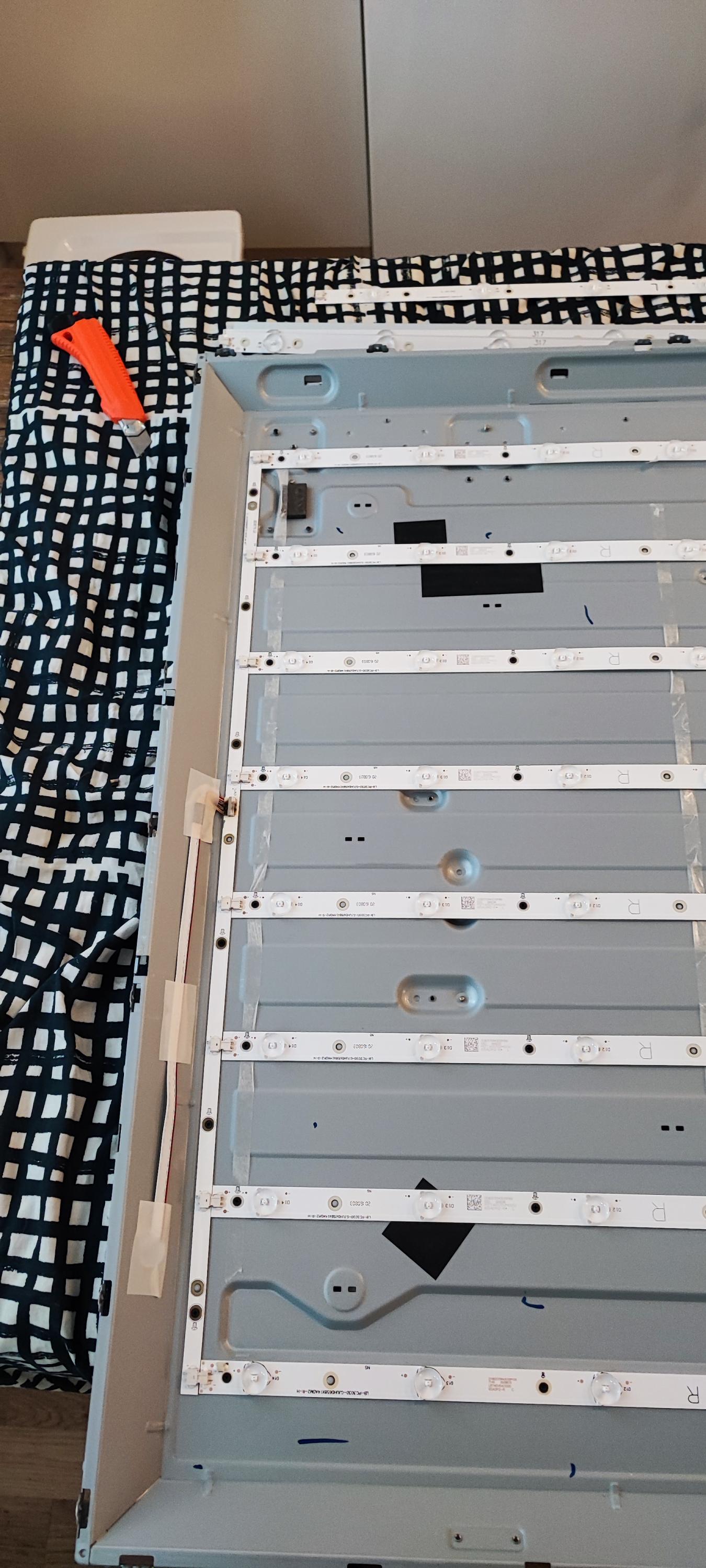

      I think you will find 8 strips with 14 leds per strip, see photo. And a pair of led wires will drive 2 strips, guessing each pair of strips will be connected in parallel.

        +32 volts is the raw supply for the led circuit, If the led's are working, this voltage will be boosted to a higher voltage, but when there is even one bad led, the circuit will go into protection and shut down. So you likely have one or more bad led's in the panel.
        If you check that +VLED voltage as you turn on the tv, you might see that voltage come up for a second.

          Black probe to chassis.
          I didn't try voltages with panel disconnected. Will it make a difference? Since I suspected it was the strips I packed up the TV with all screws and everything.
          Also I think some voltages should be 0 and not 3.8. I probably didn't notice my multimeter jumping to mV when checking some pins...

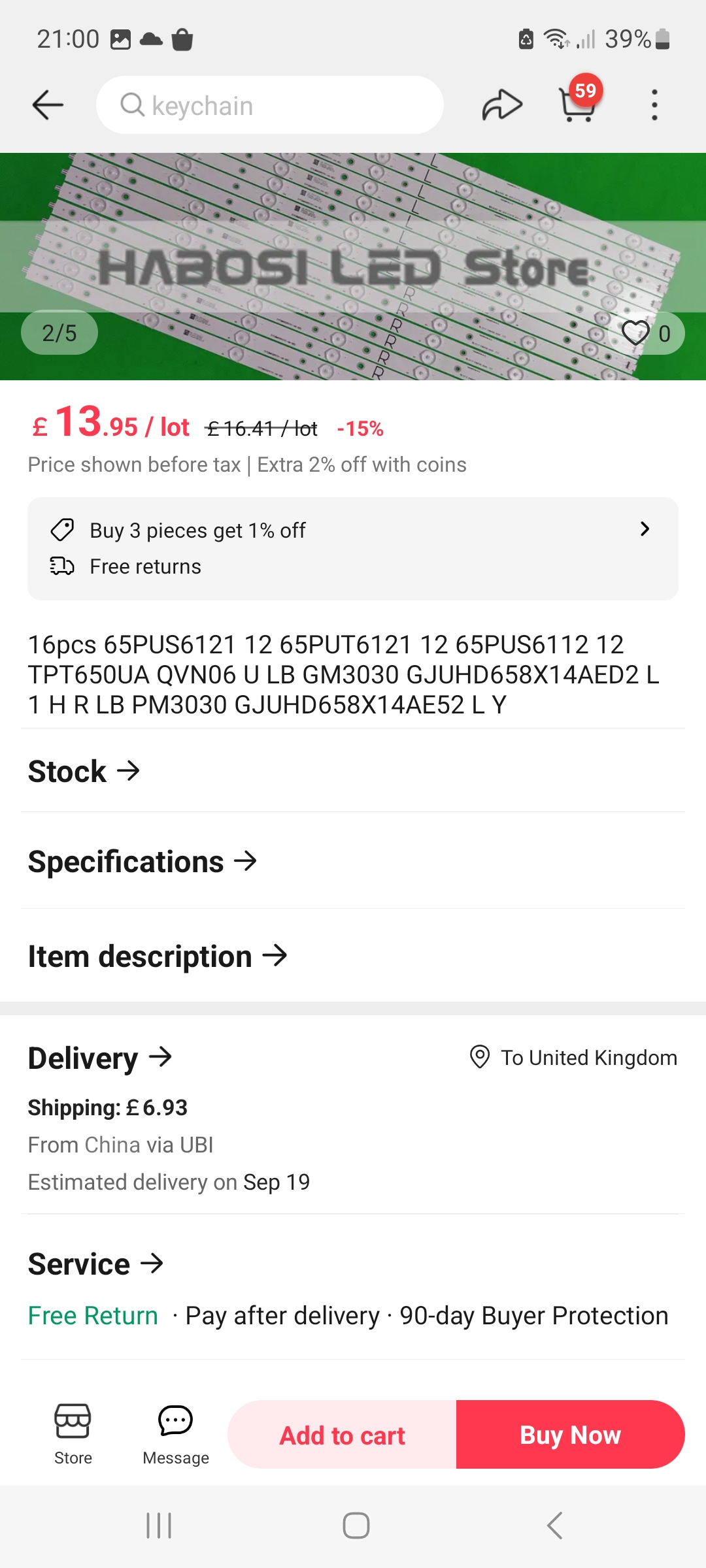

            Thanks for the reply. Makes me more confident to order strips.

              Ideally you need to strip the tv down to access the led strips to confirm you are ordering the correct ones though I havent really had any issues ordering according to the panel i.d.
              Same tv model can have different panels and hence different led strips.
              Remove the rear panel to confirm the panel, will be a label attached to the metal chassis with the panel number and use to cross reference to the led strips compatibility.

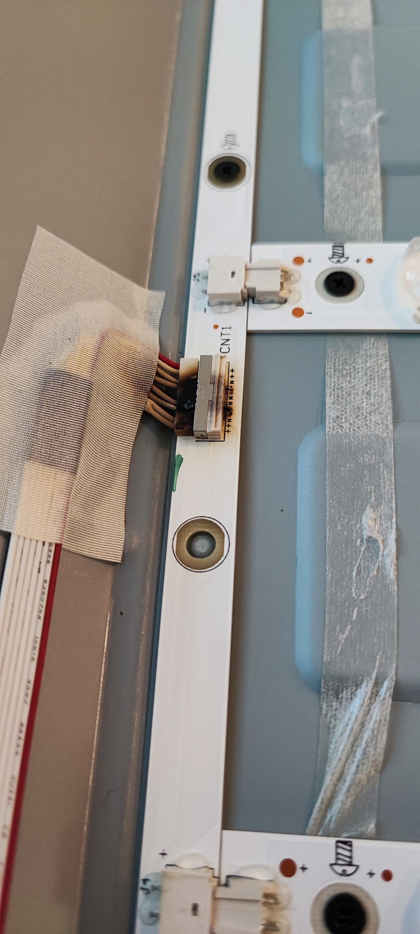

                    I have a new problem. I'm just replacing the strips when I see the panel cabel is burned. Should it be fine or should I get a new cable?

                          Re: Philips 65PUT6121 - no backlight
                          Fuck me the cable is total burned. Have to get a new one... hope I don't have to replace the contact too................
                            Damn that's fried, I wonder what caused it.
                              I'm gonna go with electricity. That'd be my guess
                              But yea that's pretty nuts. Haven't seen that yet
                                Solder the cable on the pcb, cables are not sold by Philips.
