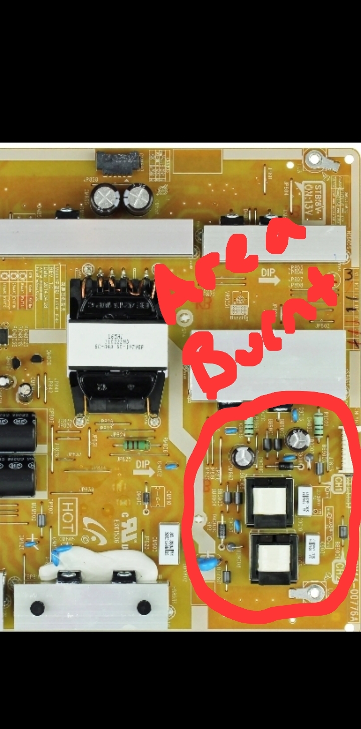

    Found my first burnt power supply!
    Now I have no idea what I'm doing lol.

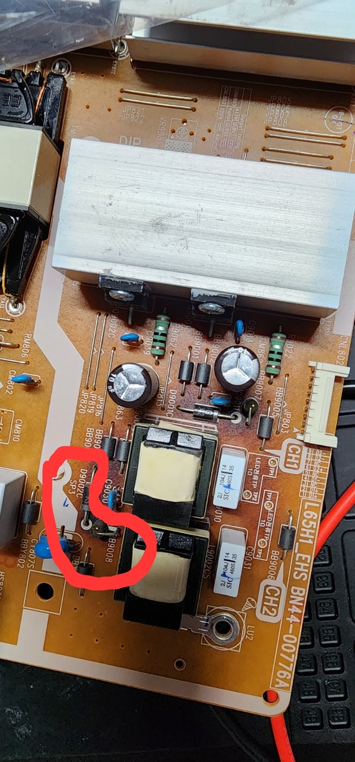

    So I found where the most "burn" is and circled it from the component and I've been testing things and found that d9002c diode is good and testing .45 and it's connected to b9008. This is where more of the burn mark is shown on the board. First of all does anyone know what b9008 is? And second how am I to test this?
    Is there something around the area that I should test? Kind of a big discoloration around this area.
    I'm trying to replace pieces instead of the board and up my game bed tonight and this is as far as I got. Thanks

    As long as the power supply works, never mind the darkened area. This darkened spot men’s nothing, as the discolouration on the board is from the heat from the diodes, not from exploded parts (carbon).

      B9008 looks to be a ferrite bead, probably fine, tests same as a fuse or jumper, should show continuity.

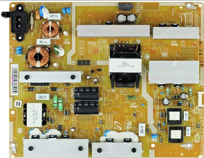

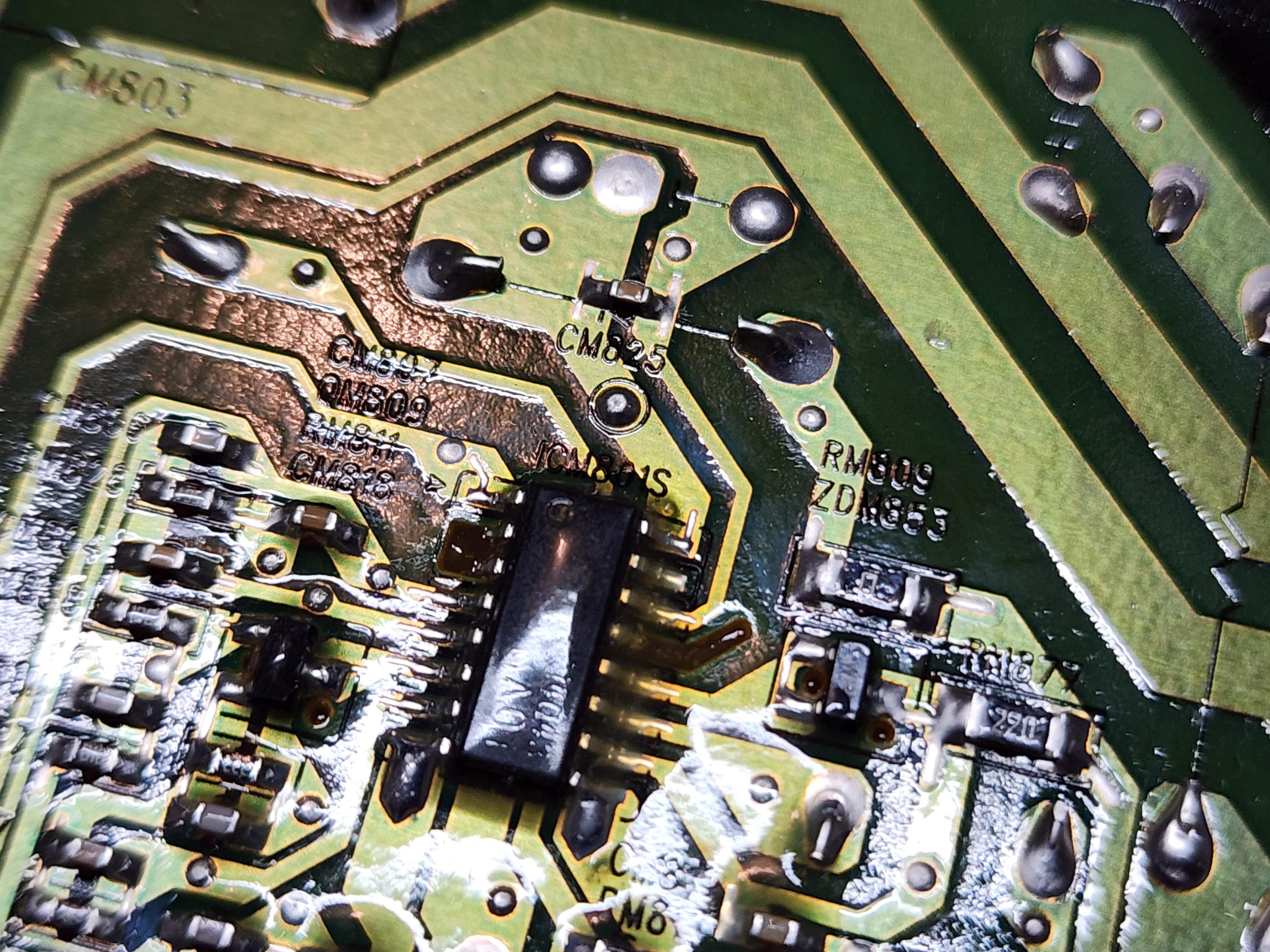

                  It may be as simple as CM809 and CM814 are bad, as in open and not charging to keep the ic operating.
                  Check that D9001c and D9002c are ok and not shorted. If they are not shorted, check what voltage you get on D9001c Cathode, it could be around 330v but is likely less given the state of the 13v
                  Check the voltage across one of the main caps CP806 or CP807, this will tell you if the pfc circuit is working

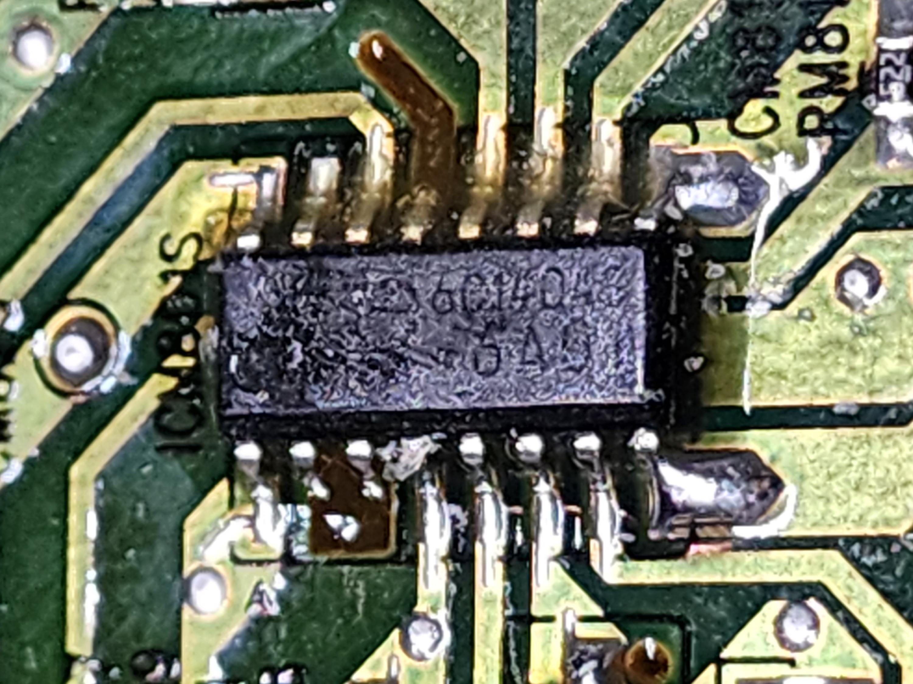

                  Post the ic number of ICM801S It might be a FA6A20N or similar

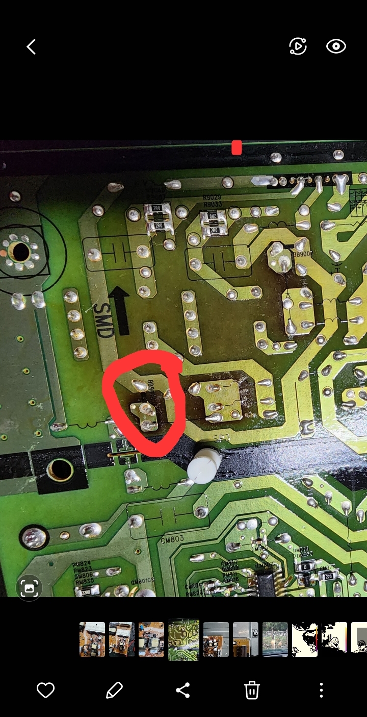

                      Took out each capacitor from the board and checked capacitance and all are reading the correct uf within 5 percent.
                      Checked d9001/2 and not shorted.
                      Icm801 I have picture kind of hard to see as I had to scrape some silicone. Don't even know what this is lol.
                      Tested mosfets from drain to source in diode mode. Are the first two bad mosfets?
                      I been learning how to test them and shouldn't they be OL like others?
