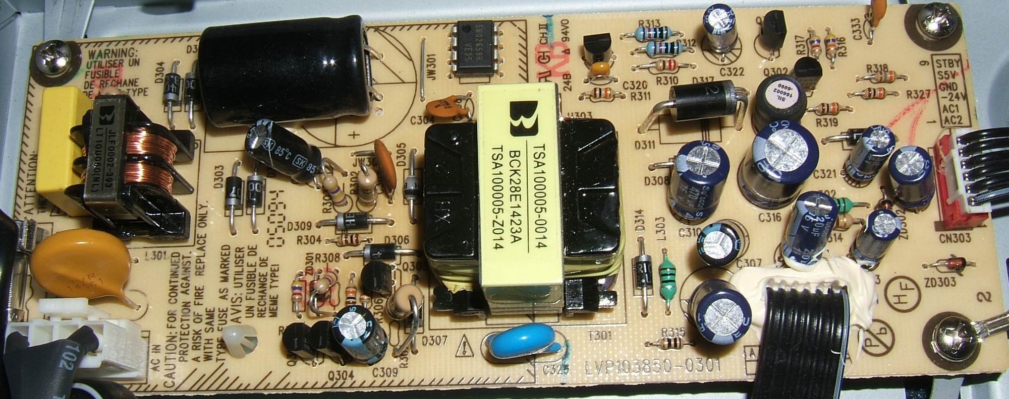

Blinking power light fix for DVP642 DVD Player

        Originally posted by gastorgrab
        There are only 6 caps on the power board that have vents.
        3 brands i have never heard of and can't find on the 'Bad' list are;
        chang
        FOAI
        NL
        Chang
        http://en.huaweiec.cn/cp/cp.asp
        I have some in a PSU. - No problems yet.
        The others in PSU are Teapo.
        I dunno the other two brands either.

                                just wanted to say thanks, blinking power/standby light problem GONE and player again working after replacing C316 with one I had lying around in the parts bins...
                                  #56
                                  Re: Blinking power light fix for DVP642 DVD Player

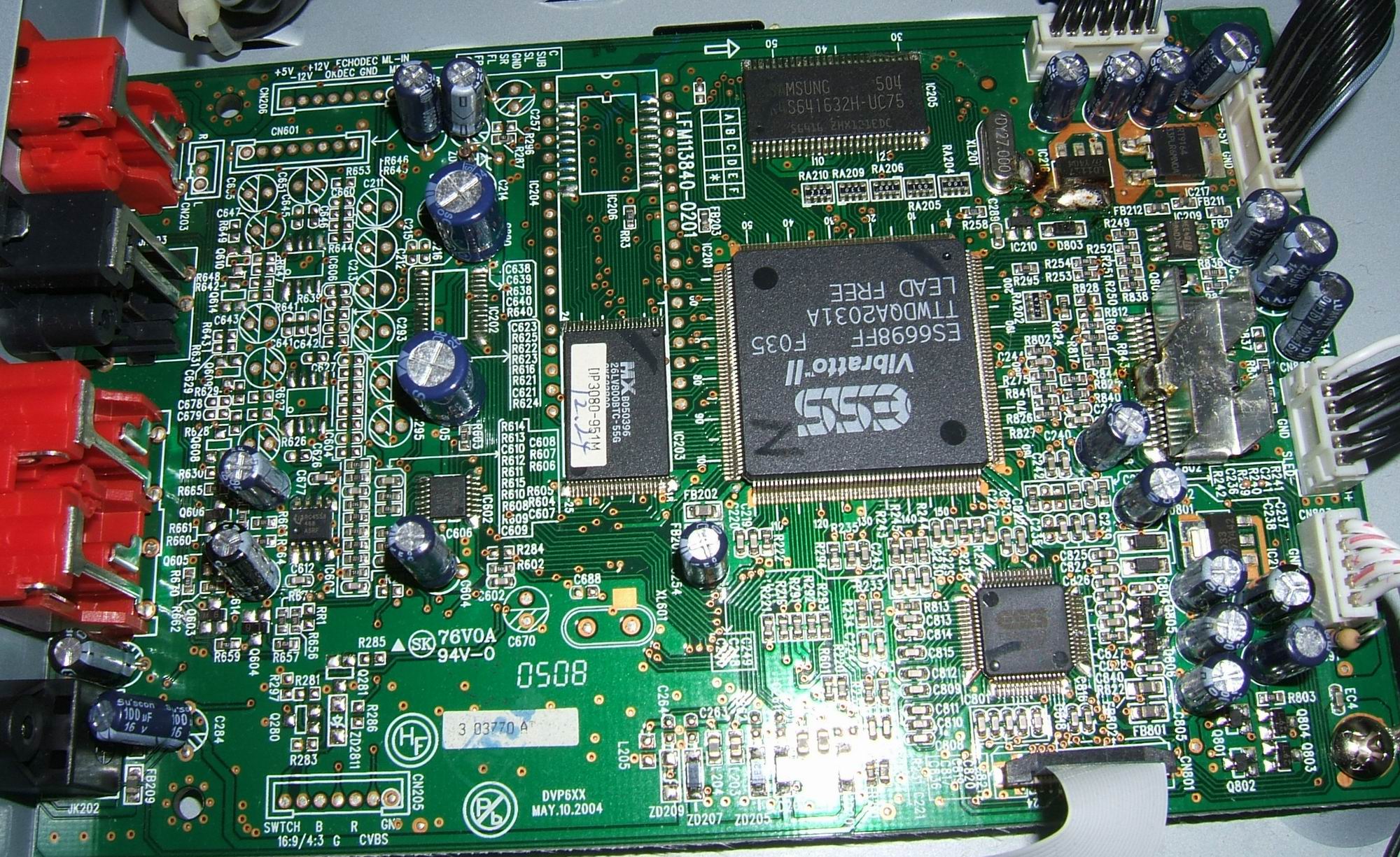

                                  Philips DVD Video Player DVP 642/37 with DivX
                                  Power Board LVP103850-0301 SM02659R
                                  Video Board DVP6XX ESS Vibratto II ES6698FF
                                  C316 in mine is a G-Luxon 1000uf 10v which has never been replaced. I just posted in this old thread to provide pictures.
                                  sig files are for morons
                                    #57
                                    C316 replaced with a Low ESR 1000uF 16V Rubicon Cap that I got from here. Unit now works great, thanks everyone.
                                    Took me only 30 minutes total for the desolder and resolder of caps. Next project is a dead HP motherboard which will be a bigger challenge since its more caps.
                                      #58
                                      I just replaced C316 with a 3300uF 6.3V capacitor. I measured the circuit and it was 5V so 6.3 is safe rating. There is no harm in going larger capacitance as there is plenty of room. I made a repair tutorial video to help anyone else fix this problem with their Philips DVP642:
                                      http://www.youtube.com/watch?v=8NeeC4kUqmk
                                      -Kent
                                        #59
                                        I replace 1000uF 10V but not helping after 1 or 2 min the player goes to standby mode.
                                        Any other capacitor I have to replace?
                                        Also noticed that the in power board 5V is drooping to 4 v after and 12v is dropping to 8 v when players enters standby mode.
                                        Looks like this is because of some kind of discharging of some other capacitor?
                                        Any idea which one it is
                                          #60
                                          There are not many caps on the board - if they are all suscon you might as well change them all except the BIG cap
