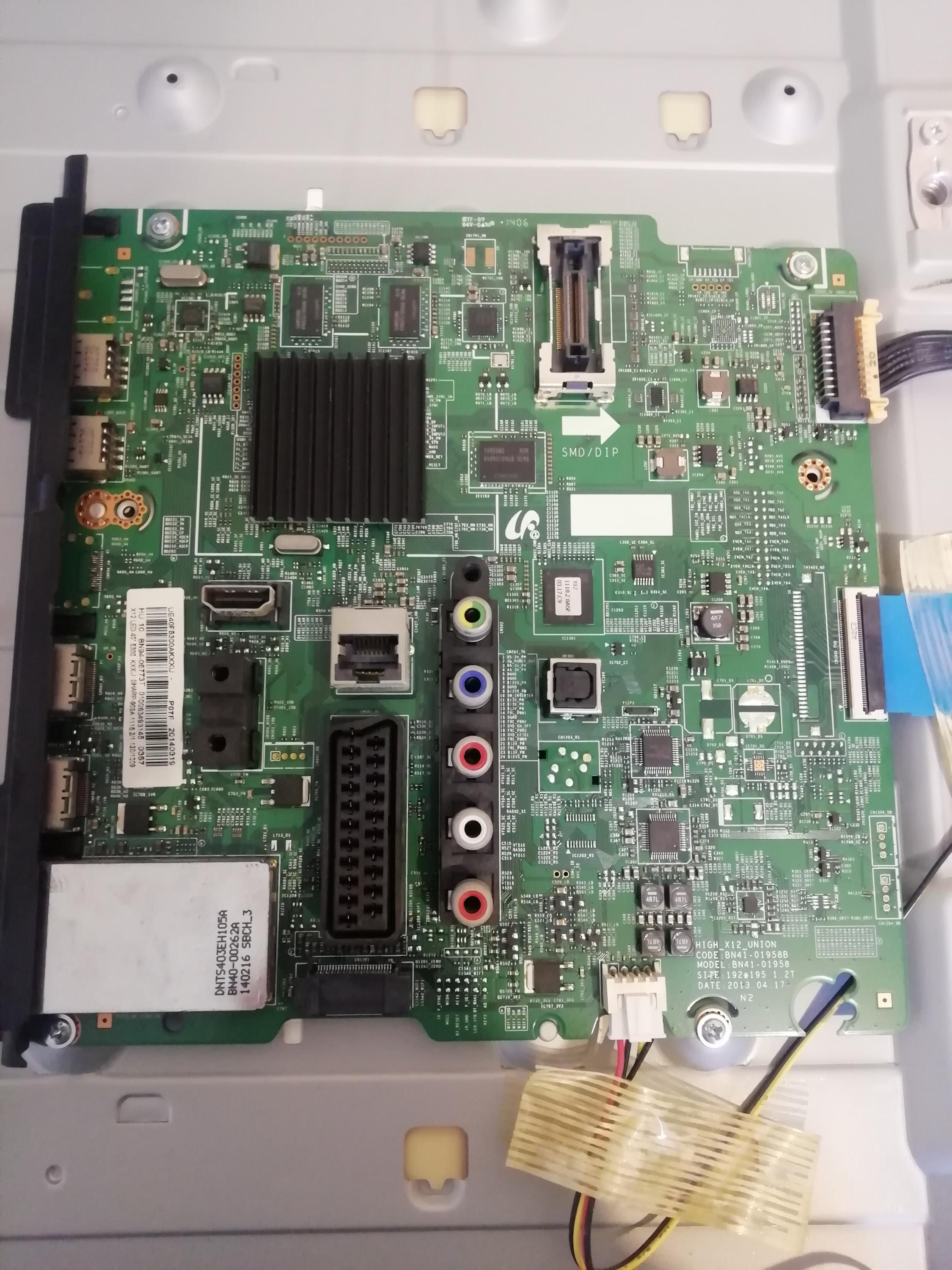

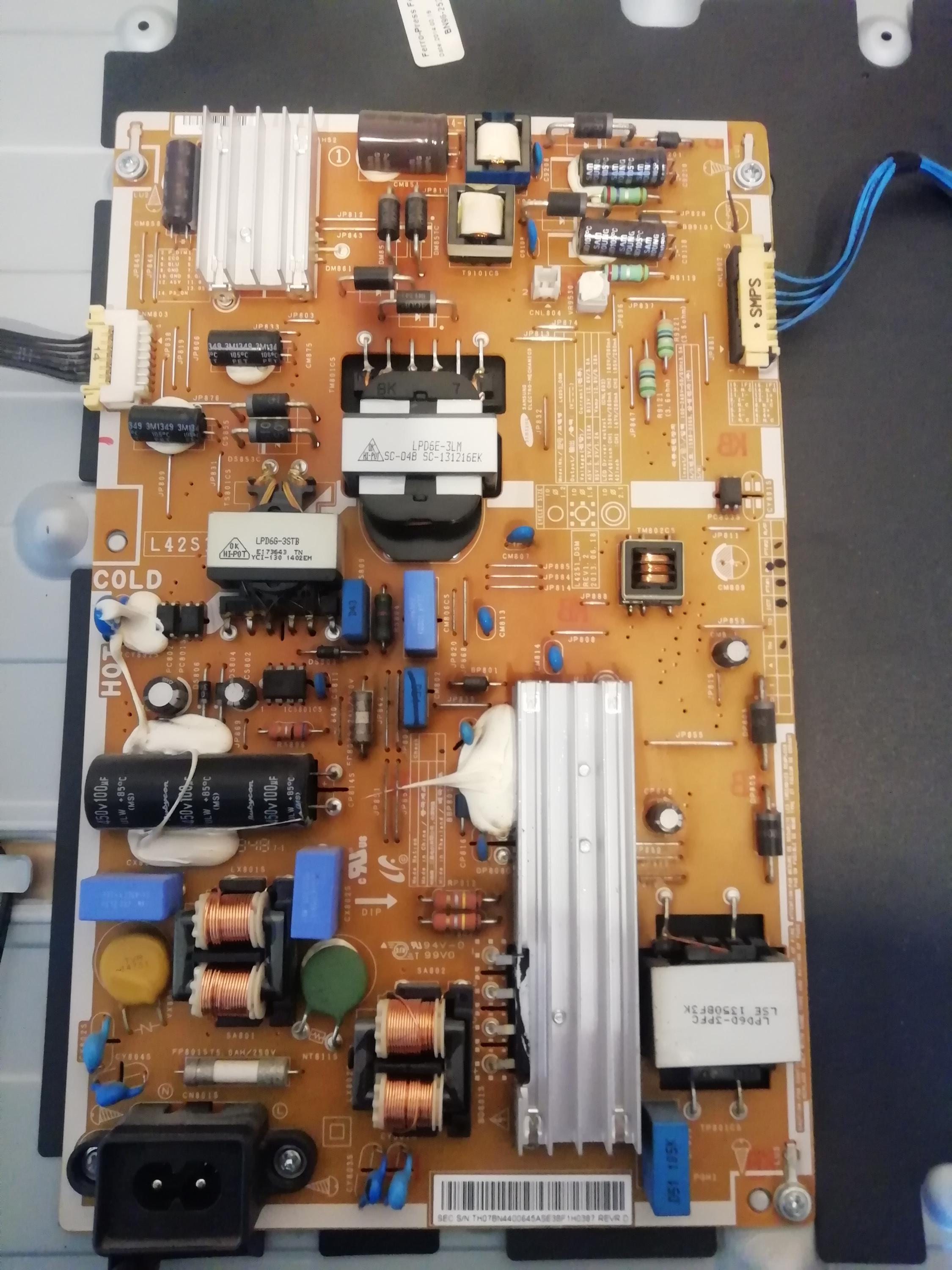

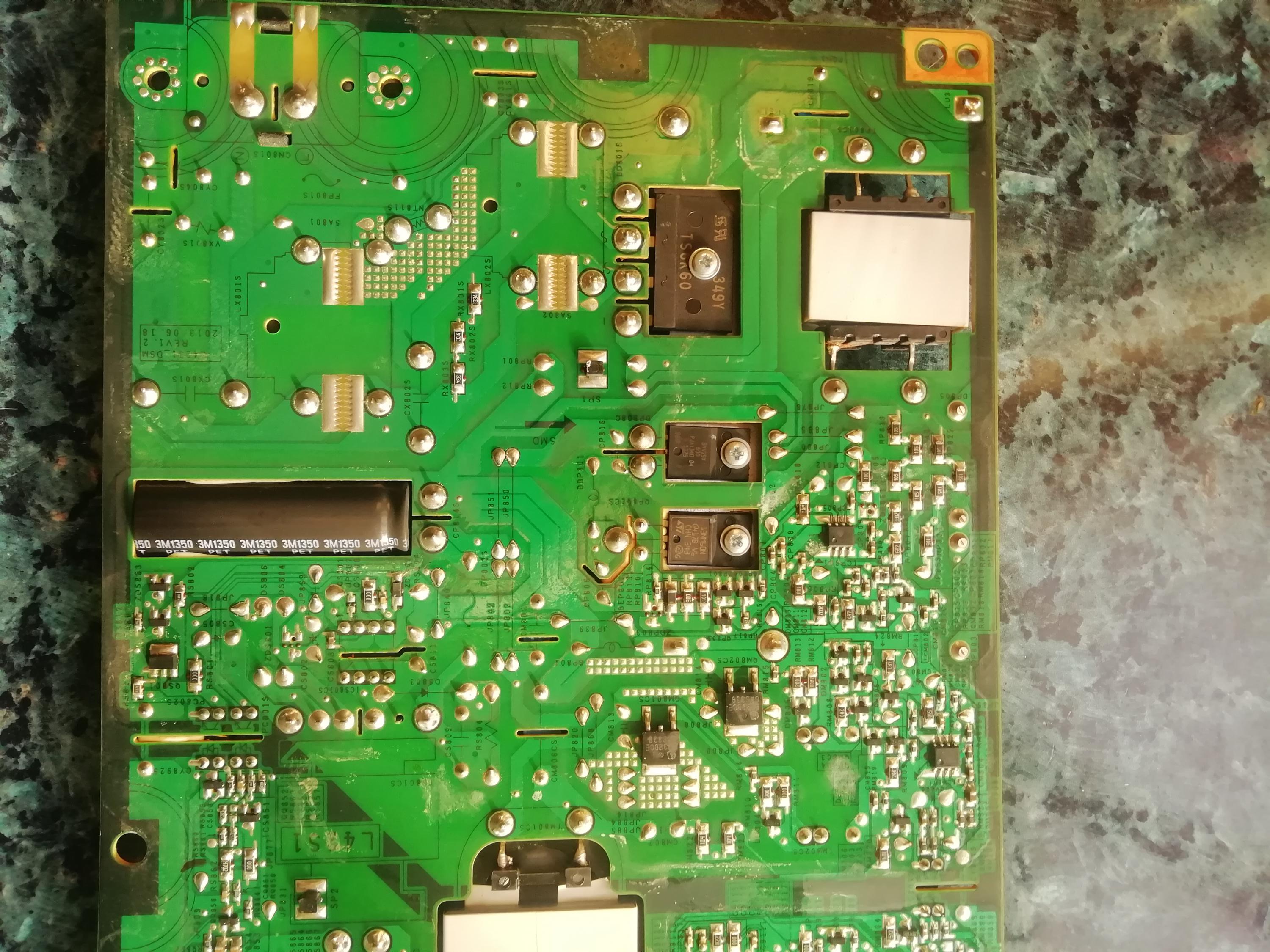

    I have the above tv that just shows a red light blinking twice 5 times, i have taken the back off and all the capacitors seem ok,
    When i disconnect the mainboard from the PSU all the led's light up blinking fast but as soon as i reconnect the mainboard back to the power supply i get the red light blinking again twice 5 times,
    I have attached pictures of the Mainboard, PSU and a small video (zipped) showing what happens when i disconnect the lead from the psu
    Any help would be appreciated

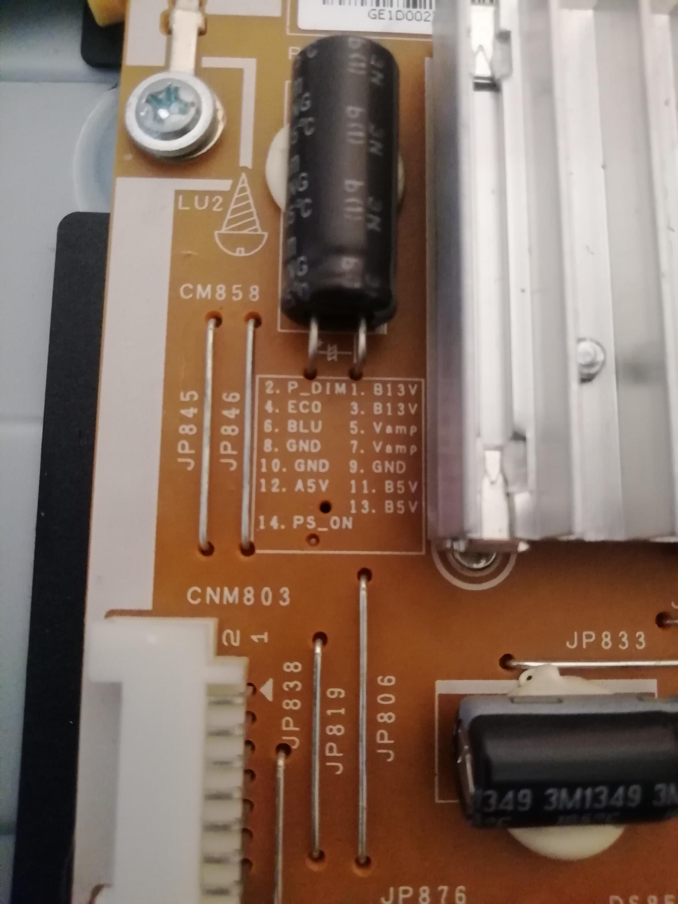

    Re: Samsung UE40F5300AK blinking red light
    suppose thats usually a backlight issue, test cnm803, see the map/legend near it, report all voltages both in standby and turned on if possible, for example pin #14 ps-on, standby 0 volts, tv on 3.3 volts, etc.
        Hi thanks for the quick replies
        @nomoresonys
        Power on
        1 = 7
        2 = 2.3
        3 = 7
        4 = 0
        5 = 7
        6 = 2.4
        8 = 0
        9 = 0
        10 = 0
        11 = 4.36
        12 = 4.94
        13 = 4.36
        14 = 3.0
        Power off all read 0 except
        14 = 3.0
        12 = 4.94

          looks like the powerboard isn't turning on fully, maybe unhook backlight connector and do the same test, lets see if there's any change in those voltages.
                post a picture of the back of power board

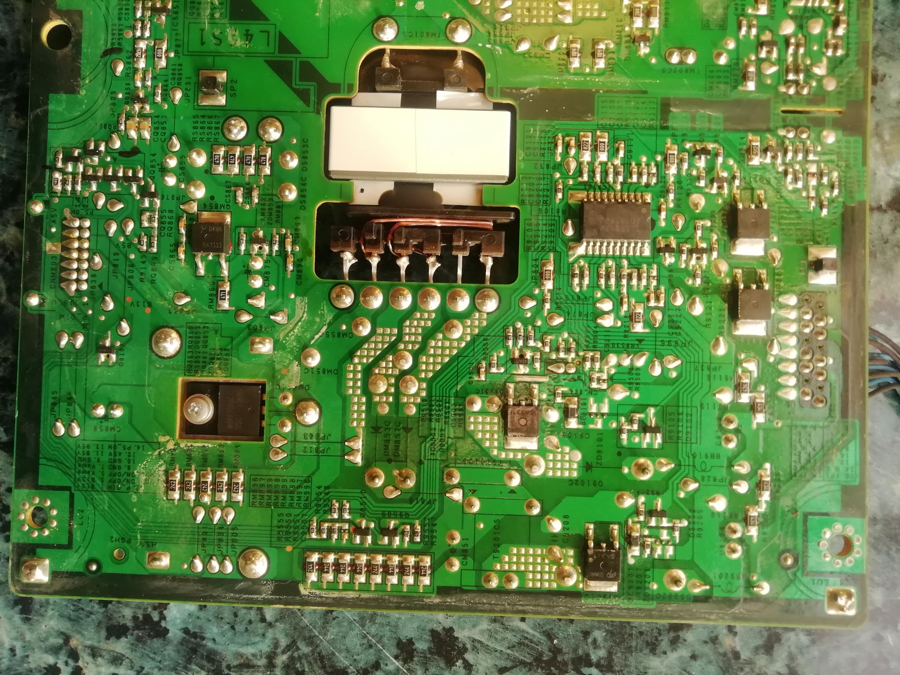

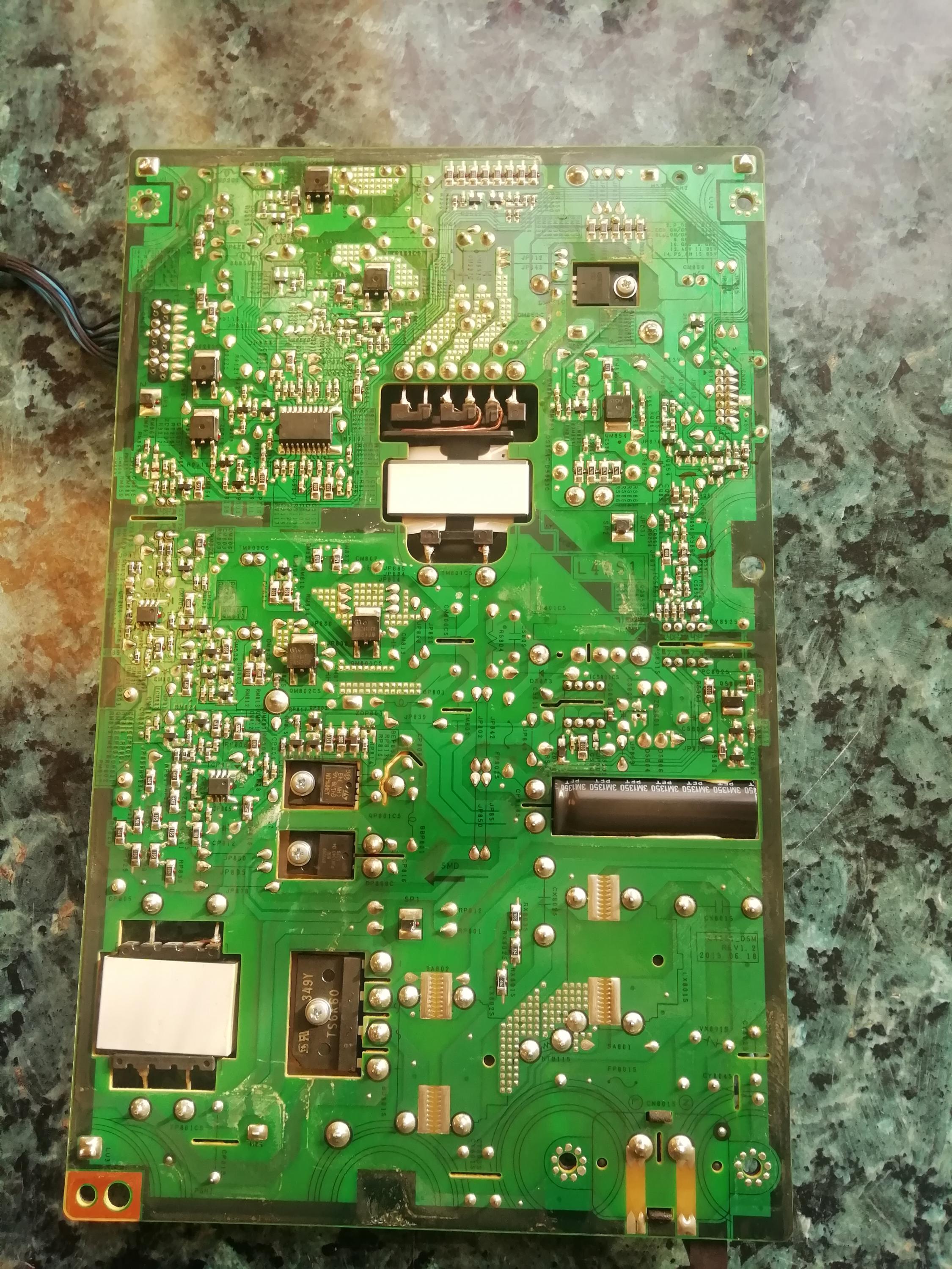

                    Pictures attached as requested

                      if the backlight blinks when the main board is turned off, the backlight is wrong.!!!! It should light up steadily and without flickering. When only the power is turned on and the backlight works, there should be about 380-390 v on the 450v capacitor. If there is a fluctuation or is below 370 in not working properly pfc
                      !!!This board is finicky and may need to rewrite the emc which is a complicated process
                        Hi, watch the under side on the center left, near the optocoupler in the secondary side there is a small sot23 called QM85, if i can see, that has to be changed, tell me its marking first, don't buy it from chinese market.. if you have spare old unuseful boards take it from there..
                        before do another little test with the power board alone, test the main board outputs, if them are ok, place a resitor on the b5v , like 5,6ohm 5w, and a light bulb to the b13v, max 30w, if the voltages drops much then the thing to do is confirmed
