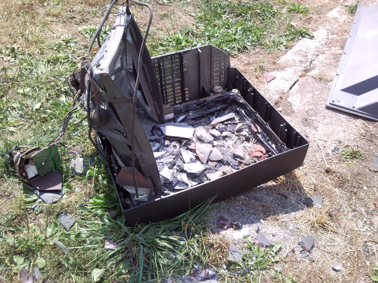

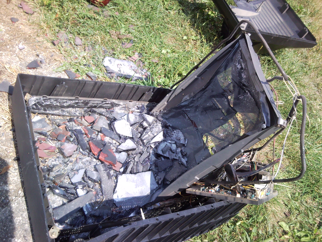

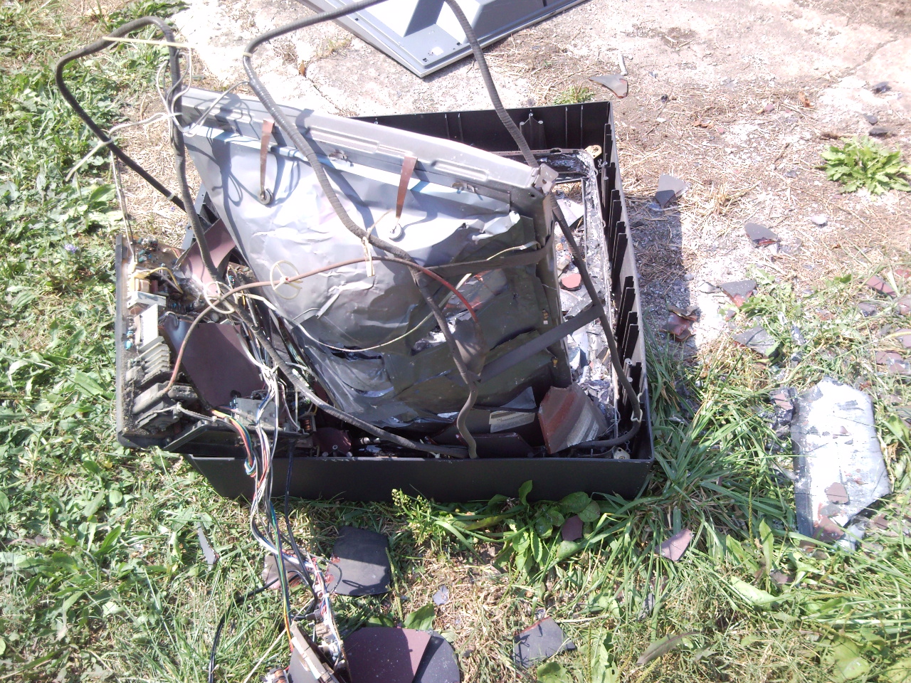

    someone dropped off a toshiba 36" tv last week to get rid of it.i found that it had a worn out crt so it stayed on the dolly and was rolled out to the loading dock.back was off to get the crt tester on it.tried to slowly tip it onto its face off the dolly when all hell broke loose.imho it was damaged somehow and just laying it on its face set it off.
    the boom brought out half the neighborhood.crt totally disintigrated and peppered my hand with bits of glass.several minor cuts and ringing ears is all i got.my help got hit with a big chunk but not cut.will try to get pics later.

      There had to be some type of fracture or weakness somewhere.
      The front of the CRT is the thickest part so the damage probably wasn't there.
      I'd be willing to bet there was hidden damage around the rim concealed by the frame where you couldn't see it from dropping or rough handling. Tipping the TV by the front plastic frame applied pressure around the rim and when the TVs weight was on it's face it gave.
      Well at least it's a modern implosion proof design an old tube would have gone off like a claymore mine.
      To think I've done the same thing countless times without thinking twice.

            That means rimband failed or was not tensioned properly during CRT manufacturing.

                      was fully assembled other than the back.

                          Never saw a shadow mask or aperture grille up close before. Can't tell what type of tube it was to verify.

                            For this toshiba TV, probably Mitsubishi CRT or RCA CRT or if the TV is very late model, could be generic CRT.
