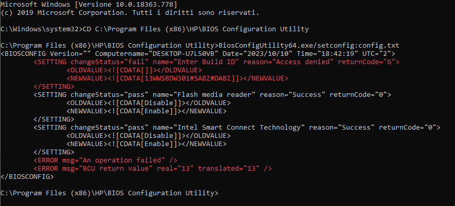

            Thank you for your help but unfortunately when entering these values I get an error
            [IMG][/IMG]

              So do I have to program the bios of the new motherboard using one of the two attached files?
              I don't want this operation to permanently compromise the functioning of the notebook, considering that now the only problem is the writing in question.

                Re: Hp Elitebook 820 G1 "warning!! machine is not in committed state"
                Originally posted by rex98
                test that it works in mine without DMI data leave the EC just test that two mains.
                I used main tested ok.zip and solved the problem. I really don't know how to thank you.
