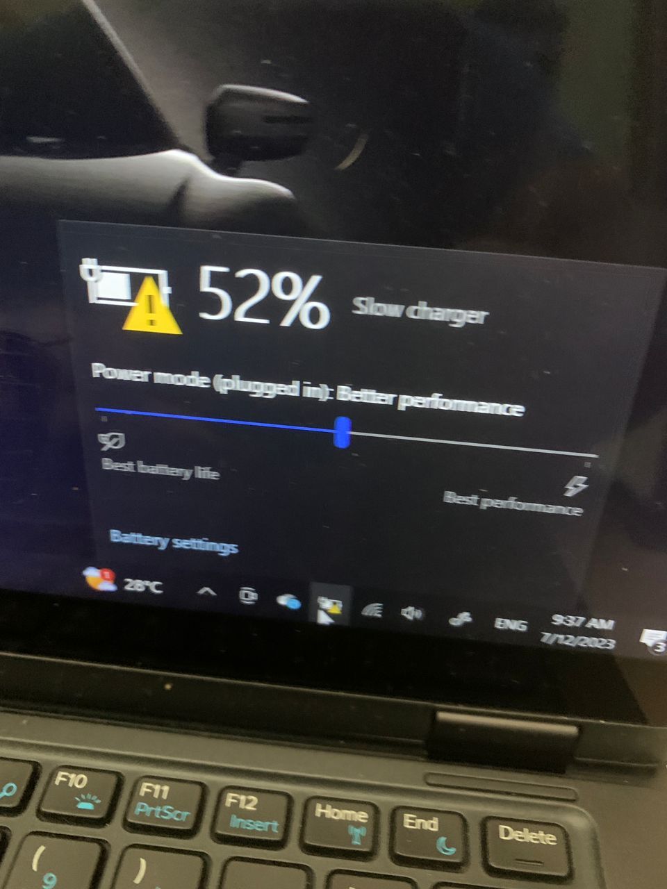

Dell 7390 2 in 1 warning "Slow Charger"
  • dqtech
    Badcaps
    • Jul 2018
    • 633
    • N/A

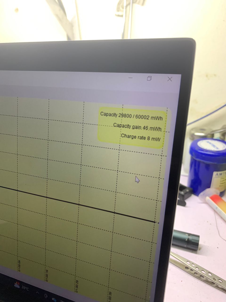

    I have try with 3 different adapter
    Dell adapter 40w - warning "Slow Charger" (charge rate 8mW)
    Dell adapter 65w - warning "Slow Charger" (charge rate 8mW)
    Power Supply Connected with BY-3200 (in bios detect 65w) - okay and no warning (charge rate 25000mW-32000mW)
    i already tried update bios and update all driver but problem still persist....any idea to solve this?
  • mcplslg123
    • Jun 2015
    • 7262
    • india
    With dell 65W charger being used, adapter is detected in bios??. Since you have not mentioned the mb markings, locate the sio markings and check ps_id pin on sio. Is the ps_id voltage reaching sio?
