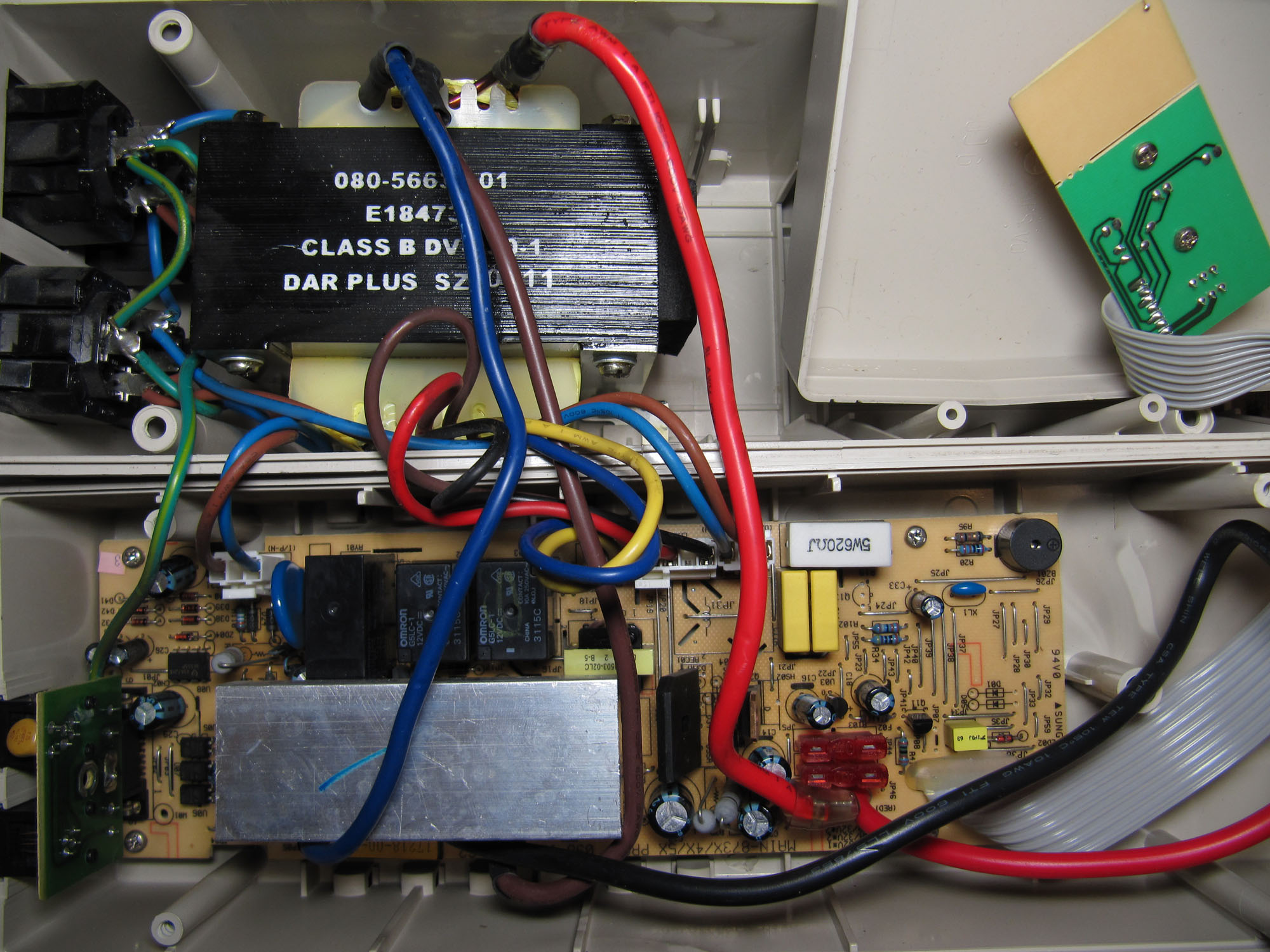

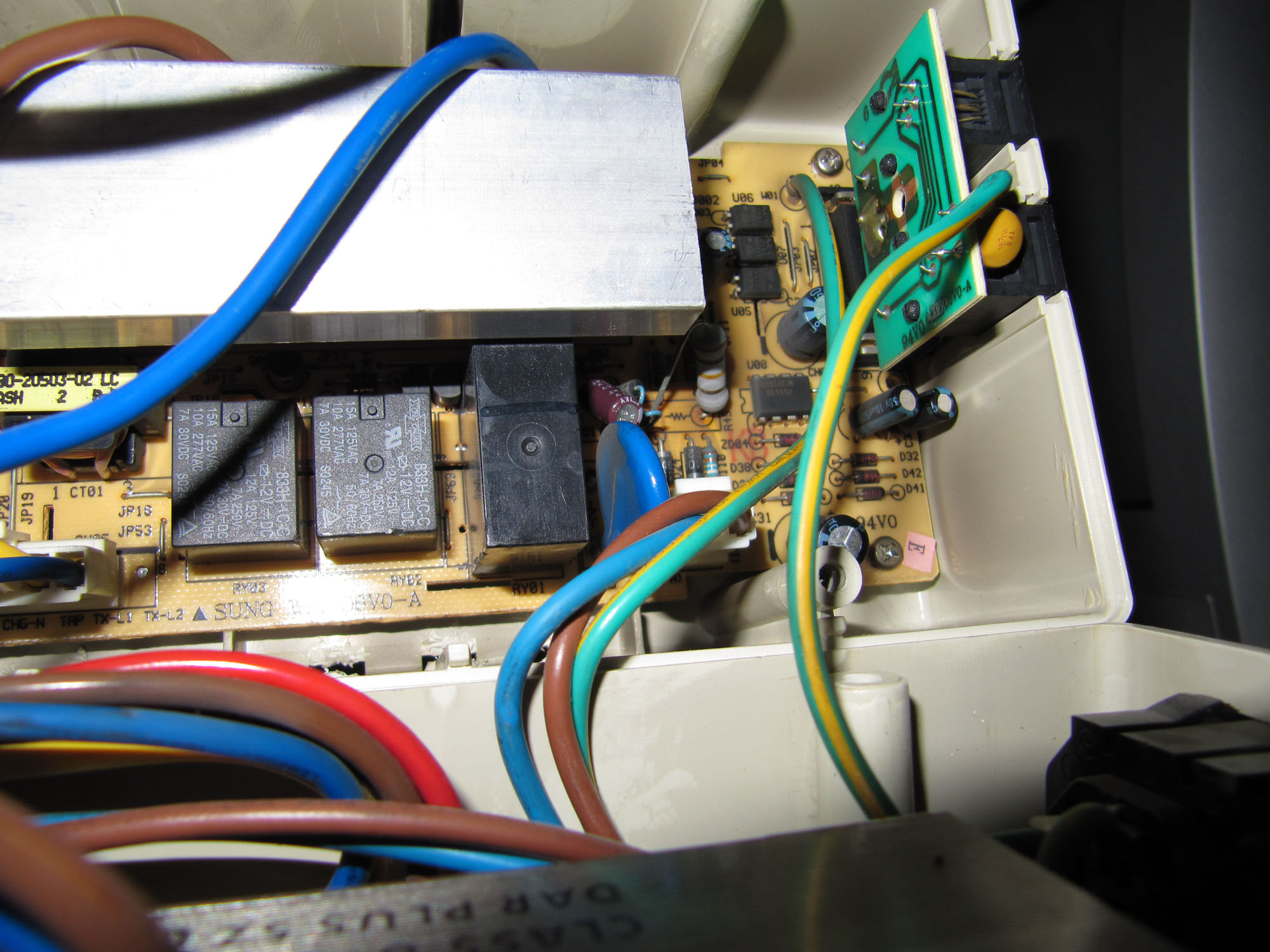

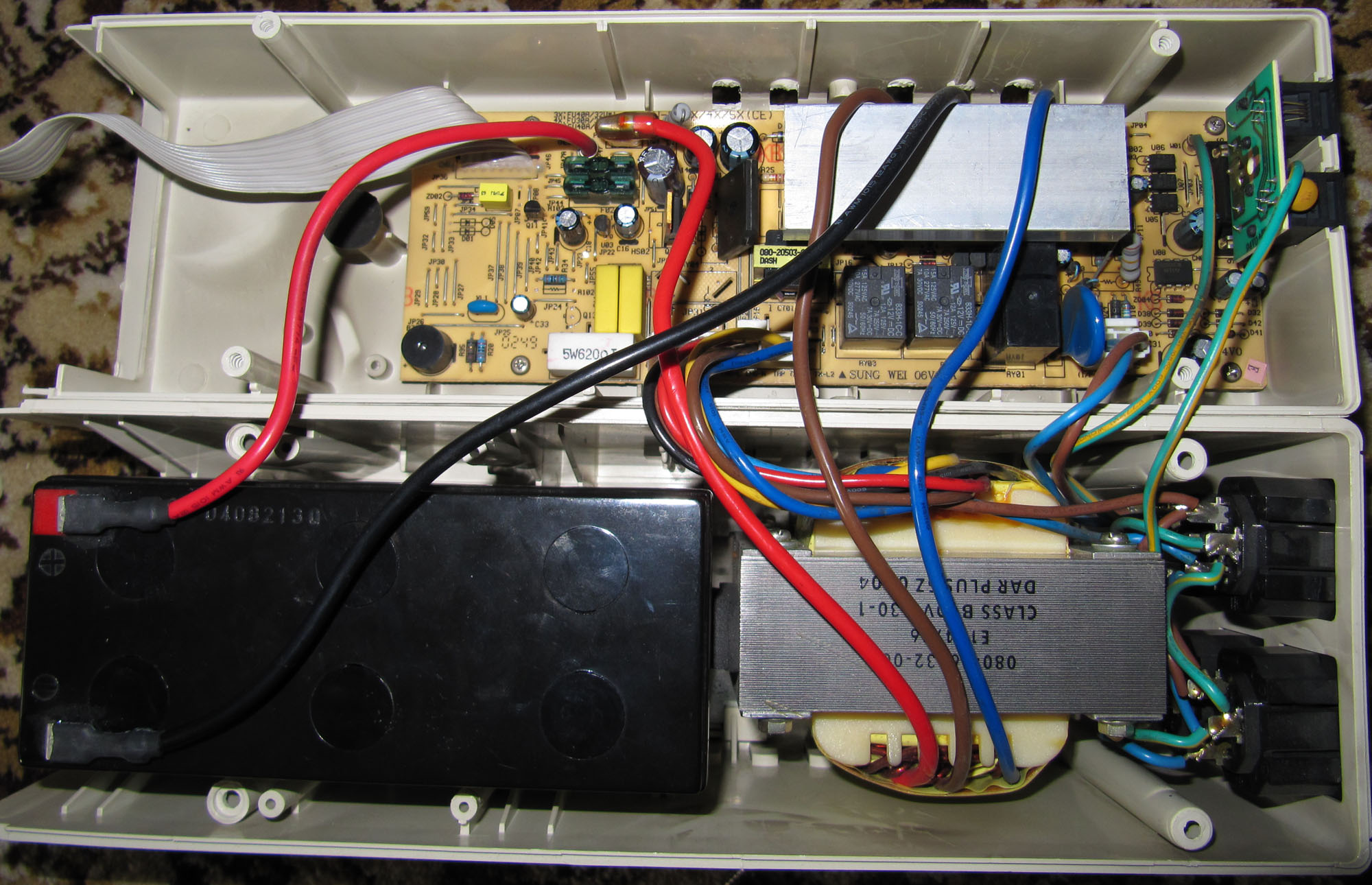

                  I opened this 600VA UPS piconet that has been working for 2 years to check its capacitors. I found a bad Jamicon TK 50V 10uF and replaced it with Chemicon KY 50V 10uF. Some pics attached.
                  The only bad thing about that ups is that it gets very hot (fan-less design) and this has an impact at the battery life. For that reason a friend of me drilled holes at his ups case and placed the battery out of it.

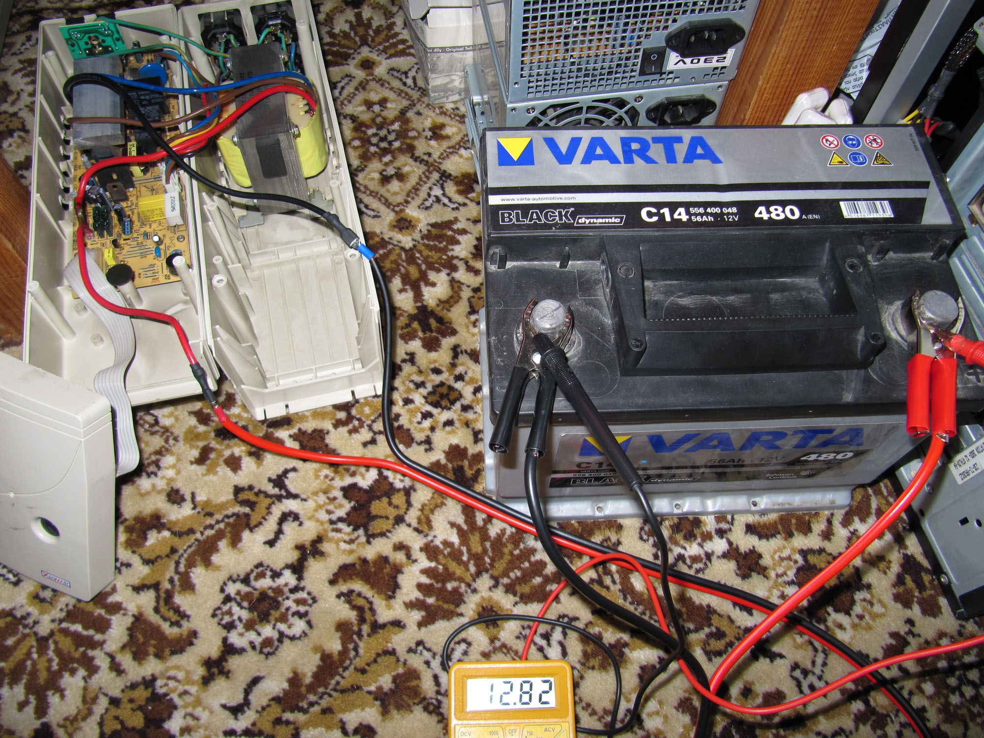

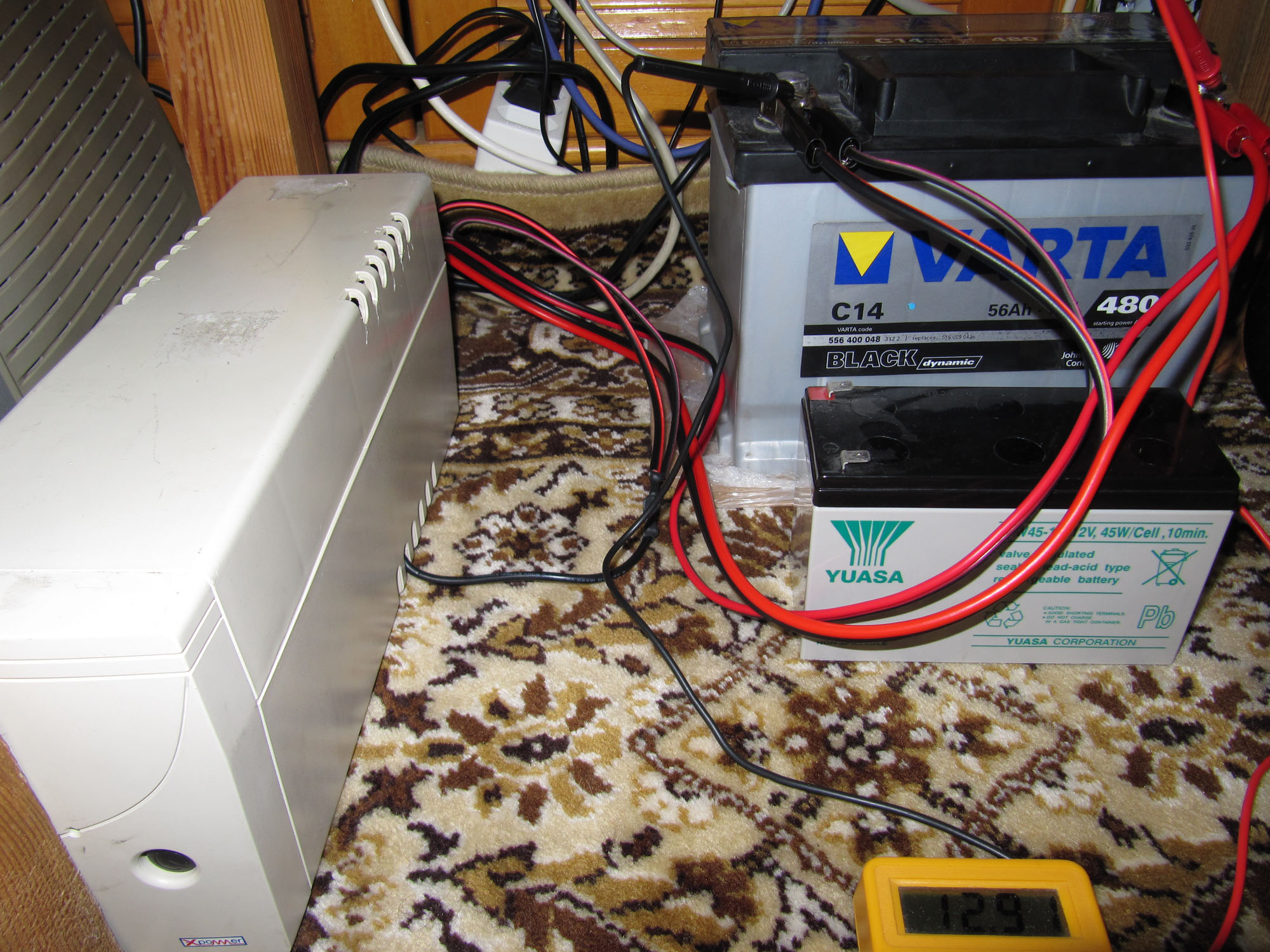

                    Just a question about a mod I did on that 600VA ups to use an external battery. The battery is a used VARTA 12V 56Ah automotive battery.
                    It managed to power a 100VA PC for more than 30minutes and the multimeter showed 12.20V. I didn't let it more because car batteries should not be fully discharged.
                    The ups is able to charge the battery and finally provides a standby charge voltage of 13.72V.
                    The only thing that concerns me is that the cable I made to connect the UPS and the external battery gets too hot after some minutes of ups in battery mode. I went to the electronics store and bought a bigger cable, but it gets warm too. As you can see in the photos attached the new cable is clearly larger than the original UPS cable. That doesn't make any sense to me.
                    What do you think?

                      Well 600VA UPS has 400Watts power, so for 12V batteries to produce 400Watts of power, it will need to supply about 33A of current (Ohms law), now you know why the wires get hot! you will have to keep it as short as possible and larger than the load require. It is going to be a hunk of wires. If the look at the internal fuses where the batteries wire go to, you will see 40A fuses there.

                        Re: Are these ups good?
                        i use #6 in short runs on 12v units.the excessive drop in your wires will cause early low voltage shutdown and more heat as the duty cycle ramps up due to the low voltage.
                        and yes repeated deep cycling will damage a car battery but it will most likely die of grid corrosion on long term float.this may take many years.dont worry about it.
                        just tested a 14 year old 8d that has been on a ups at least 10 of those years.it still gives good runtime and passes a 1000a load test.has about 30 deep cycles on it.

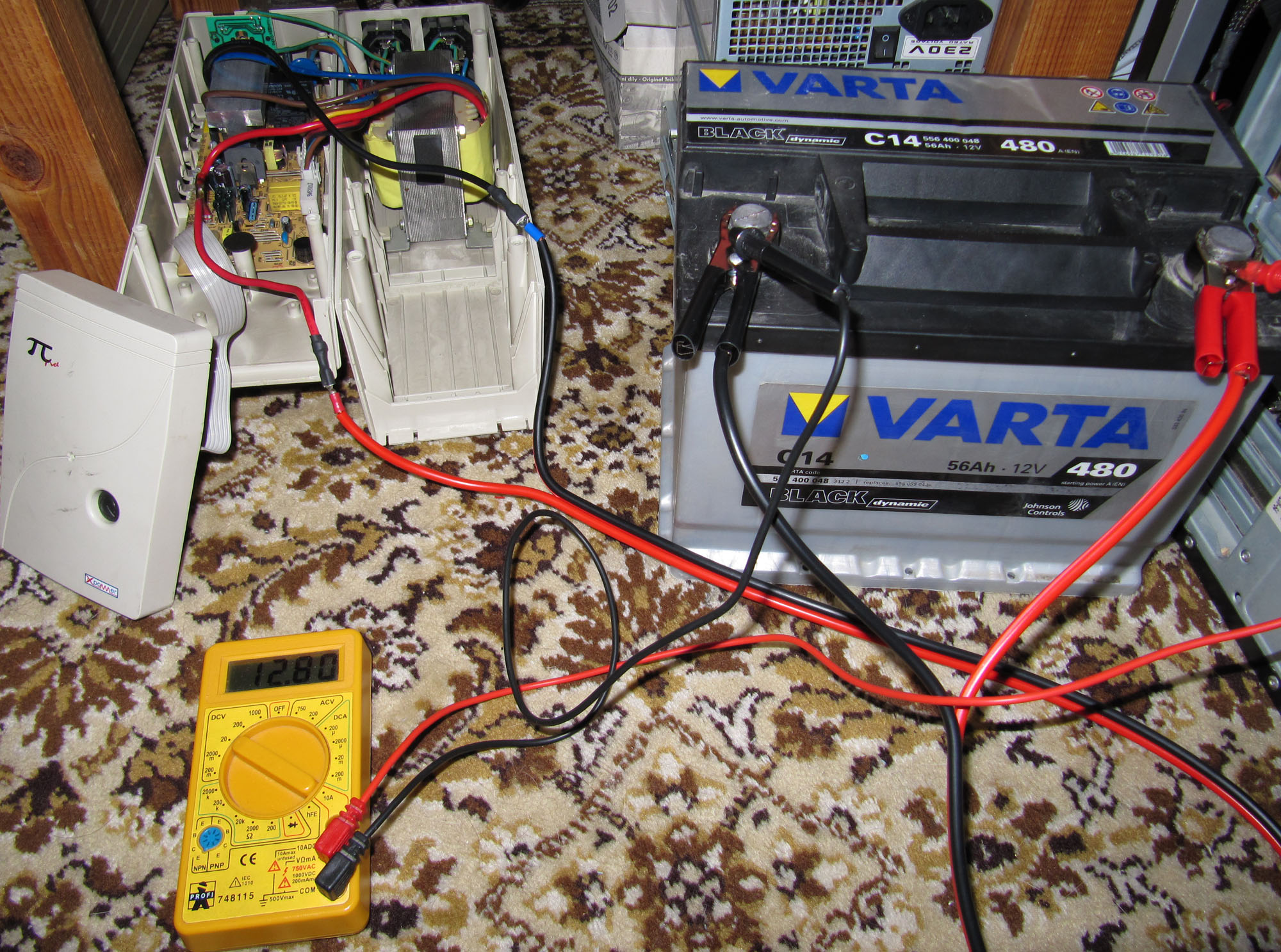

                          You were right!
                          I connected the old wire in parallel to the new as you can see in the photo attached. The cable length is 1 meter.
                          I tested it with ~275VA load and it got hardly warm. In fact the original UPS cable gets warmer! The UPS cable is 12AWG.
                          Thank you

                            You can measure the voltage drop on the wire easily.
                              There is ~0.15V voltage drop. That means ~4W heat loss across the wire?

                                The cable gets hot because you are using spade connectors on there! Those don't handle more than 25A safely.
                                Muh-soggy-knee
                                  Is that the voltage drop before or after the new wires?
                                  That wasted power of 8Watts, 2 wires: one for supply, one for return.
                                    It is after the new wires. Before the new wires there was a ~0.35V voltage drop if I rememer correct.
